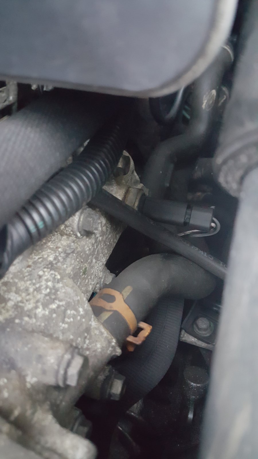

My tdc doesn't seem to be have a bracket on it? Was going to be replace that too but not sure which is the right one?!

  Clio 172 PH2
Hey mate! I can't until next weekend. Bought new plugs, crank shaft sensor and o ring for the fuel rail connector. Wish me luck.
