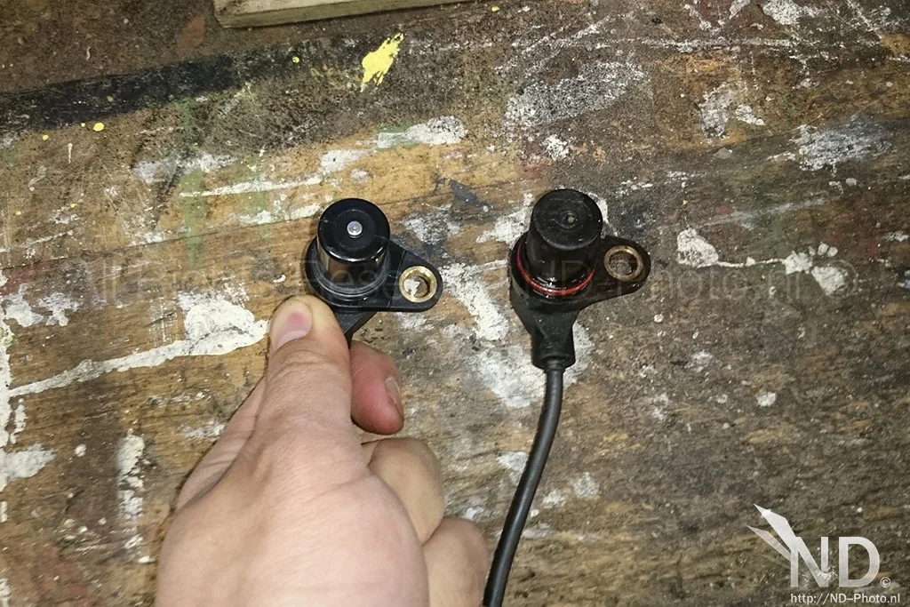

Well I found this when replacing it on my Leon
New vs Old by Andy Ramdin, on Flickr
It will probably have worked again after a good cleaning session, but I didnt want to risk it. I found out because of another forum member, else I would have gotten the fuel pump replaced (already ordered it etc). Please note the info below is for a VAG car, but will probably work the same for our frenchies.
