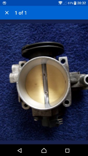

As per title, is it worth it on my ph1?
See link to eBay ad -
https://rover.ebay.com/rover/0/0/0?mpre=https://www.ebay.co.uk/ulk/itm/391920862355
£85 on exchange basis.
Will it help in any way or even be noticeable? I had an enlarged 182 throttle body on my 200,i can't say I ever noticed a difference?

"Your immediately notice the gain in power once fitted giving the engine a huge increase in torque"
plus the smell of his bullshit!!!!!!
The description isn't exactly selling it but was wondering if, combined with other mods, it might make a little difference? Like matched Inlets with other supporting mods.

Use the search, been covered thousands of times and the consensus is always that it's pointless.
The tb can flow enough on turbo cars so you'll never get it to be a restriction with your mods.
In fact iirc the 225 TB is smaller than a 172 one!
  dan's cast offs.
waste of money from a performance point of view. but if it's had a new spindle and the body has been bushed to suit then worth considering.
