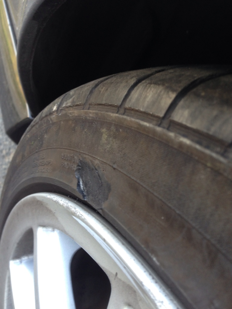

Worth replacing?
Car  Clio 182
Had a run in with a curb just before....
should be fine. if no cords are exposed just keep an eye on it if it starts to bulge then replace it.
Based on the state of our current roads with pot holes etc I'd get that replaced. I've had a few sidewalls bulge after hitting a pothole so god knows what the damage would be if you hit the weakest bit of the tyre with a chunk out it at 70mph.
For the price of a tyre I'd get it swapped.
I'd keep a very close eye on it but if it stays like that then I'd stop worrying. Whether thats correct or not I dunno, buts its what I'd do! First sign of a bulge it can gtf
