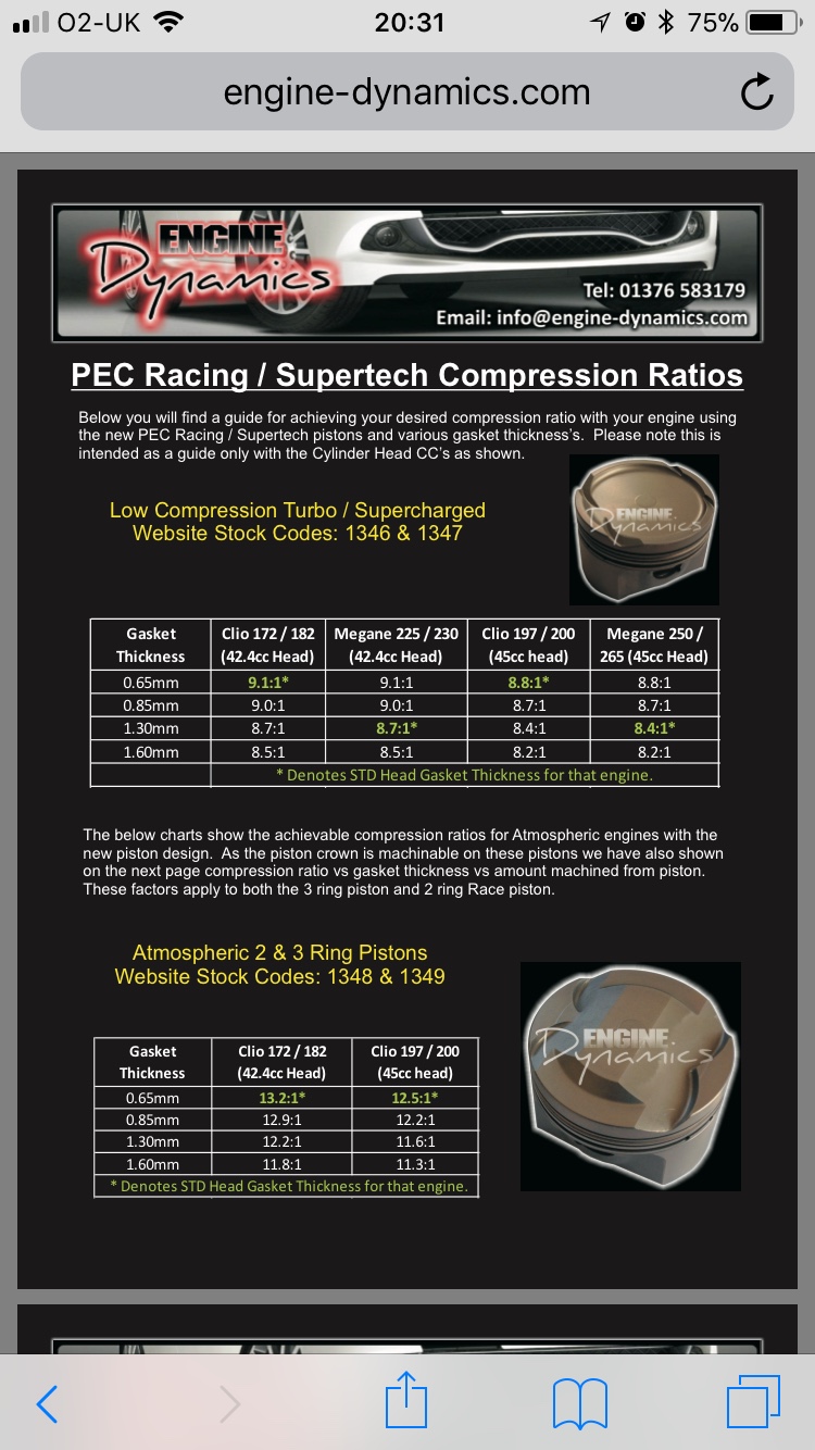

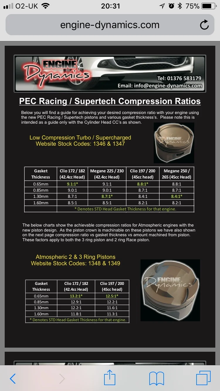

Hi guys, what wossner pistons are people using to achieve this compression ratio in an F4R?
I don’t want slappy competition ones either, I have seen there is an option!!
I can get wossner cheap through an engineering friend but currently we don’t know part numbers... can anyone help?
Cheers
  dan's cast offs.
i'd take quoted ratios with a pinch of salt anyway, most will give few different sizes from 82.5mm-84mm but still give same cr. (sizes are off top of my head by the way)
incy-spider
I’m aware of the sizes, std size and oversize... what I’m after is what piston would give me 9:1 in my 182 engine... I can get 9:1 Megane pistons but not sure what that would equate too in an f4r!
  dan's cast offs.
fwir the meg listed pistons give a lower cr used in the clio engine? what power and boost figure you aiming for?
incy-spider
Chris@efi has mentioned he gets nice results from 9:1 and they retain good drivability... 9.5:1 are good up to 300ish on pump fuel... pretty sure I can get both with one choice of piston by using a 1.3mm gasket for 9:1 I just need to get the wossner part number to order.. apparently there are a fair few options so want to be sure!
  dan's cast offs.
it was chris i was talking to about meg pistons and sure he said about them being lower cr? wossner not give dimensions on their site?
incy-spider
  dan's cast offs.
piston dimensions, with them you canr work out exactly what's what if you want to be bang on 9:1.
