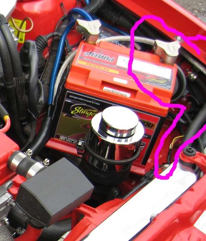

here you can see my old kit fitted on my mates astra..
the ballast is fitted to the inner wing (red box behind battery) and then the wires go from that through the rubber dust seal (we just pierced a hole through it) some wiring to the bulb, and the connector that plugs in the standard wiring connector plug that usually clips in the bulbs.
took us about 30 mins to fit them.

fitting is a piece of piece..
ballast unit you fit in the engine bay behind the headlight with the mounts provided or mega strong double sticky pads..
then you have two wiring looms coming out of it.
one goes to the standard H7 fitment plug that usually connects on the back of the bulb.
the other goes to your HID bulb that fits in the normal h7 lamp holder.
