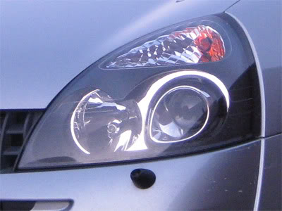

Can anyone tell me the process of fitting the 'ice blue' lights cars seem to have now. im guessing these are the xenon headlights? how do i fit these, is ít a case of buying the bulb or a new headlight?
Well you'll need to change the headlights to those which came on 172's and 182's.
You'll also need the bulb, ballast and igniter for each side, these plug straight in. It's easier to buy everything together, so look for 1*2's breaking on here.
You can get HID kits which fit into your current headlights, but DO NOT INSTALL THEM. They blind other road users, potentially causing a crash and absolutely beg police officers to pull you over.
