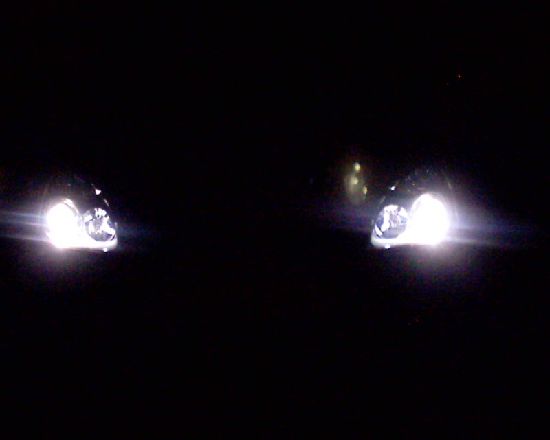

They use the same wiring as the standard lights and they bolt in the same place (after removing the bumper) To make them legal you will have to fit the headlight washer jets (I have done this but NONE of the wiring is there and you have to DIY) The auto leveling computer has to be fitted too and again none of the wiring is there. I have also fitted this and it works perfectly. There are SIX wires to connect up but you have to get the wiring connetor for the computer from a scrappy. It is very easy to wire in with most of the wires connecting to the radio and one to the Headlight adjuster switch. The last one was a bit tricky the Green wire has to connect to the socket under the ash tray but again not rocket science.
Hey presto fully legal xenons
