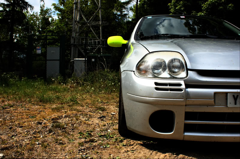

Get some 25mm's! Also about 1.5 deg of camber
First pic for the thread too lol!

The spacers are the Delta Mics ones form LK. They come with bolts to bolt to the hub then my original bolts bolt to the spacers.
If they didn't have the camber they would sit just outside the arch I think.
Cannot comment on what they feel like as need to get my camber on the other side set after the mishap I had with a wheel. But at the minute is feels weird, it feels like its dragging the back round around corners and feels liek it will lose grip, could be the camber not setup properly, or something bent from the mishap!

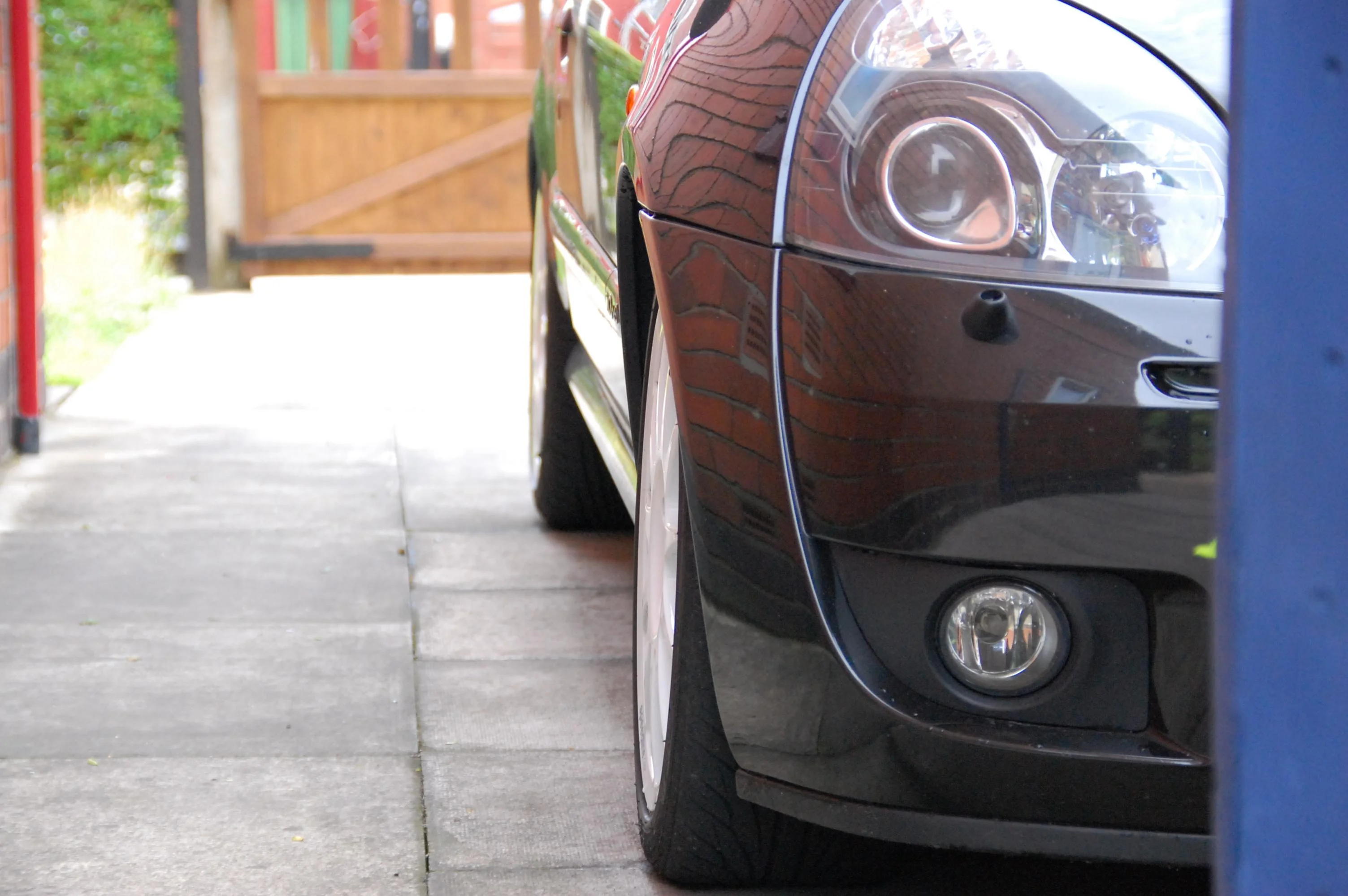

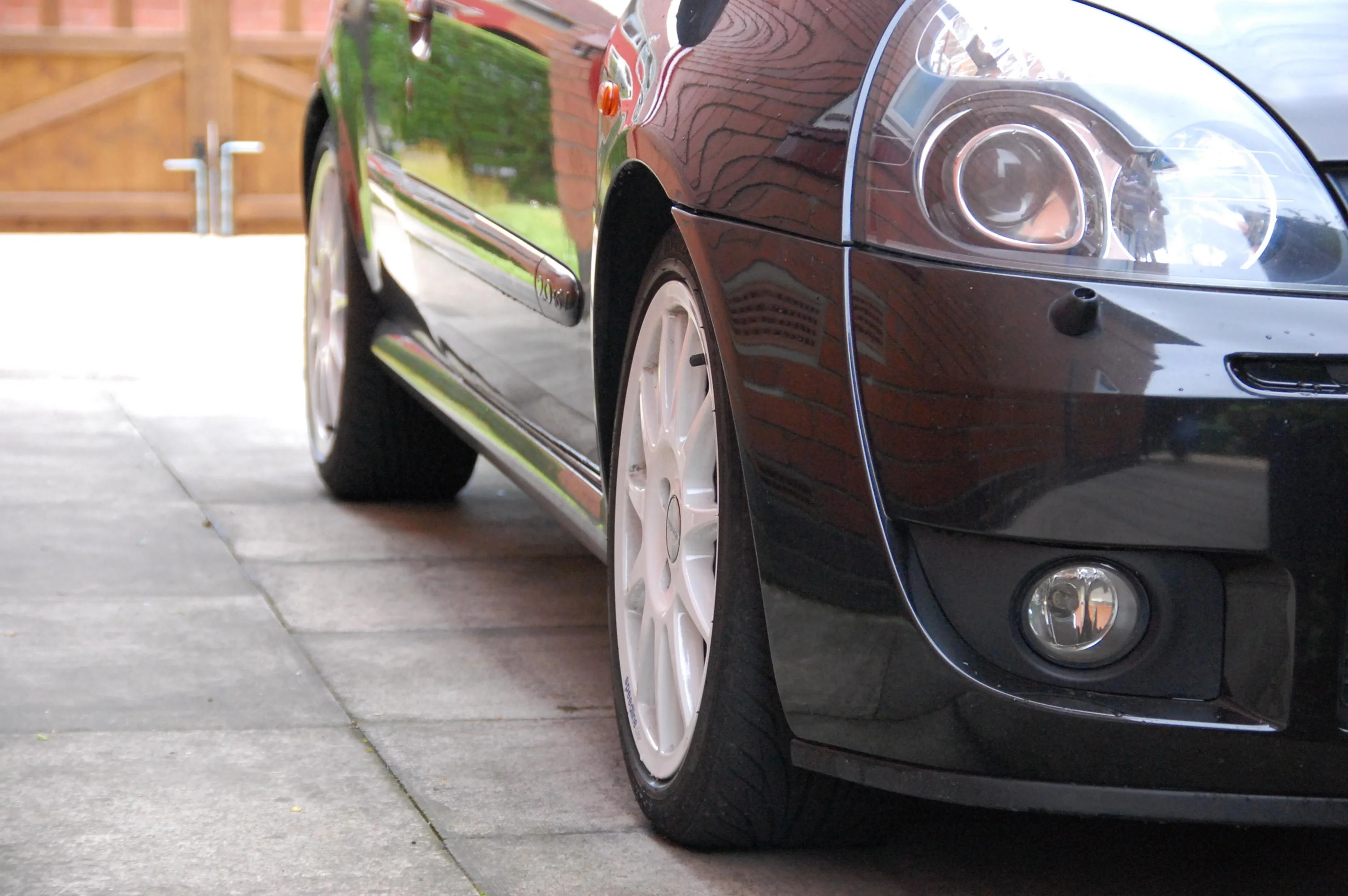

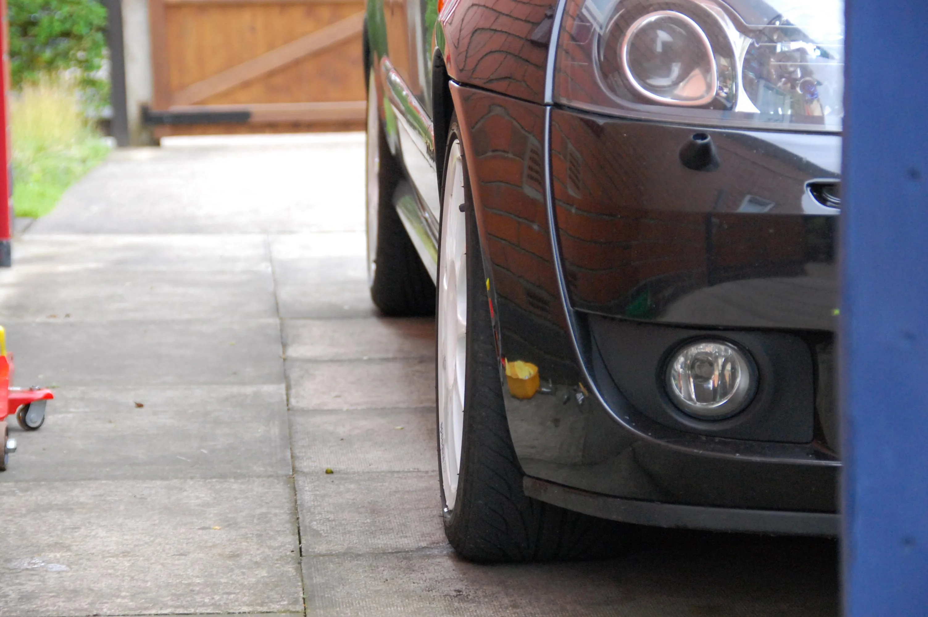

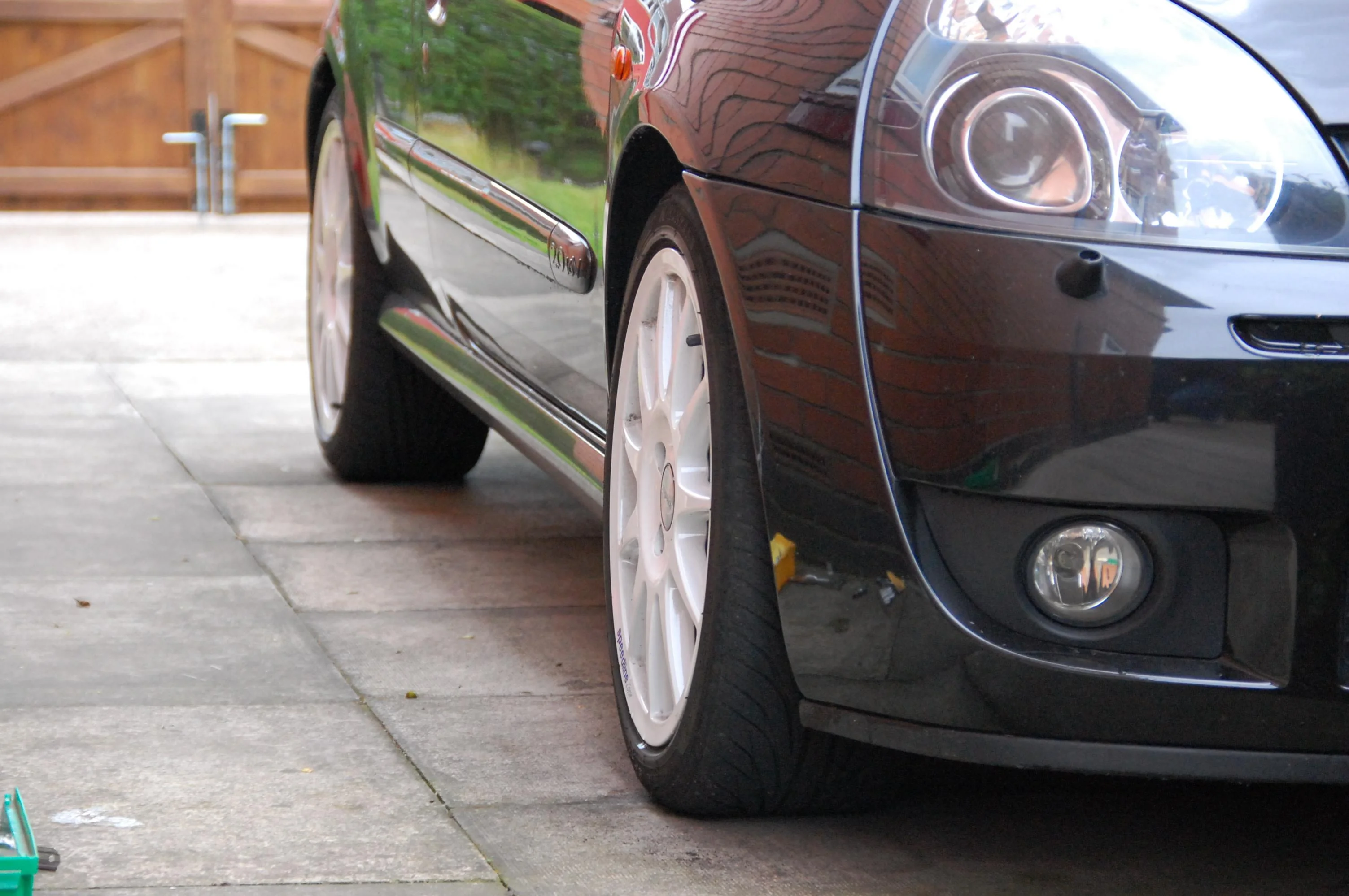

I've got 13mm hub centric spacers on the front of mine.
Some before & after pics...........

Just what i was looking for pete! Do they hit the inside of the arch? as its pretty close isnt it?
  Clio 172
There's a nobble on the arch liner that sticks out & it was just rubbing on that slightly on full lock until i filled it down;)
Think there eibachs (got them second hand), I've not got studs just longer bolts.
Its sat on koni ajustsble shocks/eibachs sportlines & running about 1.5deg negative camber
