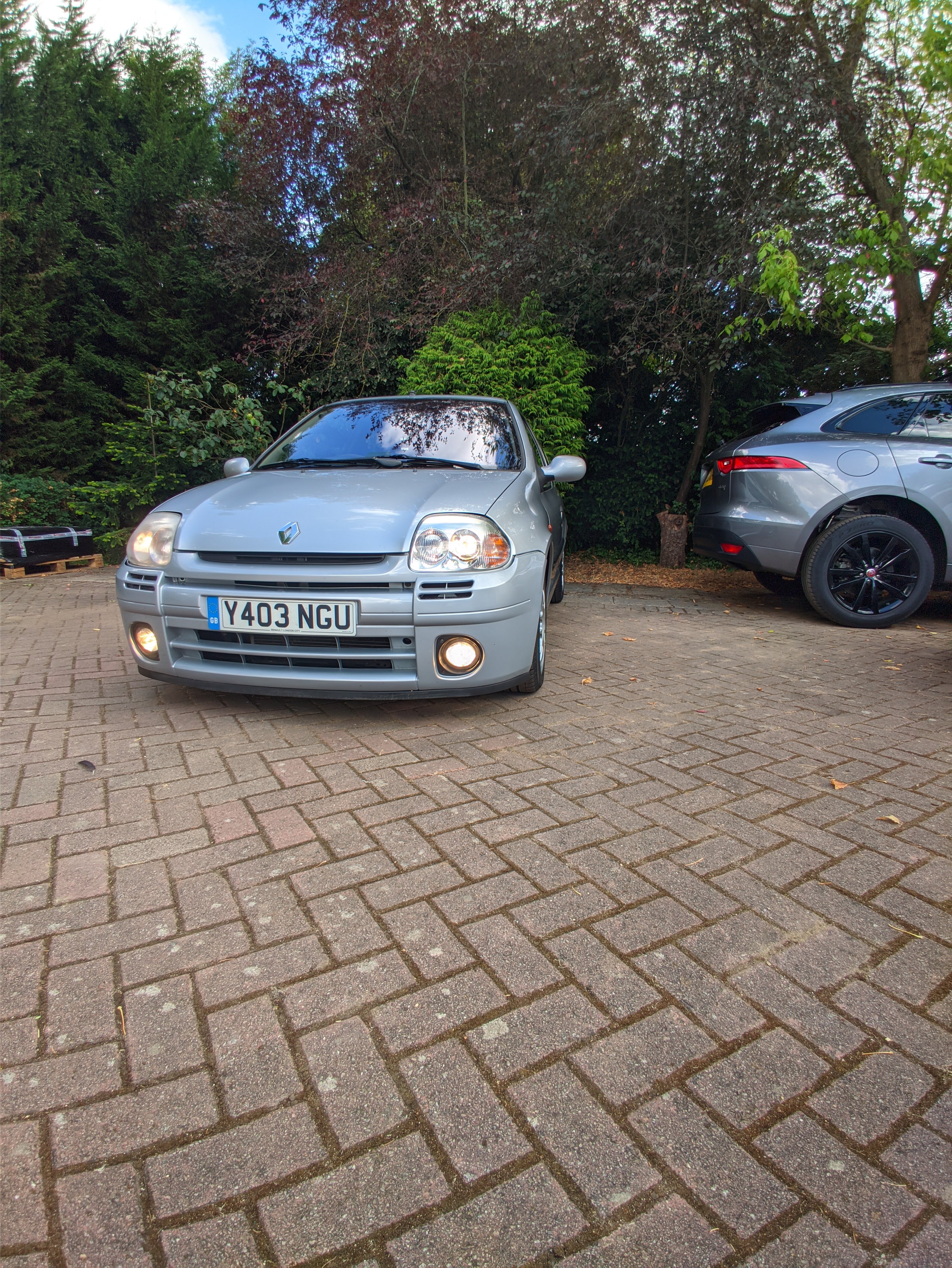

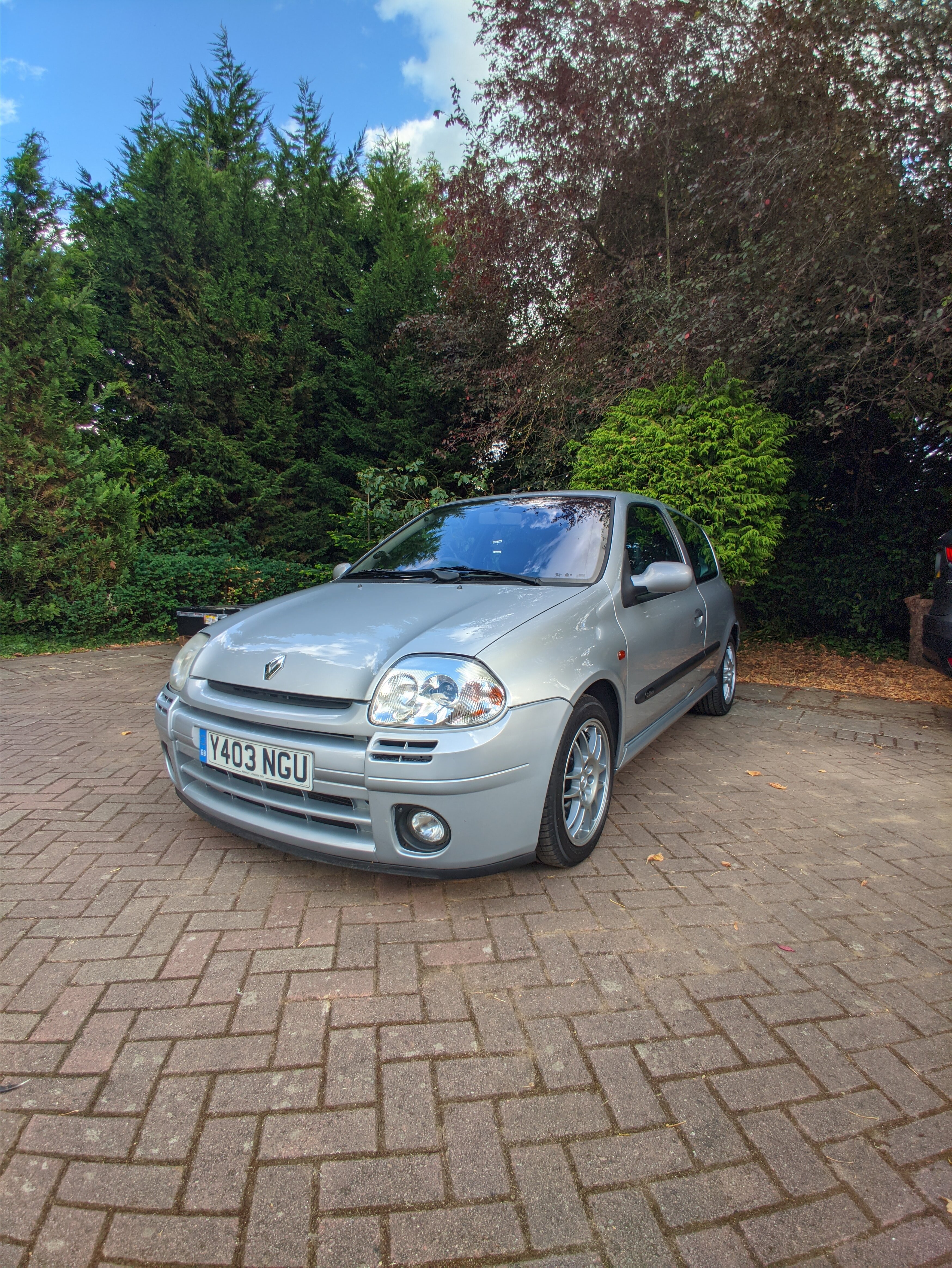

Hey guys! I am the (extremely happy) new owner of a phase 1 Clio 172. I came from a 50k mile 2003 boxster S in completely mint condition - I was worried the 172 wouldn't live up to it and my god was I wrong! I couldn't stop saying holy sh*t on the way home because of how impressed I was with the handling 😂 that's really saying something coming from a mid engined sports car.
It was advertised for 3999, and I got it for 3600 due to a cracked windscreen and what seems to be a leaking OS CV boot!
It's got 84k miles and a seriously thick service history folder! From the history it seems to have bilstein b14 coilovers installed, as well as powerflex camber bolts.
There's a bit of play in the shifter when shifting and the engine jumps around a bit on cranking, so I'm going to get those polybushed I think. Gearbox might need a refurb too, 2nd gear whines a bit.
Anyone got an estimate for how much a CV boot costs on one of these? And a new windscreen? And gearbox refurb?
I'm obsessed with the way it looks, a couple of dings here and there, and unfortunately looks like an elephant has sat on the roof, so I'll need to get that sorted if anyone knows someone who's good with bodywork!
Also do spacers mess up the geo on these? Considering some subtle ones to fill out the arches, but I care more about handling performance than looks, so won't do it if it messes up the handling.
