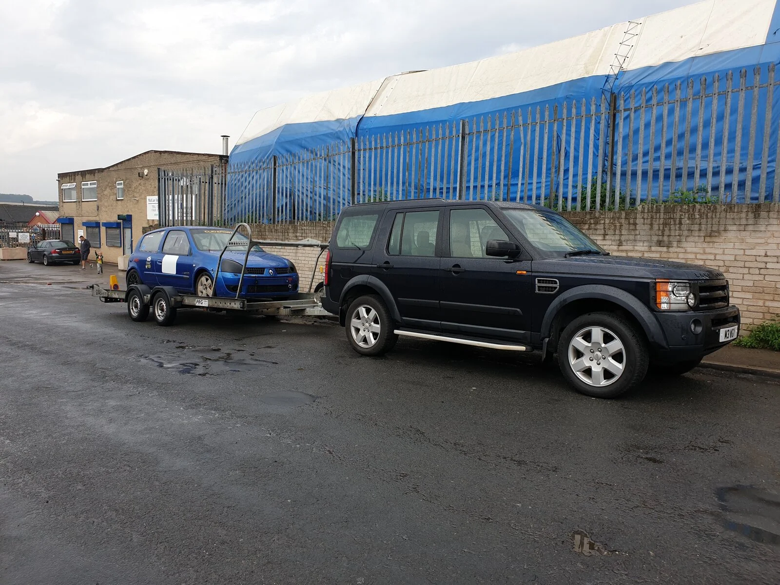

I've always liked the 172/182s and always thought about buying one at somepoint as a bit of a toy. So on a bit of an inpulse i found myself on a 10 hour round trip to Doncaster from South Wales to pick up a 172 Cup sprint car. In equally as impulsive fashion i also decided to pick up a trailer along the way which was a brave/stupid move but thank god it all worked out ok.

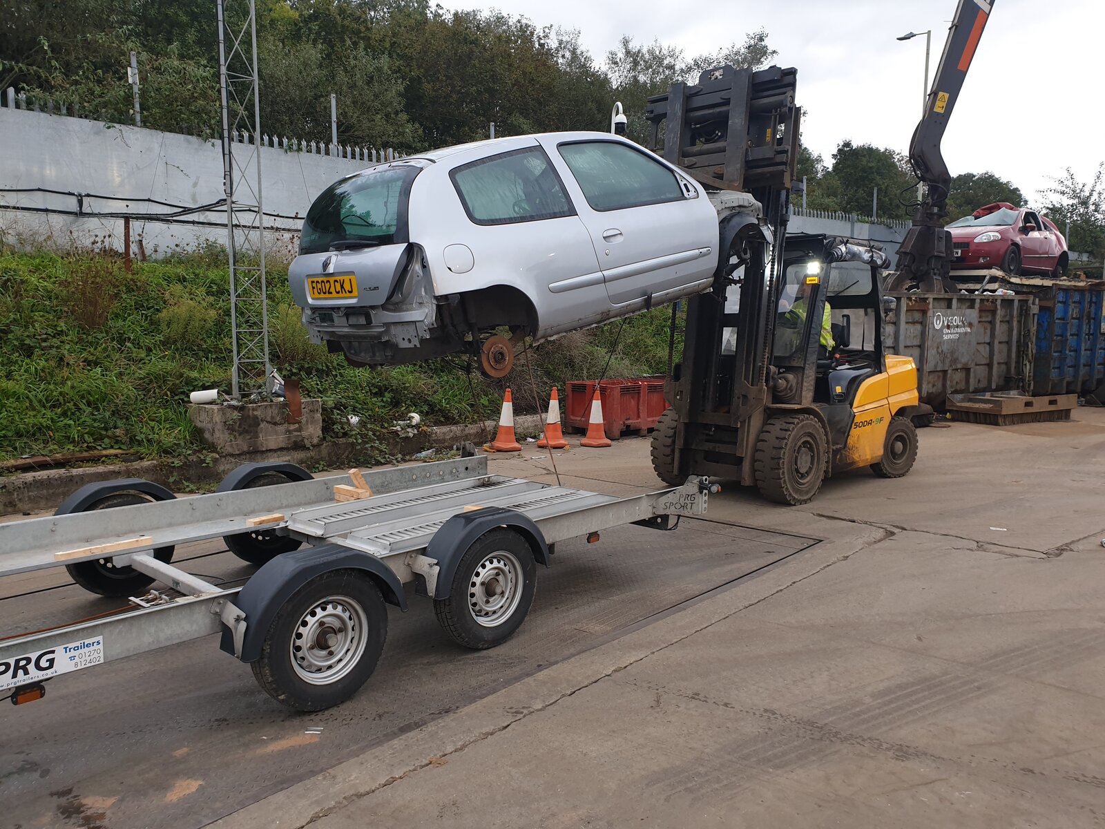

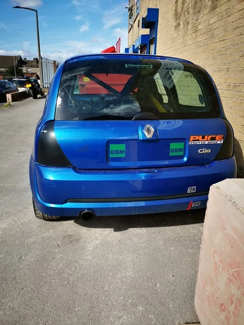

Here's a picture of the car on the way back...

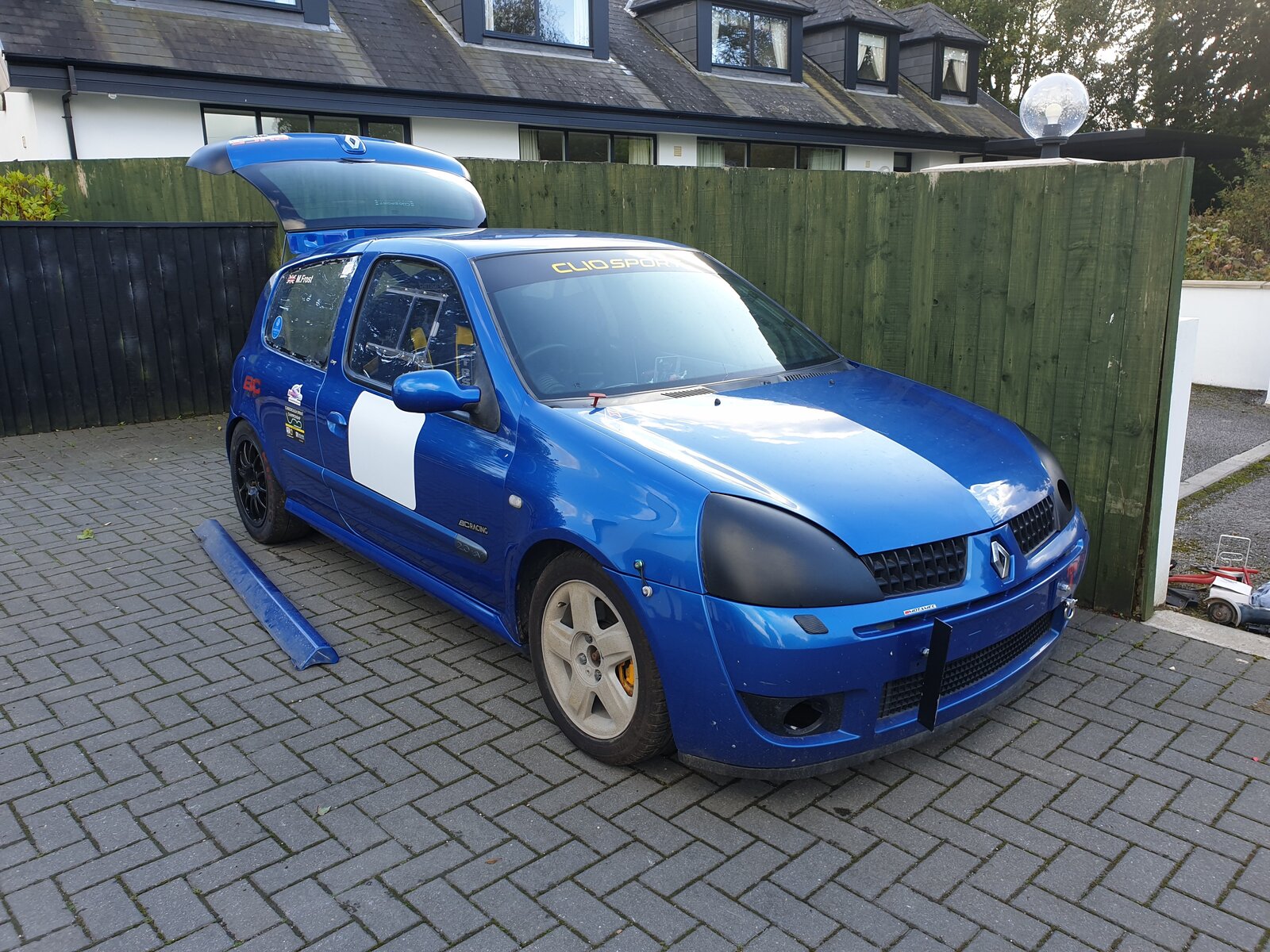

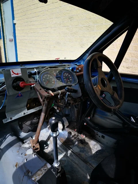

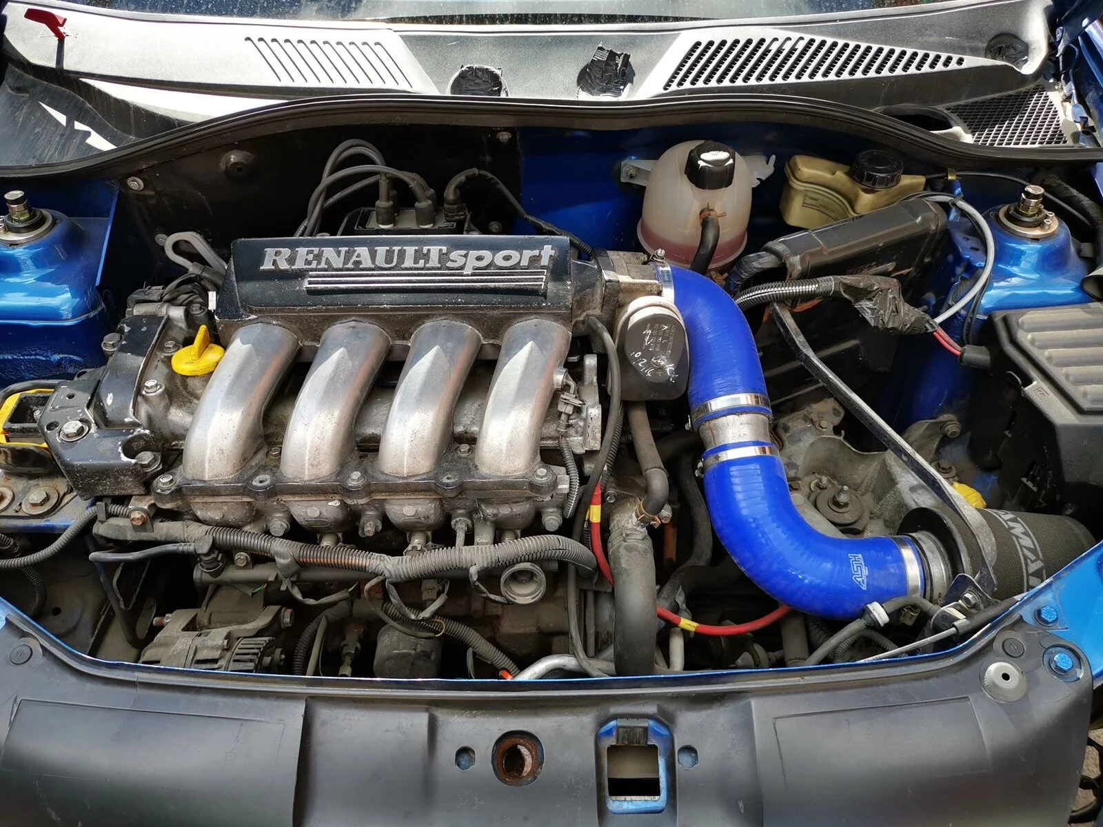

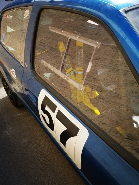

Pictures from the advert
The original plan for the car was to get it onto the track and do a little sprinting in between with the potential of also getting it back road worthy for a trip to the 'ring. So with that in mind, there was a few bits that i needed such as washer bottles, interior wiring and some other bits. So in another crazy moment whilst trawling facebook i stumbed upon @Filters old clios which were only down the road so went to pick them up too..

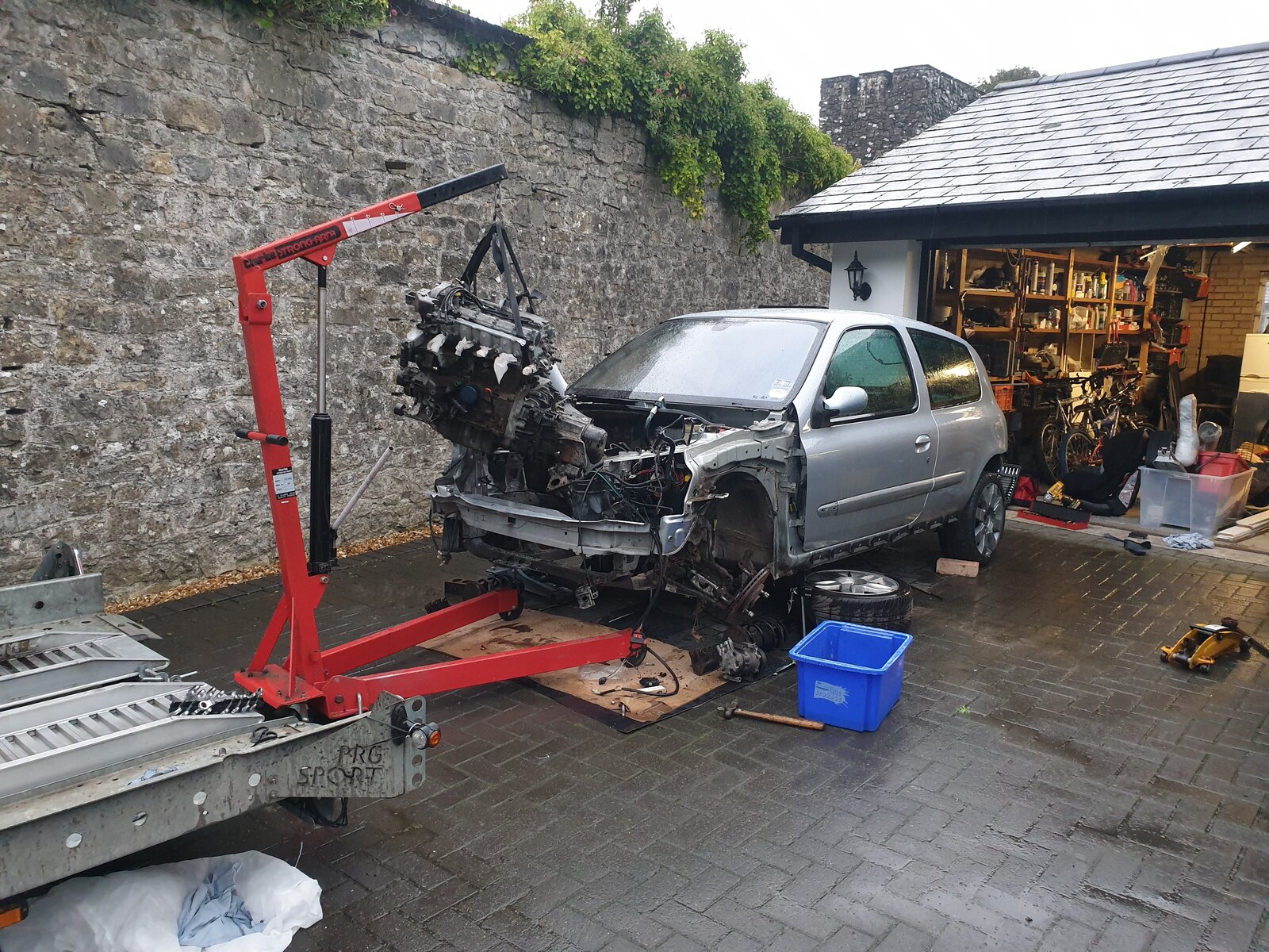

This was the first i picked up from Andrew, previously crashed but had a good engine and gearbox in along with some running gear. Picked it up on a Friday, engine out on the Saturday (in the rain) and scrapped on the Tuesday.

When i bought the car i was told that there is sometimes an issue with starting. Upon investigation i can see why and have a plan in place to get it sorted. At the moment the negative/earth wire from the battery is about 1-2m long and the cabling is too thin for both +ive and -ive. I've ordered 4awg red and black cable which will replace this over the next couple of weekends. Although it does work, it can be improved, esspecially as french wiring is already known for how s**t it is!
More concerningly was the lack of inline fuses used for the +ive cable. In fact, there are zero fuses at the moment which is a big no so that has meant that this job is the next on the list to get sorted. Mega fuses, cabling, criming tool, round connectors etc all in the post!

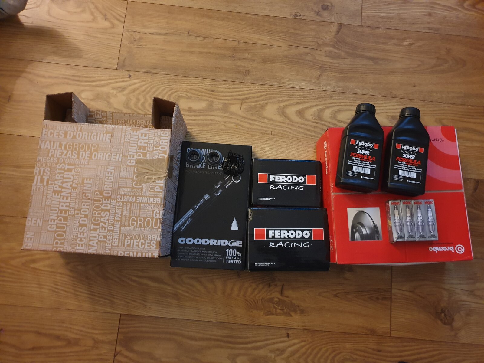

Here's the bits i ordered from @George@RTR_Parts. Great service, price and quick delivery - Would recommend him to anyone. Thanks George!
  • Front discs - Brembo HC - Didn't see the need to go for the Max or Xtra discs
  • Front pads - Ferodo DS1.11
  • Rear discs - Genuine Renault discs/bearings
  • Rear pads - Ferodo DS2500
  • Fluid - Ferodo Racing
  • Set of Goodridge braided lines
  • Set of plugs
  • New hub nuts / spacers
These will all be changed when i have the calipers off for the refurb. Whilst i'm there i will likely replace the front bearings to save a job in the future. Any recommendations on which brand is best or is it the same with the rears and stick with genuine?

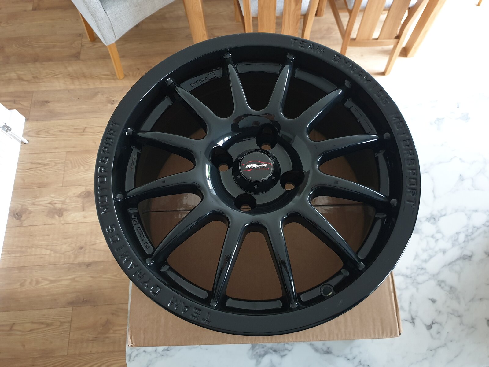

Team Dynamic 1.2 Pro Race ET35 and correct size so no adaptors. The other TDs i have are ET40 so these will sit 5mm further out. The plan is to have a set with semi slicks on and another with wets or one set for track work and other for the SS sprint/hillclimb tyres. I'd been looking online and second hand sets but sometimes it's just better to have new and at least know that they are all straight etc.
Next is the minefield to find some tyres to put on these. Opinions are everywhere, don't know whether to bite the bullet and put R888s straight on or something a little cheaper for the first few running in track days etc.
No worries Sam, happy to help mate. Those will sort your brakes out (y)
I can supply the front bearings aswel, SNR are the OE fit and ones to use, drop me a PM i'll get those out for you if not got them already @Sam1008
