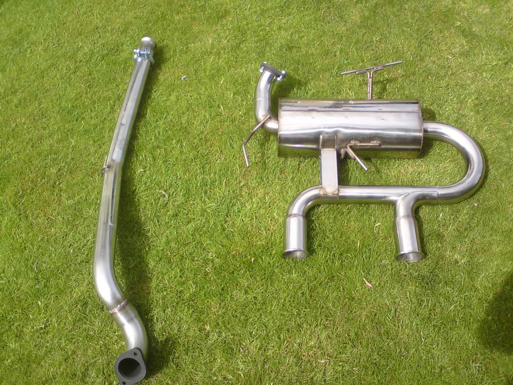

Pics of fitting and the final result...
The exhaust arrives
After about 10 minutes of unwrapping

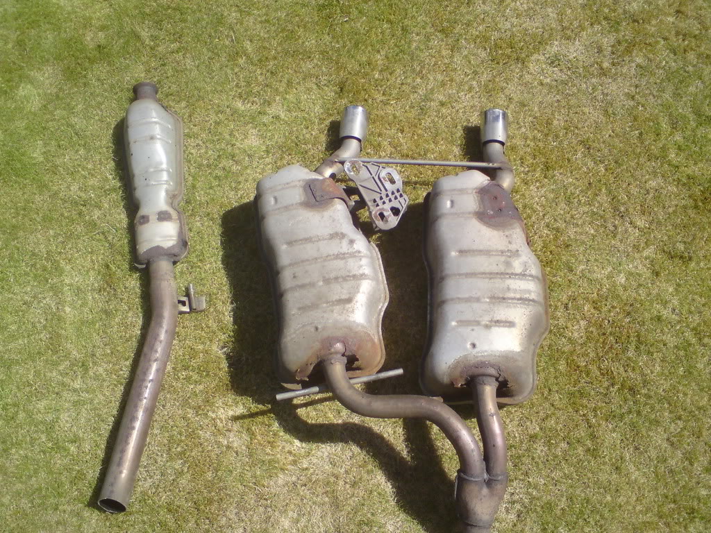

Old vs New :D

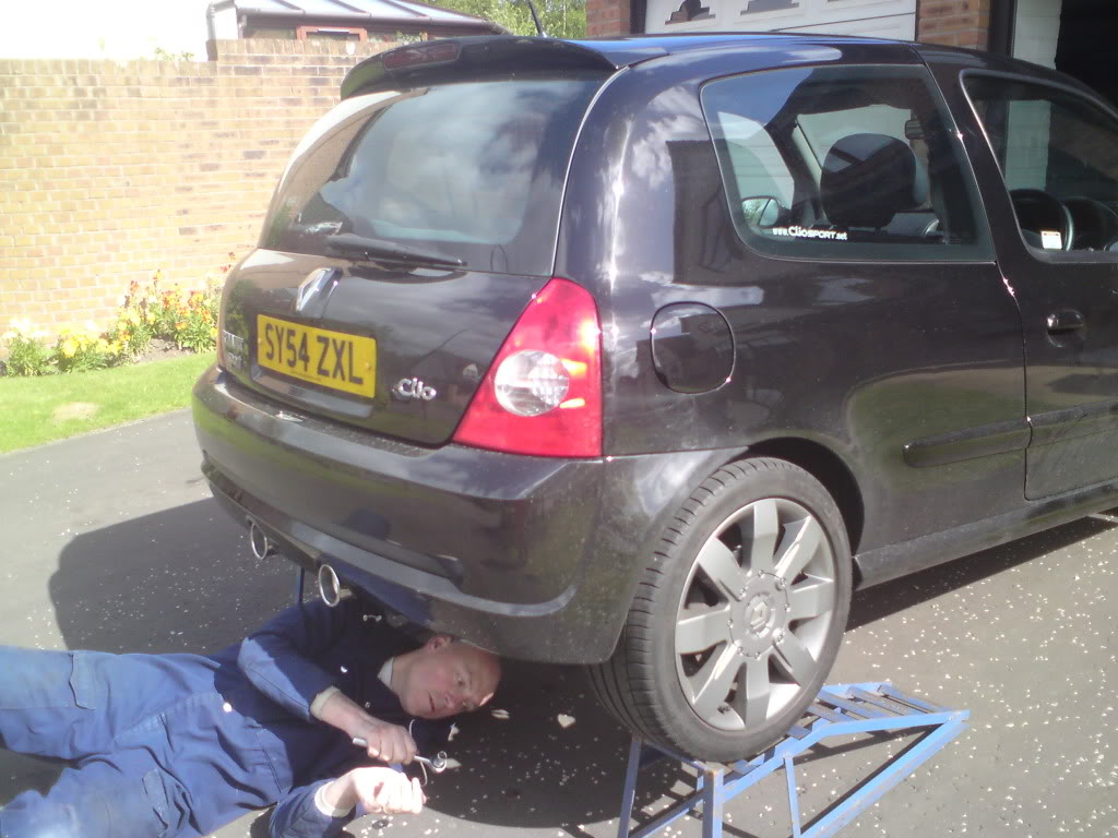

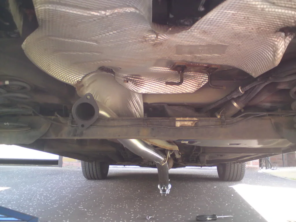

Fitting begins (note the yozza fits around the rear axle)

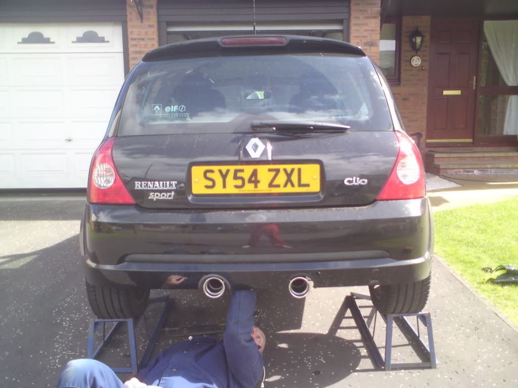

My very own personal mechanic (otherwise known as dad) lining up the backbox after installing the new rear exhaust mounts including some nice new stainless steel spacers and a once over of everything with some silicone grease

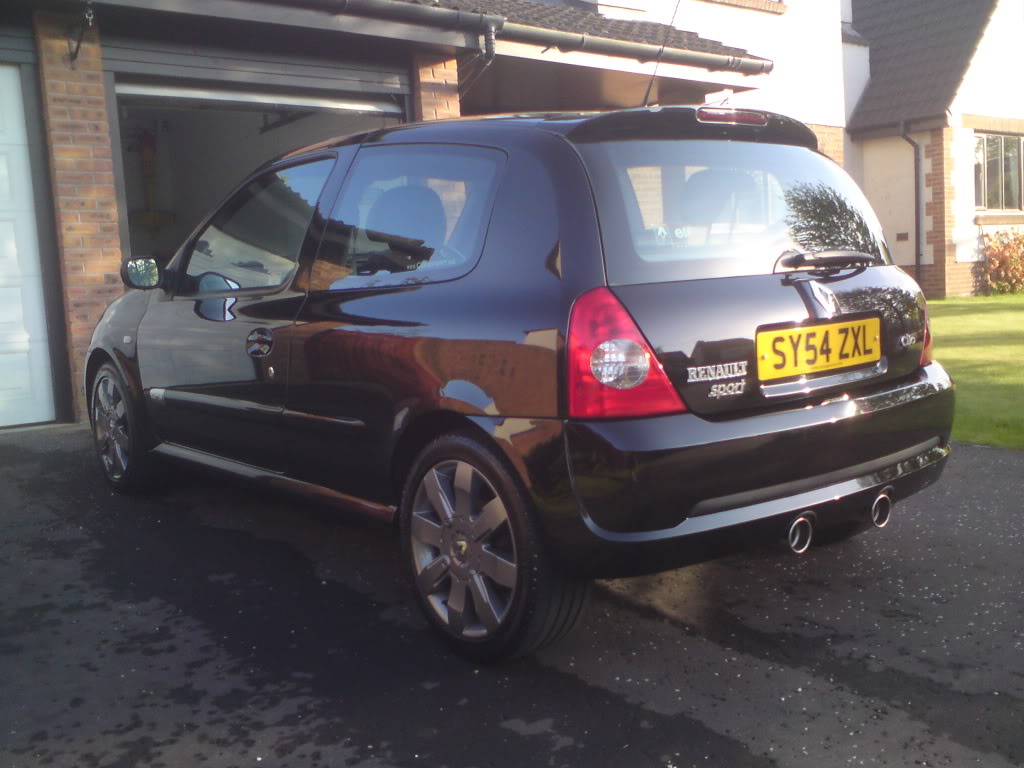

The final result :approve:
Was going to take a video for those who have not yet had theirs delivered but believe me...no video can give you a true idea of just how LOUD it is!!! As Clayton says, it does have its chav appeal (especially when you first take the car for a spin) but i seem to be getting used to it now and the noise is 100% unobtrusive on motorways whilst making a good noise around town when you're below the 3k mark!:race:

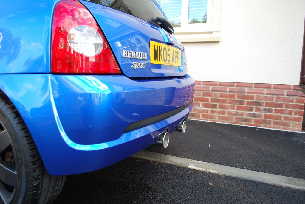

nick, not sure as cant see the final result but third pic from last looks like the exhaust is almost in the bumper!?
mine's about an inch out, perfect imo

looks good mine sticks out a little more, also mine didnt come with a new coupler (no idea if thats what it is called?!!) to join the centre section to the cat. just used the old rusty one with some wd40 :)

Love that colour! Ye, the left one was further in than the right at that point but after moving things about they're now even. However, they are still both about 1/2 an inch out from the bumper where as I would have preferred them out a bit further...still, you can only do what you can only do!
  Lionel Richie
need to adjust the engine mounts, cars with hooky engine mounts end up with the tailpipes sitting further under the bumper, its no biggie
  Yozza'd BG
mine are from renault so hope they're not hooky. they've been adjusted back and forth and it makes very little difference.
