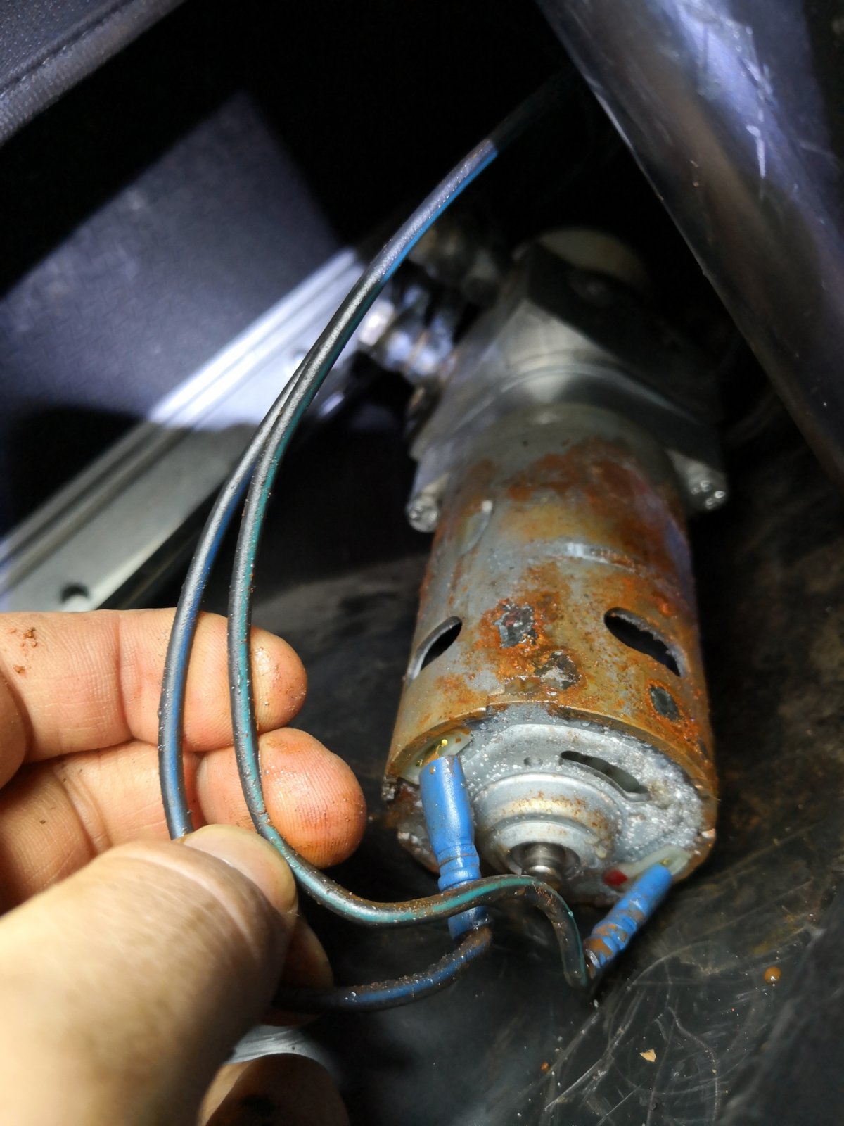

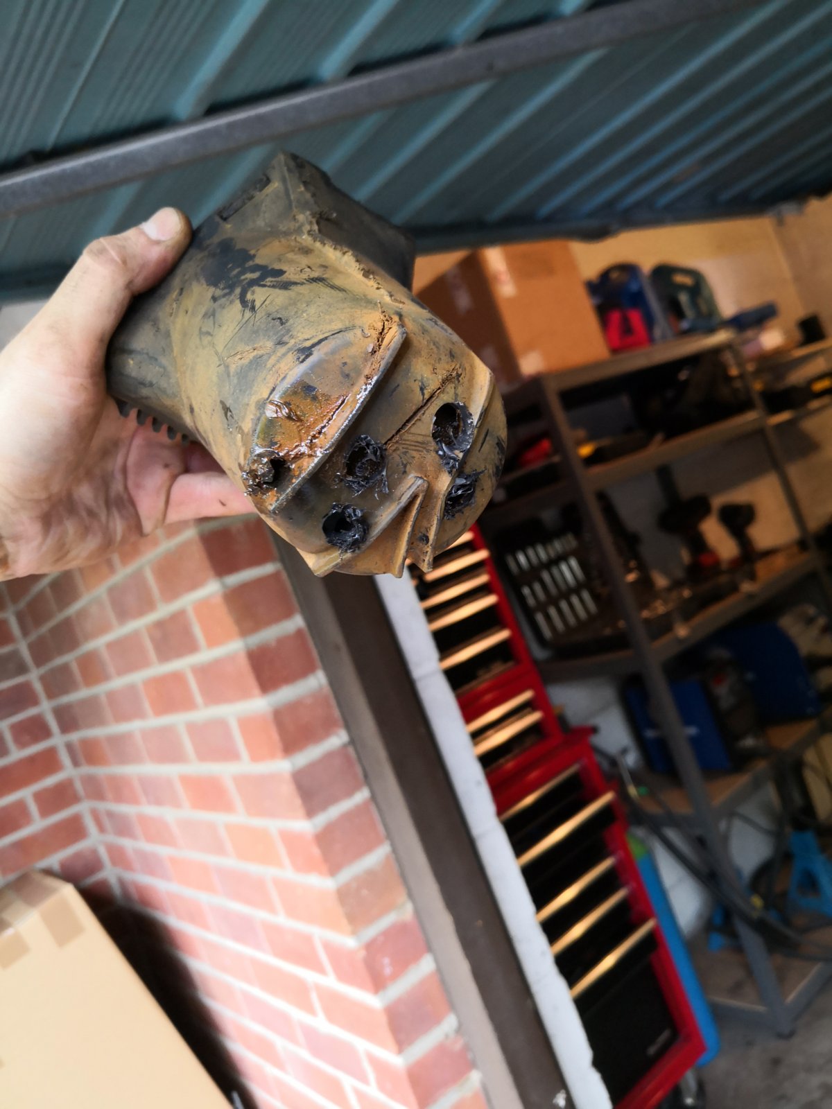

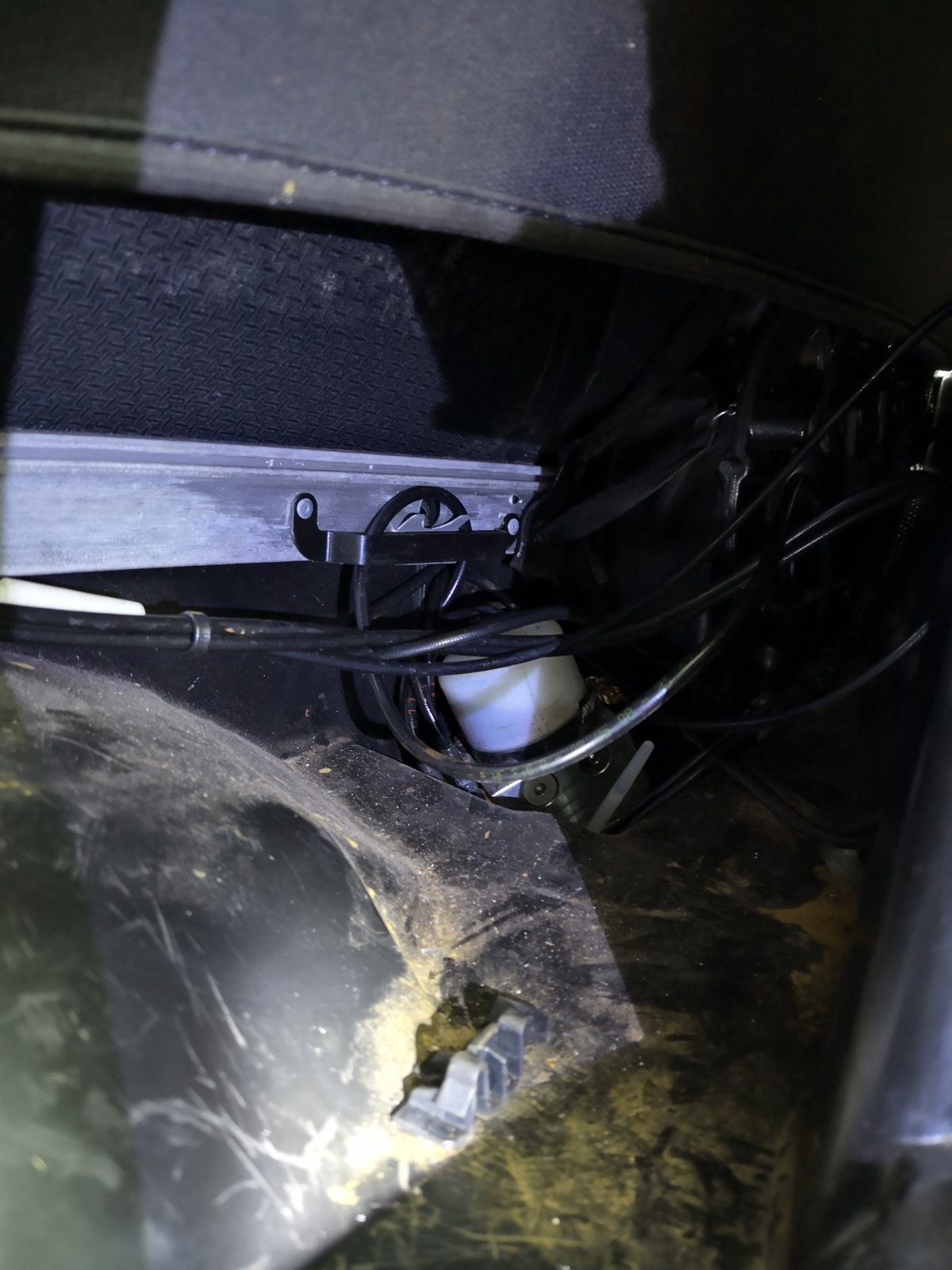

Then today I tackled moving the roof motor into the boot, and to my surprise it had already had someone doing.... Something to it.
I'll give some background, basically thr roof motor is housed in a plastic container that is in the sill, water is meant to pass over this however overtime the sills fill up with water due to blocked drainage holes and the seals in the housing give way.
So a typical intrusive mod is to move the roof motor to the boot.
I got quite far and saw that someone had already taken the motor out of its housing at the top but it was still in there someone had just drilled holes in the bottom to allow it to drain but..... If the drainage holes further down are blocked it's just going to fill up anyway as I found out.... Anyway here it was and now it's in the boot

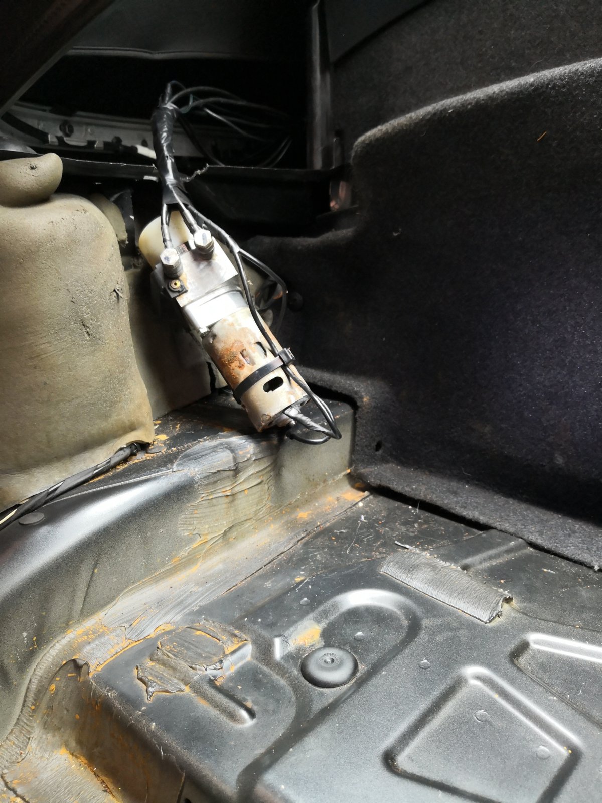

I'll go take a pic of how it's stored now... You can just about see two wires sticking out but that's it really.
Overall I'm still loving the car, it's the perfect daily. Has just enough power, rwd and can bring the roof down whenever I want.

How easy did you find it to do? I want to tackle it too but according to the z4 forum it’s a very difficult job?
dann2707
In all fairness it took about an hour in total, that was trying to understand a guide for the first time and what parts it was referring to.
Apparently the hardest bit is removing the cable ties around the motor which luckily mine had already been snipped. I reckon some long needle nose pliers would sort it. If you're around Derby I'd be willing to help
dann2707
I downloaded a pdf for it. Drop me a pm with your number and I'll WhatsApp you it @Cribert

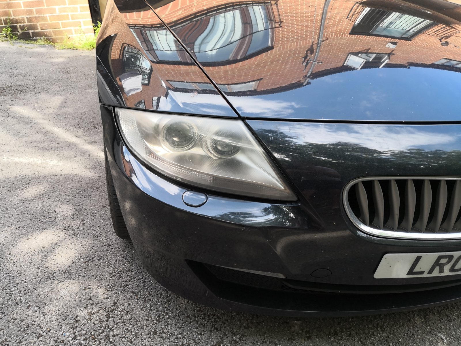

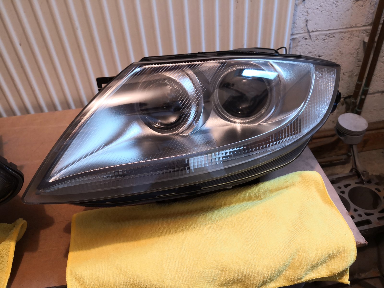

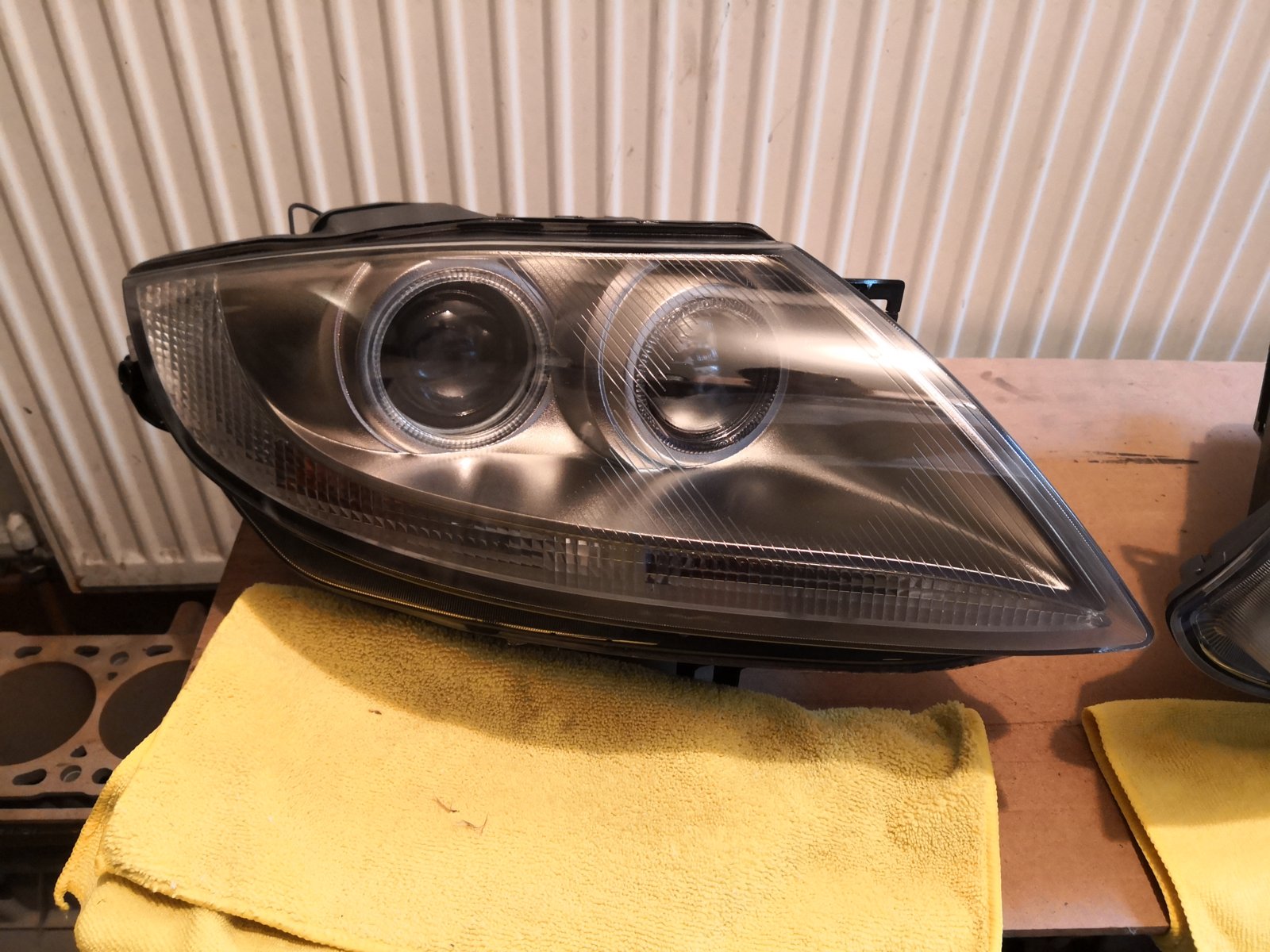

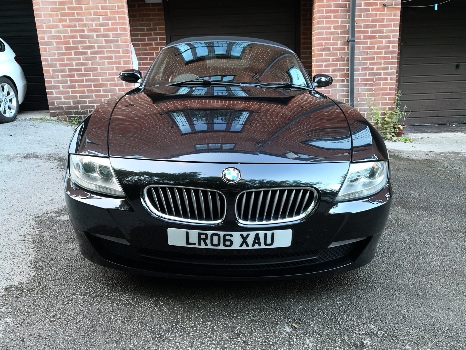

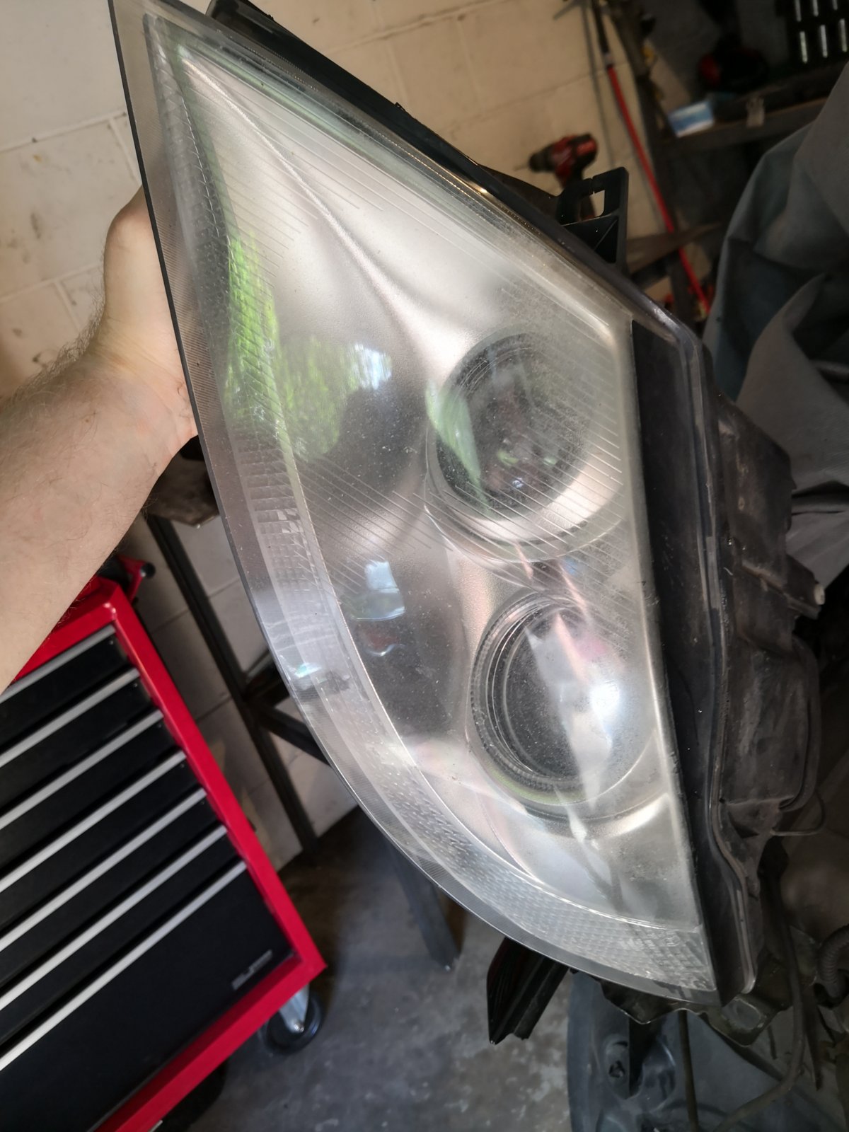

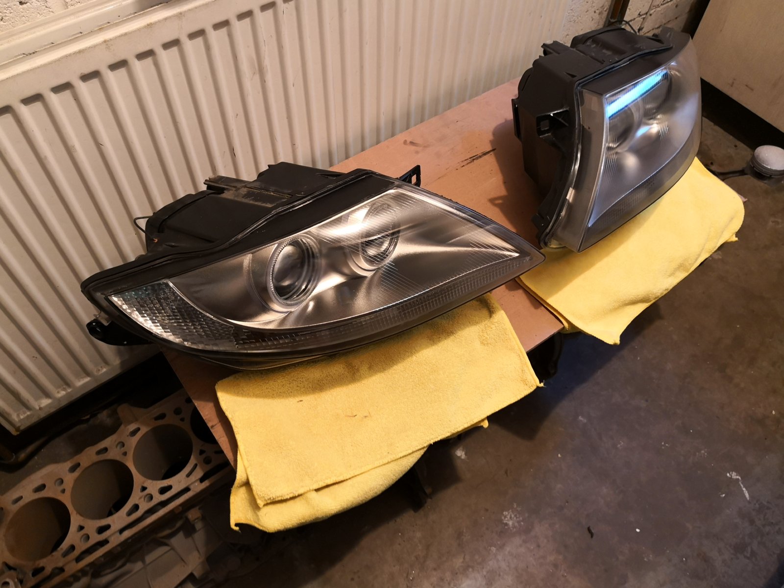

Today I polished and lacquered the headlights.
Most times people do this they always say I could have done a better job but I am well happy with how they've turned out. They were super minging.
Just drying now ready for a final polish of the lacquer tomorrow if it needs it.
Before :
Afters :
I've sprayed it with some etech headlight protection lacquer so hopefully it won't come back anytime soon.

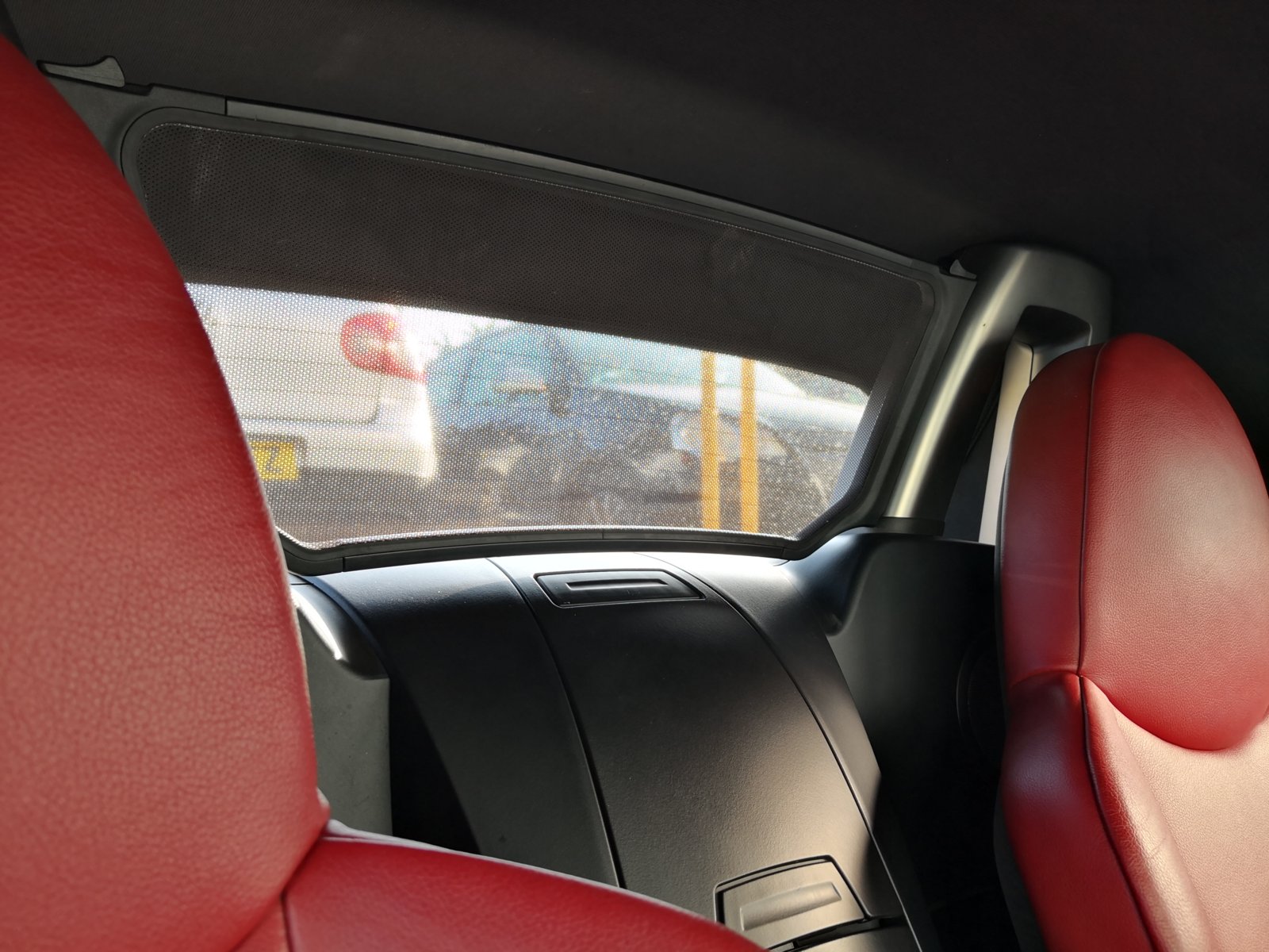

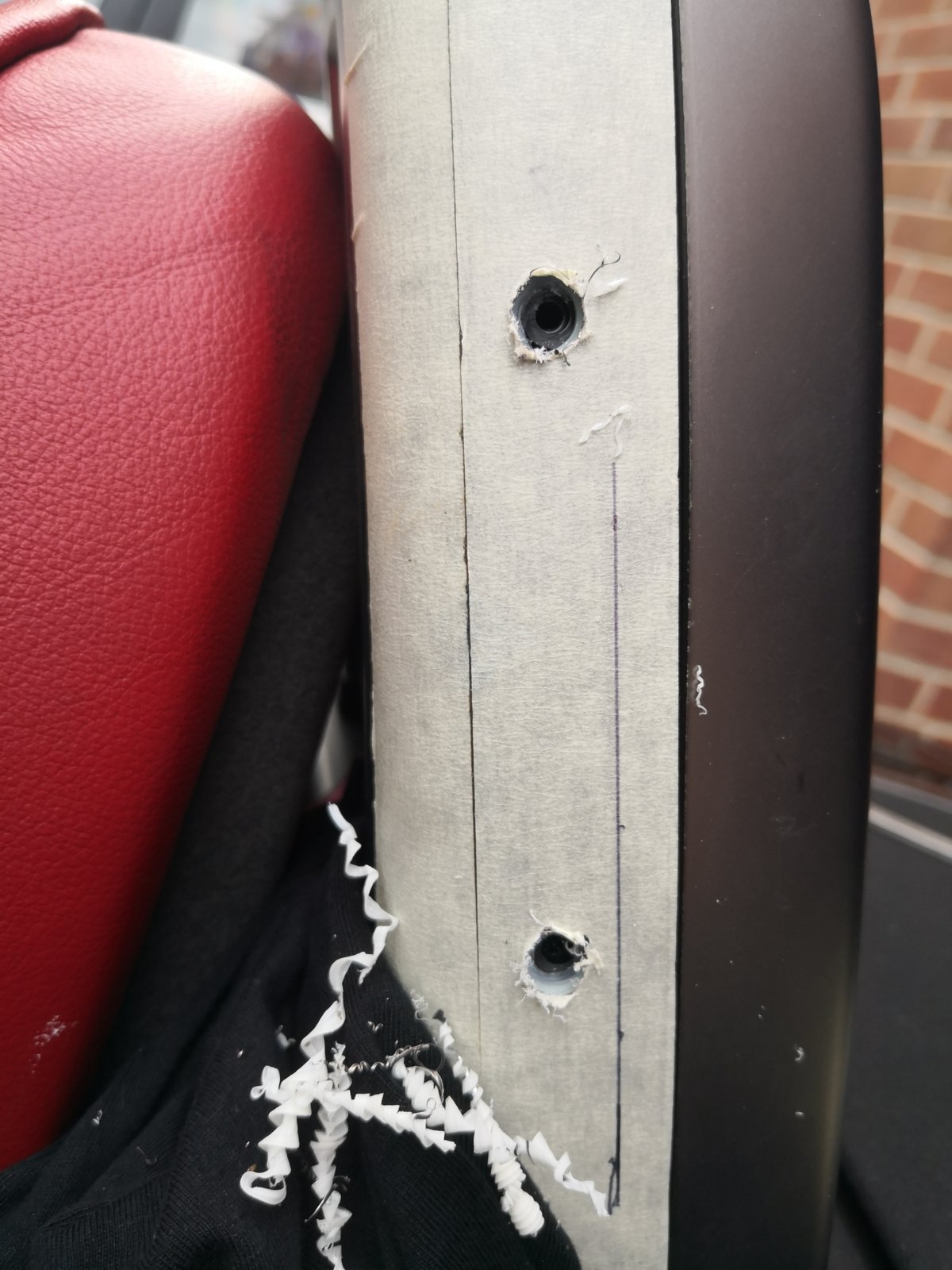

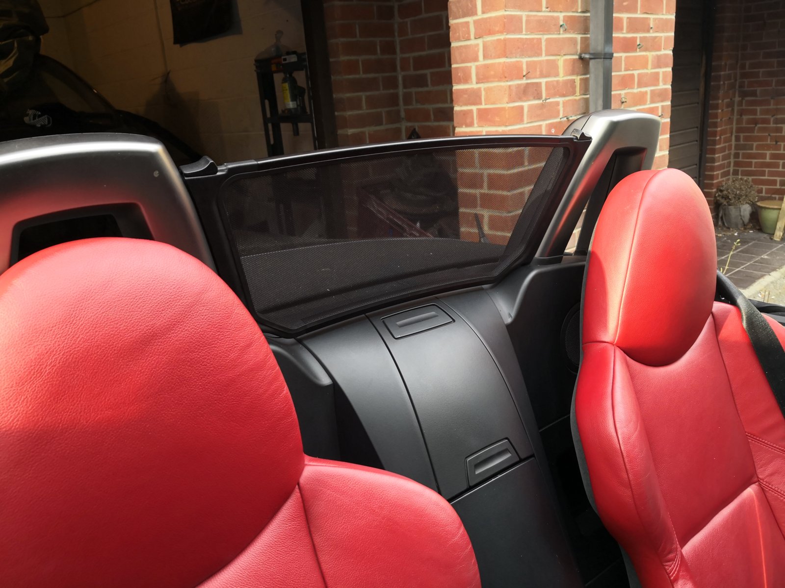

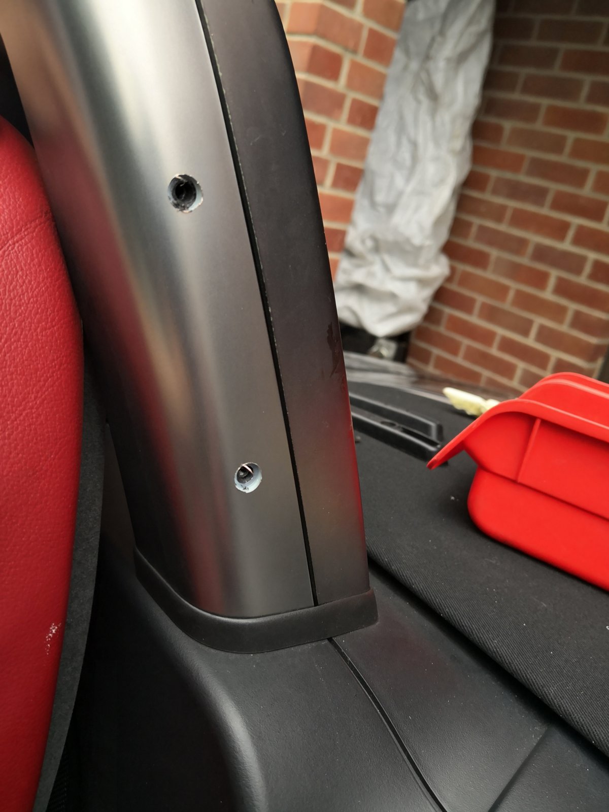

Fitted a stupidly expensive for what it is bmw wind deflector tonight. Was a bit touch and go lining up the holes just by measuring and drilling through but it worked well and the holes behind the headrests were pretty much spot on as to where I was hoping.
Fitted and yet to try it but I love the look of it already.
dann2707
Well f**k me in the rojer and call me Kevin thst works so f**king well. Could have a normal volume conversation with myself at 80 without shouting. I could tell it instantly worked because I didn't have to increase the music volume when at speed.
Definitely not worth the rrp as it is literally a mosquito net and some trim but I'm happy!
Think it looks cool too
