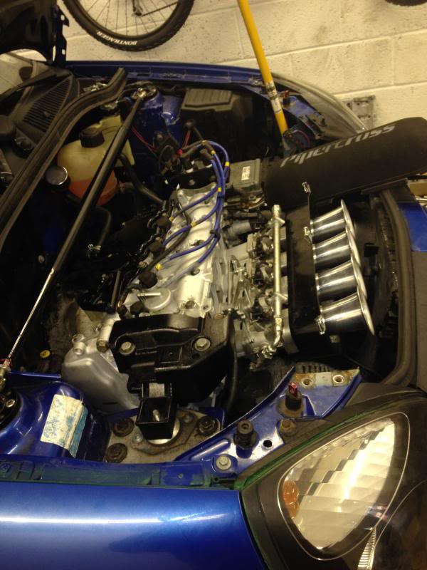

The DTH with 90's is longer than SF with 120's. They also angle upwards a fair bit more than SF's.
I cut my bonnet because it pressed on the filter and I thought that would restrict air flow - plus it's a track car so I don't give a feck.
Why are you so sure DTH with 90's will fit when A) they are longer than the SF setup I have and B) they sit higher than the SF setup I have.

They don't match the port angle in the head - they angle upwards presumably for clearance over air-con and other standard gubbins.
Then if you add an angled spacer down you're effectively creating two sharp angles in the inlet path.
If you open the butterflies on my setup and look down it - it's a perfectly straight path from trumpet to valve.
I am by no means an expert in air flow - but I'd say that's more optimum than two bends.

Let's apply some of that common sense you're fond of. 120s on DTH fits if you cut the bonnets inner skin, yet you think 90s won't fit? Need me to draw a diagram so you can play join the dots? Here I'll help.......wait for it......90s fit
And no one would describe a 22.5deg bend as sharp.

Bumping this back up as I have just refitted my engine and have fitted some 120mm trumpets , along with jenvey 20mm spacers between the bodies and airbox backing plate giving 140mm inlet.
I can get the bonnet shut but the filter is just touching so going to cut the inner skin out and may drill 4 holes in the bonnet to force more air to the filter aswell.

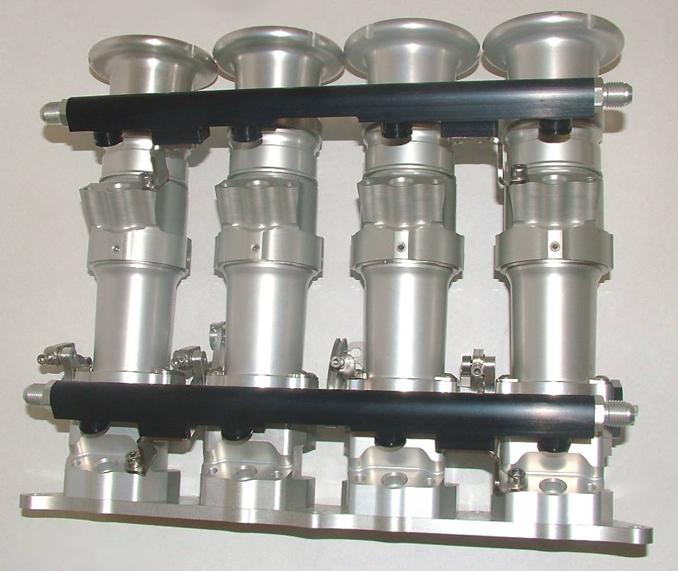

Indeed, for midrange torque if you have too much diameter on the bodies, it will lose you torque by dropping gas speed.
Is this why the At-Power bodies can be shorter? Smaller diameters (or equivalent oval area) can be used due to being shaftless butterflies.
With oval port sized bodies, the gas speed will be kept up, hence allowing a shorter overall package (body, extensions, trumpets)...
Too short, or a good compromise?
  Cup In bits
Theres not only the trumpet size to think of with the at power kit but also the injector position (being right next to the valve mouth) that affects things.
Im pissed out my dick currently and will let Chipapedia explain the intricacies.
  182cup & 172 racecar
Mine haven't been tried yet (new AT design for RS133) so I'm not sure how well they will compare if another company were to make a set. I know the injectors are close to the head, but that's exactly the same distance from the head as the original inlet manifold, with the injectors firing at the back of the valves.
Hopefully Paul will get it up and running early in the new year.

Seems a bit of a contradiction :S
Not really, they do the job fine (i.e having ITB's) but they are not the best on a high power build (circa 220 up)
They would need staged injectors to have a half decent torque figure as they struggle to make torque from all the graphs I have seen.
  Cup In bits
You got any of the graphs for me to look at Morgan as it’s an area i’m looking at atm?
AT do staged injector setups
Nothing to hand James although the AT setup is known for lower torque figures on most cars just by their design. Yours and Tonys would be good ones to compare against a Jenvey graph.
The AT stuff is the best to look at definitely, I really like the look of that pictured setup, saves having to do custom bracketry for the 2nd rail etc and having the wiring loom inside the airbox. It does look REALLY long though.
Injector being so close causes issues with high rpm usage as the fuel doesnt have long enough to mix with the air properly before it enters the chamber.
