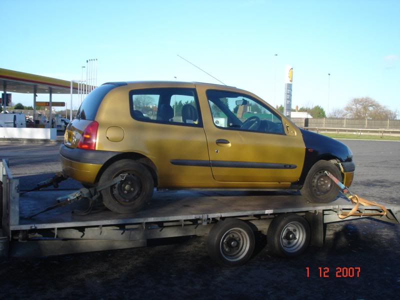

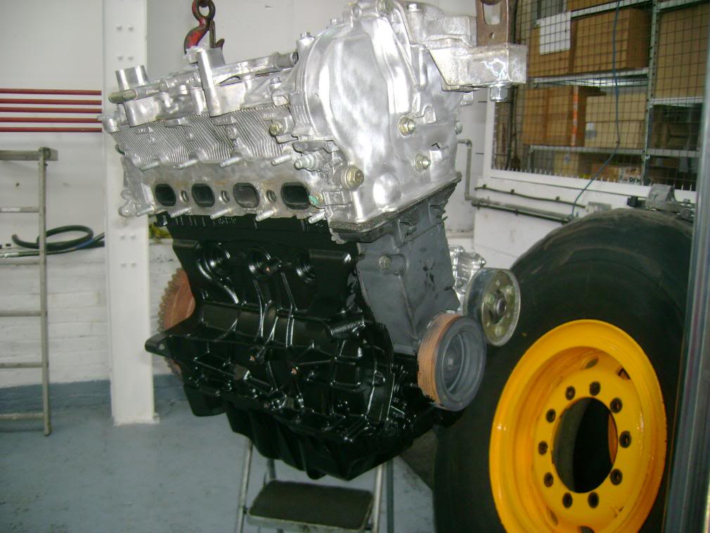

After finishing my replica i felt that the only way to go was to fit the real thing, the 2.0ltr from a 172. This led me to purchasing this beauty:

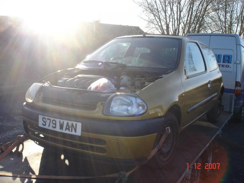

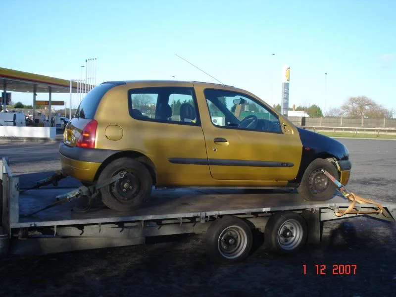

Failed conversion with a Clio cup engine which has only covered 16k miles.
After looking at all the things i had to change i decided against the conversion and when this came up for sale:

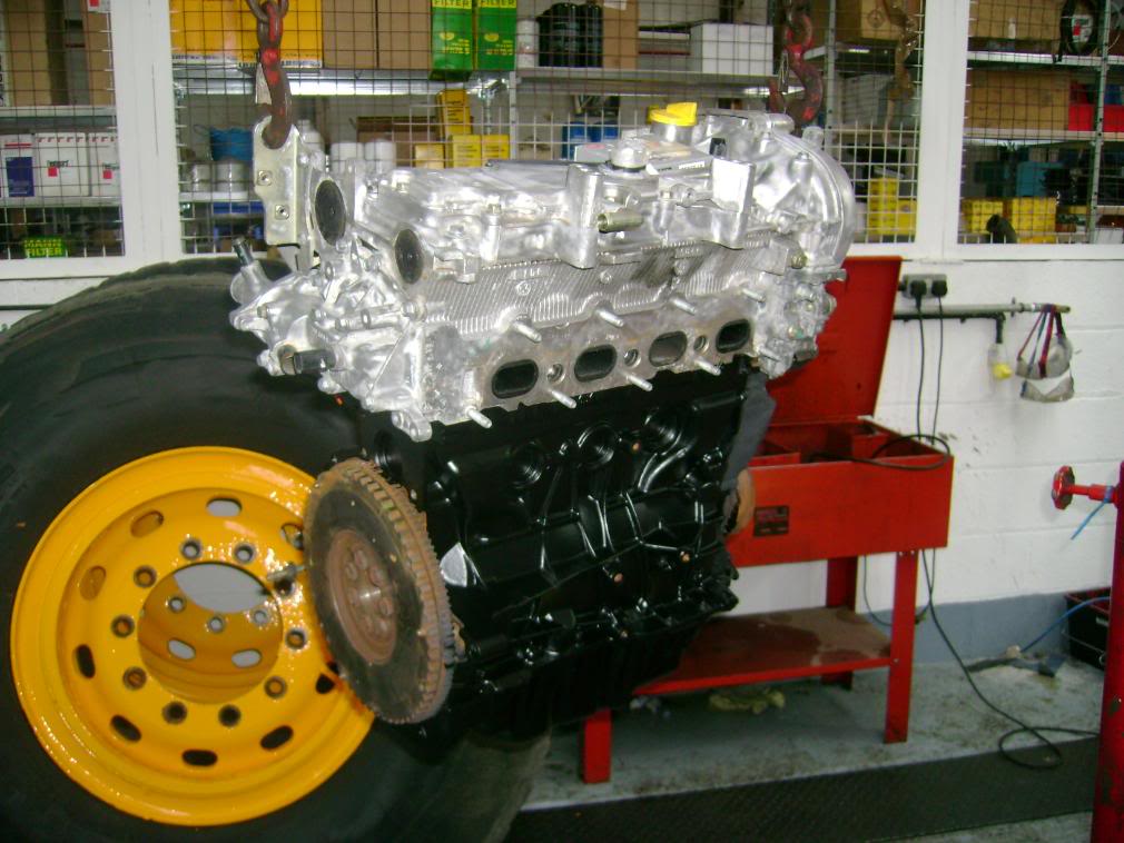

Current Engine has covered 54k and the one that came with the gold car came from a 53 plate Cup with 16k miles on it. The cup engine was a little grubby so gave it a clean and painted it black.

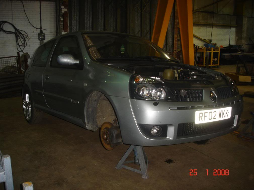

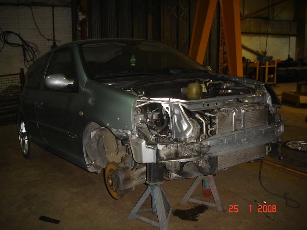

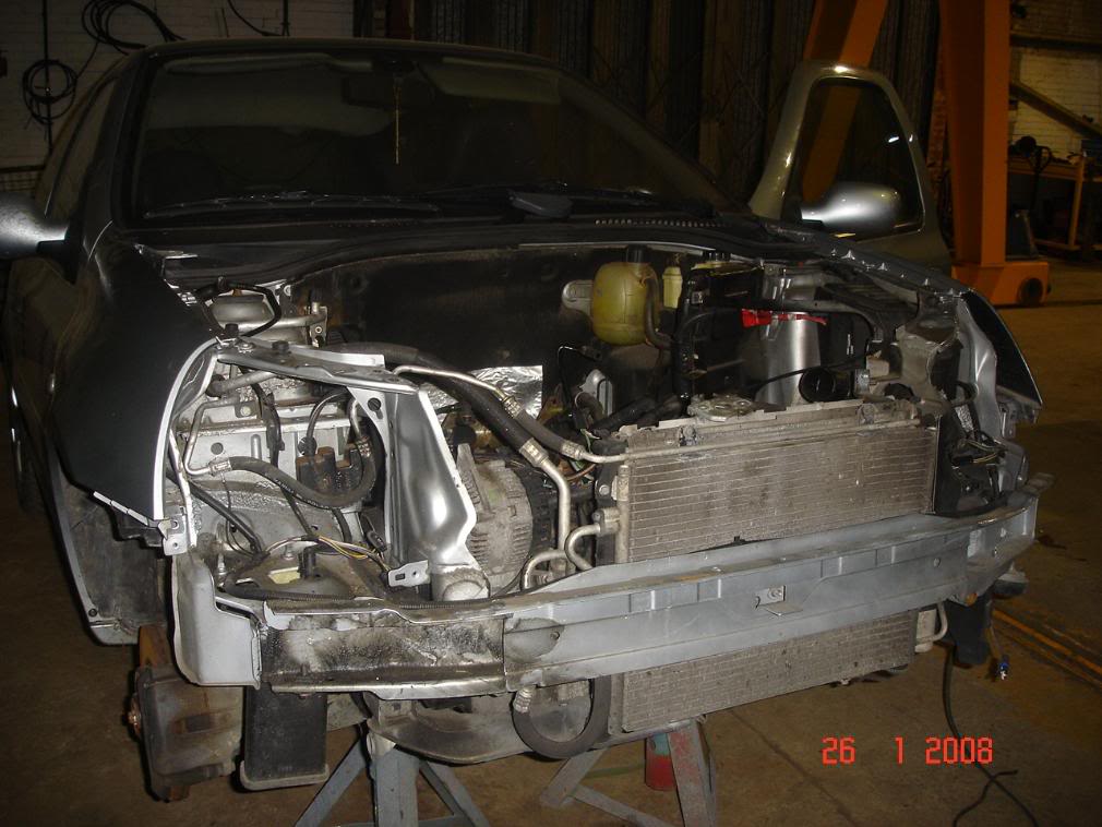

Day 1: Friday 26th Jan 2008

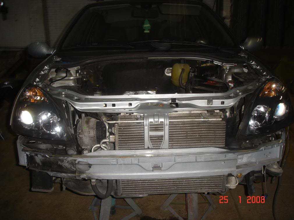

Bonnet Removed
Front bumper removed
Xenons Removed
All ready for the early start on saturday.

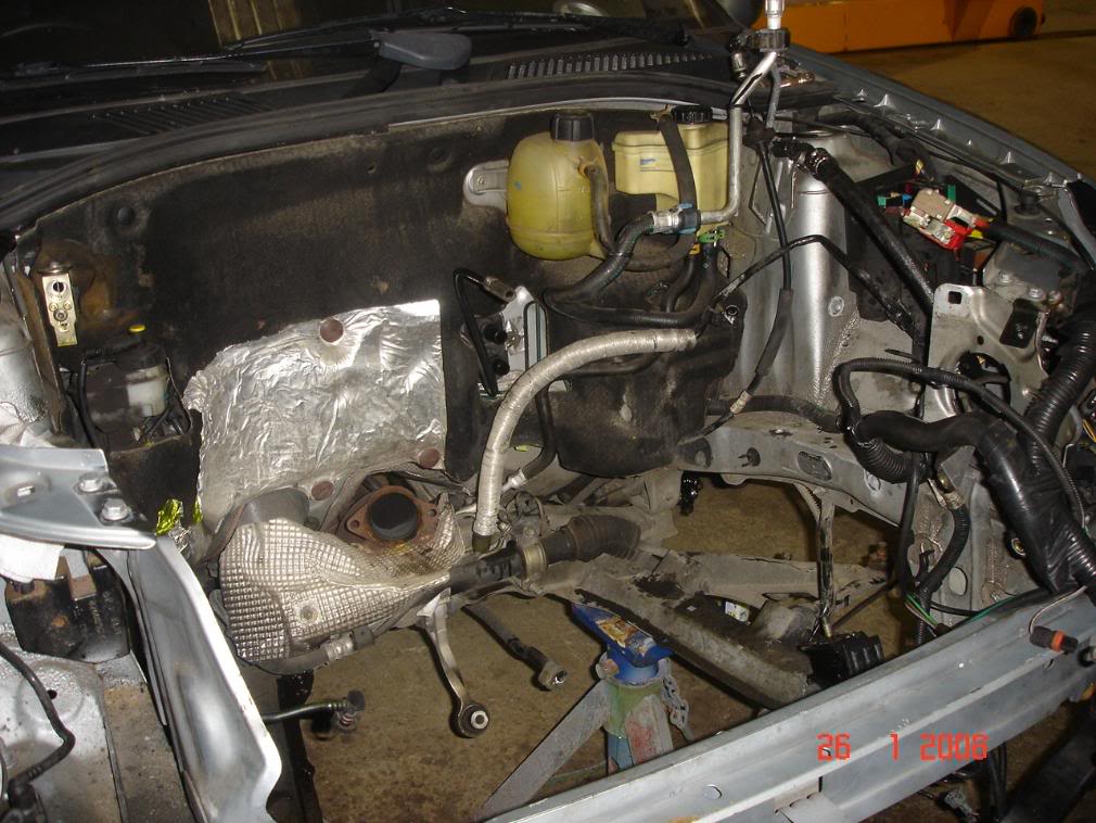

Day 2: Saturday 27th Jan 2008

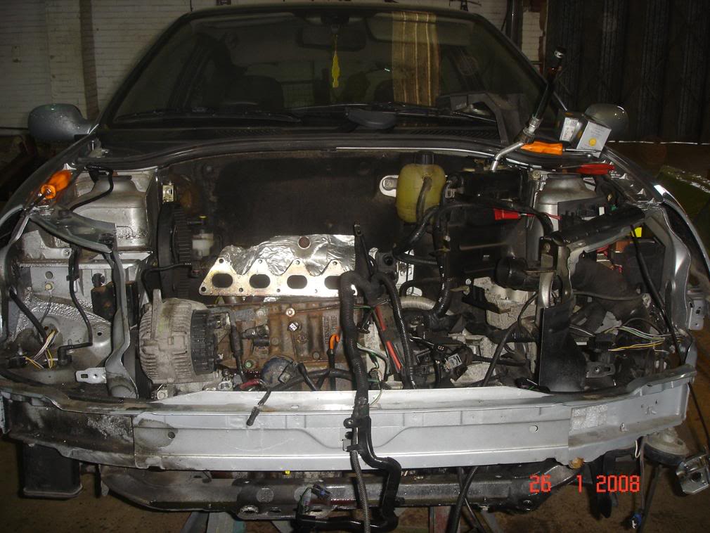

How the day started (7am)

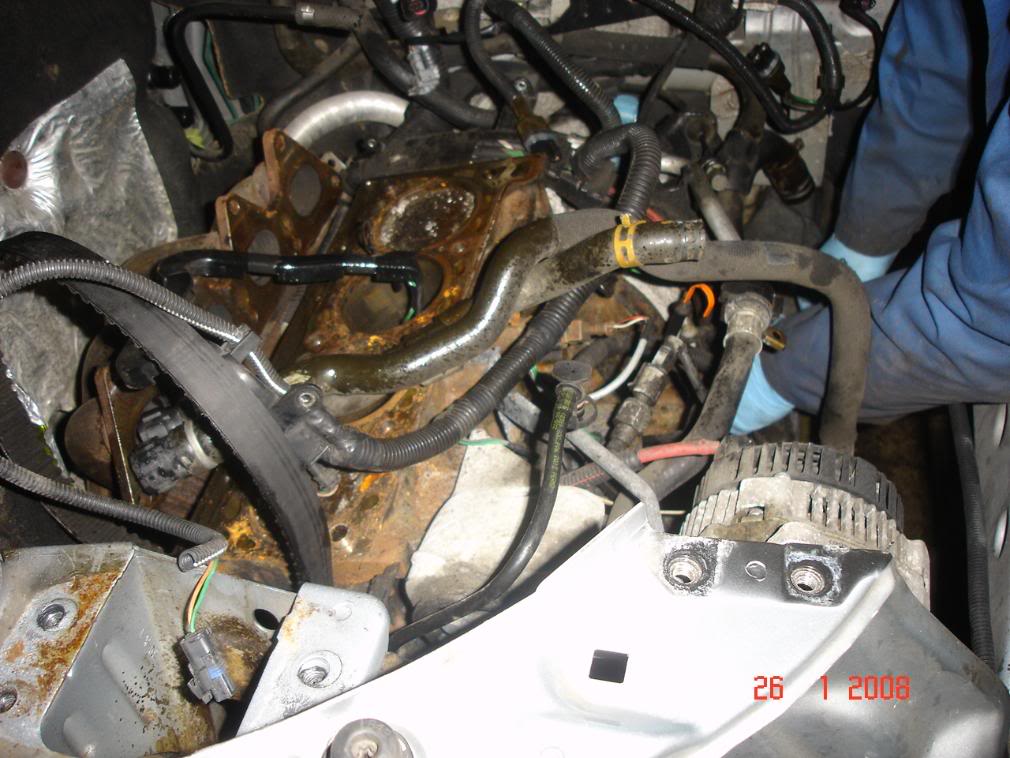

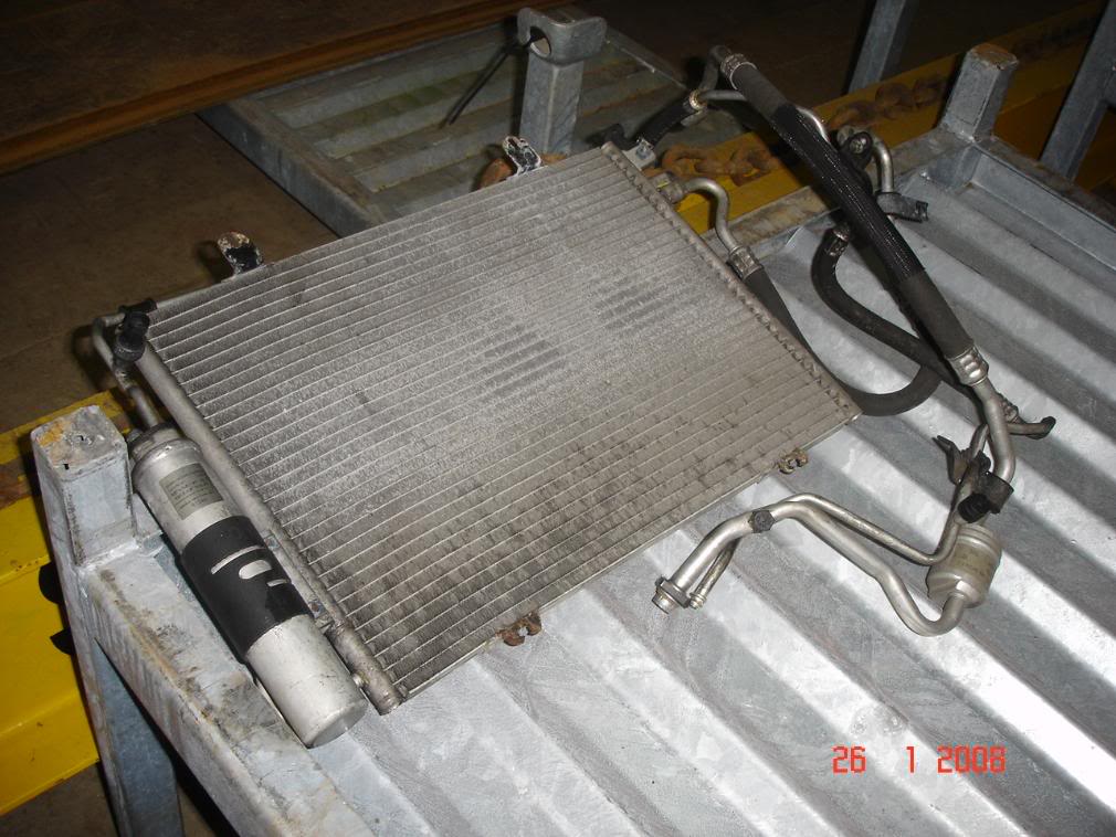

Drained and removed the aircon and the piping to make room to remove engine
With the aircon removed now was time to remove water piping and to move the loom + ecu to one side of the bay. Took quite some time due to the mass amount of sensors and electronics.
Remove Manifold + Lamba Sensors

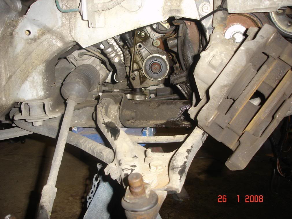

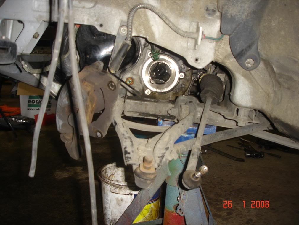

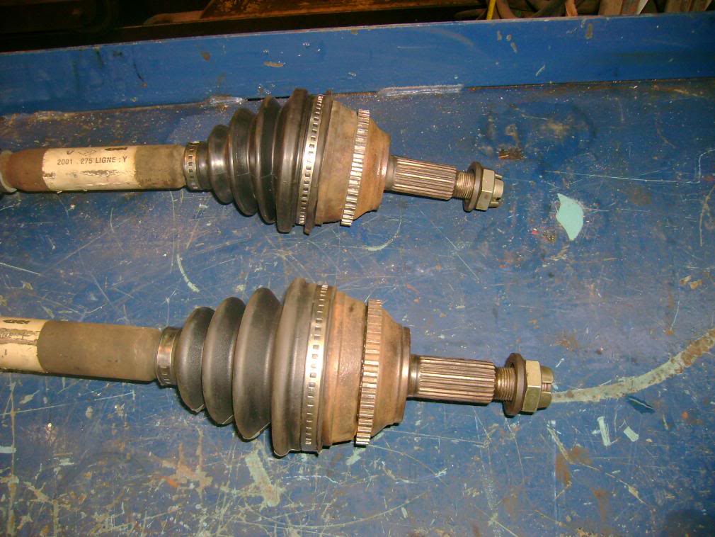

Removed Hubs, Driveshafts
Passenger Side
drivers side

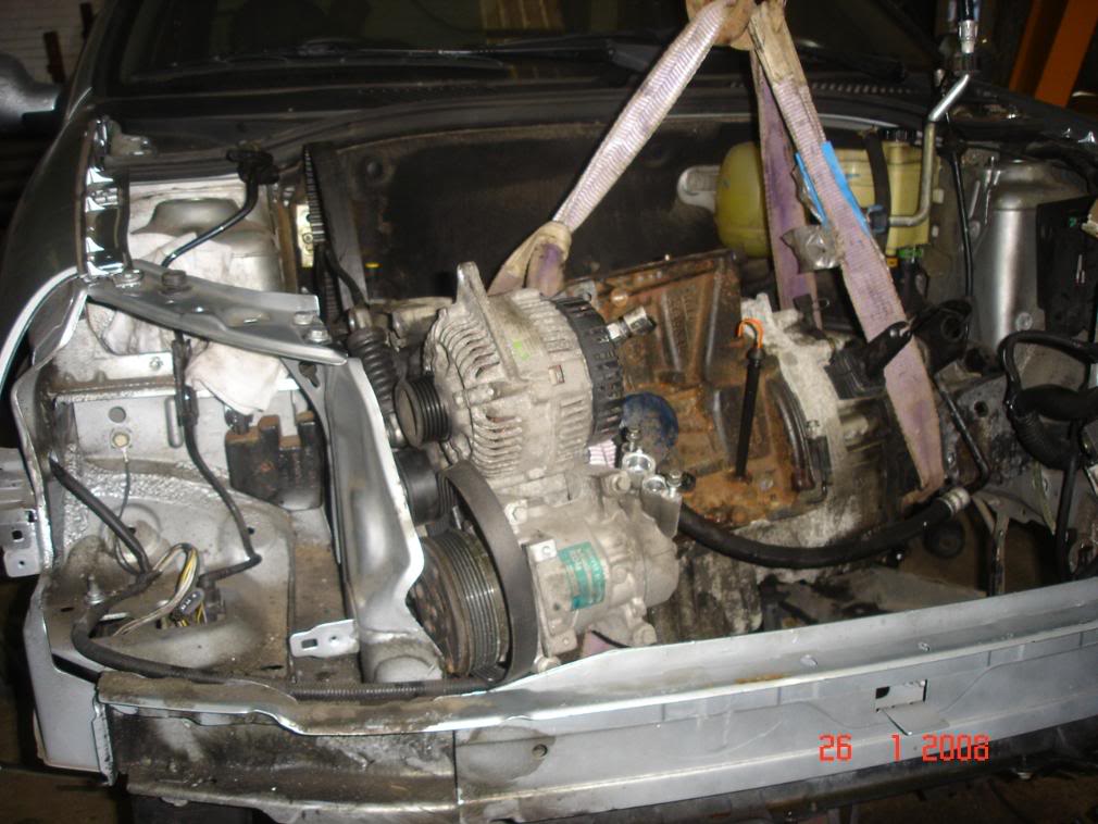

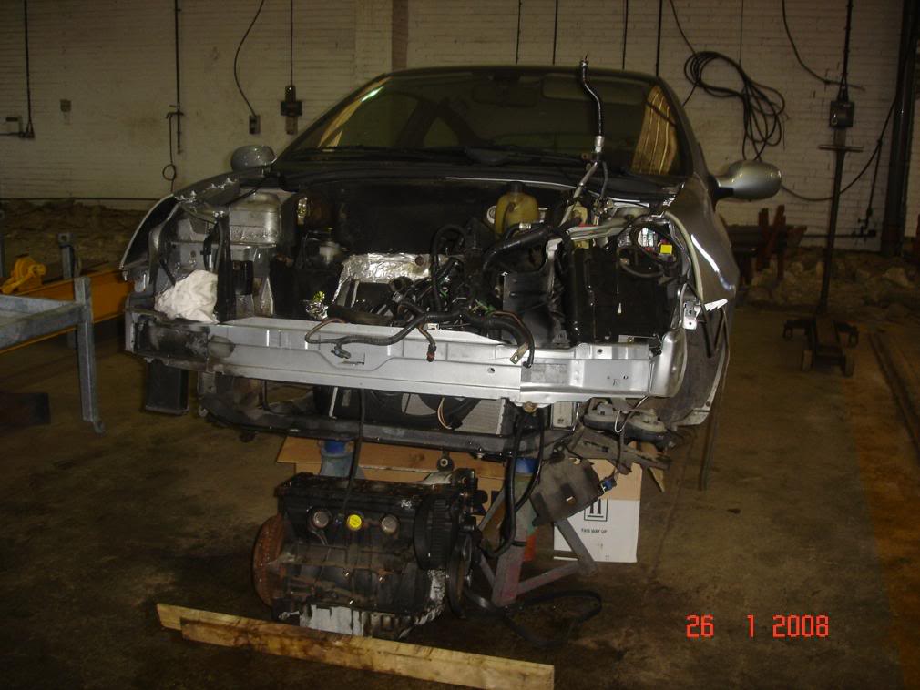

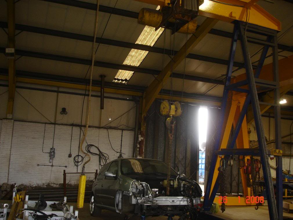

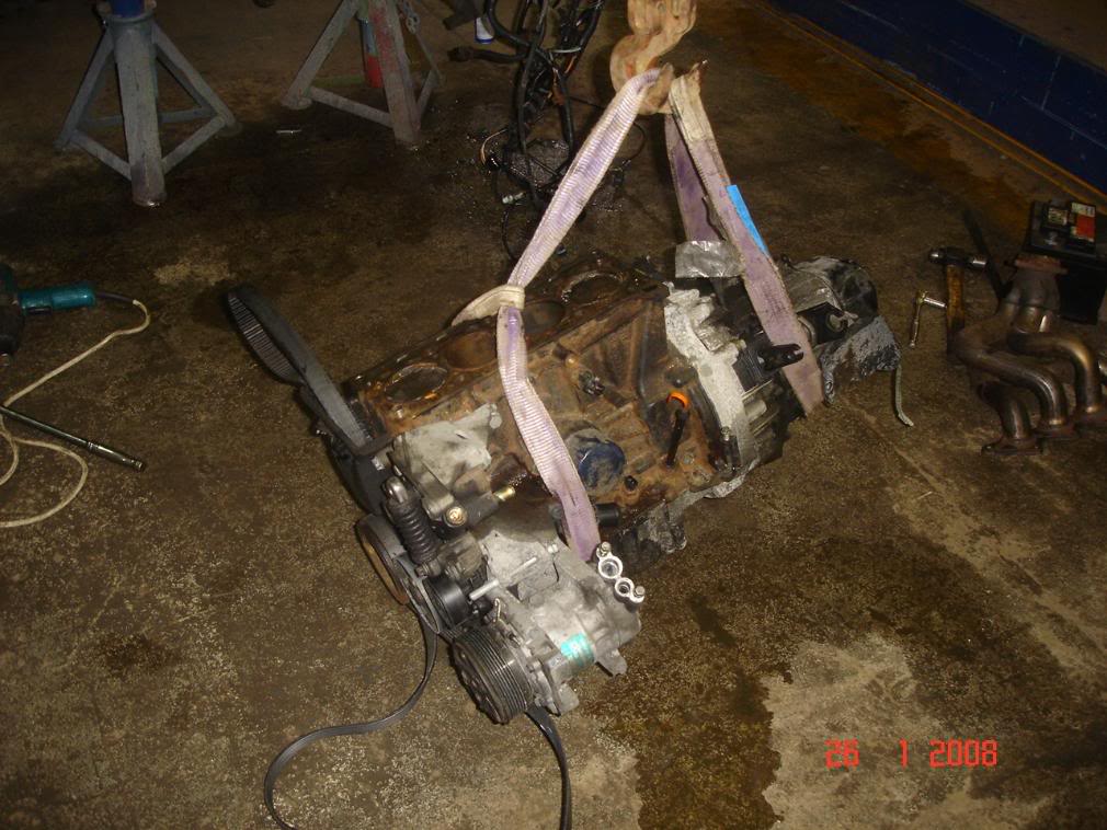

With everything removed from the engine it was time to remove it! hurray!
All strapped up
Big Crane ready
Half way out
And its out!
All ready and prep'd for next weekend, will be cleaning the bay before new engine is fitted

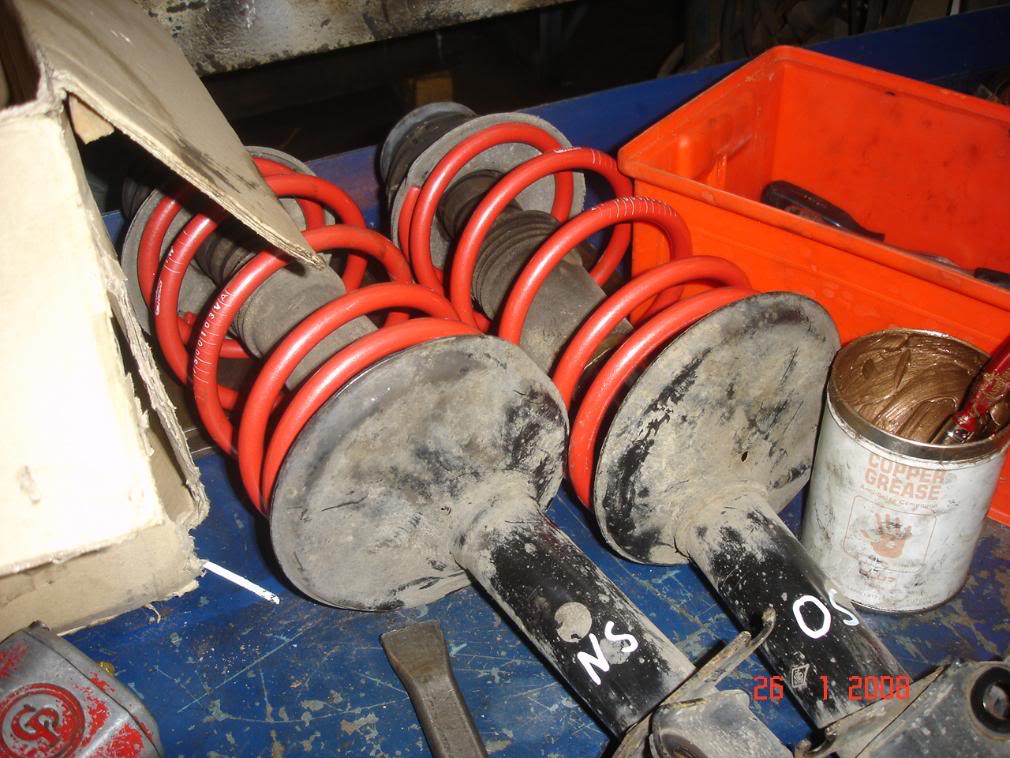

Old bearingss removed, waiting for new ones

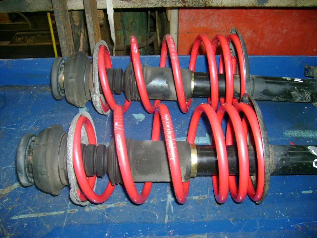

Sportlines fitted (yes the strusts do need a clean lol)

whats happening witht the other engine (the one from the gold car)

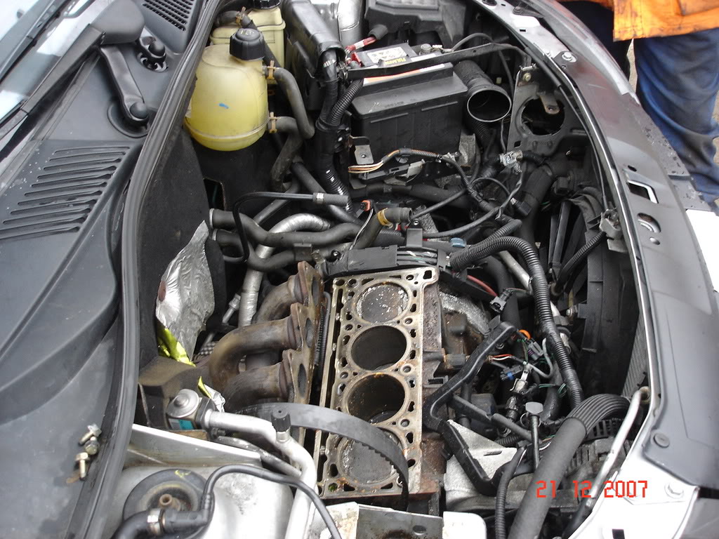

Engine from the gold car (cup 172 engine) is going in the silver one. The engine from the silver one must have slipped a couple of teeth on cam belt as it has bent some valves and put a dent into one of the pistons. Will be selling parts of the silver engine as spares though if anyone is interested :)

A
ashy_gtt
where do you people find these 172's with fecked engines? been on the lookout for one for ages :(
good project tho :)
good project tho :)
lol :D this one came from ebay actually, problem it was in High Wycombe tho. only 4.5 hours from Co Durham :(

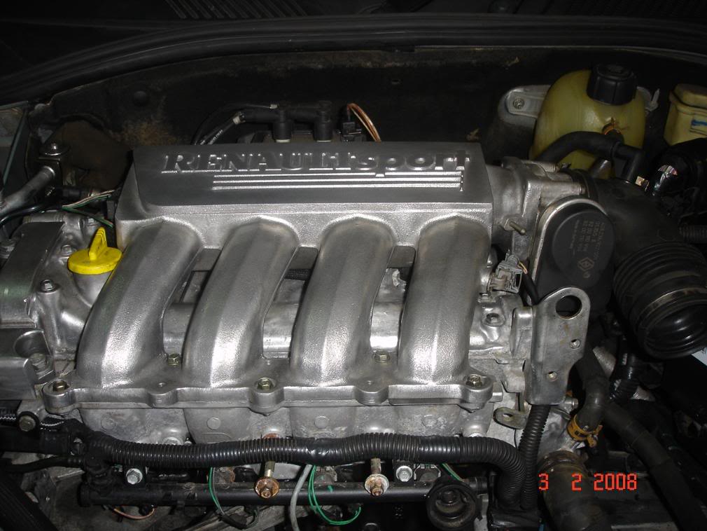

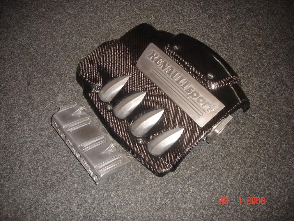

Tuesday 29th January : UPDATE
Not much to update on but thought i would add a couple more pics.

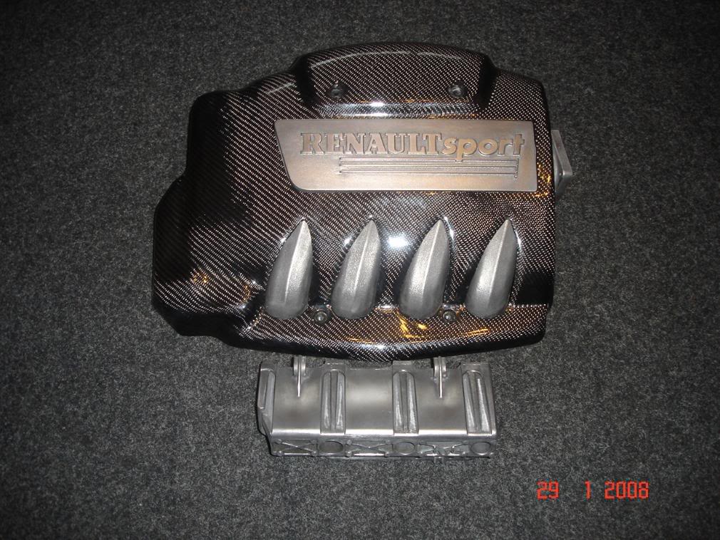

a sexy looking inlet manifold, fuel rail guard and engine cover ;)

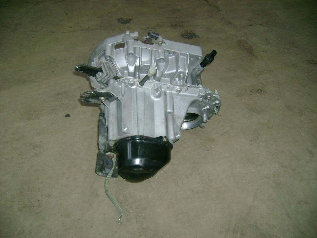

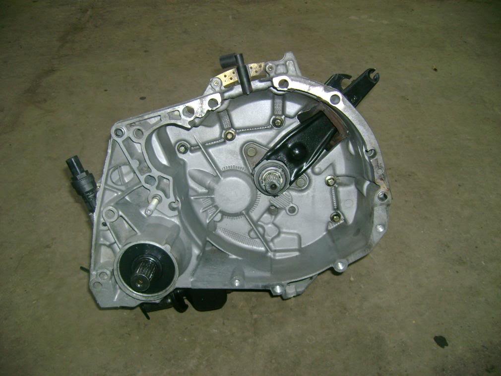

Also sent away the gearbox to get checked over and refurb'd. Ordered a new alternator and new gaskets.

- Reconditioned Gearbox (looks new :O)

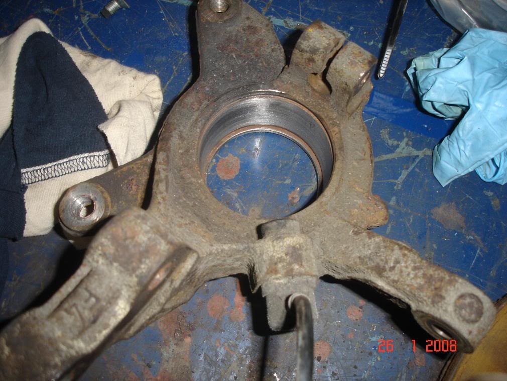

- Replaced bearings in hubs and sprayed them black

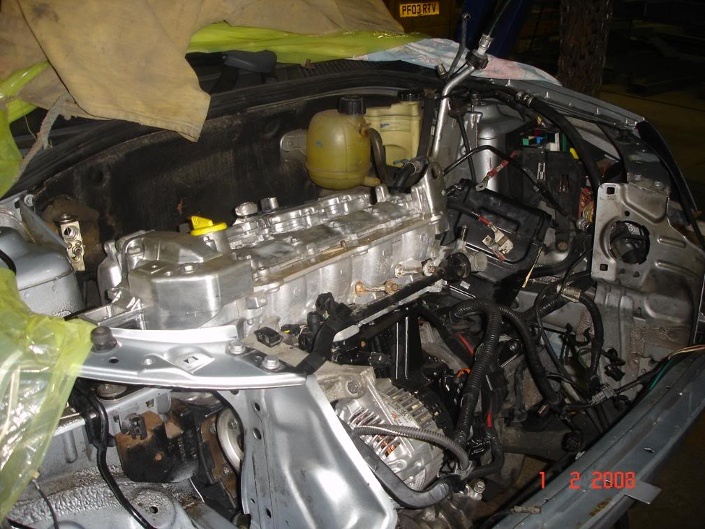

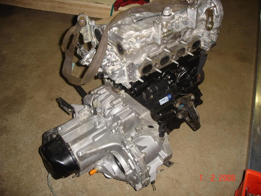

Good start to the weekend though, got the engine fitted and fitted all the new engine mounts. Will be plugging it all in tomorrow with water hoses and sensors etc.
Here some pics so far :)
:D:D:D:D:D
will post more pics tomorrow of the progress, fingers crossed it should be running! :approve:

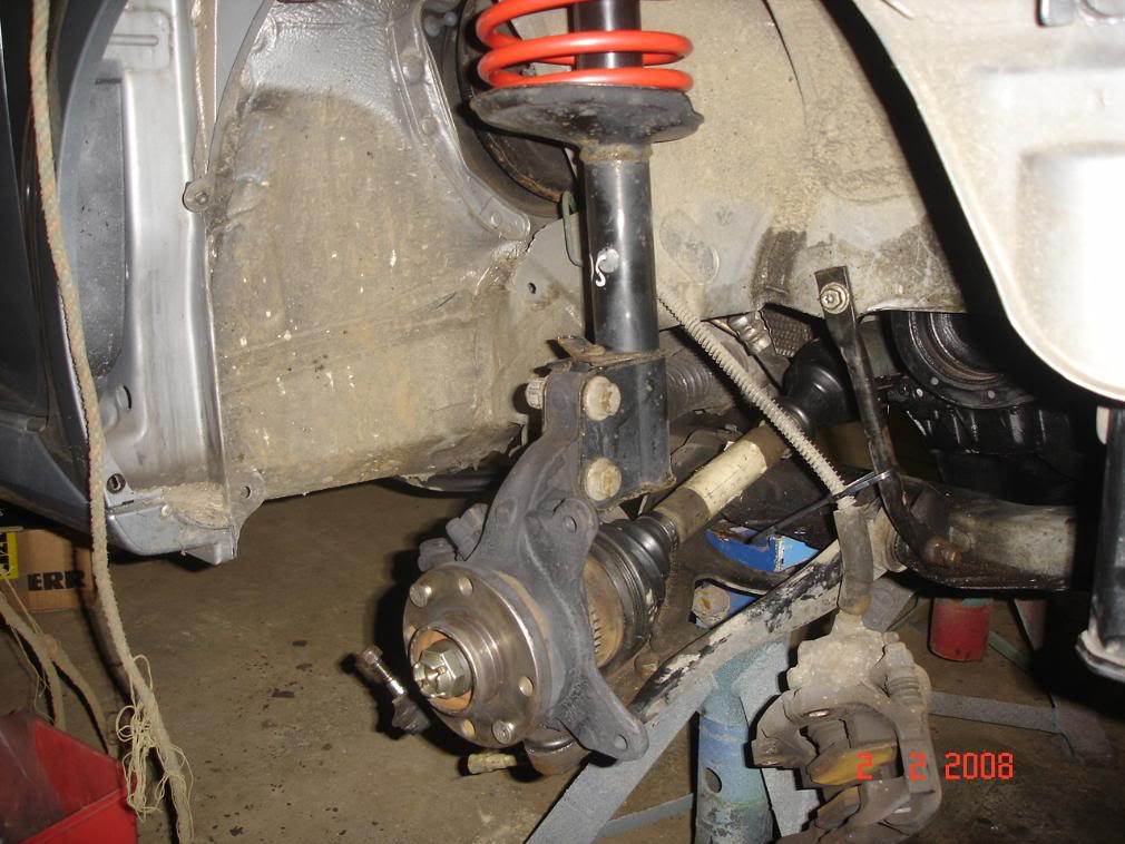

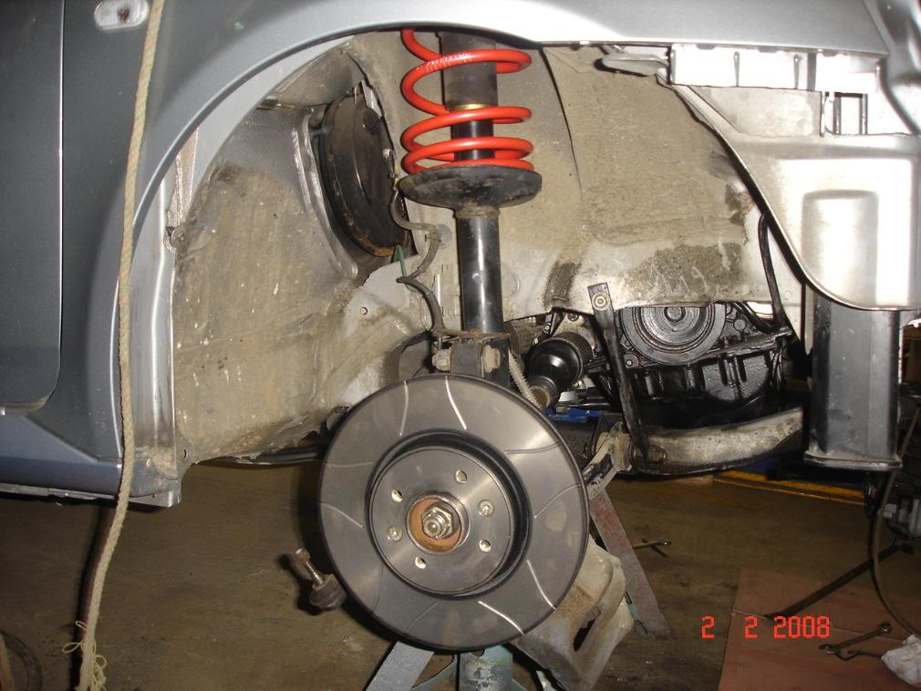

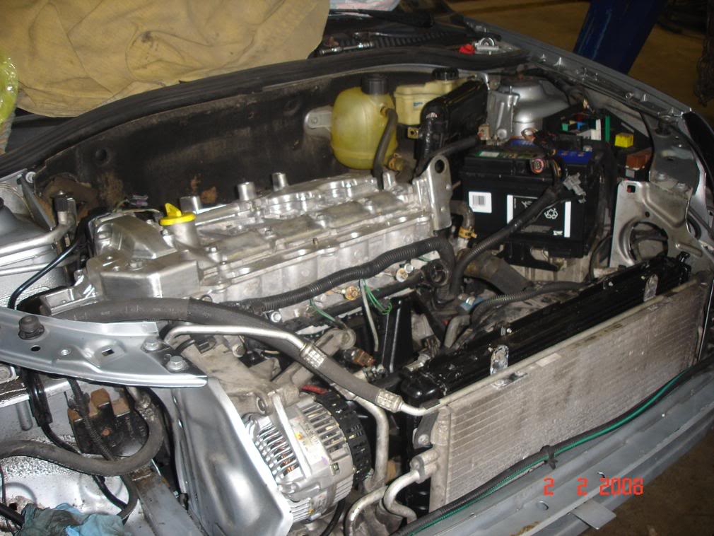

Saturday 2nd Feb

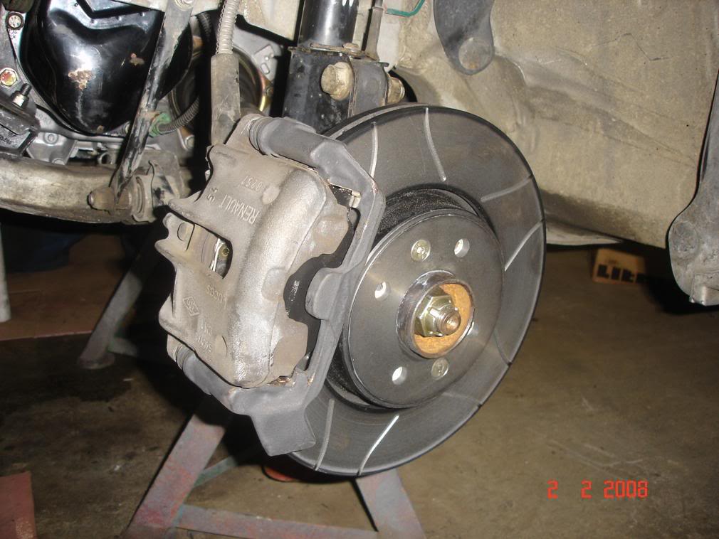

After a good friday nights work, hopes were high for saturday. After a few hours work the engine was partially connected up with the struts,hubs and brakes all sorted:
Ferodo DS2500
Brembo Max
Driveshafts/Hubs/struts assembled
Discs Fitted
Needed a slight adjustment to the pads but got there in the end
Radiators+Aircon fitted+Sensors fitted

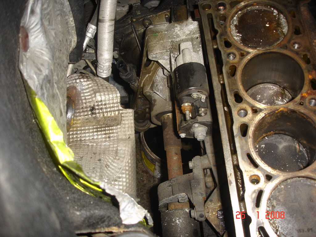

As we connected the battery up the car started turning over by itself :quiet:
After a few tests it was down to the starter motor (Brand New) sticking staying constant live, this would normally be ok but when the startor motor is hiden behind the manifold it takes abit longer. After an hour or two of fighting the motor was off and the original was fitted. This didnt turn the engine over by itself so we turned the engine over with the key, it turned over a few times and went dead. We thought it would just be the dead battery so we put the battery on charge and packed up for the night.

Hopes were shattered at the turn of a key, the car turned over but not enough to start the engine. Just my luck two dodgy startor motors :X Finished the day with removing it and a new one will be ordered tomorrow.

Are you sure its the starter motor mate, seems a bit unlikely after putting a new engine in and wont start and you changed starter motor and still dont start?
Could be something in wiring
Barron
  Turbo S,Exige,R5,182
yeah im 95% sure. The first motor was sticking and the 2nd one has been on the car for 54k and i think when the cam belt snapped on the other engine the guy who had the car before had been trying to start it too much and turning it over many times and burning out the motor.
