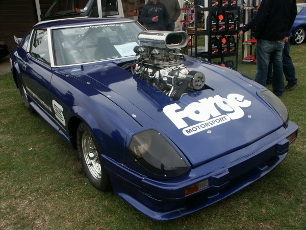

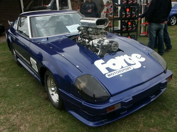

as above, but also conside the option of one of those huge through-the-bonnet blowers.....yeah, the ones with big red flaps in them
  Listerine & Poledo
photoshop anyone?
