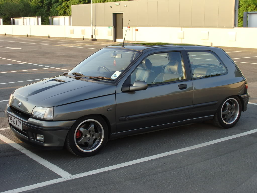

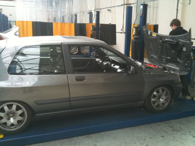

Right so I bought this car about 15 months ago, for the first year didnt really do anything to it apart from a few new parts etc. Then I decided I wanted to change it around a bit! I will let the pics do a bit of talking!
How I bought the car:

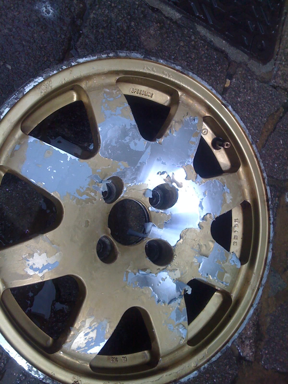

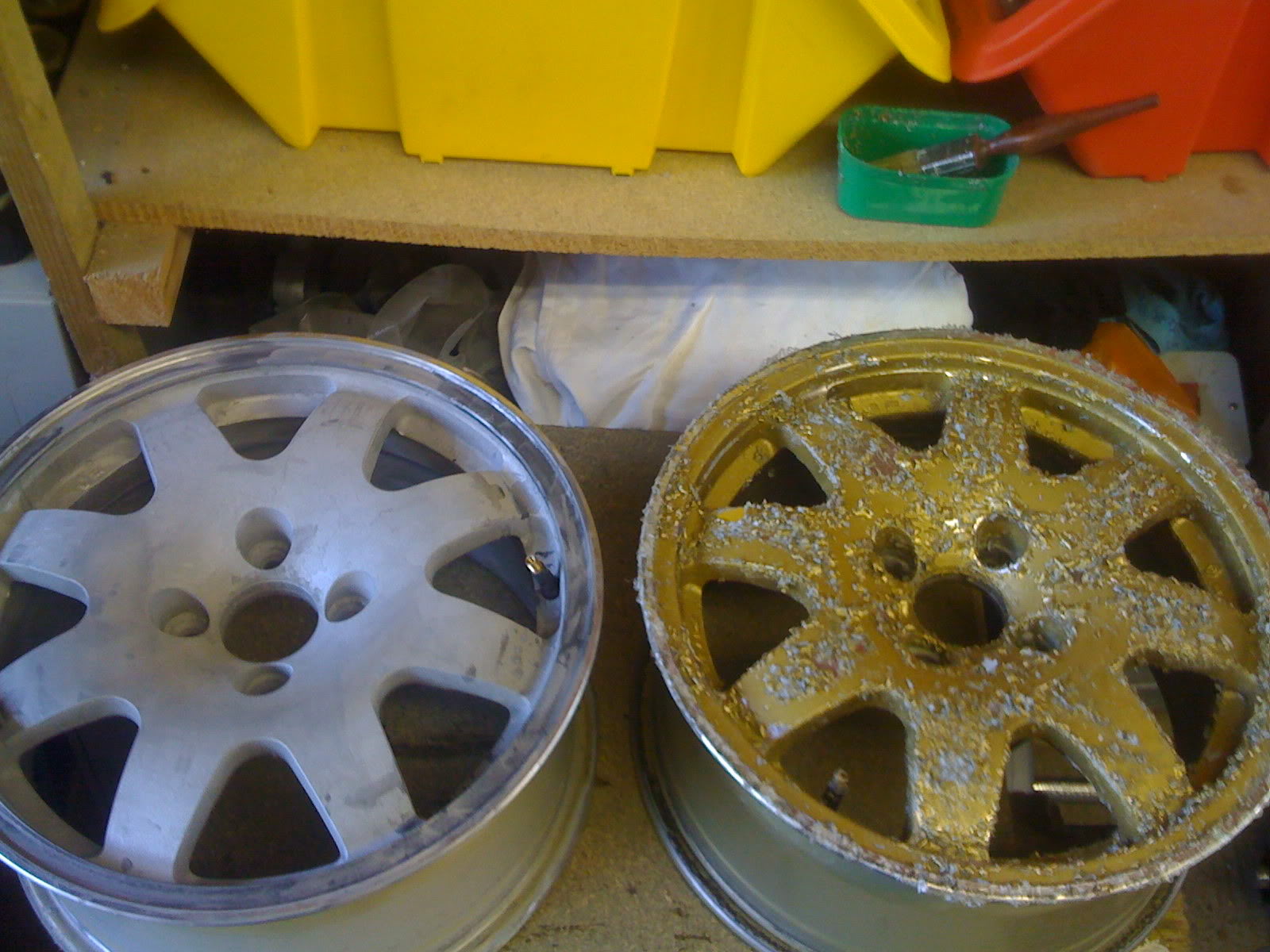

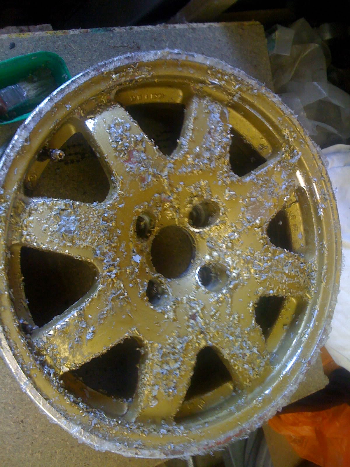

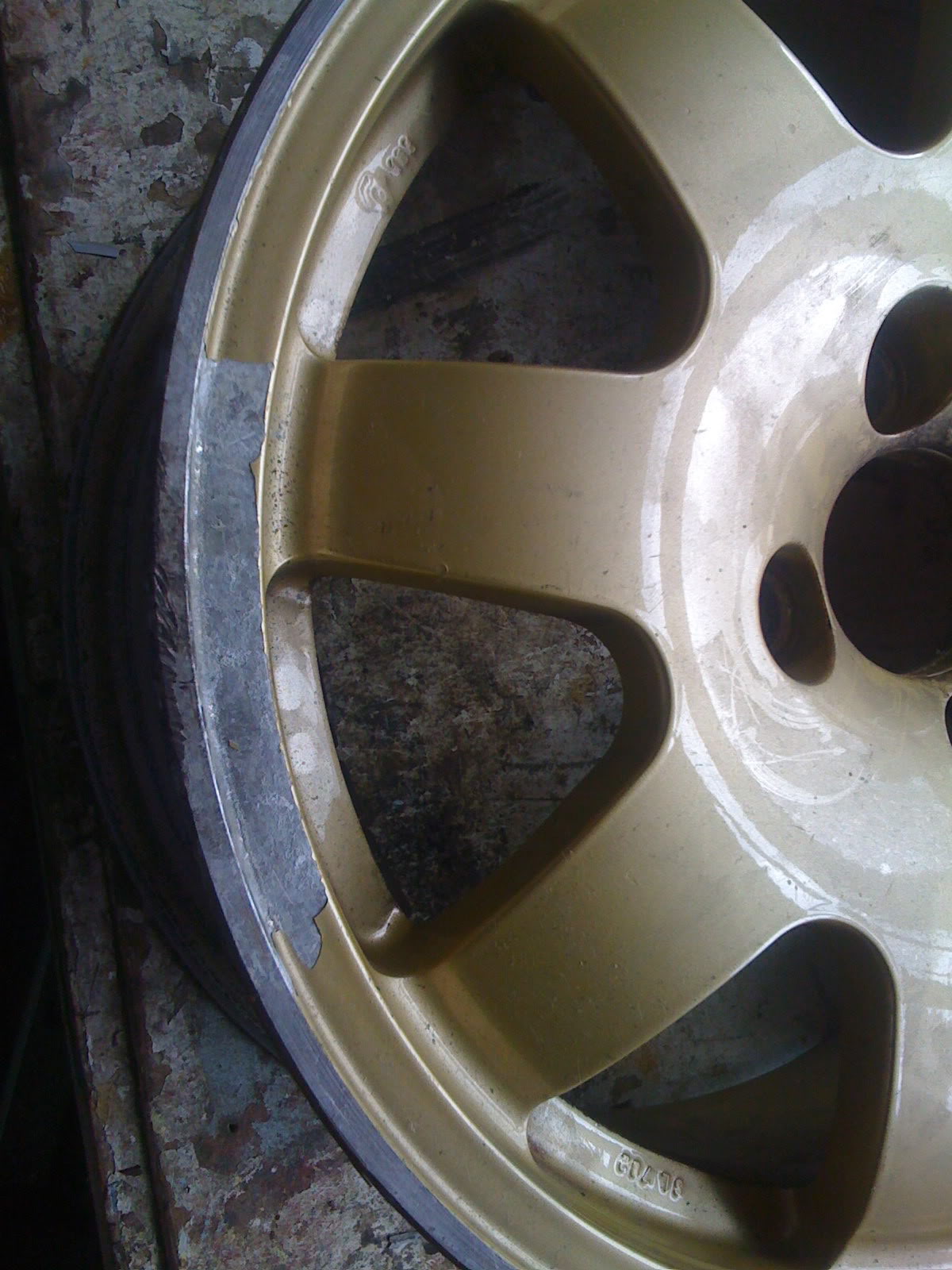

Anyway I decided I got bored of the wheels so I picked up some williams wheels to refurb:
Paddy_g46
After a lot of hard work I decided to just send them off to be done professionally after all! :dead:

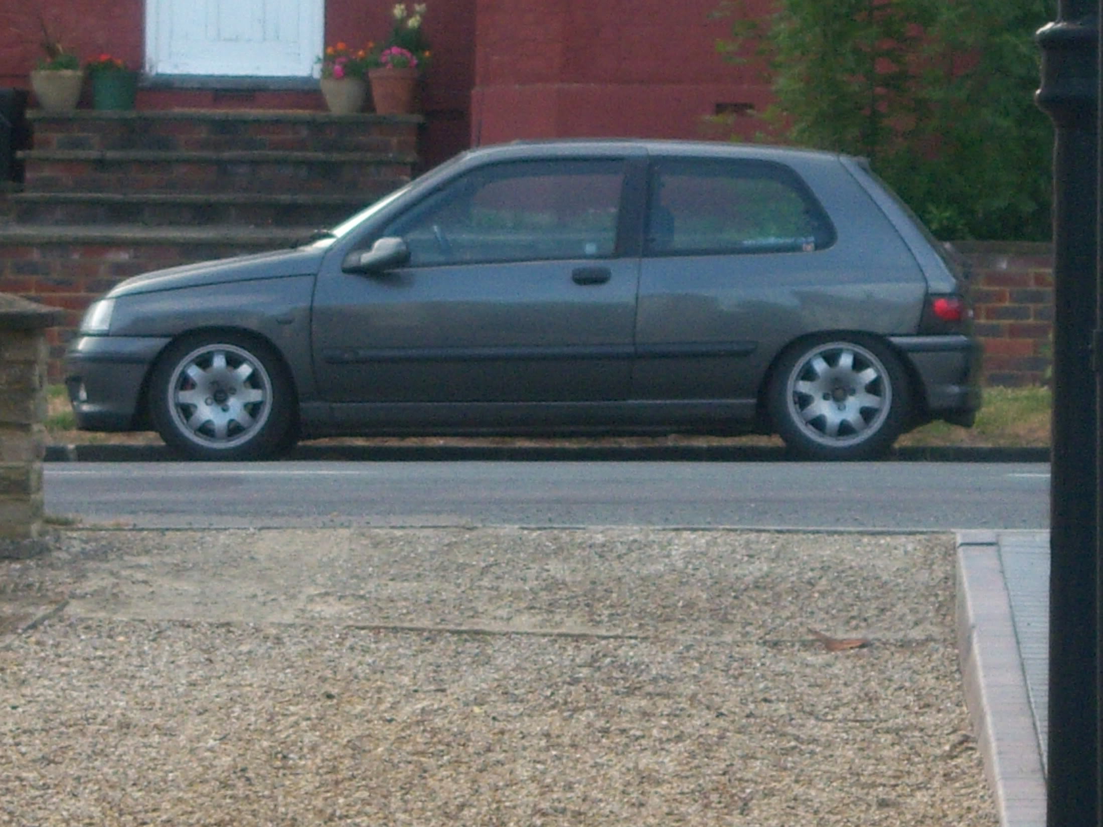

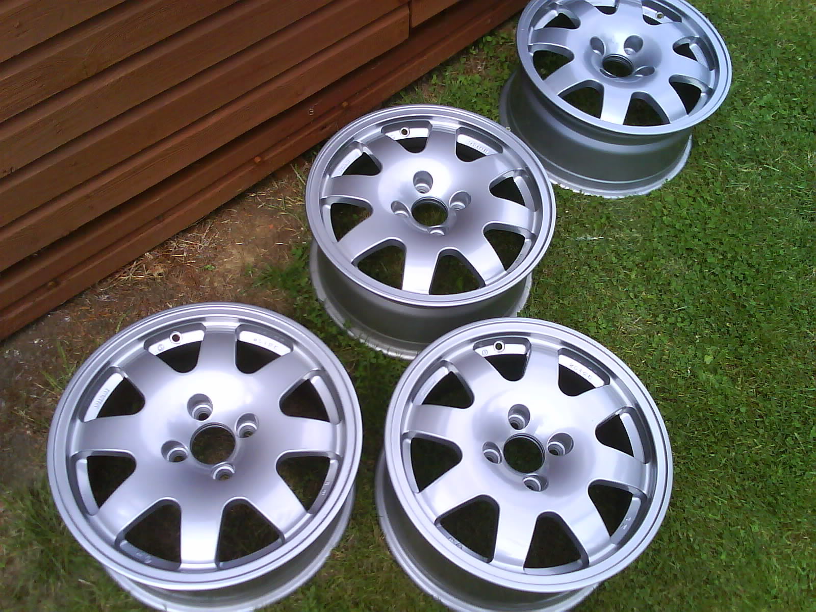

So I got them done in silver:

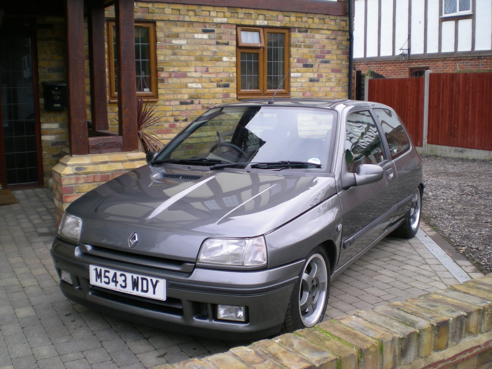

I havnt got any proper pics of them on the car yet yet but here is some from the door of my garage that I took today:

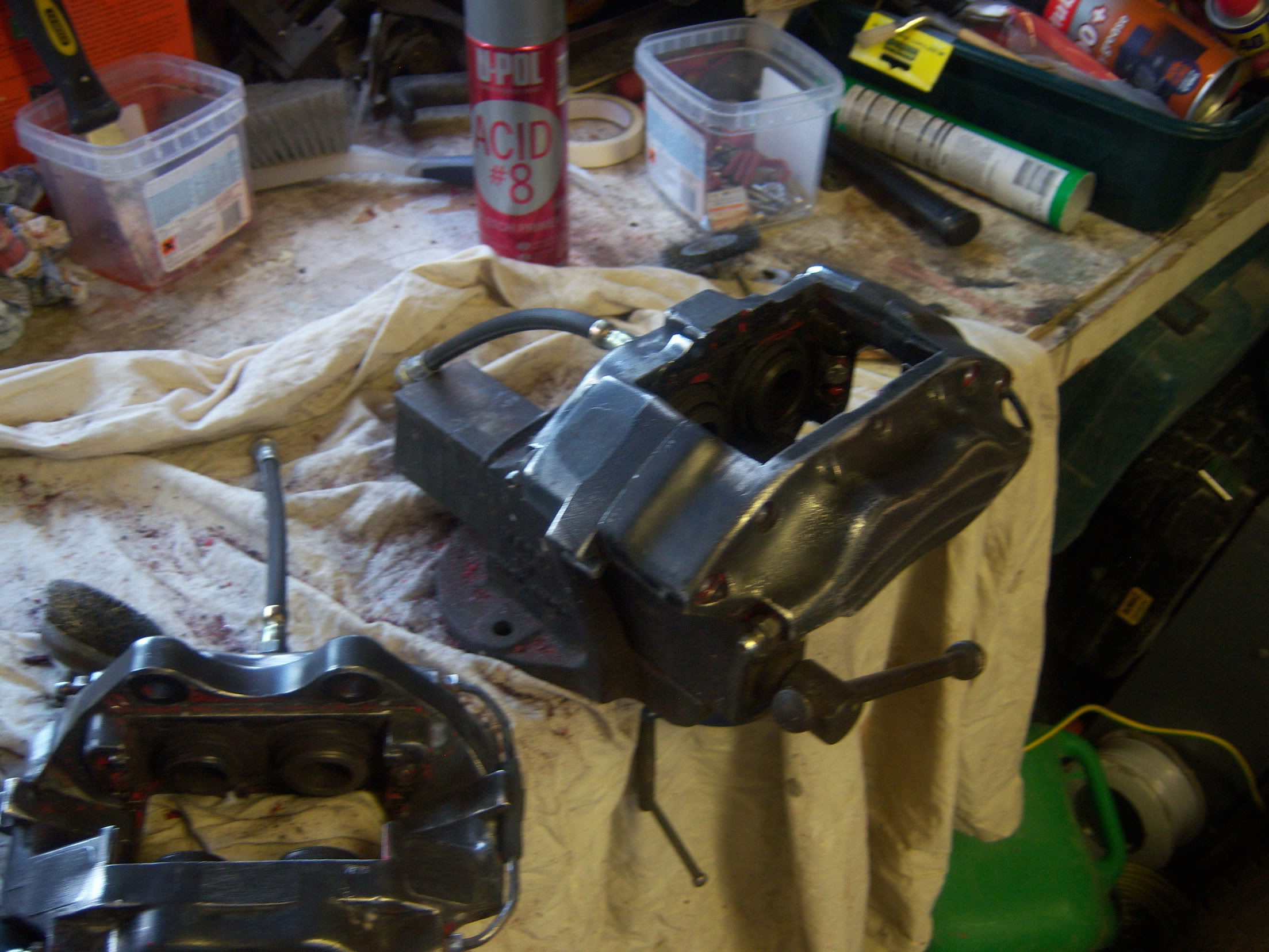

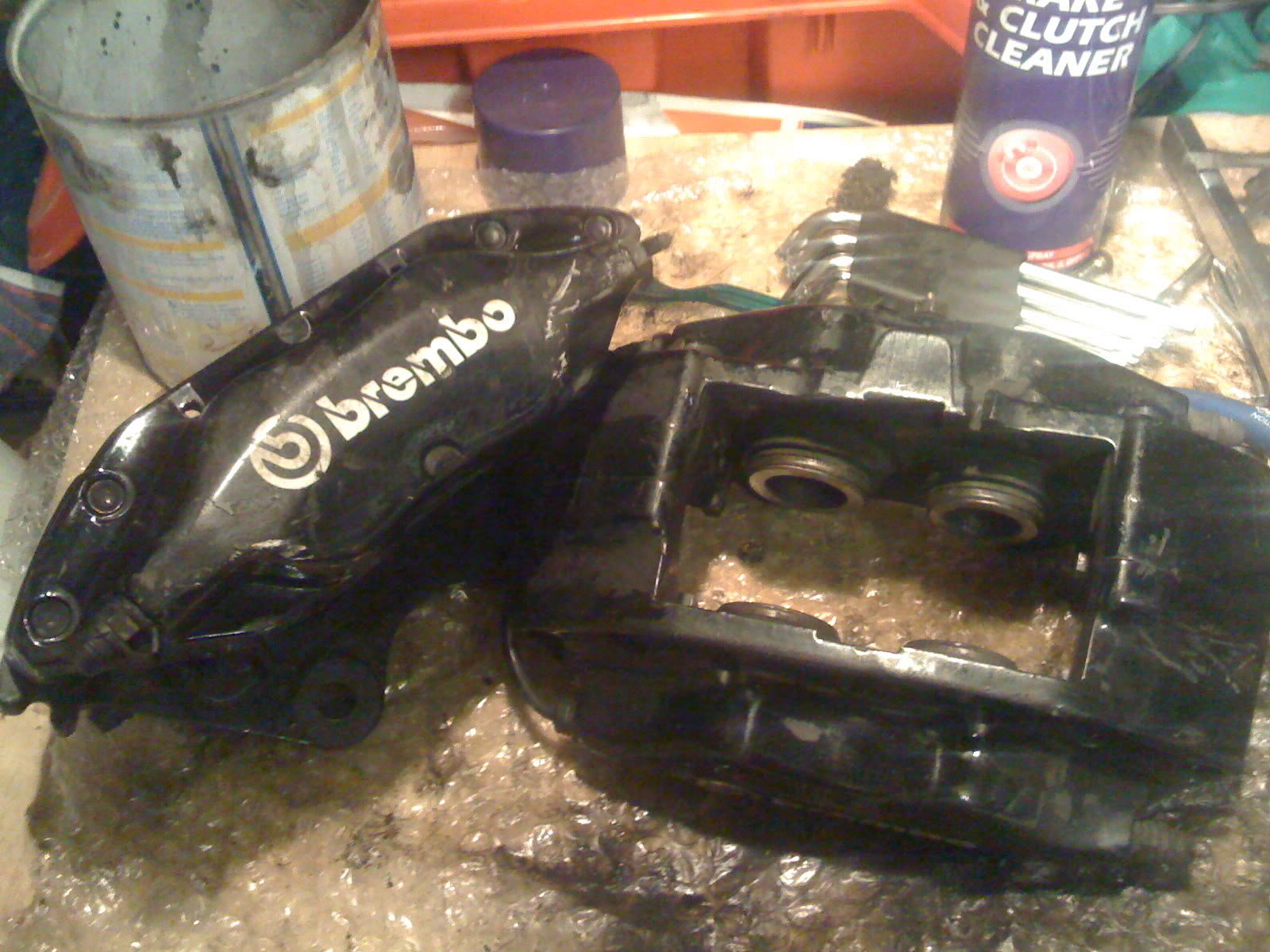

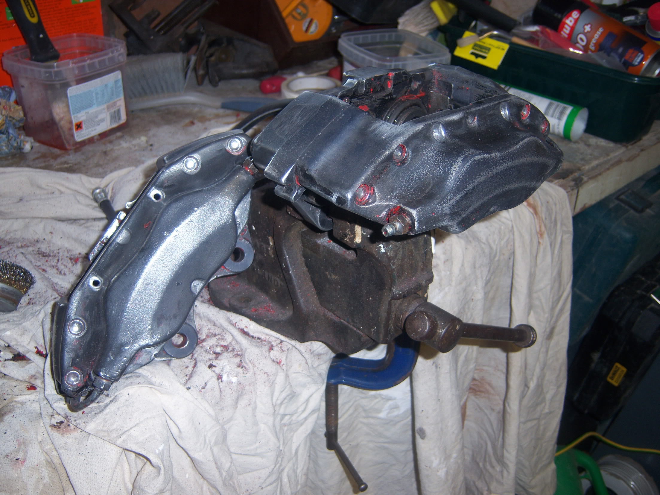

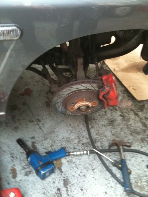

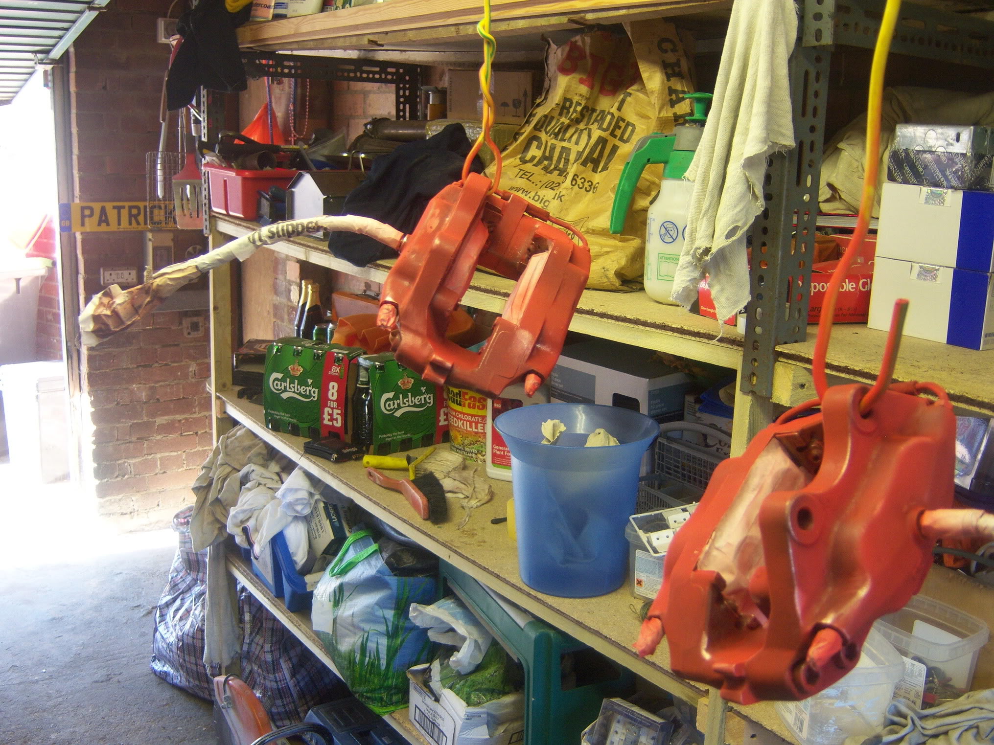

Next up was the 4-pot Brembos from a 406 coupe. Got these stupidly cheap so I couldn’t really refuse!
Here they are as I got them:

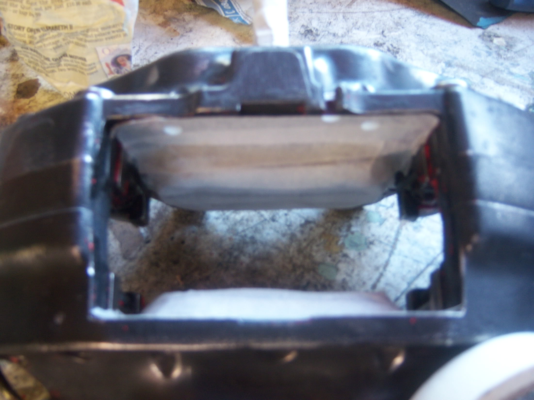

First I removed the pad sliders and removed any corrosion and re-greased before refitting. This is a common problem with these callipers.

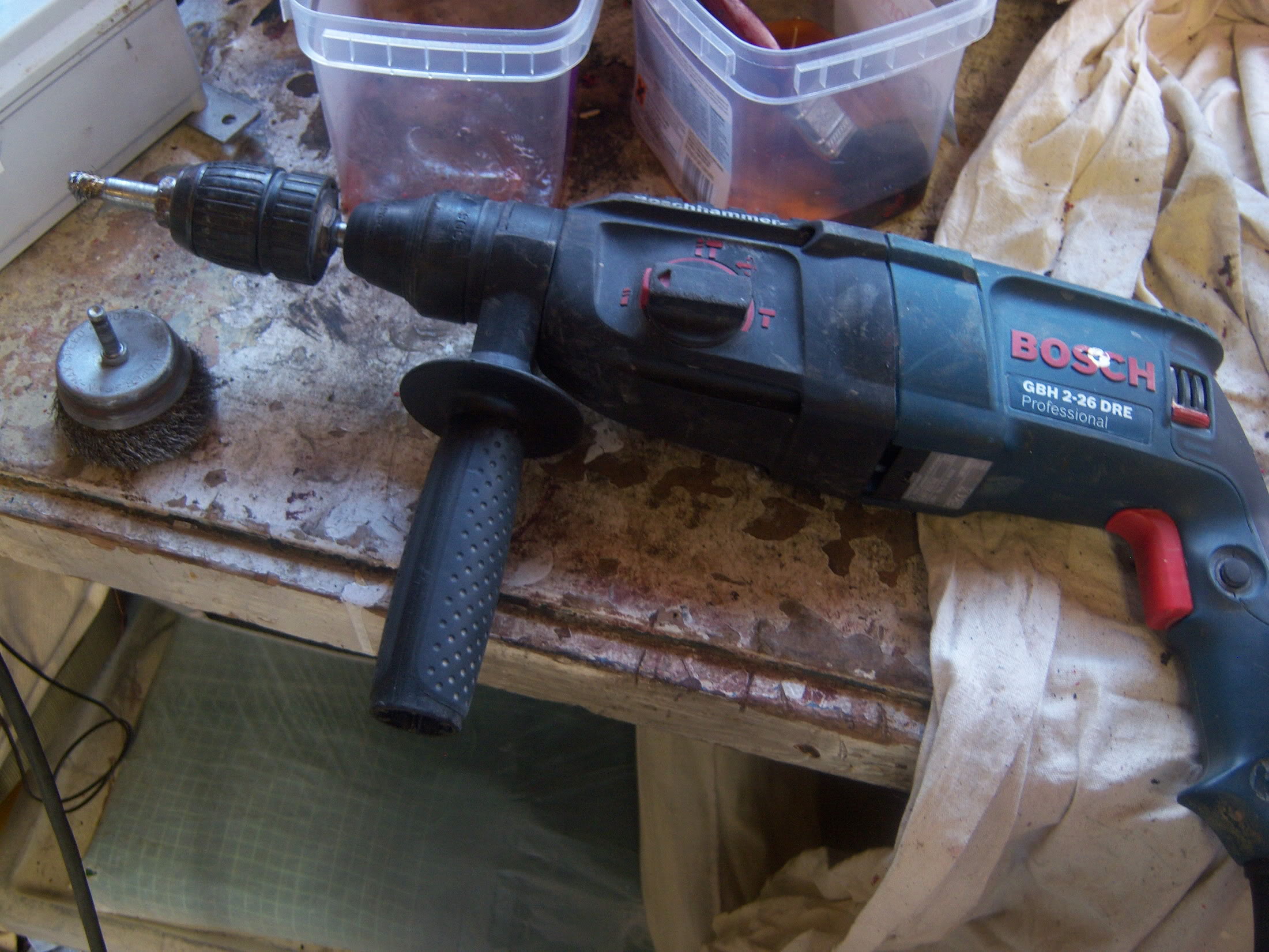

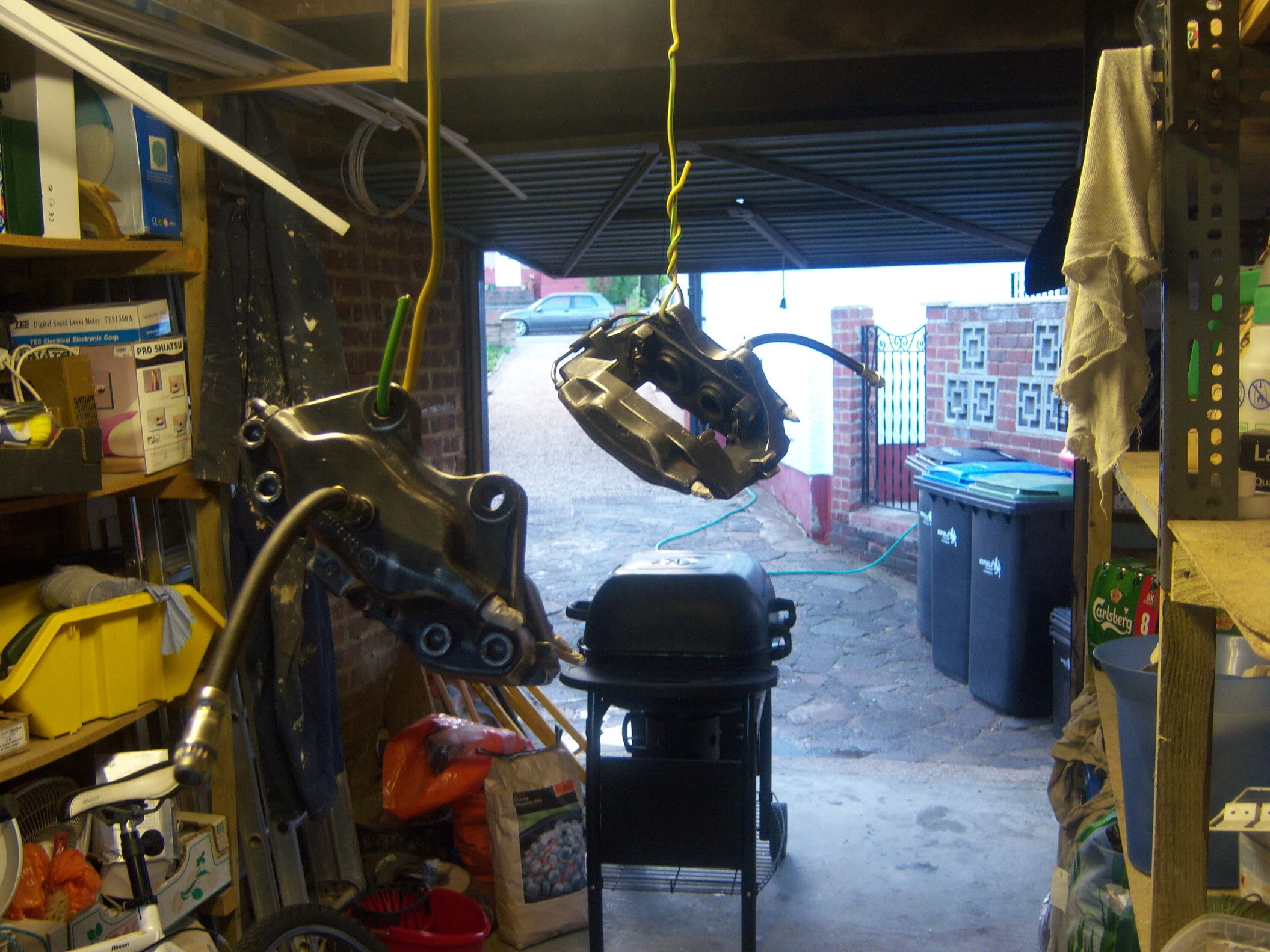

Then I set about cleaning and stripping off all the old paint which wasn’t in a good way! I used a normal 240v drill with a few wire brushes and lots of nitro-mors!
Paddy_g46

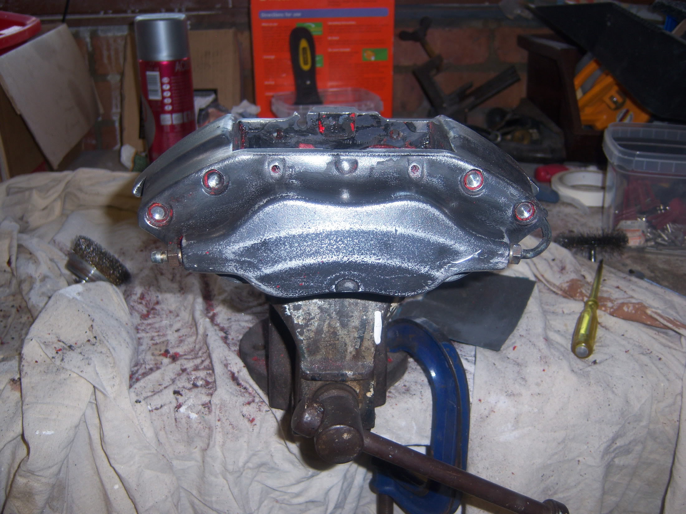

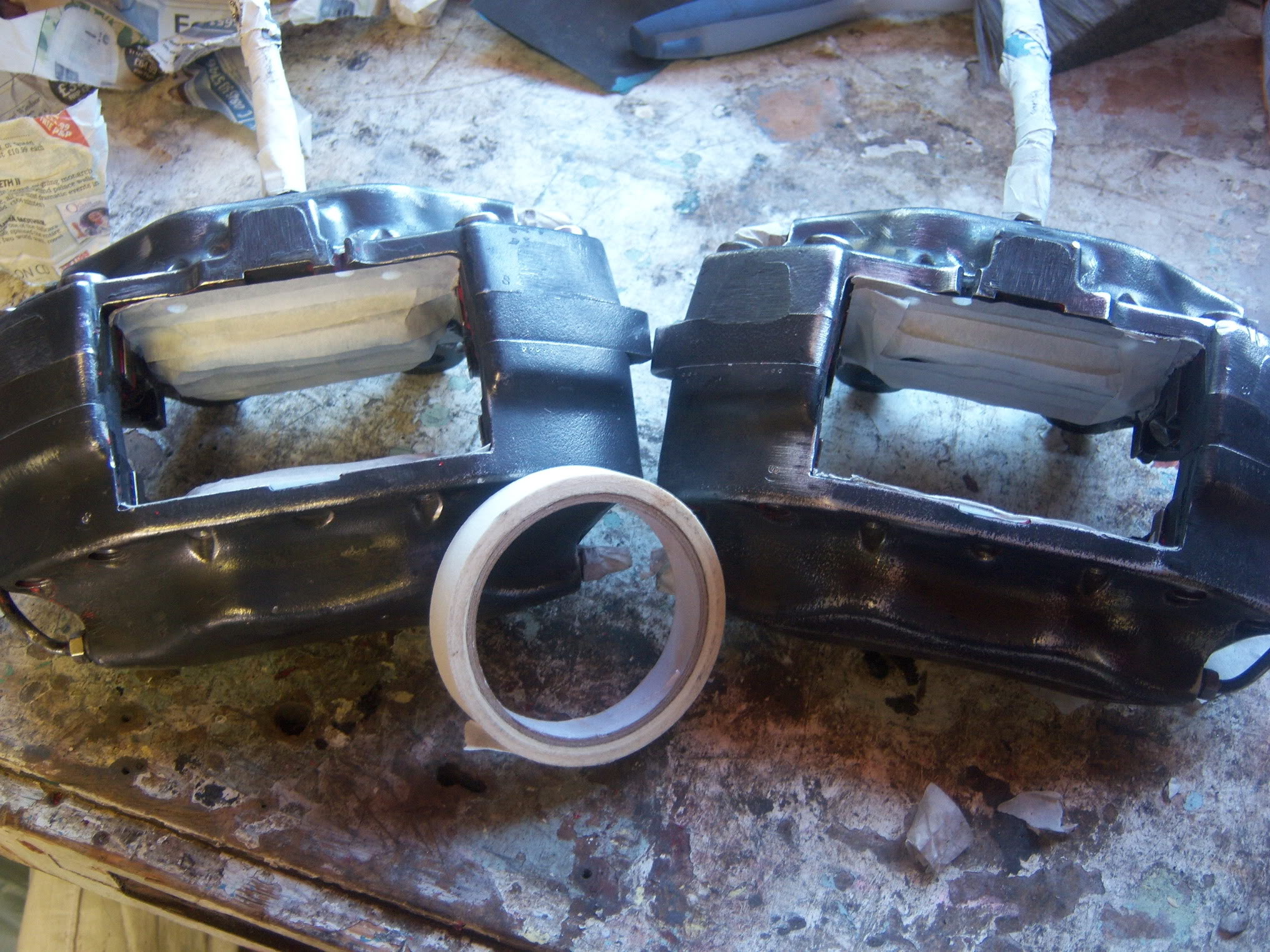

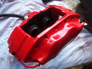

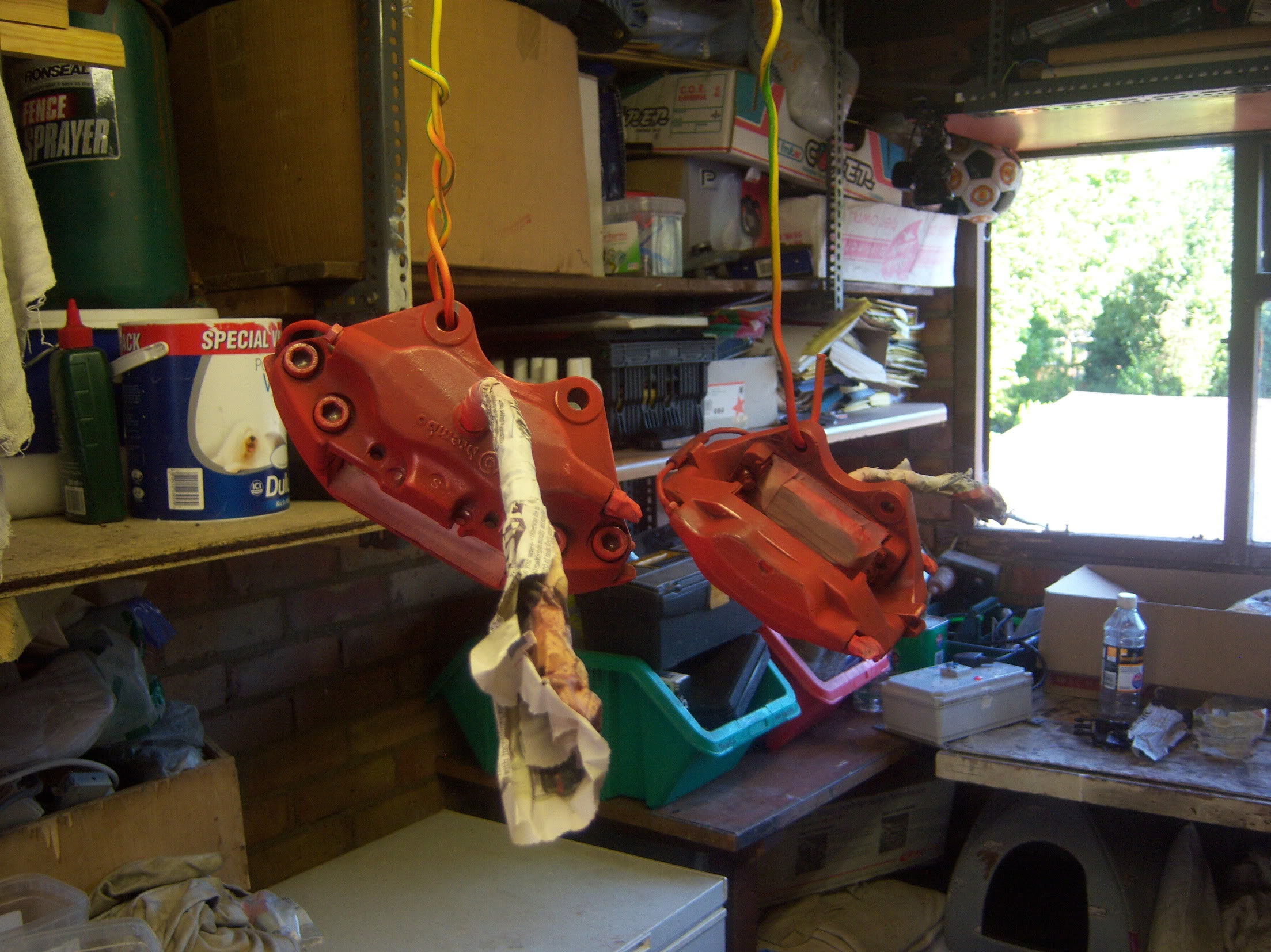

Then came the job of masking it all up ready for spraying!
And then I set up my “spray booth” lol

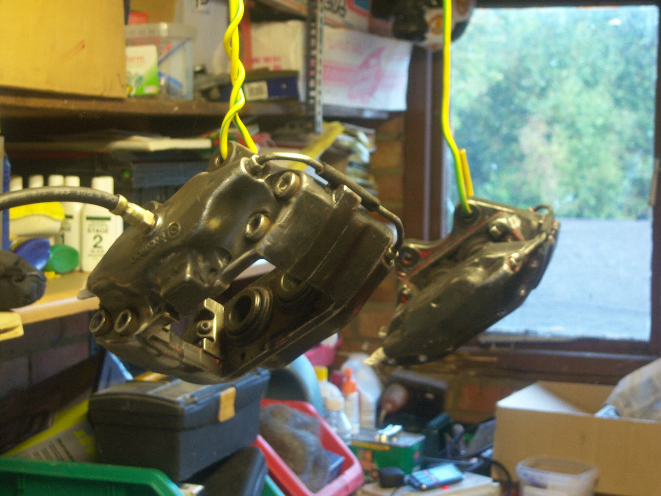

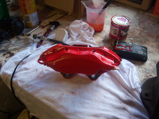

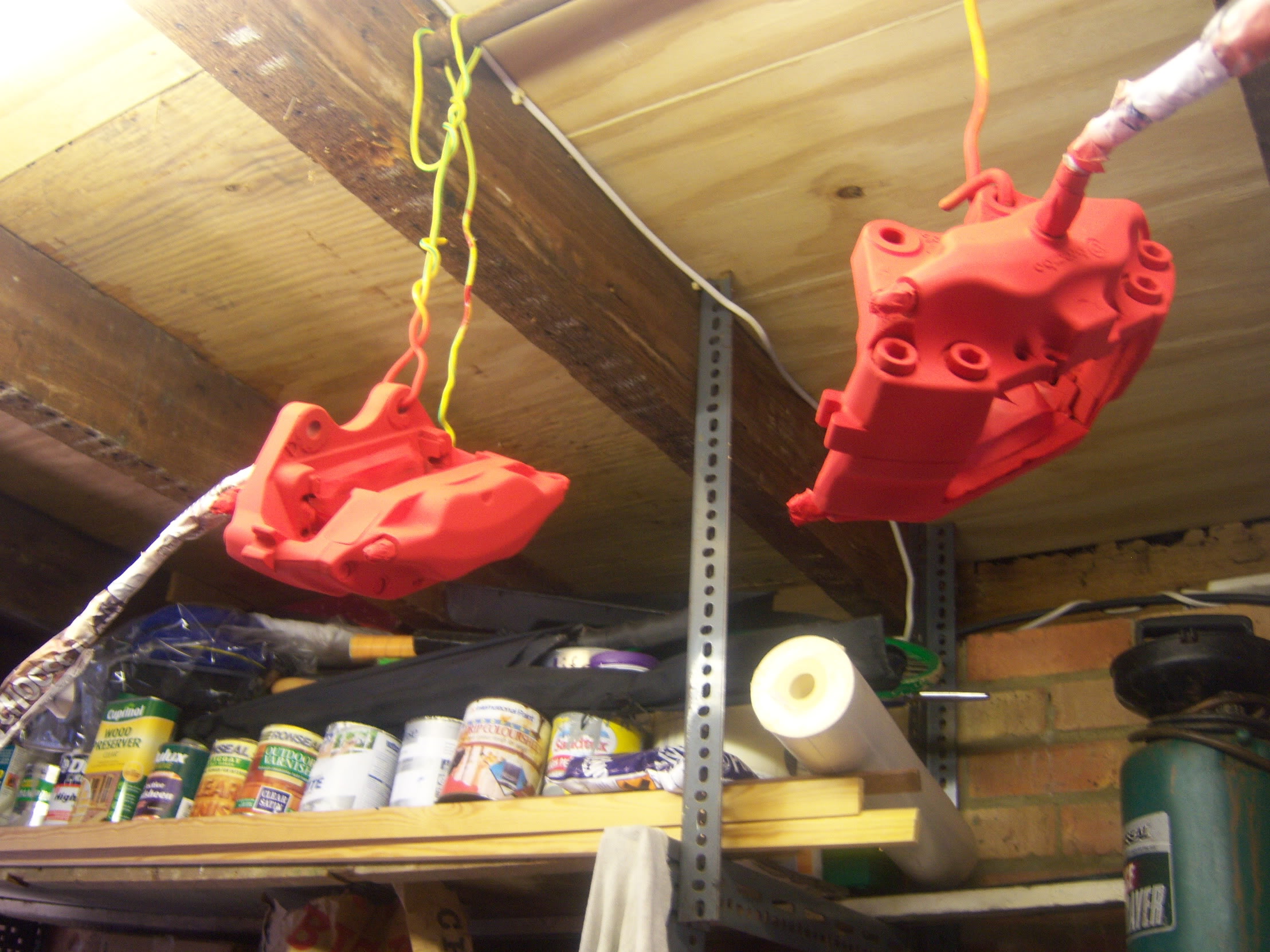

Here they are with a very light “primer” spray
And then I gave them a good coating of VHT paint.

Looking good so far! Bet the Brembo's will work on such a small car!
Tunst
  Focus ST225, Focus E
How much effort will it take to fit the brembos? they wont be a straight fit will they?
Tunst
Well i didnt know that, theres a 406 coupe in my local scrappy, might go aquire these brakes for a future car...
Paddy_g46
Yep, fit staight on with a couple of washers to centralise the calliper over the discs! Need at least 15mm spacers on most 15" wheels though! Oh and bigger discs from a mk2 172/182.

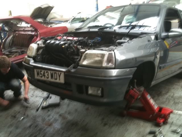

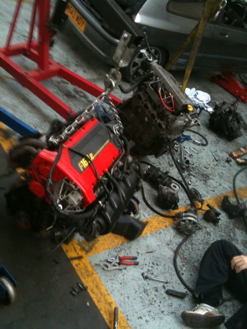

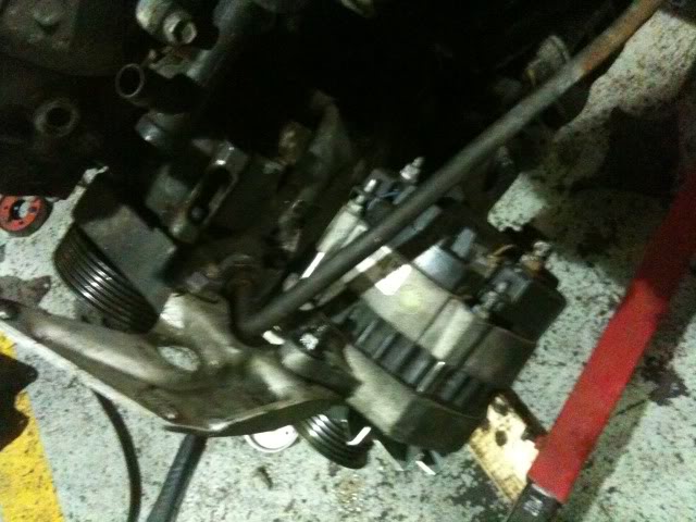

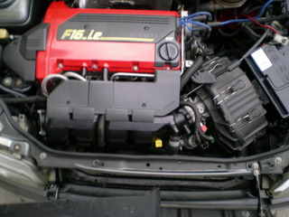

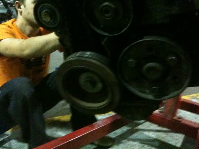

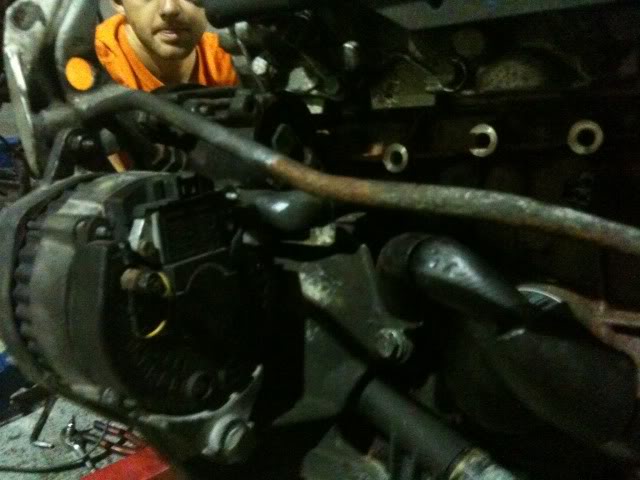

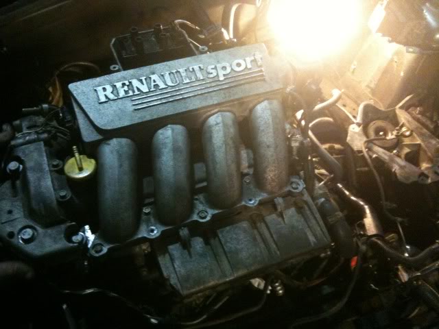

Ok, this needs an update!

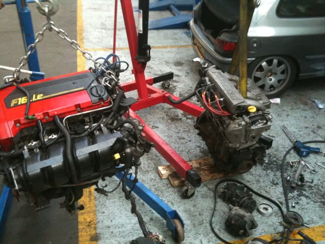

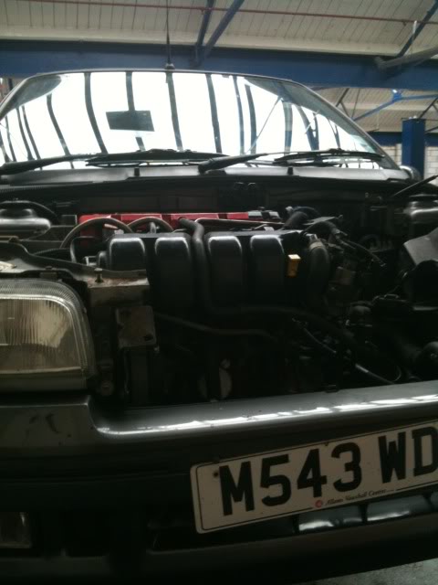

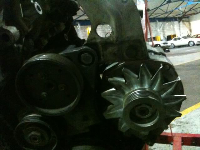

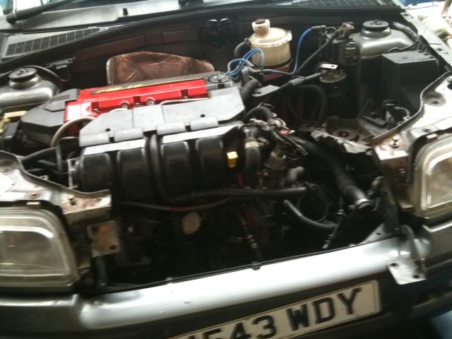

I started ripping out the old engine on wednesday morning.
Very start of the day:

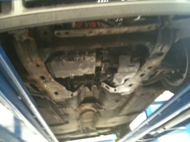

Exhaust system off:
Rad etc out:
Shafts out:
Paddy_g46

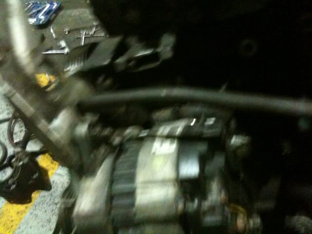

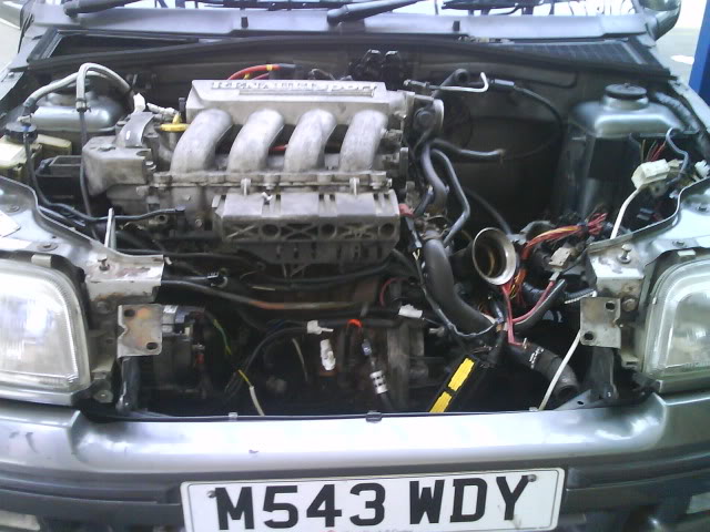

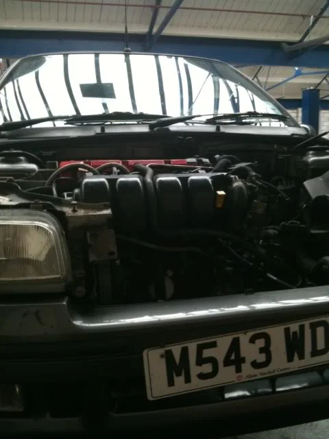

Currently I am having problems getting it started. I have connected up all the wiring as it should be, but when I turn the key, the starter turns the engine over but the fuel pump is not priming/runing and also I am sure there is no spark. I am thinking it is immobiliser related, possibly the ECU.
Paddy_g46
If it ran Andrews car when he testsed it I dont think it can be, unless you are very unlucky
Thats what I was thinking! Who knows! :S
Edit: He is on his way here now so hopefully he will be able to shed some light on it!
  330i. E30 Touring.
Glad to see my old lump's going into something worthwhile! This is going to be awesome!
  330i. E30 Touring.
PMSL. Would the key/door locks/decoder ring from the 172 help? I think I've still got 'em somewhere..
wilky19
  Leon FR 184
might sound stupid but have a poke around the the brown connector box when the car is in ignition 2.mine was doing the same and it was a loose connection in the brown plug that was stopping it starting
