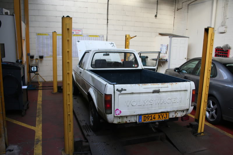

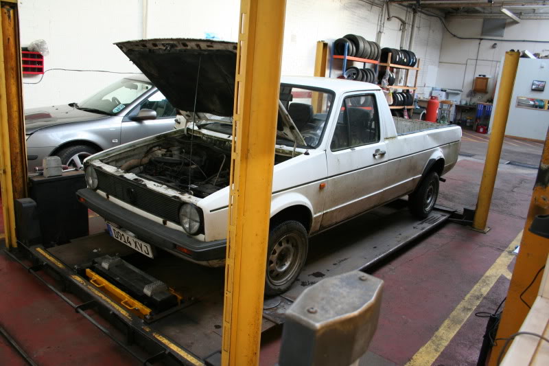

I have now bought it back for £200, spent £15 having the exhaust fixed and just put it through its MOT today, knowing very well it would fail lol
Considering the truck is 21 years old & its been sat for well over a year, it didn't fail to badly... It needs a bit of tinkering with the lighting side of things and a fair amount of welding doing... Oh and it blew a core plug, so that needs seeing to aswell
Its still all very new to me all this VW shizz and I will be getting alot of help from my mates over next few weeks to get it ready for its re-test

heres the fail sheet from this handy online link http://www.motinfo.gov.uk/internet/jsp/ ... equest.jsp
Horn does not function (1.7.1b)
Registration plate lamp not fitted (1.1.5a)
Nearside Front Direction indicators not in good working order (not working) (1.5.A1b)
Nearside Front Side repeater not in good working order (not working) (1.5.A1b)
Hazard warning tell tale not working correctly (1.5.A4b)
Nearside Front Hazard warning lamps not flashing in phase, with ignition on (1.5.A4a)
Indicator tell tale inoperative (1.5.A3)
Nearside Windscreen wiper does not clear the windscreen effectively (8.2.2)
Offside Inner centre Seat belt anchorage prescribed area is excessively corroded (5.1.B.6)
Offside Rear wheel arch Suspension component mounting prescribed area is excessively corroded (2.4.A.2)
Offside Front floor Suspension component mounting prescribed area is excessively corroded (2.4.A.2)
Nearside Rear Suspension spring mounting prescribed area is excessively corroded (2.4.A.2)
Nearside Front floor Suspension spring mounting prescribed area is excessively corroded (2.4.A.2)
Nearside Outer centre Seat belt anchorage prescribed area is excessively corroded (5.1.B.6)
Nearside Front wheel arch Suspension component mounting prescribed area is excessively corroded (2.4.A.2)
