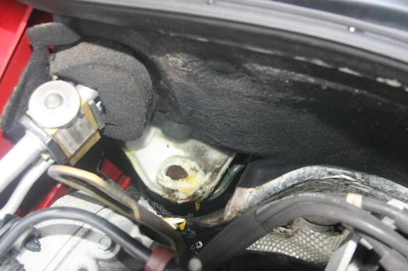

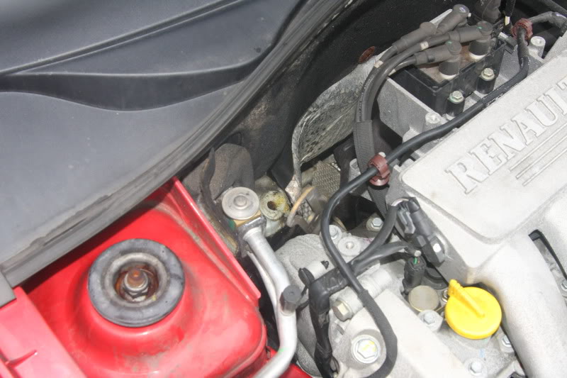

Had my 36k service done just over a week ago at Renault Bridgend and then had my brakes done yesterday at Renault Neath. Driving home earlier noticed a funny smell in the cabin so took it easy just to get it home. Reversed up onto my drive and the smell got much worse, switched off the engine and got my Mrs and nipper out of the car immediately. Then noticed smoke coming from under the bonnet so got it open to see flames coming from this area of the engine bay:
Car starts ok and it seems fine on idle, not making any strange noises and no strange substances coming out of the exhaust.

Overfilled brake fluid?

Brake fluid cap not fastened correctly, dropped off onto hot exhaust manifold?
But it also looks like the reservoir has melted aswell???

Yep the entire reservoir has melted. My old man seemed to think it was the brake fluid.
Very luck there!
I agree with this but how the hell does the reservoir just melt, where is the heat coming from ! ? :S

My guess is reservoir cap was just undone and placed on top, driving a long hit a bump knocks it out along with the fluid all over the nice hot manifold!

Looks like the cap was never put back on and fell off. Some fluid dripped onto the manifold causing a fire and then flashed back and set fire to the oil in the reservoir.

More than likely the lid as it is missing!!!
Brake fluid is flammable, but not like that, you can drop it on the hot mani and it wont ignite, so something has been melting etc!!!

The chap did say that he doesn't think brake fluid is flammable anymore, so it must have been the reservoir cap left loose which then melted and caused the actual reservoir itself to melt.

Can drip petrol onto a hot exhaust manifold and it won't go on fire.
So meltage, unless you've been doing some serious braking!

Had the car back from Renault today, and they confirmed that the Brake Fluid Reservoir cap wasn't secured causing the fluid to leak out everytime I touched the brakes. The subsequent heat generated melted the reservoir and caused the flames.

how did the reservoir itself melt then? I can understand the cap melting if it was touching the manifold, but why the actual reservoir? There would have been no difference in heat around there. I've had brake fluid seep out round there and it never made any difference. If it's not flamable then it makes no sense.

Lol it is flammable and it he's braking it'll be sloshing all over the place with no lid! A load straight onto manifold, big flame, will probably catch fluid on lid and set fire to that!
