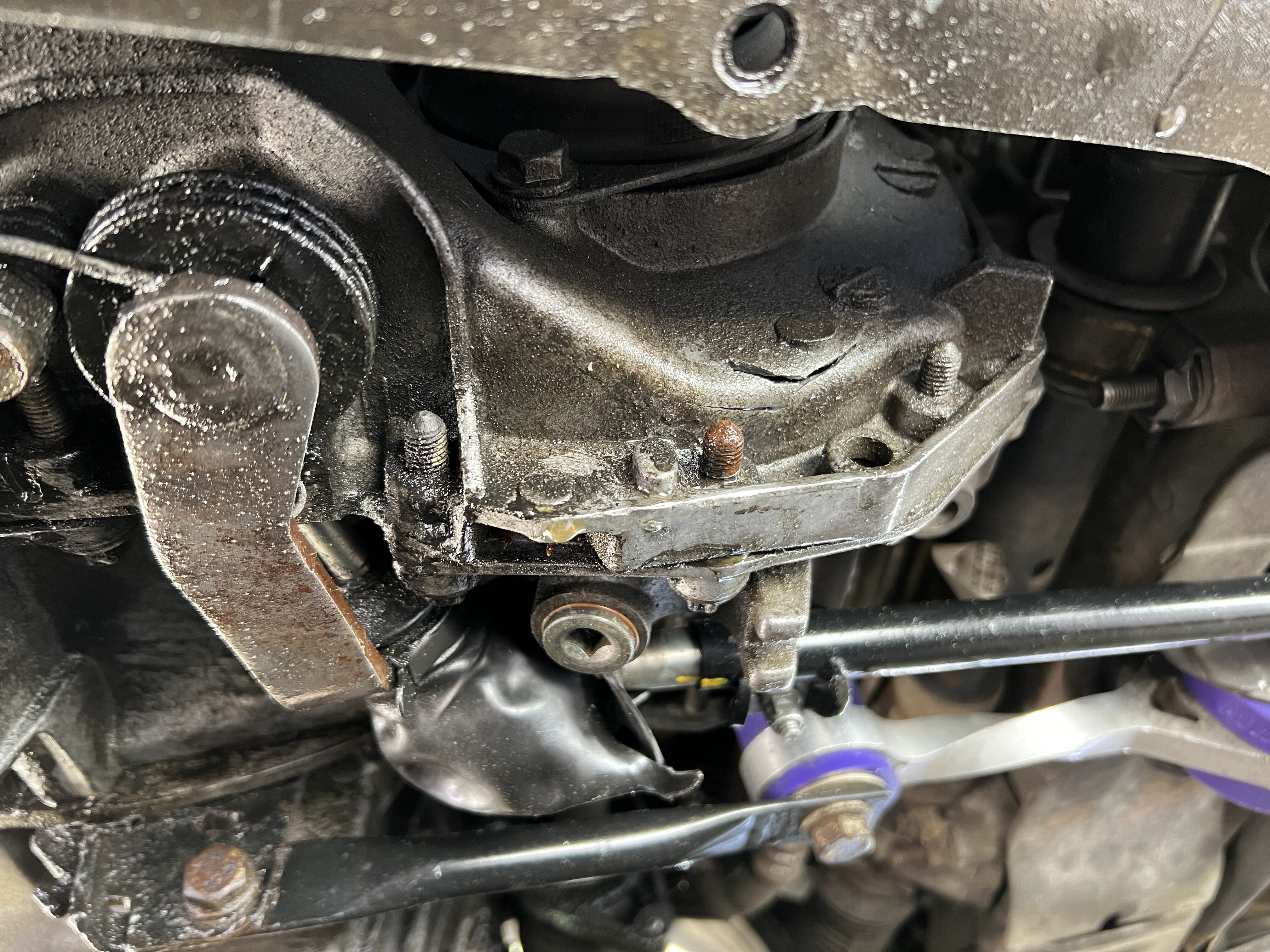

Finally got round to cleaning the clio. Had pretty much been left since the box (now suspected diff) crapped itself. So looked a bit sorry for itself, dirty, oily and covered in brake dust.
Took a while to get all the oil off, but has appeased my ocd making it atleast look good again despite the hole in the gearbox 😂
Missing being able to use it already

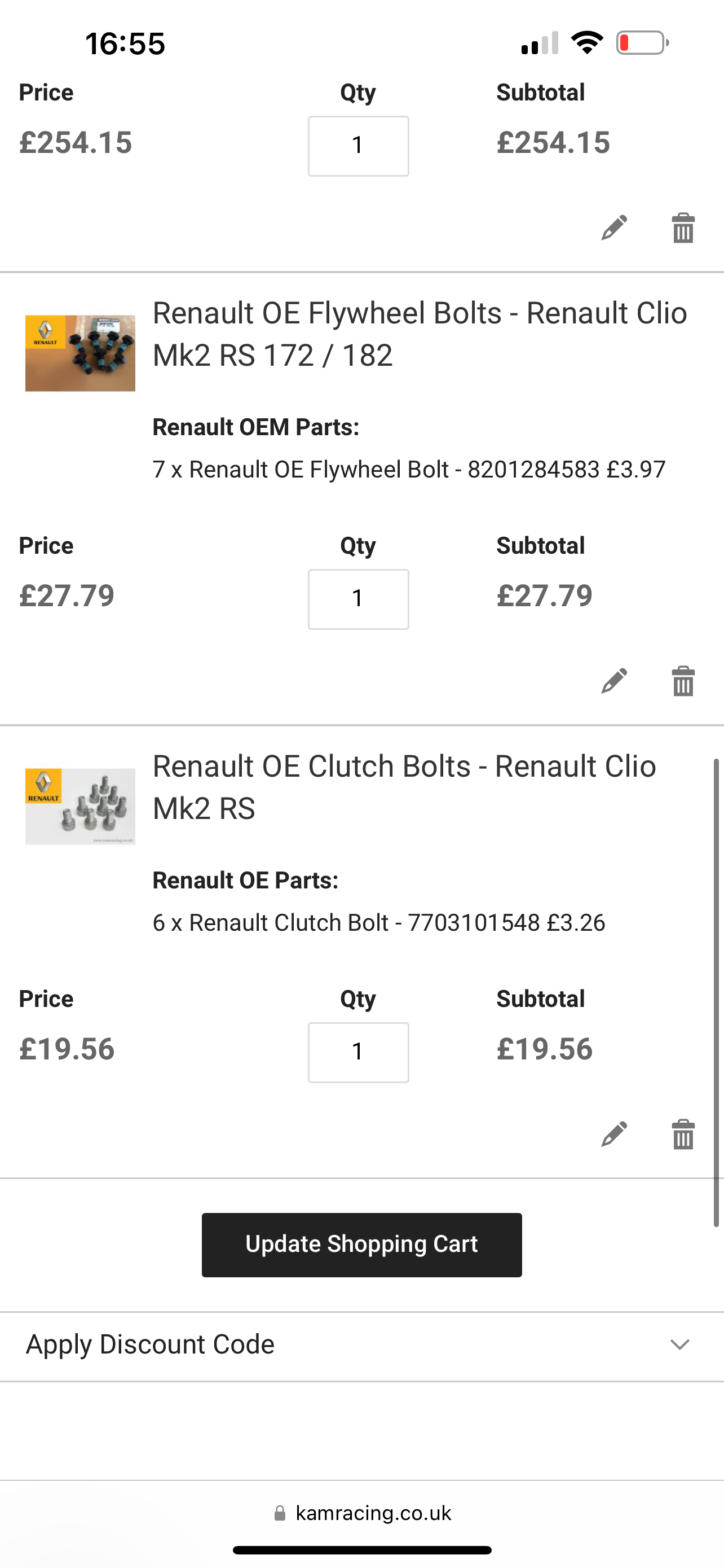

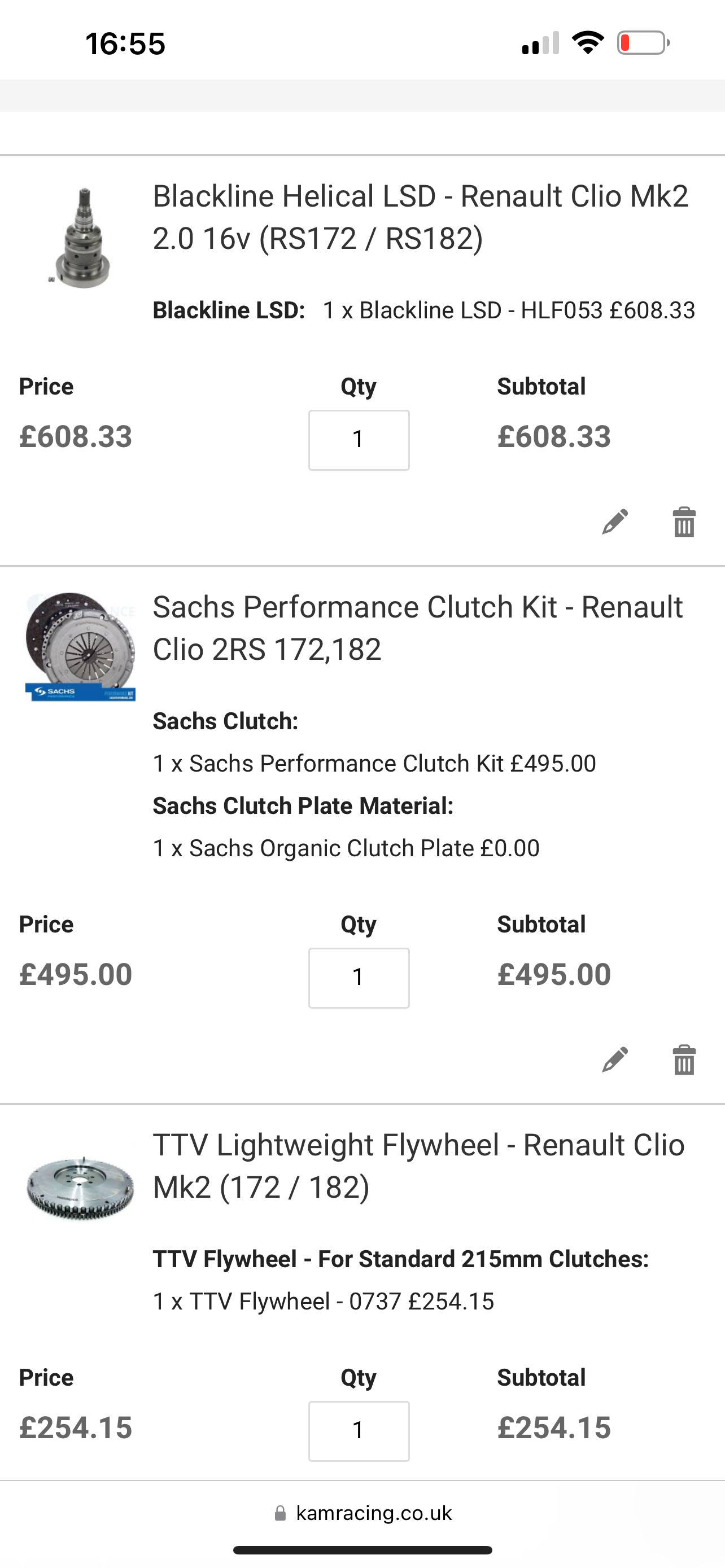

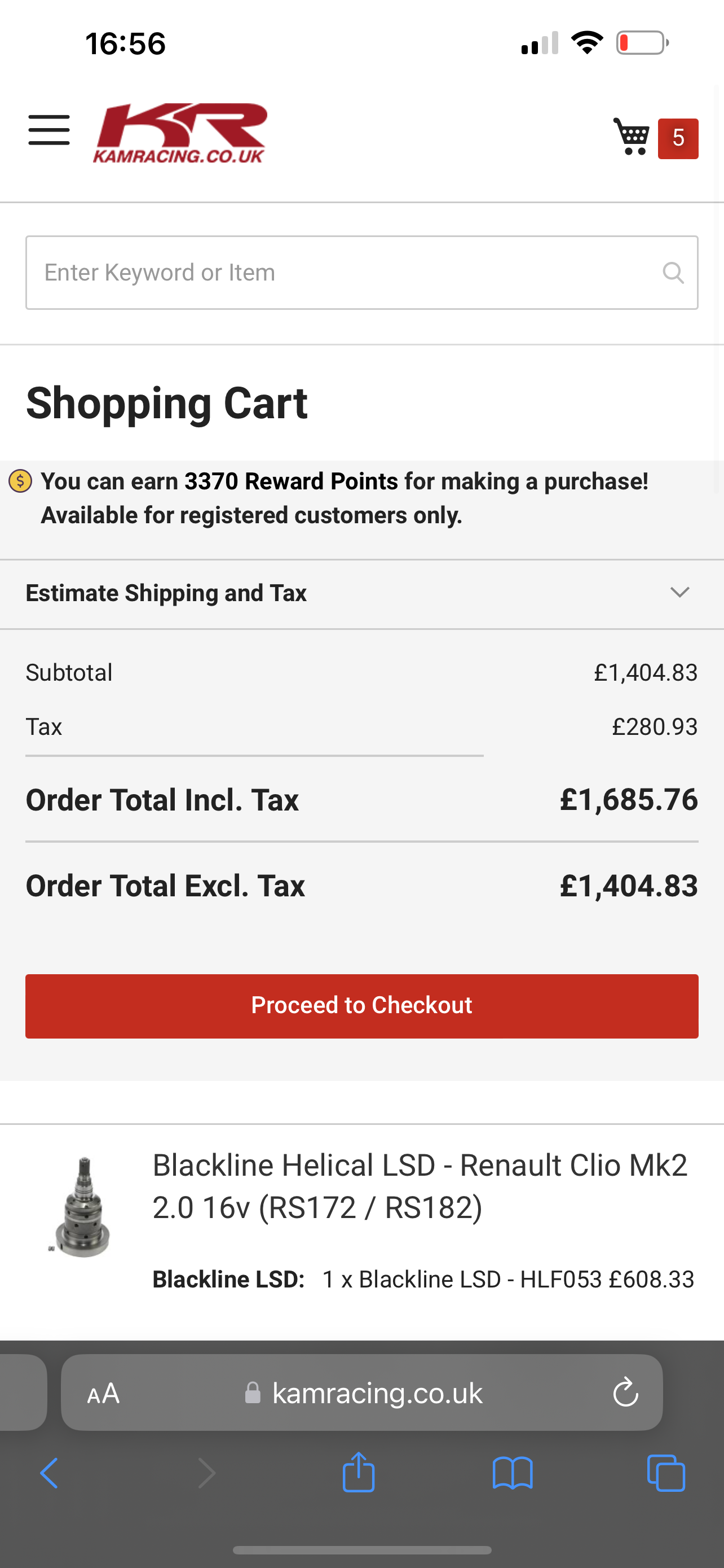

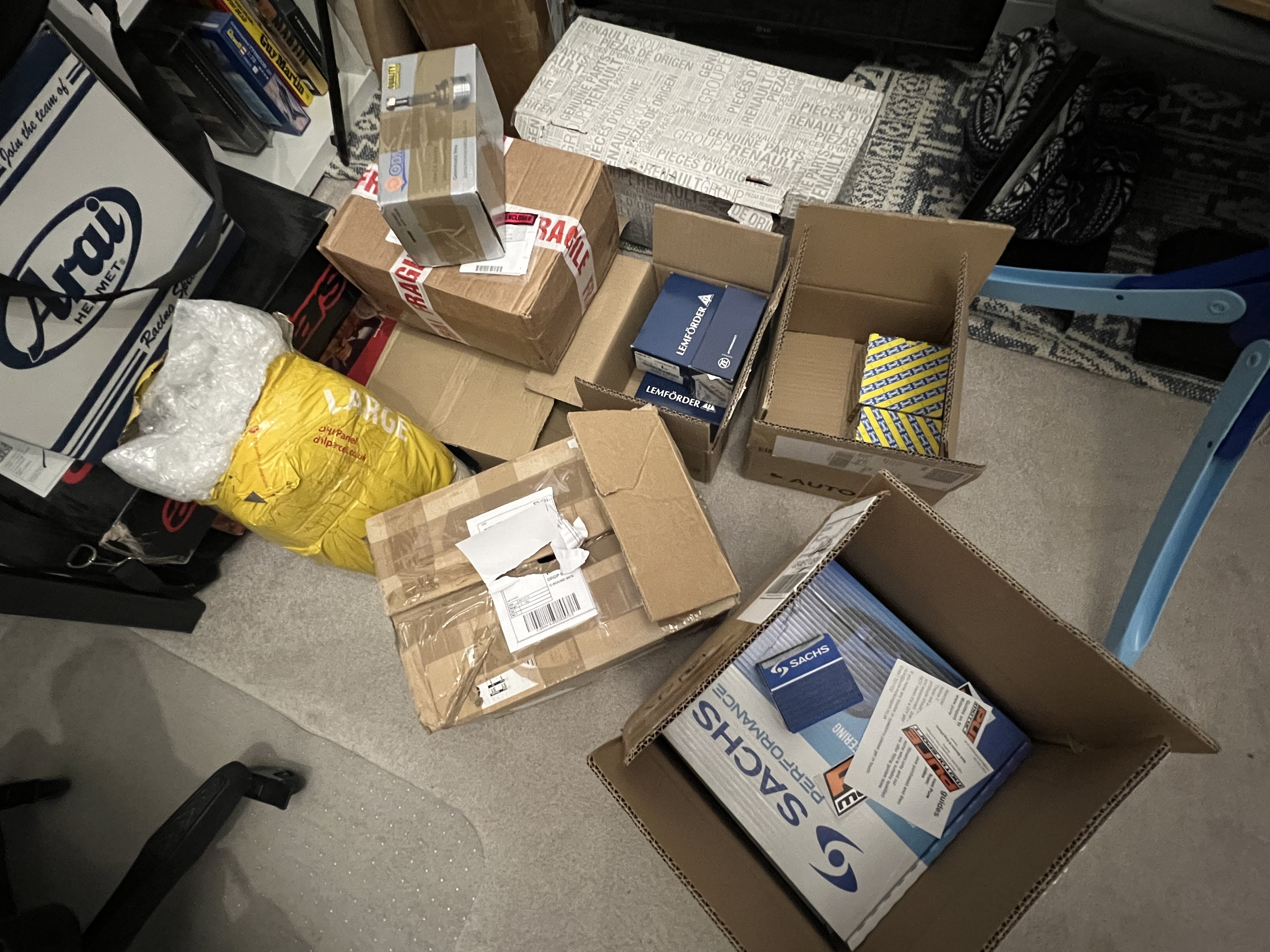

Advikaz
Just some of the bits that have turned up 🤦🏽‍♂️
Loosing track of what’s been ordered and what I’ve got tbh. So writing it here.
Should be
Black line LSD
OEM Inner track rods kits
Lemforder Rod ends
Lemforder Ball joints
SNR Front wheel bearings
Hubs to be refurbed
Redline Pas fluid
Motul brake fluid
Sachs performance clutch
Oem clutch bolts
New drive shafts
Doner gearbox to be refurbed
Subframe to be refurbed
Subframe supports to be refurbed
Arb to be refurbed
Pure wishbones to be refurbed
Powerflex arb bushes (inner and outer)
Powerflex wishbone bushes
Powerflex steering rack bushes
Front abs sensors
I ‘think’ that’s it…. f**king hope so.
