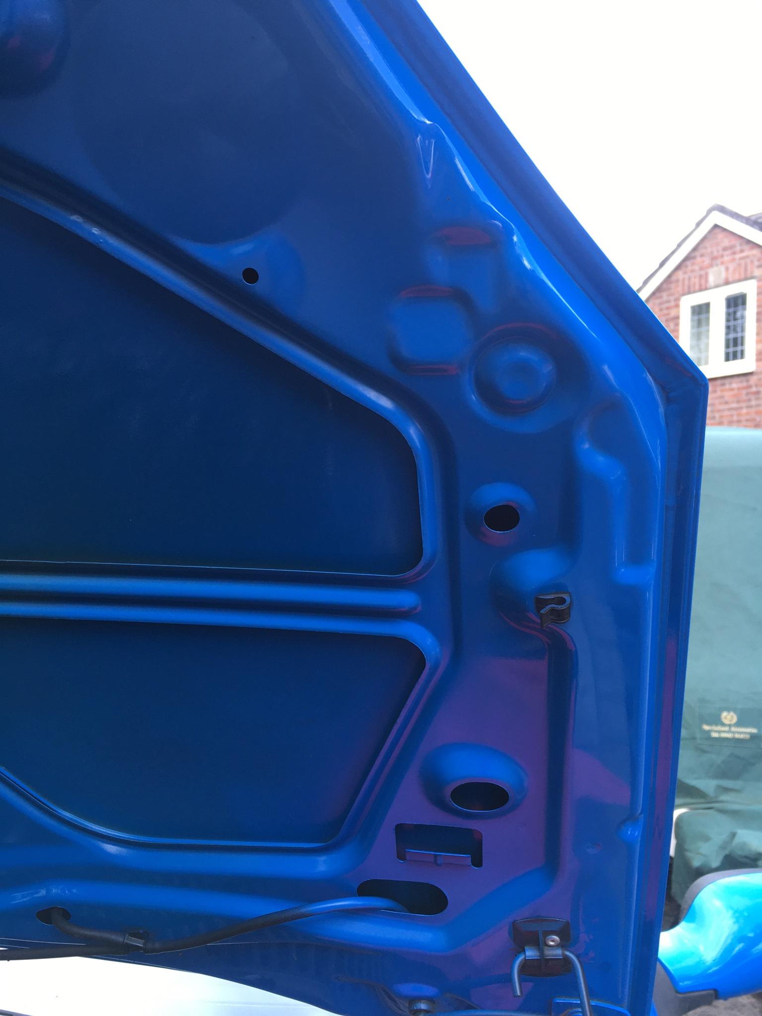

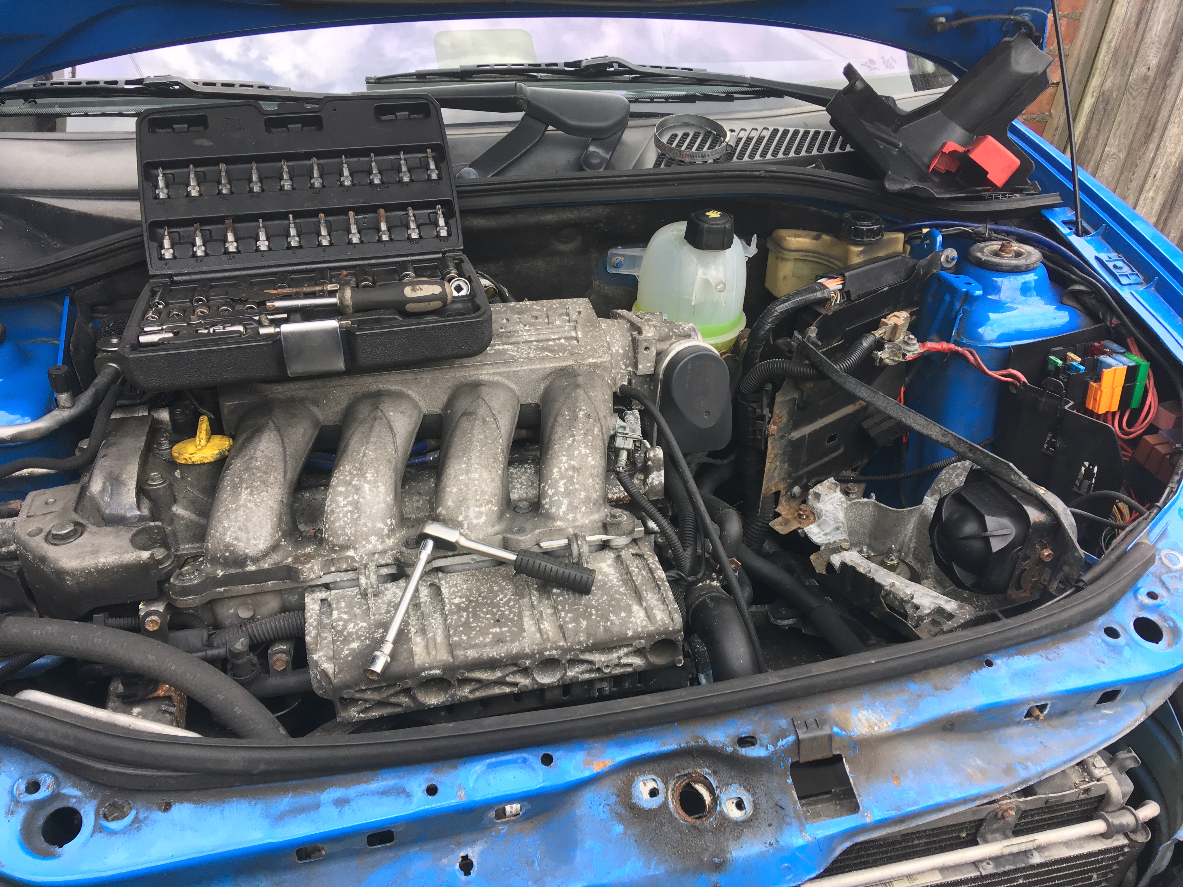

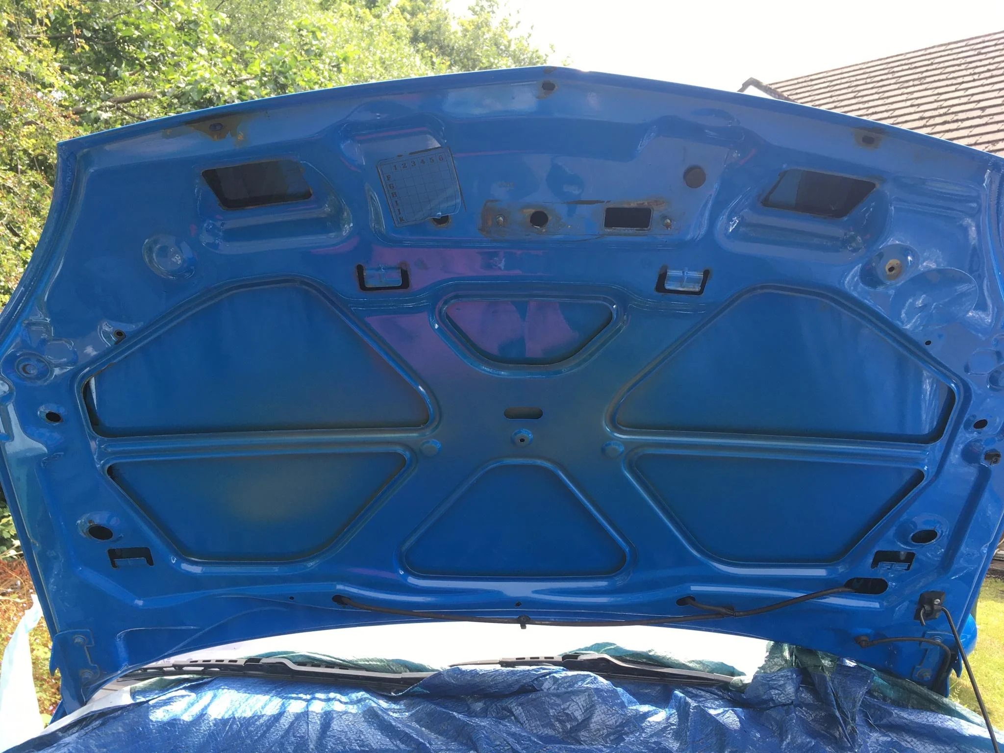

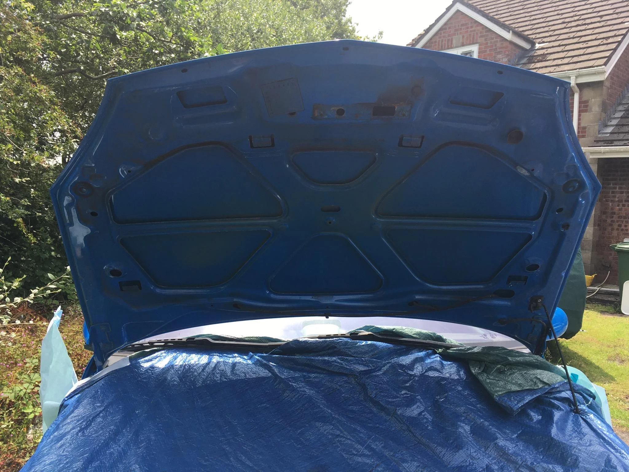

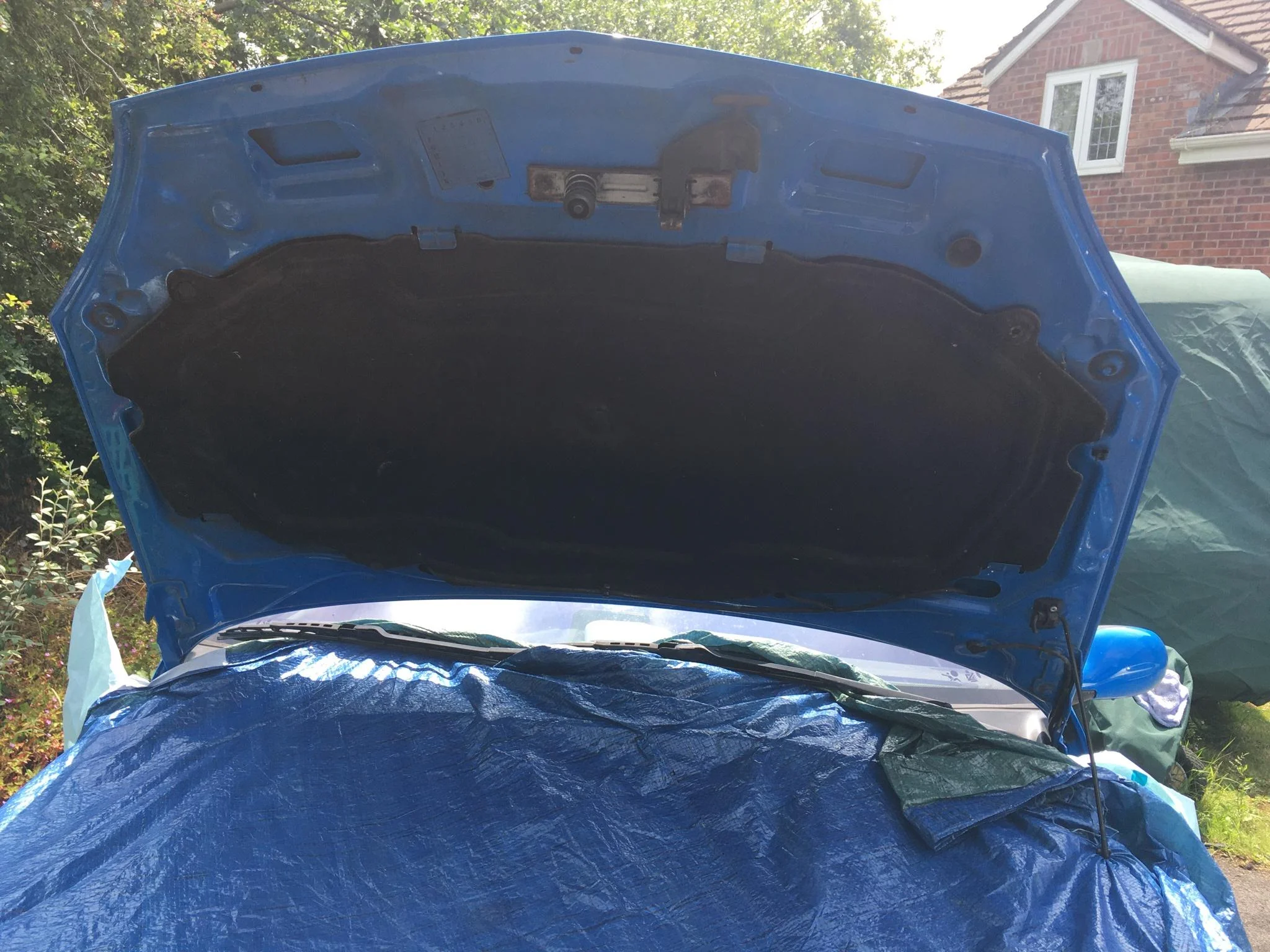

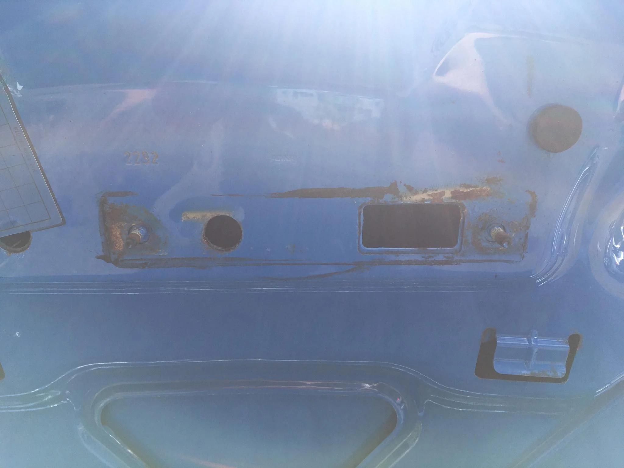

I also wanted to check out the bonnet and treat any rust.
removed the sound/heatproofing carpet
A new bonnet catch is on the list but for now i'm just going to clean up and grease the old one. Cleaned up the bonnet
I think the bonnet will need a respray at some point anyway so I'm just going to treat the rust and repair with the airbrush.
Treated with hyrdate80 and filled some of the main cavities with bilt hamber
I will then zinc coat and touch up with the airbrush and J45 then clear and cut it back.

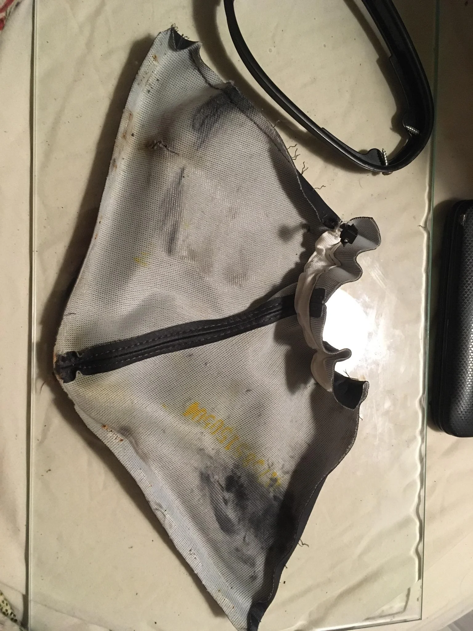

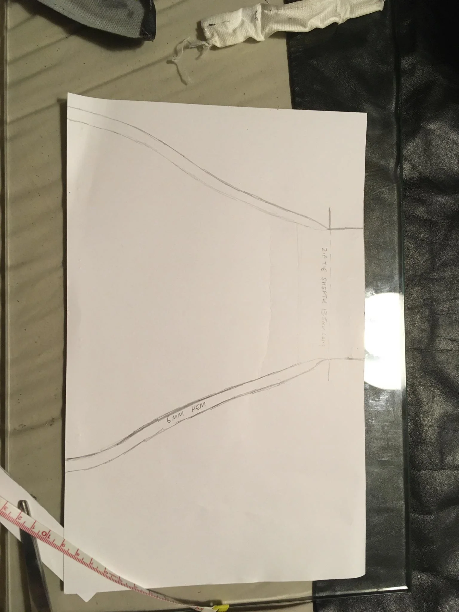

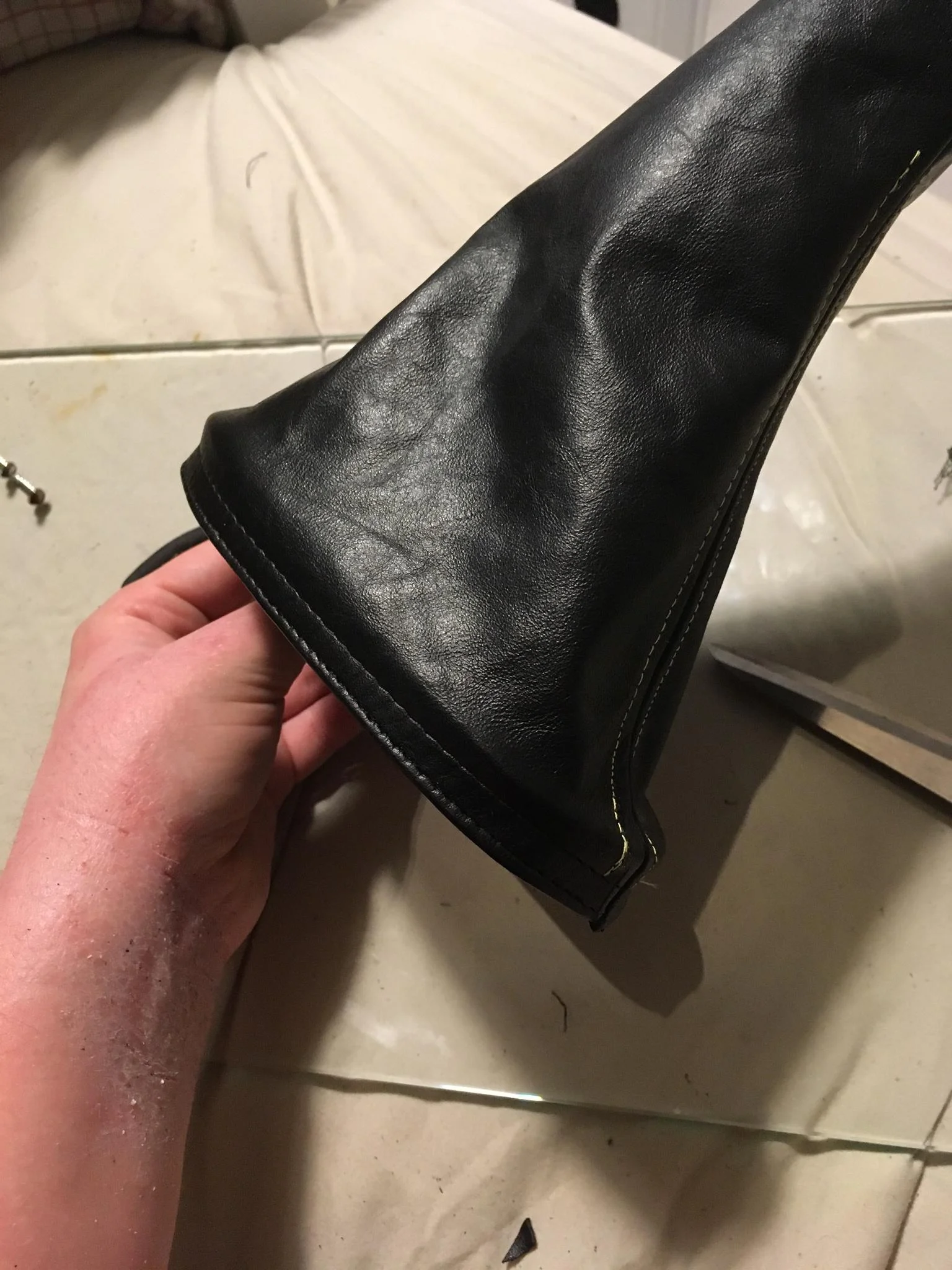

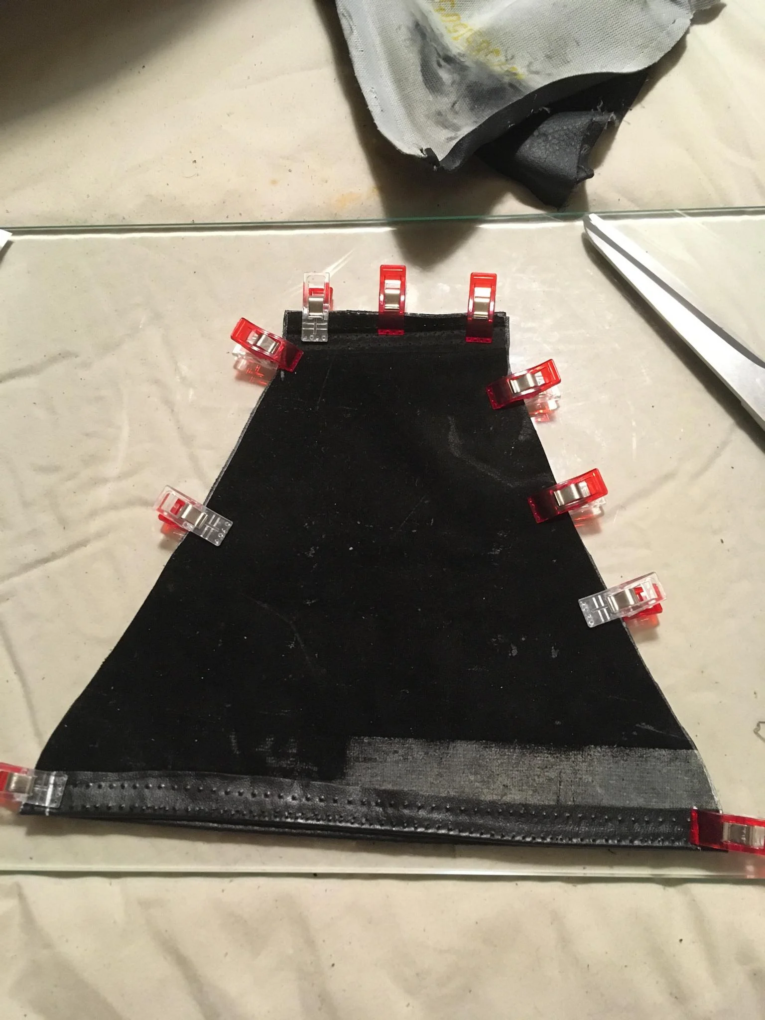

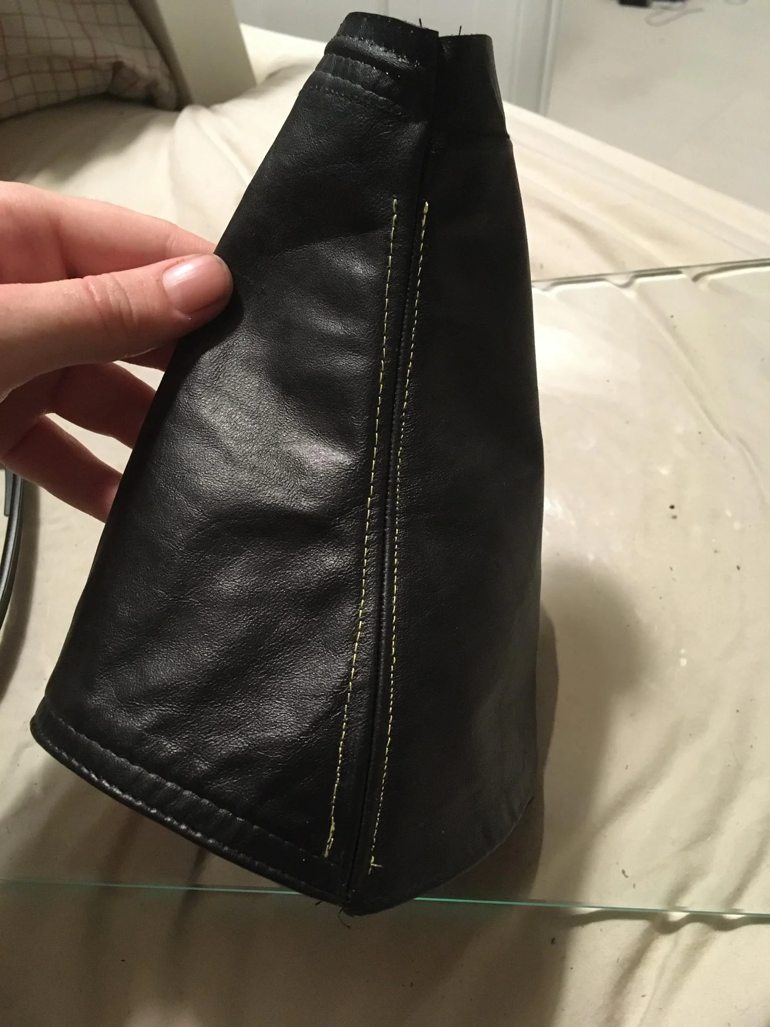

I had a load of leather offcuts and my gaiter is a bit tatty so thought I'd have a go at making another.
Made a pattern from the old one
I regret the yellow stitching as it's naff, The machine I'm using is older than I am and I'm sure the timing is out. Its very hard to run a straight stitch but it will do for now. I will make another with black stitching.

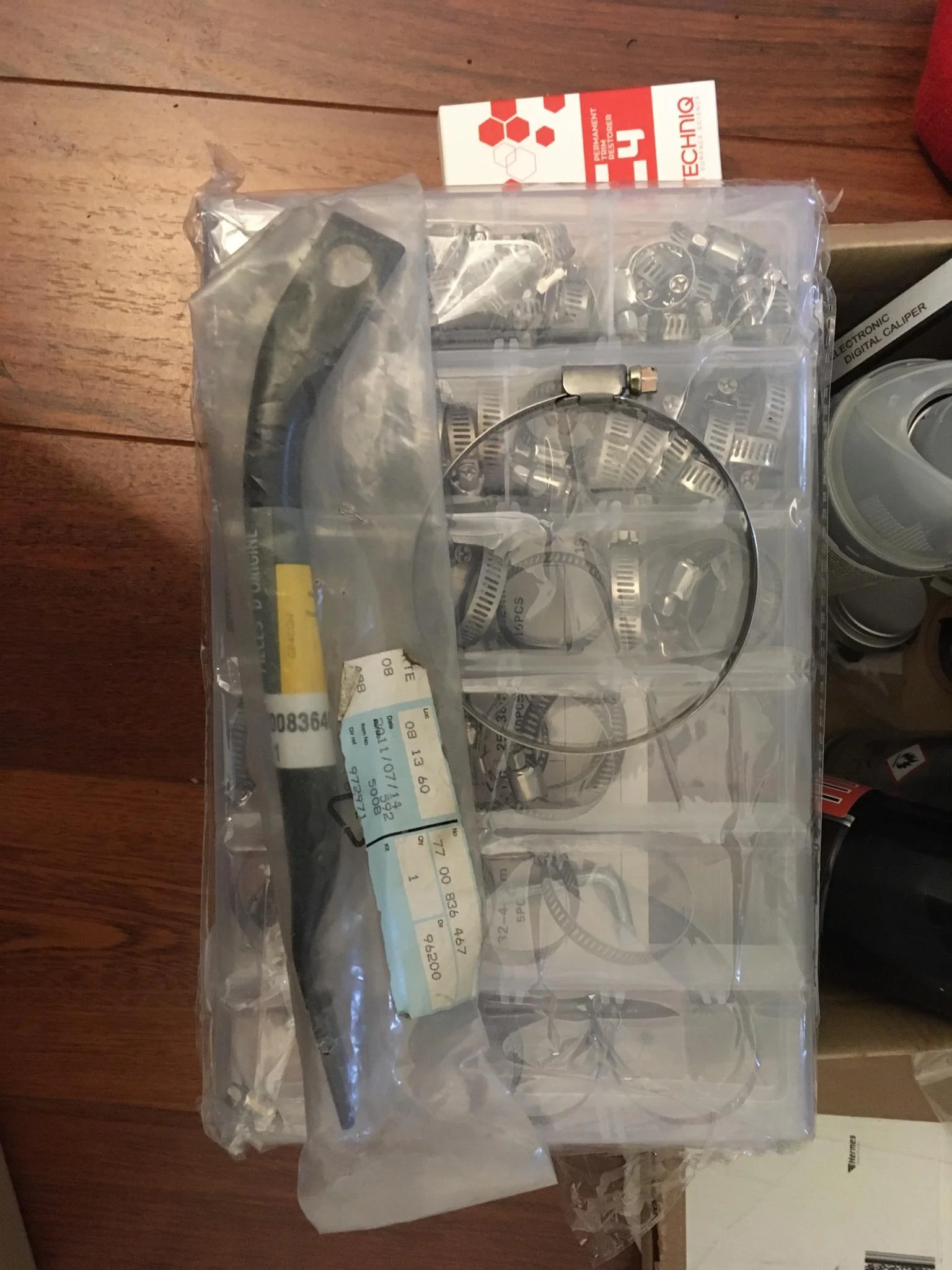

Some more goodies arrived. I managed to get the passenger side subframe brace bar thingy brand new. For some reason the left side components are in a worse state than the drivers side. I'm plodding along little by little.

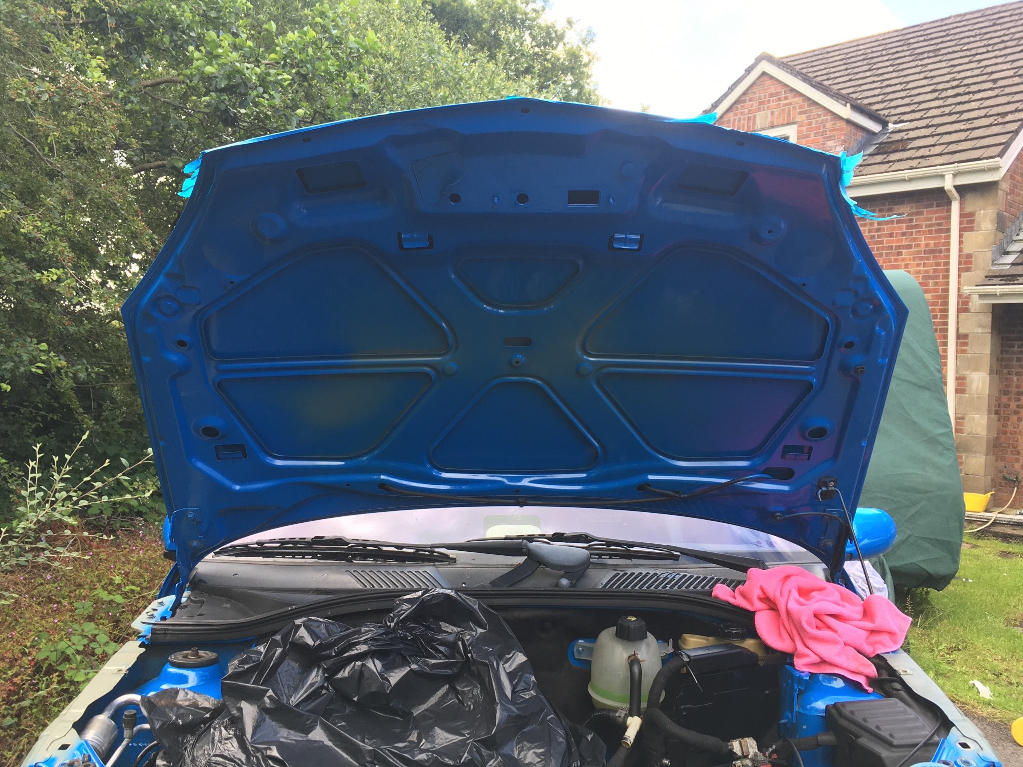

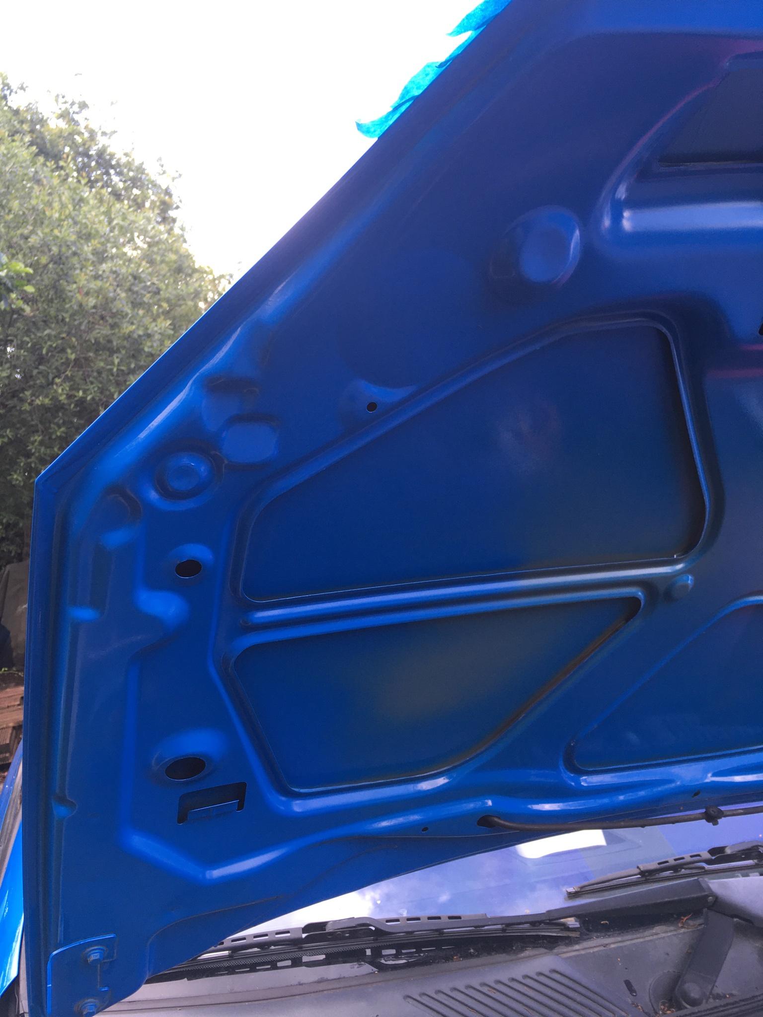

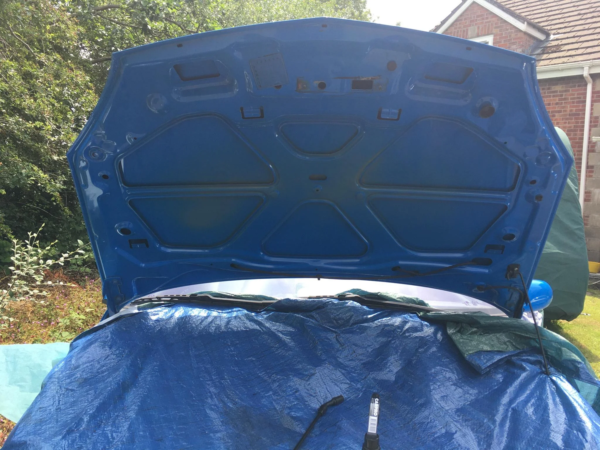

So I touched up the underneath of the bonnet. The blend is already pretty good but I can always cut it back once it's cured, It's not high on the list though as it looks acceptable for the underneath of a bonnet.
I was a bit lazy so excuse the over-spray. The washer hose will be replaced anyway and I will get around to cleaning up the plastics.

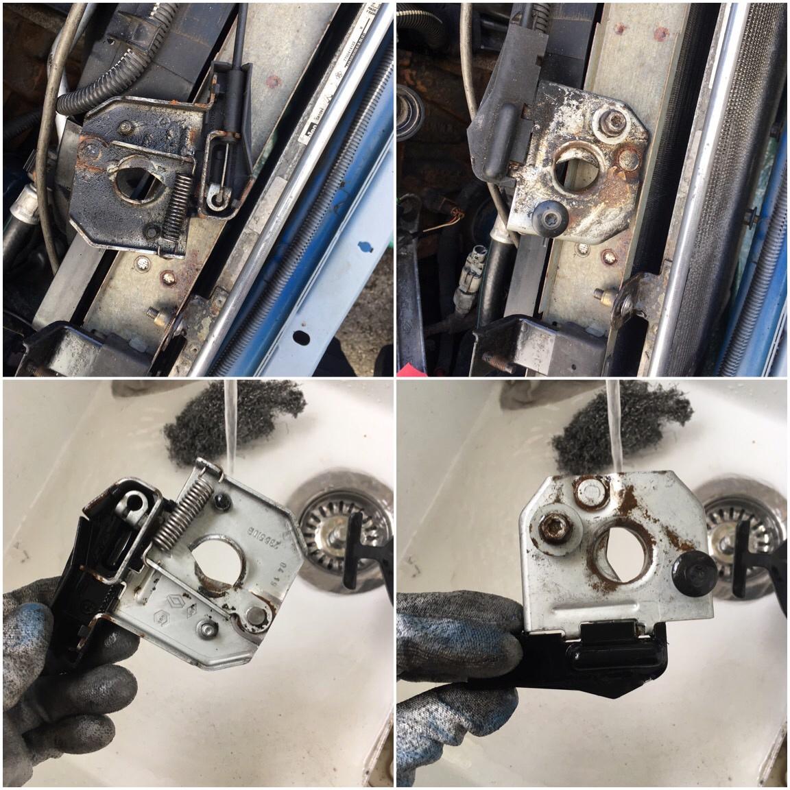

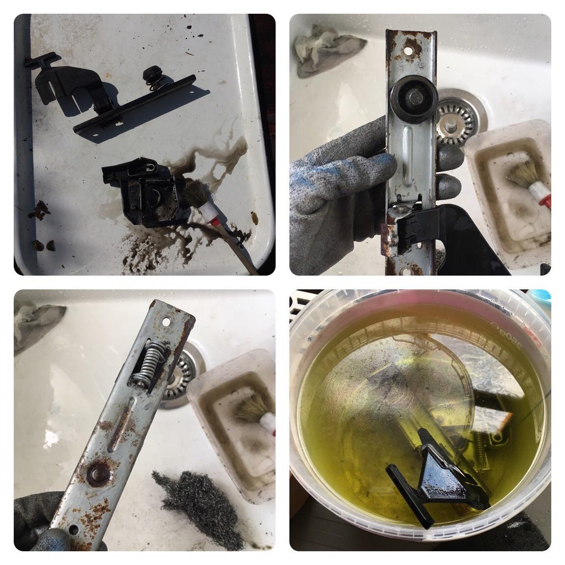

I took the latch and catch off for a good clean also

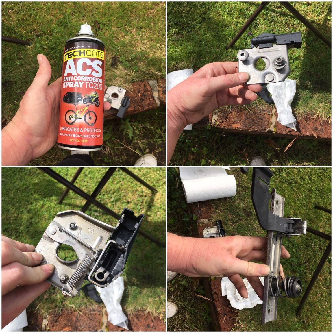

I then gave them a rust bath for good measure and then a coating of ACS 200, which I find lasts longer and preforms better than ACF-50
I will let it dry and then grease the springs and catch back up.

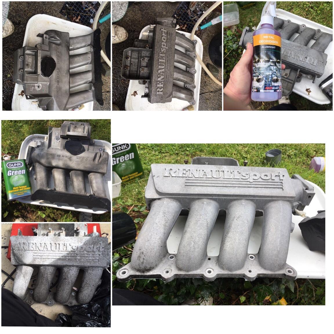

The inlet got a wash with de-grease, I also tried some alubrite to see if that helped clean it up

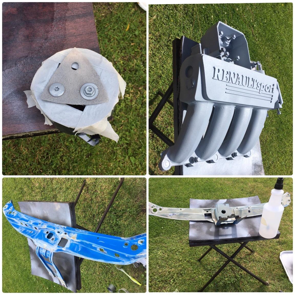

Gave the inlet a few coats of etch primer, and started prepping the slam panel. Snapped the clip strike plate bit while getting it off which is annoying. If I can't get hold of a replacement I design and print one.
I will see if I can make my booth a bit bigger for some of these parts while it all cures, they're still small enough for my airbrush which gives a much nicer finish than rattle cans or a my cheapo spray gun.

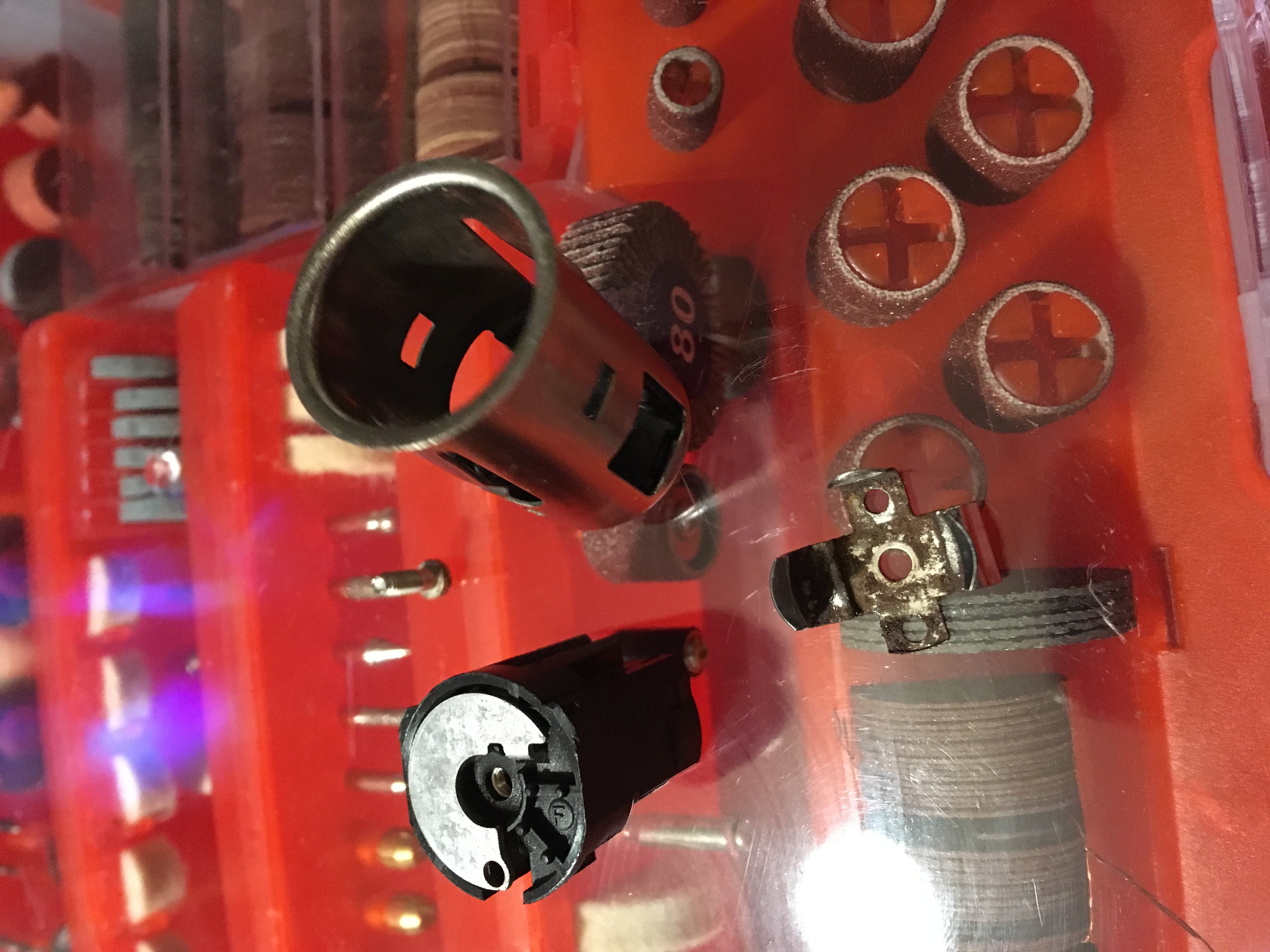

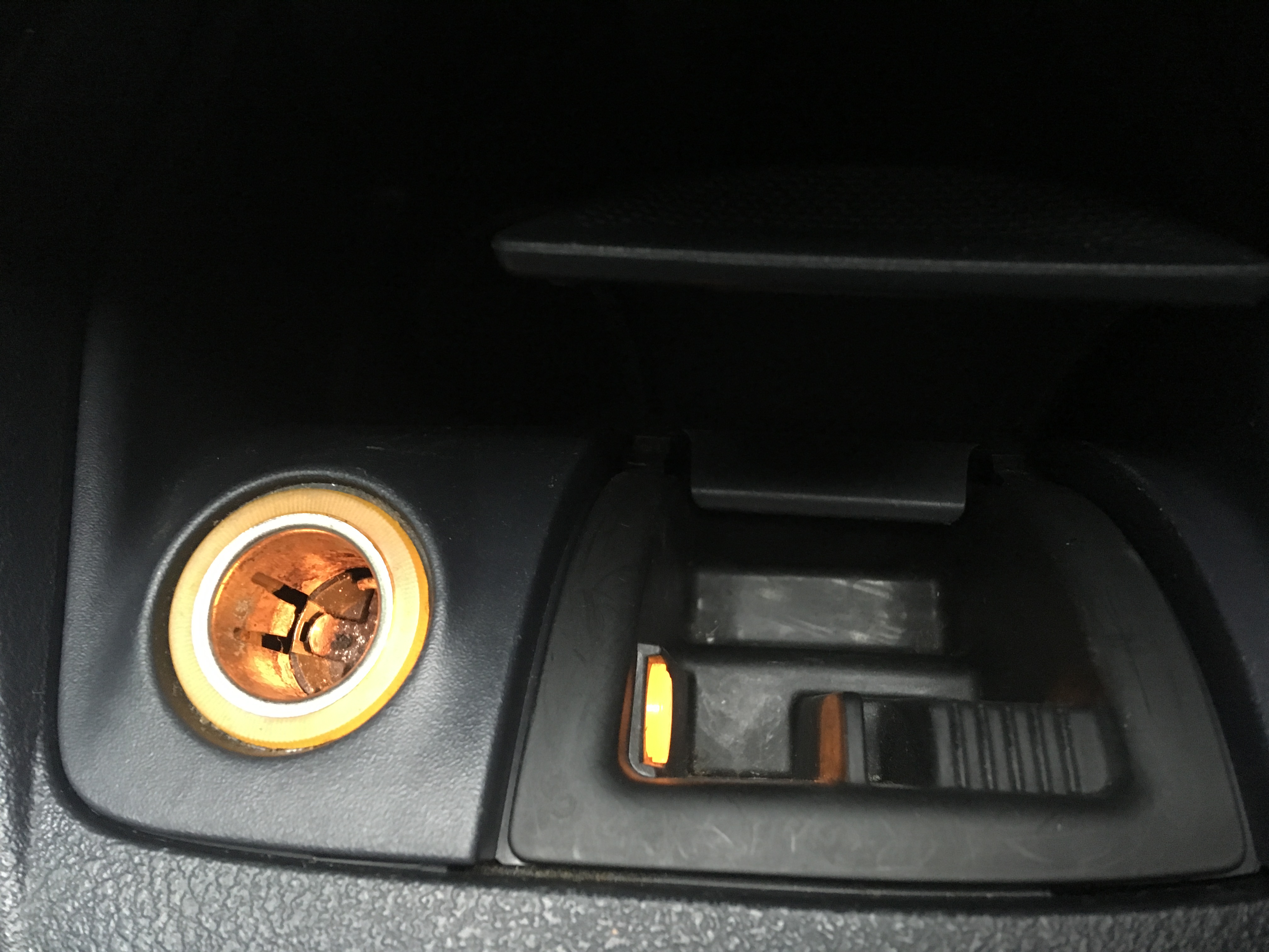

The cigarette lighter isn't working. Having a squint down in there, its very rusty! so I took it out and got the Dremel with a wire brush attachment to sort it out

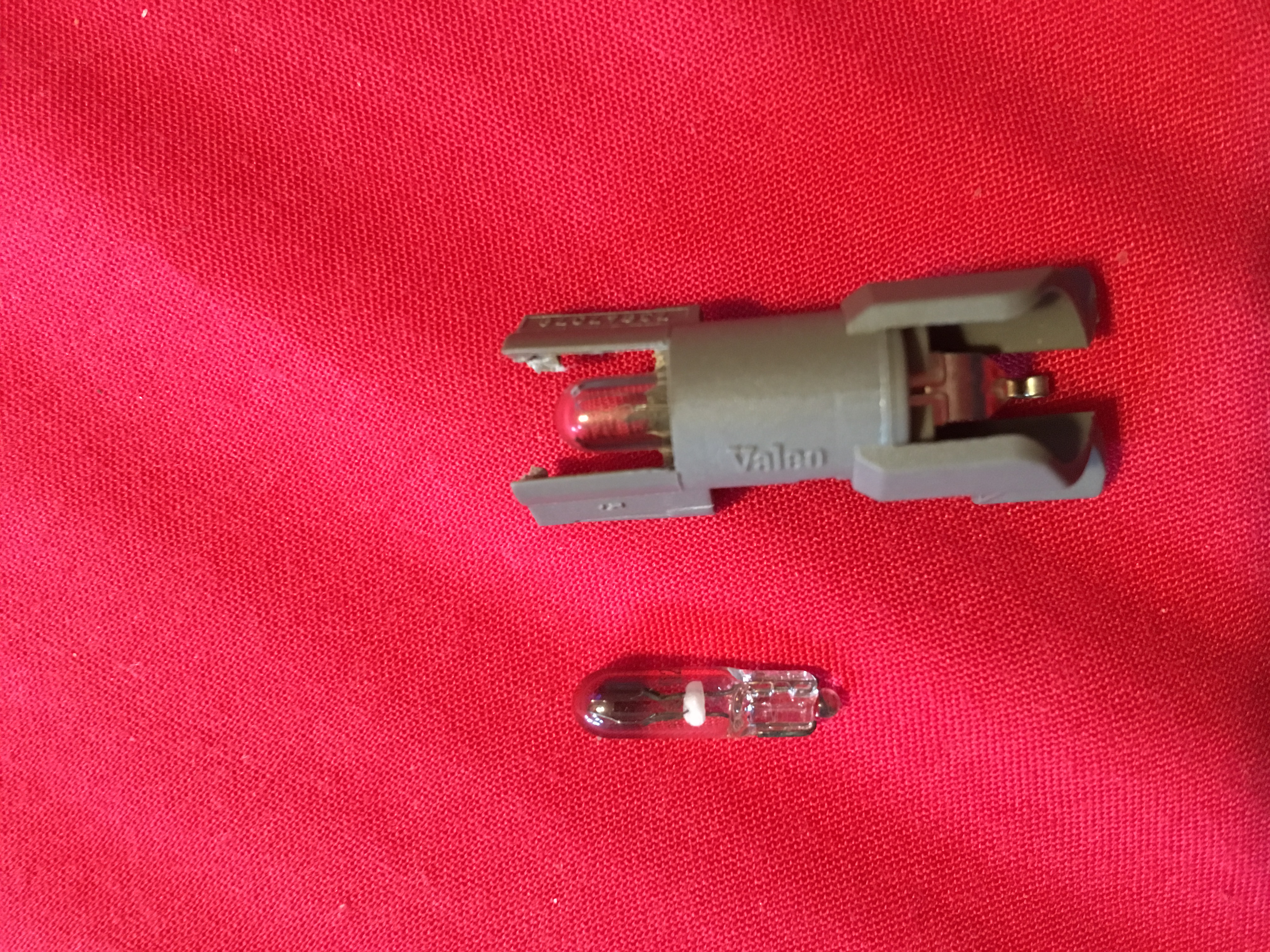

I also saw there was a light that was not working, so I got hold of the bulb and changed it
I forgot an after picture but the contacts were all clean and it all works fine now

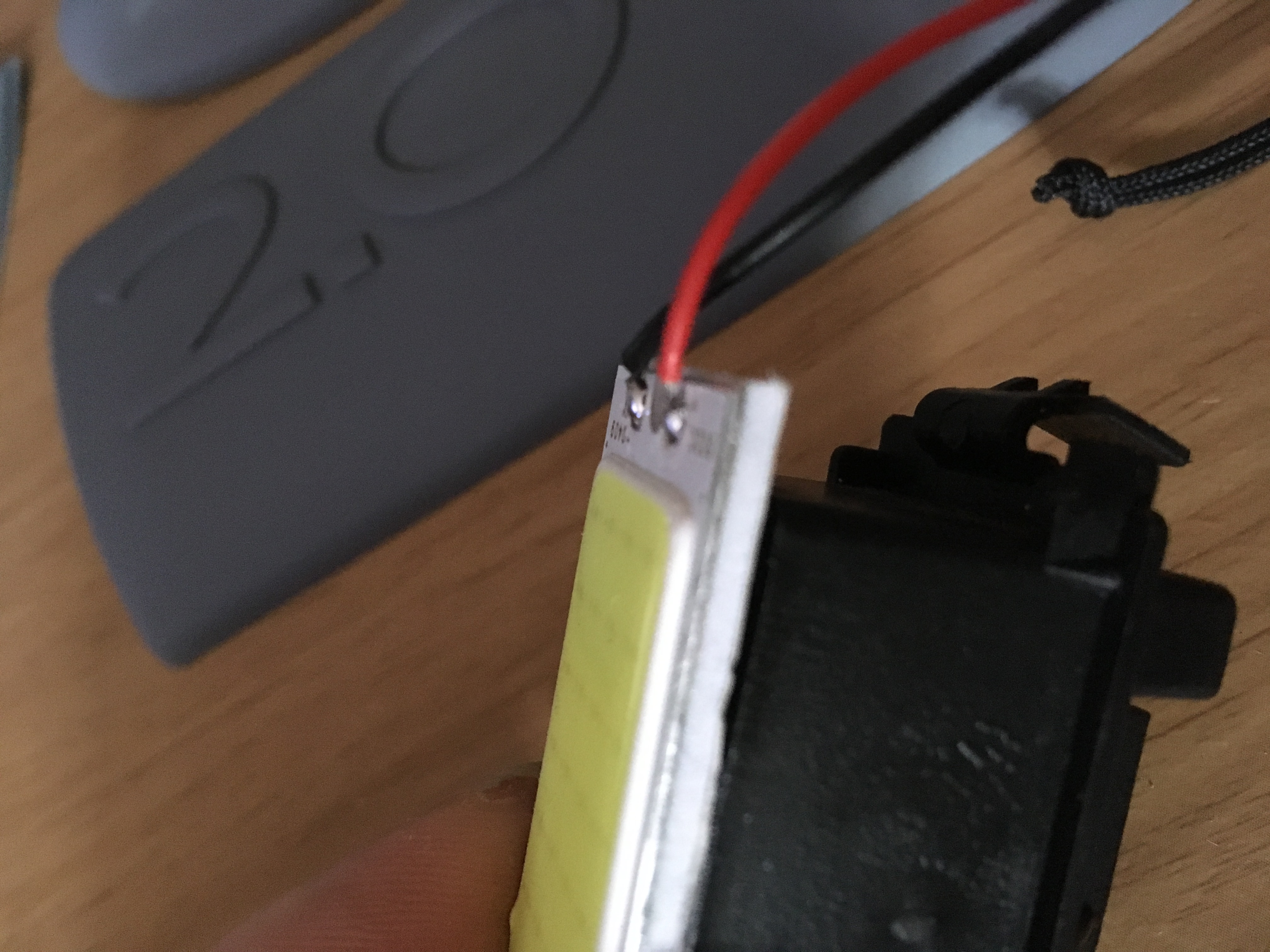

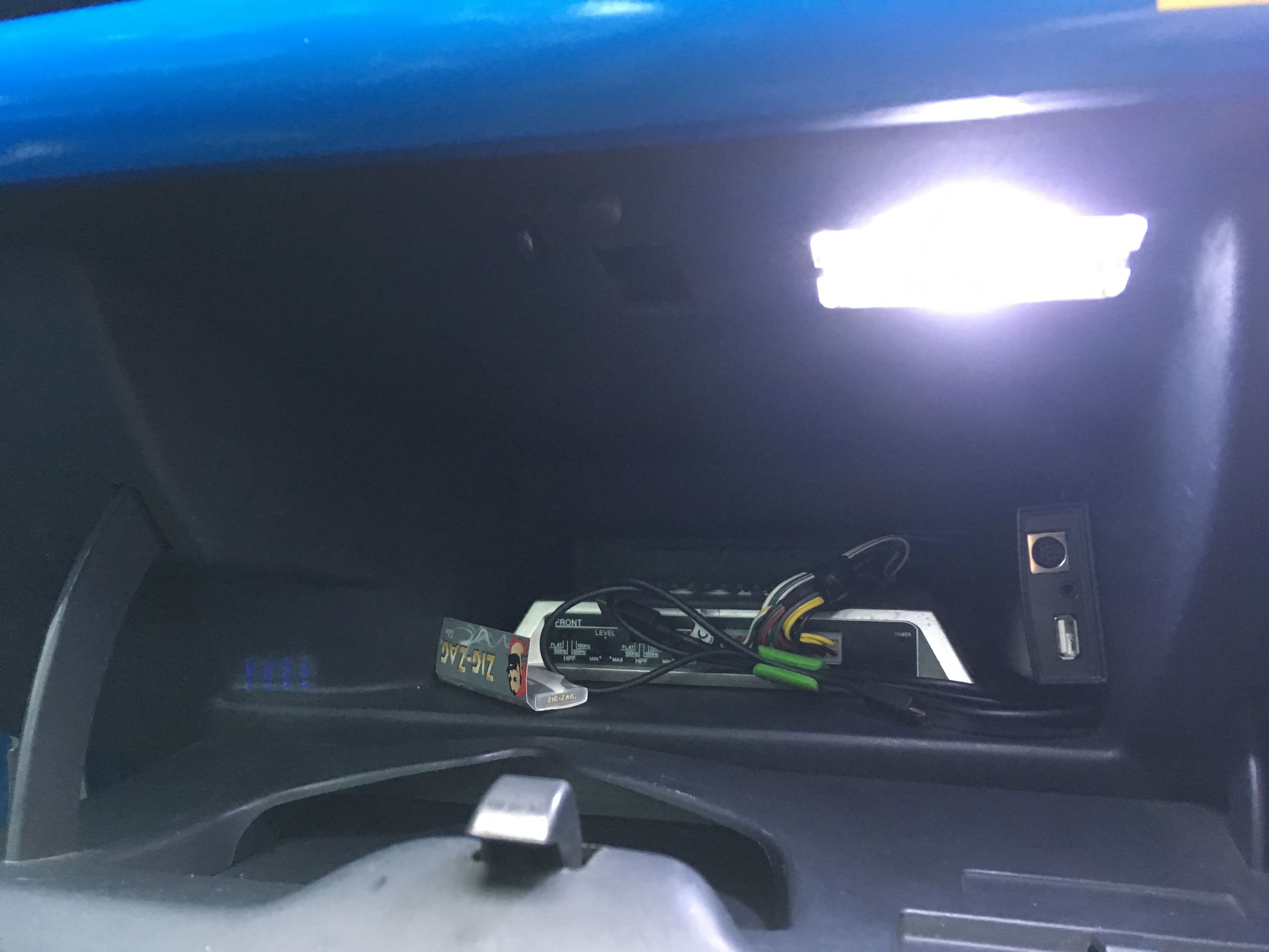

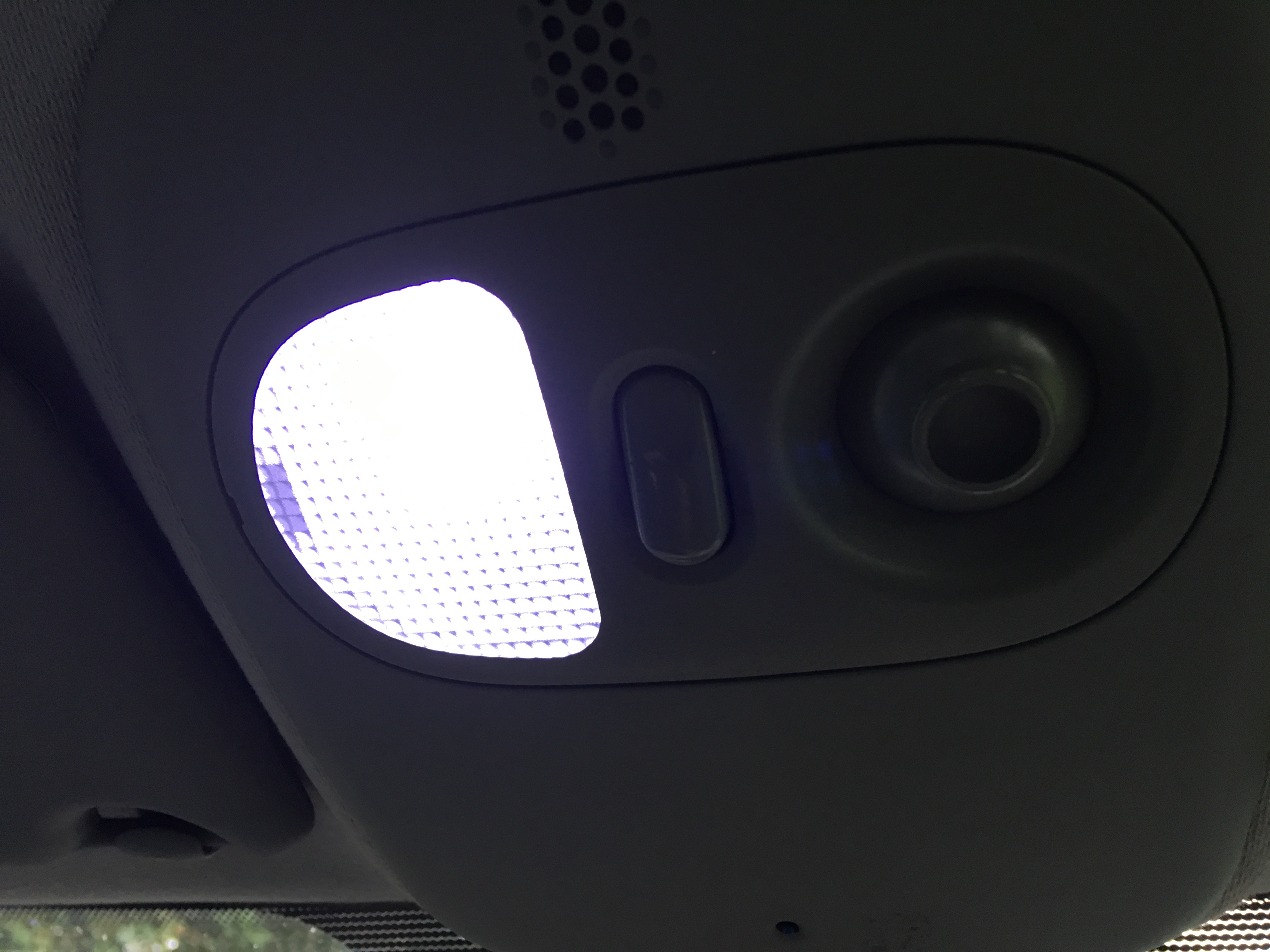

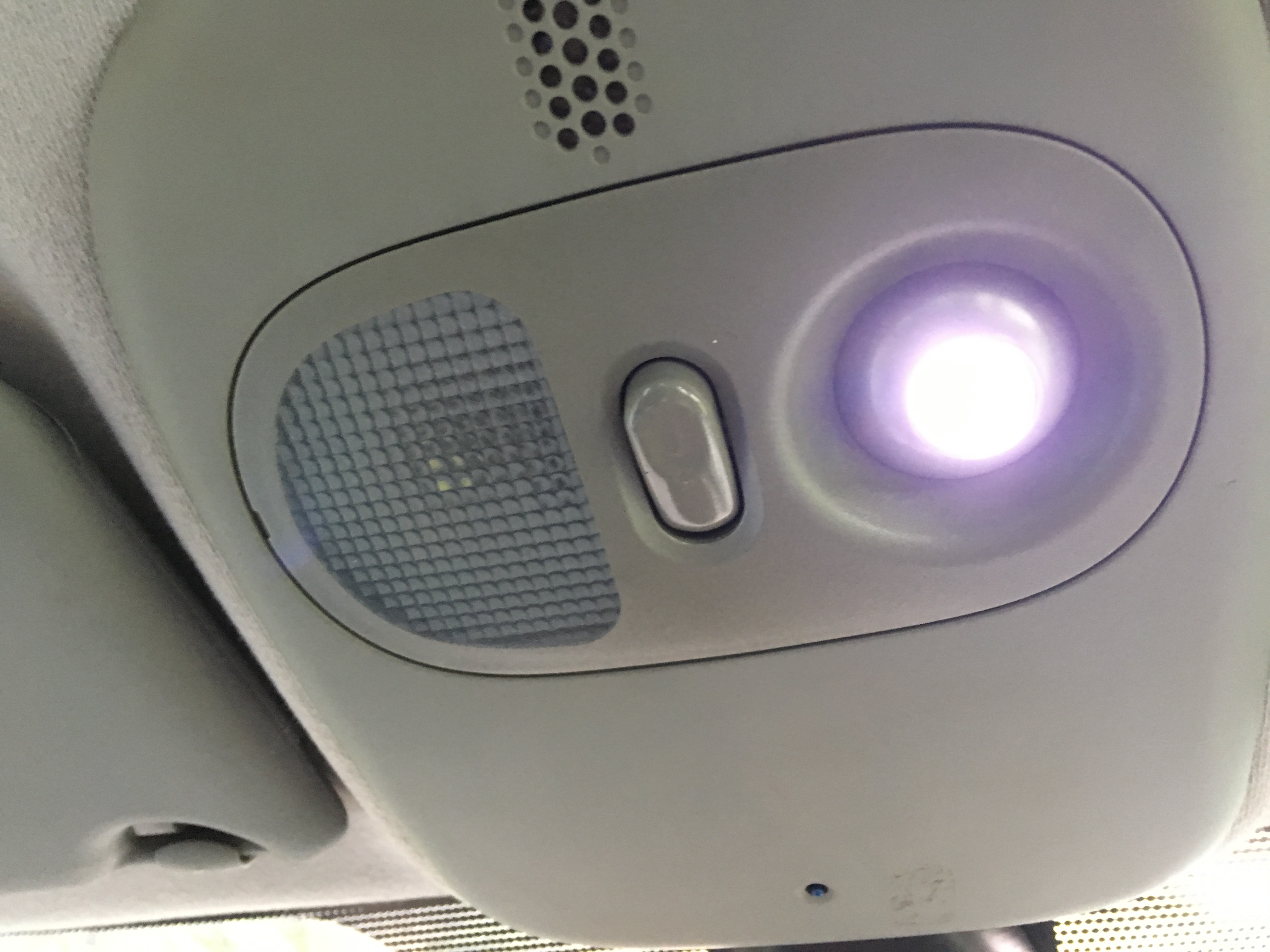

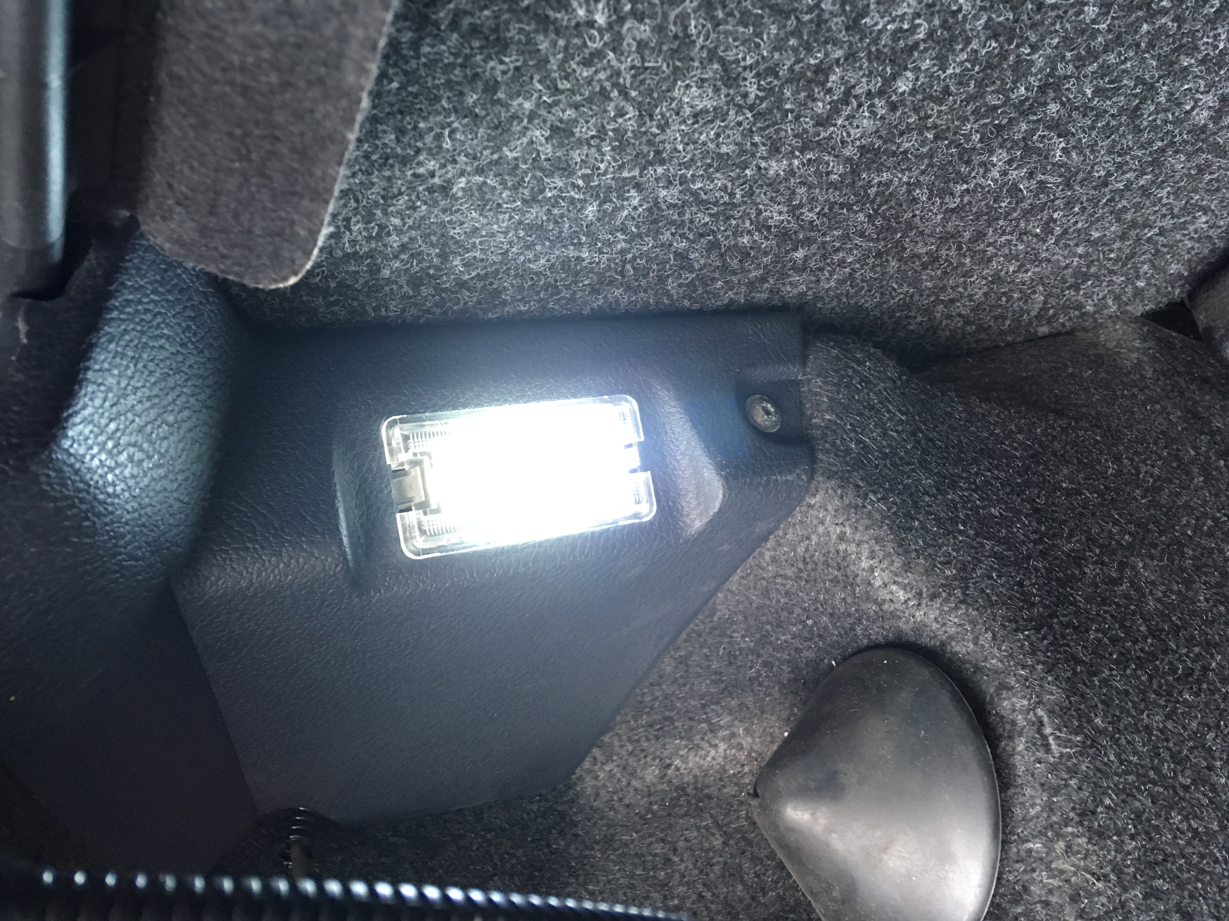

Changed the interior lights to LED's also, they actually light things up now!

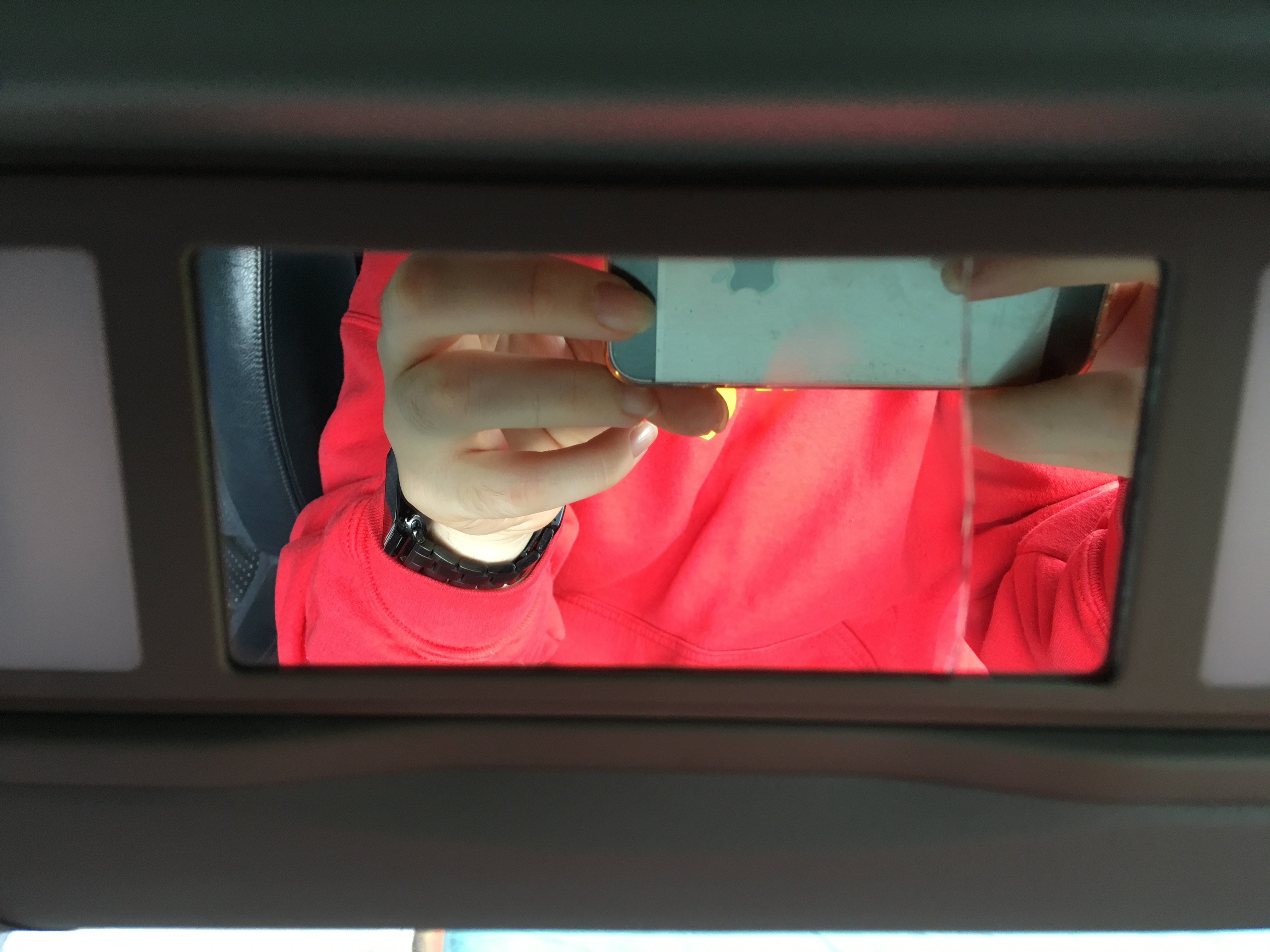

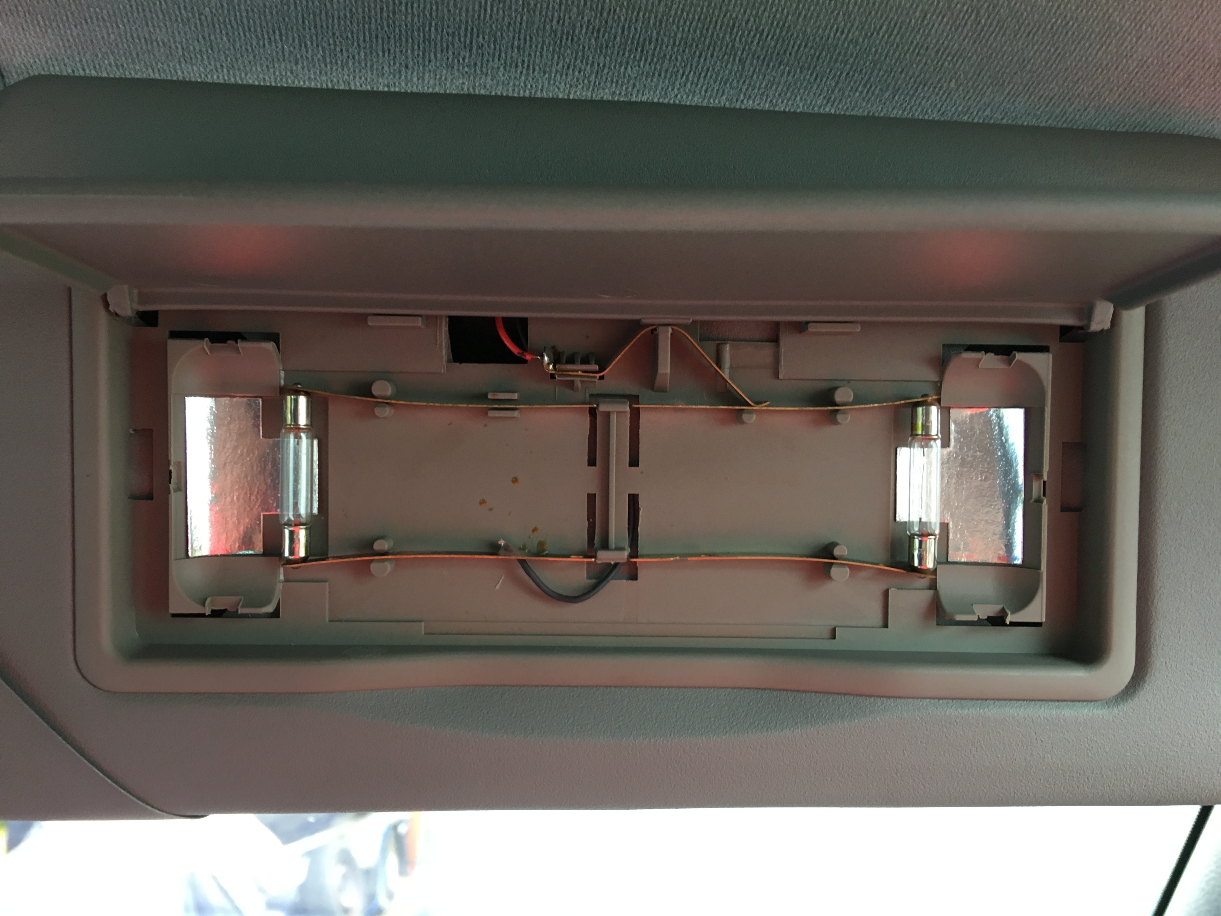

I broke the mirror putting it back ... A new sun visor is now on the list

What was the bulb in the cigarette lighter please? I’ve tried search’s but can’t seem to find out what it is.

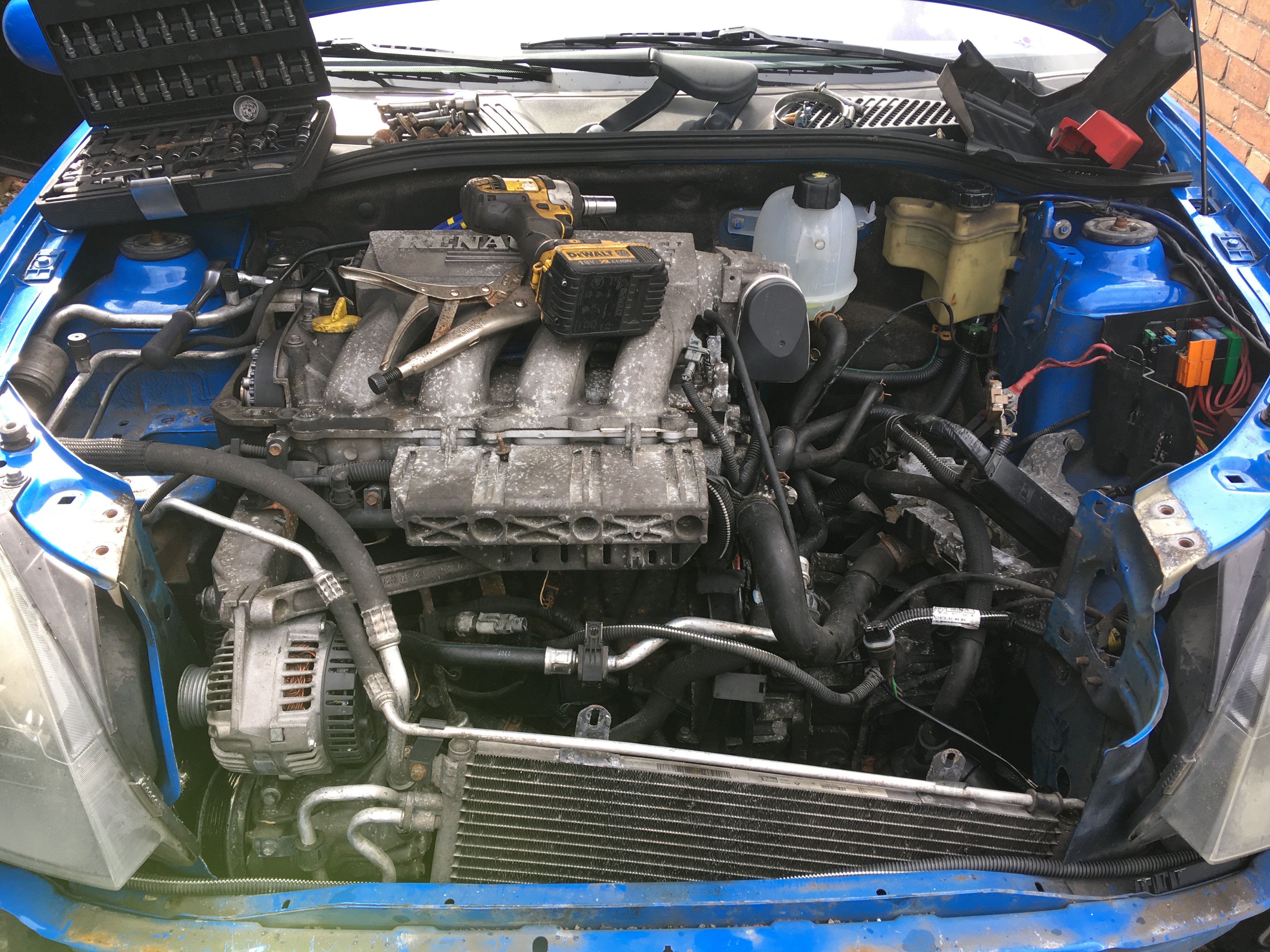

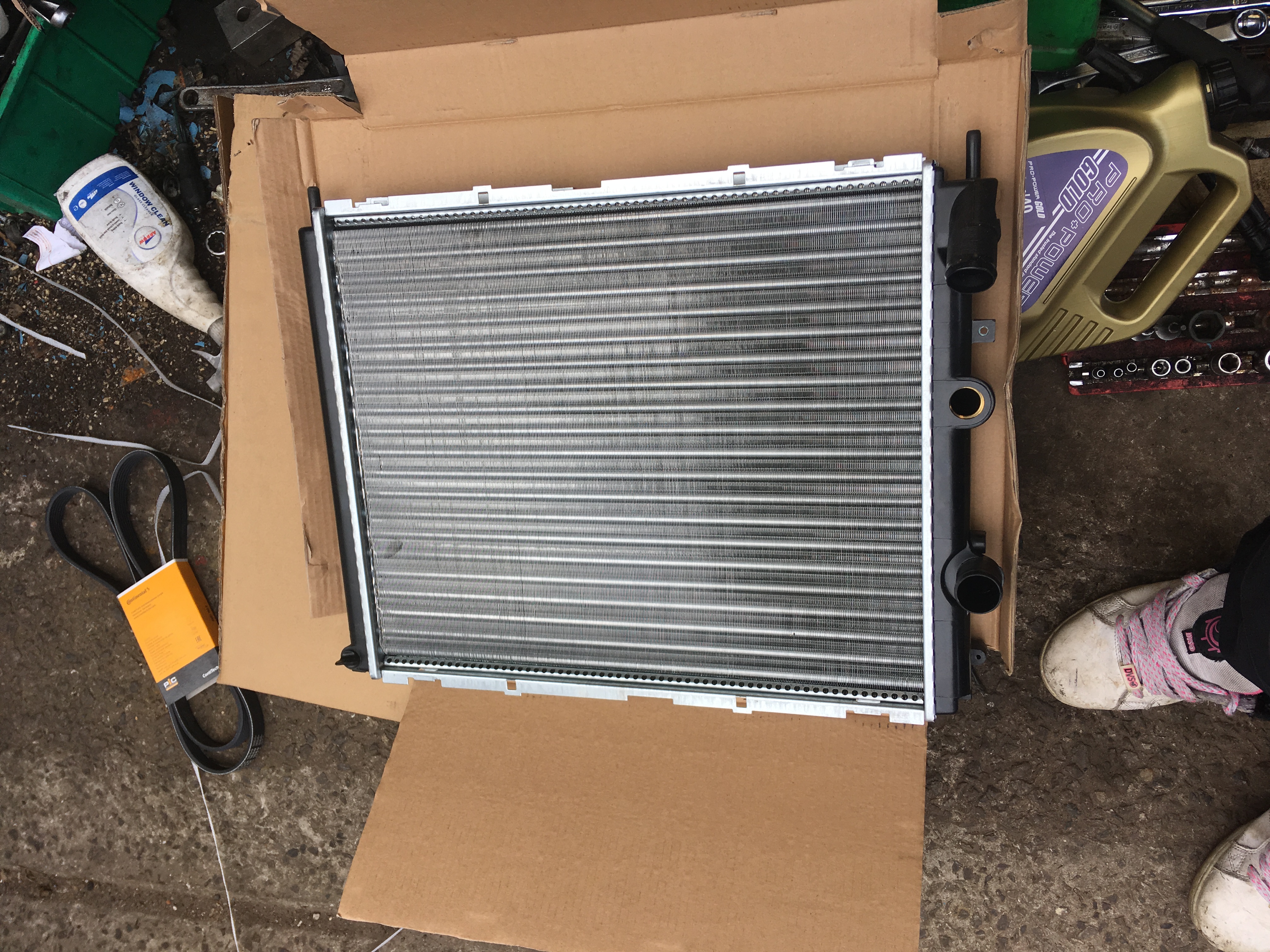

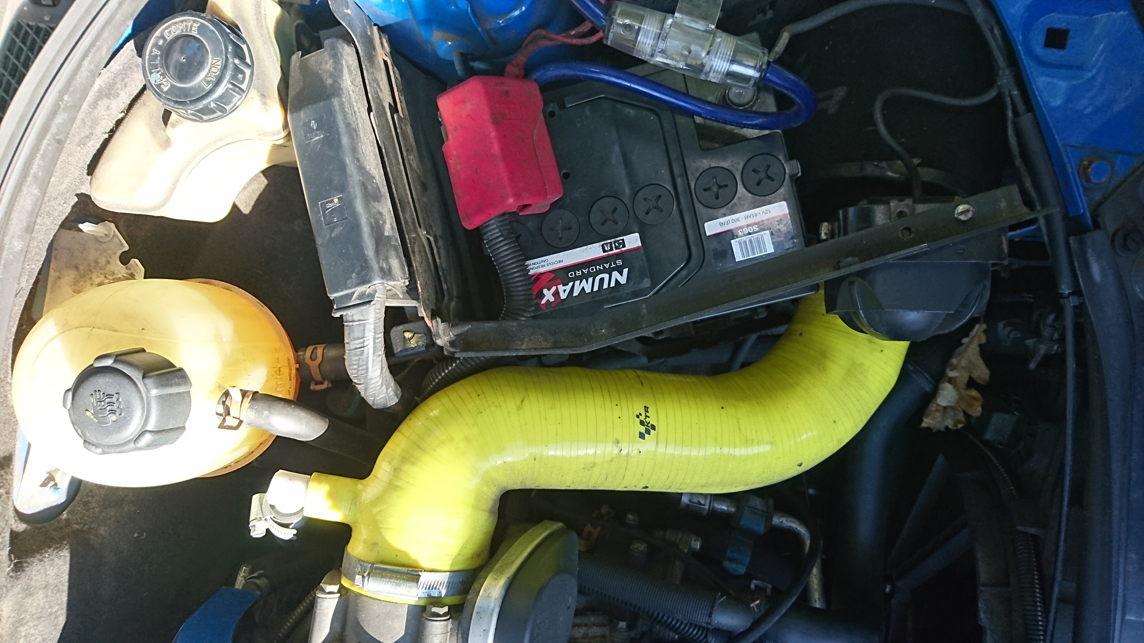

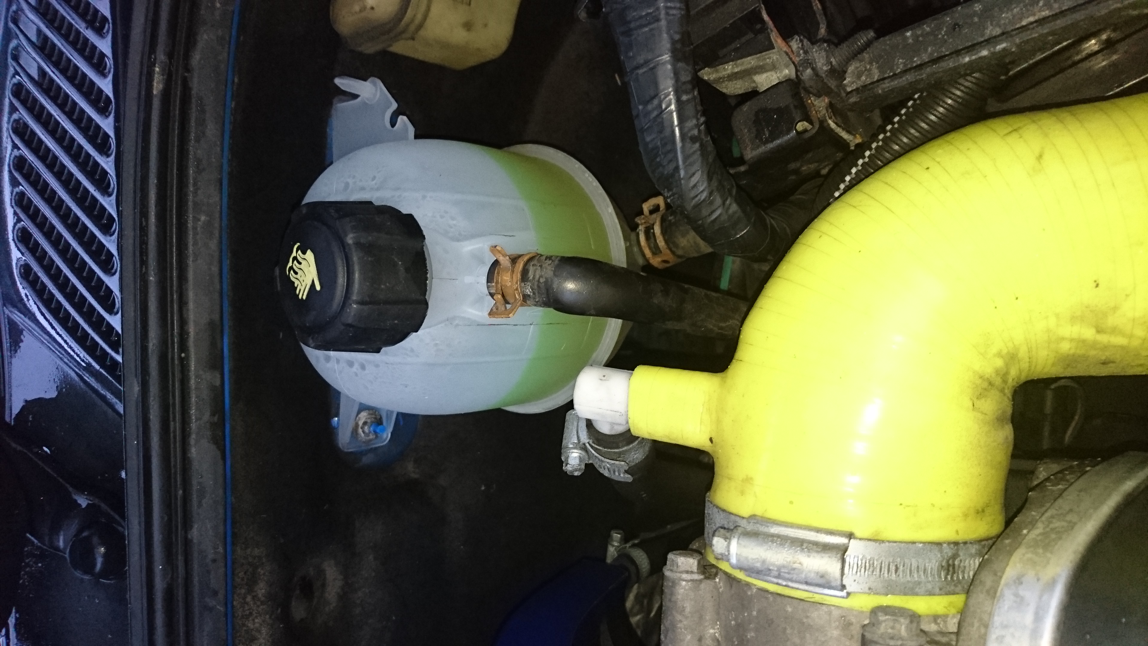

I noticed that my coolant was dropping below minimum after a drive. I pressure tested it and there was a leak when pressurised, a hole in the radiator so I changed the bottle, flushed the system with distilled water and replaced the radiator. Re-filled with Type-D
I was also having an intermittent problem with car and the battery dying! I tested the alternator and it wasn't charging so I got a second hand alternator, and will change the belt at the same time.
This car is a nightmare to work on, there is no space anywhere!
very nice!
Found a leak on my rad aswell thinking about fitting new one myself. Bit intimidated by the condenser though haha did you have to do anything with that or just push it to the side?
