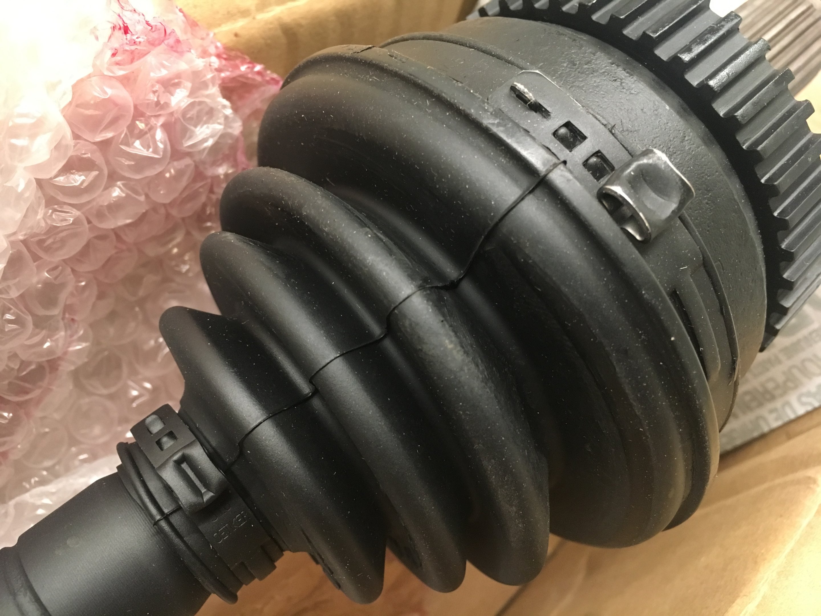

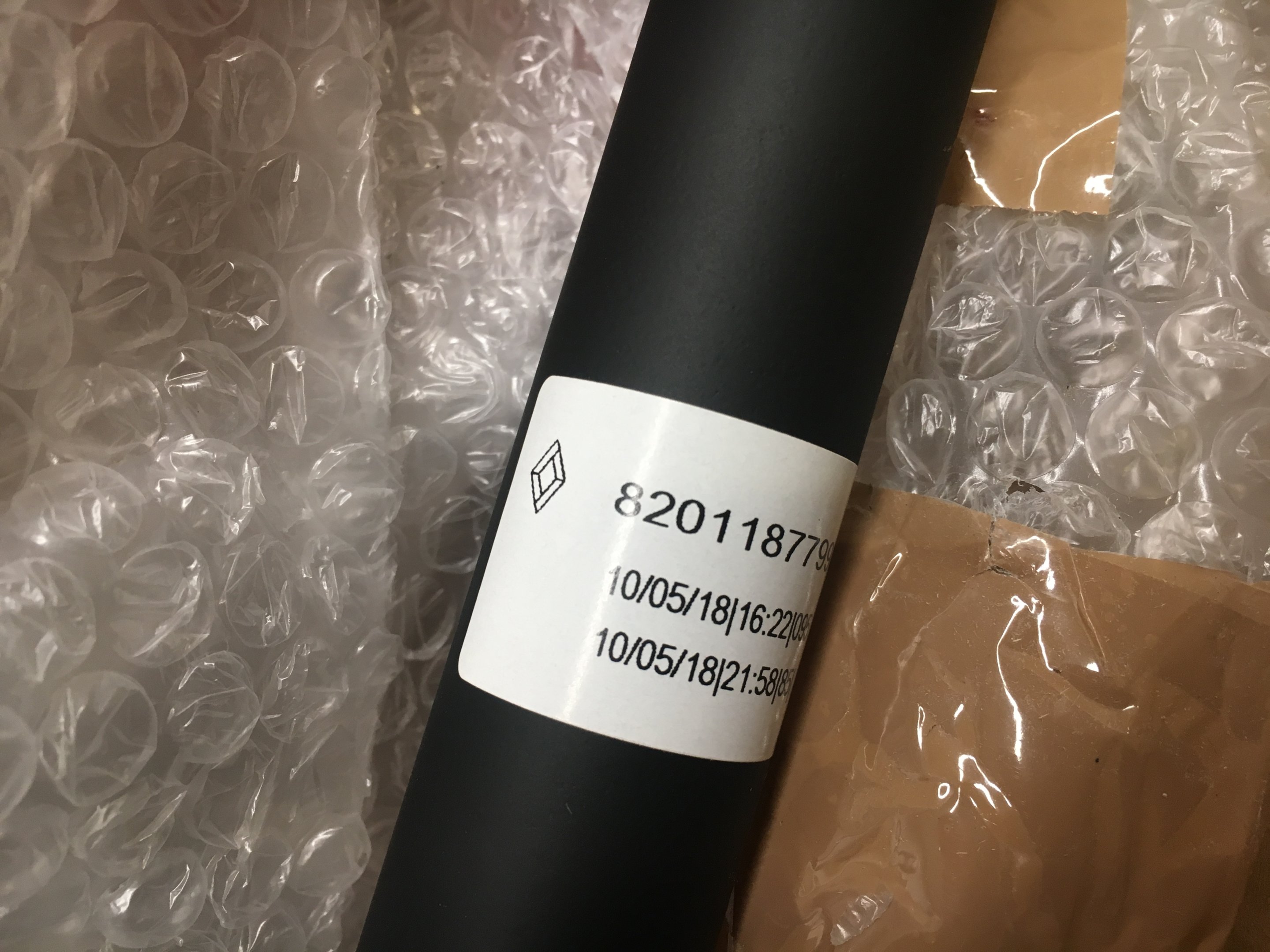

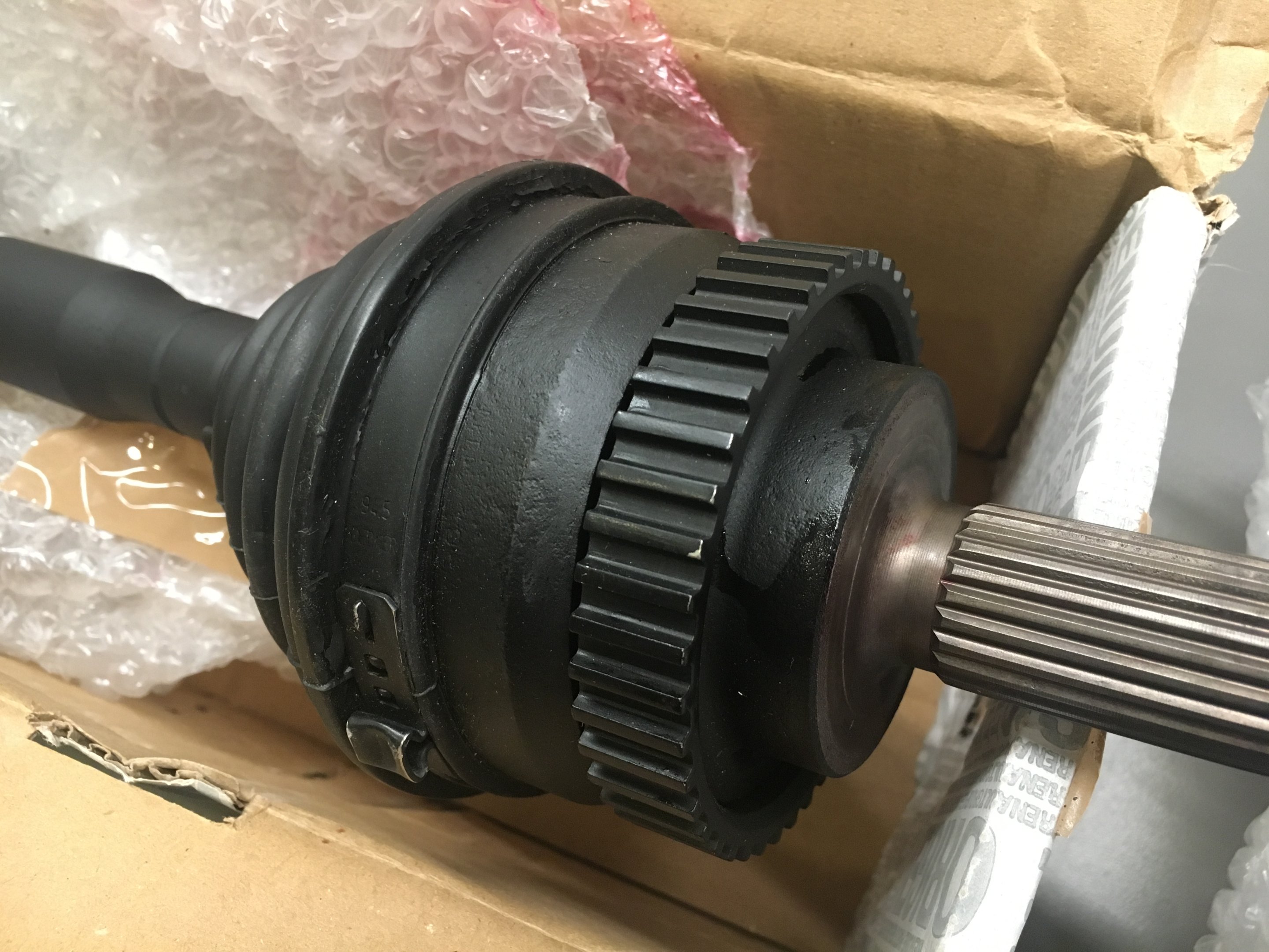

Looking at the shaft, you can see pitting and that it’s all been painted (all Looks professional, but shows that it’s not brand new)
Quality of clips and rubber boots doesn’t look to be up to the standard of the brand new genuine Renault driveshaft thatbi received for the other side.

The splines on one of mine removed were corroded to hell and the entire driveshaft looked well past its best. They must do a fair amount of work on them to refurb them. I wouldn't bat an eyelid at the example posted above.

For me, the biggest problem is the movement in the outer joint. There's significant resistance and when it does move, the movement feels particularly rough. Just like a shaft where the boot split and someone has been driving around for a while with it like that - grease gone with dirt and grit in there instead. I'm suspecting that insufficient work has been done to that joint to get it up to standard.
