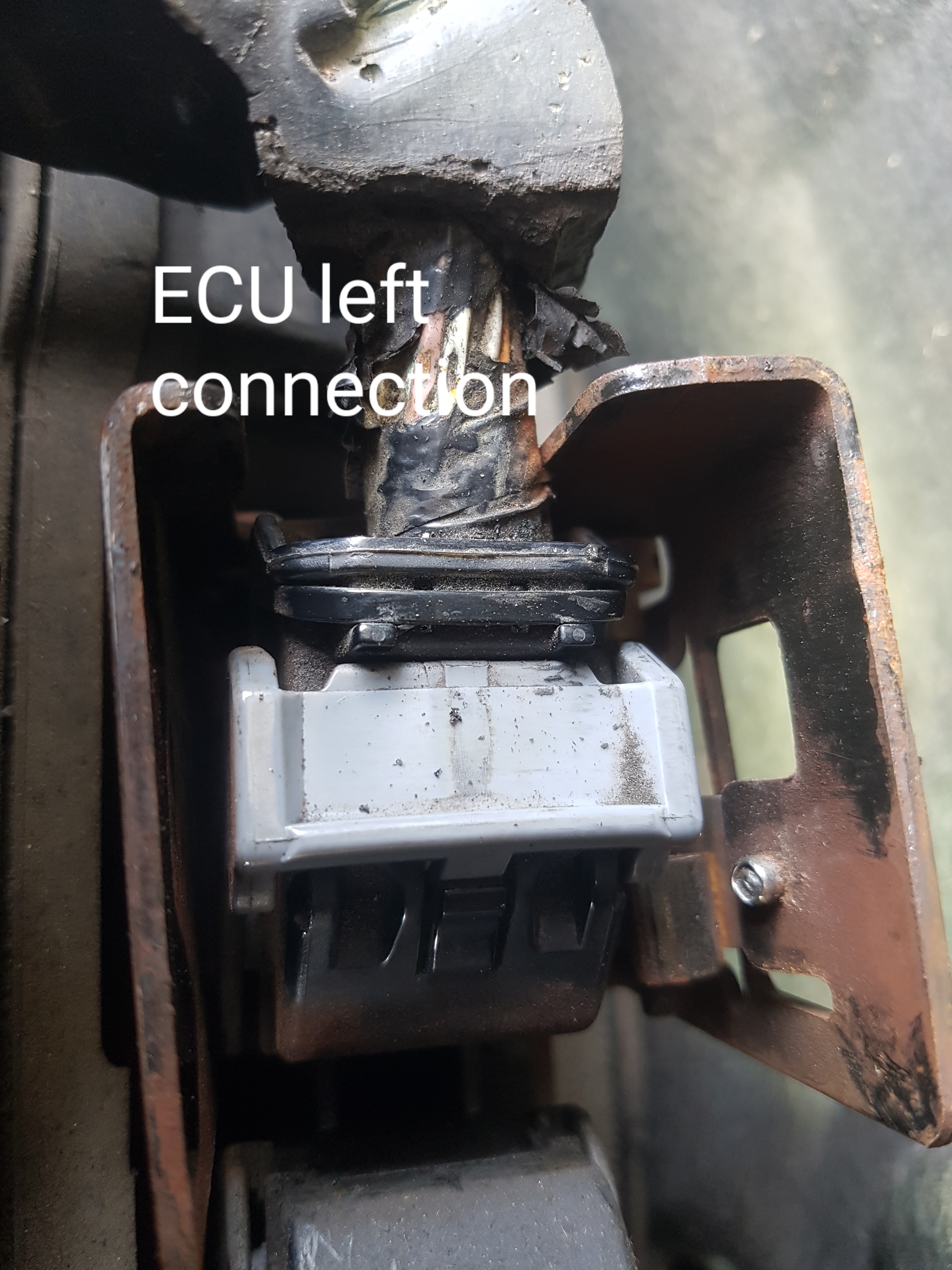

I have a Renault Clio 2 4df 712 1.2 16v Engine , with a Magneti Marelli 5NR ECU
I need to check ECU signals
I am looking for the detailed Wiring diagram for the the Engine ECU .Fuses Relays and connections to the UCH.

Hi Brigsy
I found a D4F 712 CA ecu diagram.
It show 4 Rows 1234 and abcdef etc and 2 ecu plugs.
It looks like the right one Marelli 5NR.

Hi
Finally Traced the fault.
Bad connection to the ecu from Crank position sensor.
Replaced Sensor as well .
Used Intermotor Part . because a cheap one from Amazon Had a different resistance and gave lumpy running.
Diagram Verified many continuity tests.
