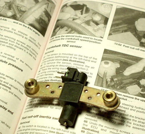

Ok having a problem with a friends car. Its an 02 plate with a 1.2 16v engine.
She says a managment light comes on when slowing for lights etc and it will cut out. She also says that if she unplugs a sensore which is placed at the top left hand side of the cam box it will run ok for a few hours. I am unsure of what part this is though, The numbers off the top of said part are
5 volt GND
106644
16220279
7700101762
Any help would be great
cheers Dave
TDC sensor looks like this:
It's a nightmare to get to though so probably isn't that.
