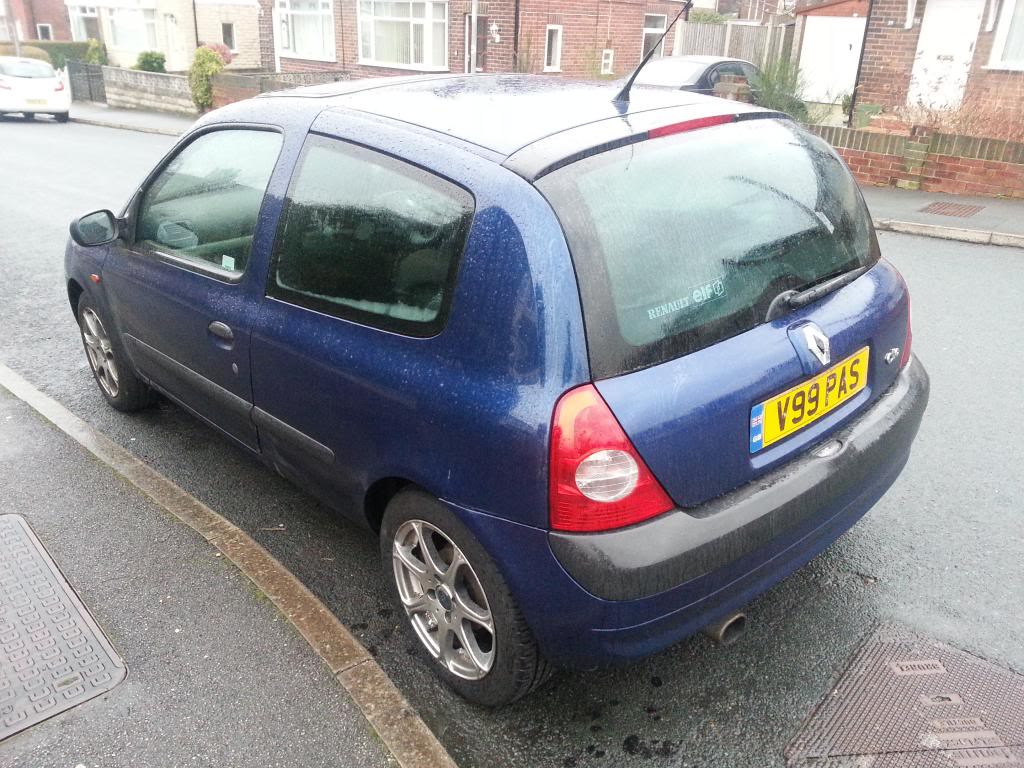

How would this help!! Having said that, don't think I have, sorry!! If you tell me what you would like photos of I can see what I can do!
Just I had a 1.2 16v on LPG. See of its my old one. Can't be that many about.
Sorry it's probably unhelpful
I will see if I can take a photo tomorrow. It is in blue and was bought from Andover. Vehicle was converted to Prinns by the local Prins specialist nearby.

Maybe not "tomorrow" as promised but see photo below!! Private registration though, and not the best photo, lost the one at the front...
