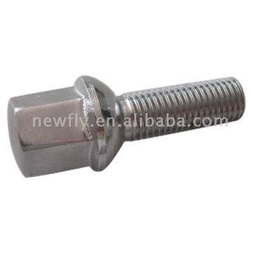

Have your existing bolts got a tapered head:
Or a rounded head:
If your original wheels are steel, chances are you'll have a rounded/dome shaped bolt. For alloys you need the top bolt, with a tapered head.
