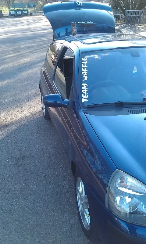

its a long project that will also need a respray in the same colour thanks to yobs and there mums door keys

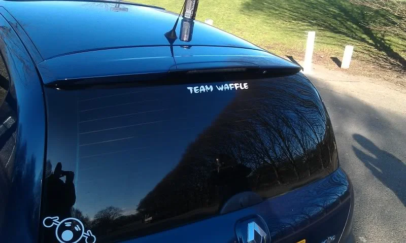

here are a few pics of my car
below is some of the outside...
not really any mods apart from a few stickers from the group im in with friends and the other sticker basicly explains everything

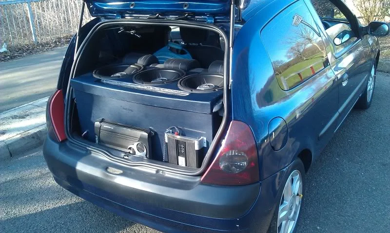

Yobs? I'm sorry, have you seen what's in your boot? :rasp: Must cause rear seat passengers genuine discomfort as well lol.

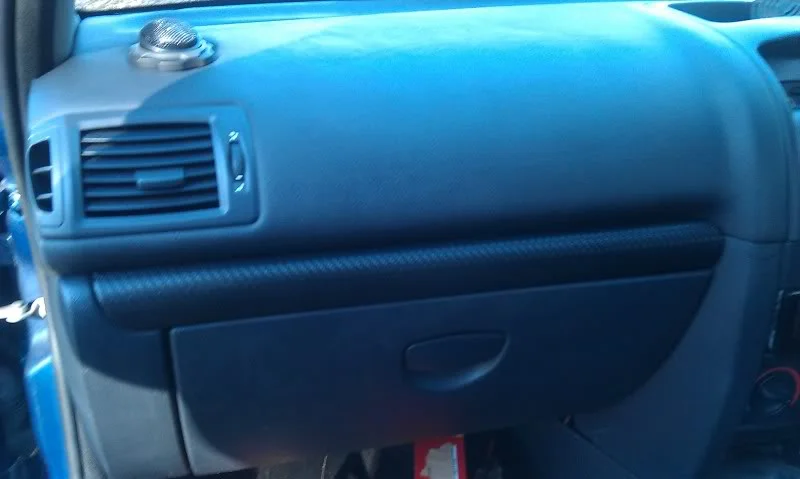

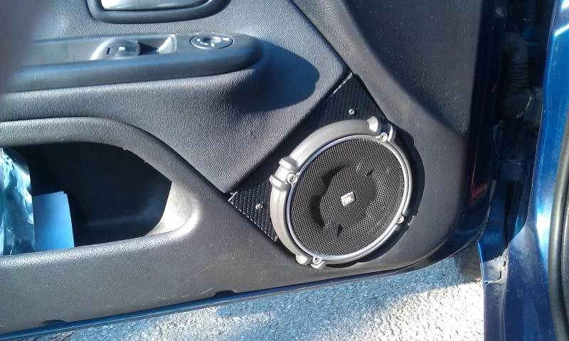

Like what you've done witht he carbon effect speaker covers (well, mounts, they are no longer covers) Are they 6.5" up front? Looks pretty nice & clean though. Think the tints match that colour quite well, they look ridiculous on lighter coloured clios.

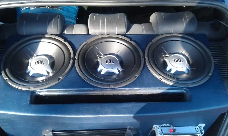

The box is 6 cubes tuned to 32hz they are 12" subs Its currently doing 143.2 at 33hz with only 700 watts rms combined
The tints took me about a month of thinking whether to or not thank god for Photoshop
Yea the front speakers are 6.5's hopefully during summer I should have a door build with 2 sets in the doors and maybe 4" coaxial speakers in the dash/ a pillar if they fit that Is

Sorry to be harsh, but that dosnt look good imo. 3x12" subs seems a bit of a silly setup to me. I would have either gone for a better sub (I prefer the pioneer competition class subs with twin coils and double stacked magnets) or gone for a 15" instead. Also whats the alternator rating on the 1.2 clios? can the actually produce the required 58amps to keep the system at 700watts for periods longer than 20mins?! (that is a geniune question, not a retorical). Good call on the tints btw, a needed thing with that int he boot for sure. What are you using to messure the pressure level? Please dont say your phone?

For a budget system jbl is the best as they can handle alot more then their rated power the clio has a 70amp alternator which is being upgraded tova 110 amp alternator as a temp replacement I have 3 batteries which helps on the voltage and no I'm not using my phone LOL im using a term lab
As for the amount of subs I'm entering the car into pd events and 3 12's is different and puts more of a cone area then 1 15 plus I will be upgrading and changing the baffle etc if I have pushed the subs as hard as I can which right now I'm under rating them due to me not putting my SPL dynamics in until I've got a better and more stable power supply

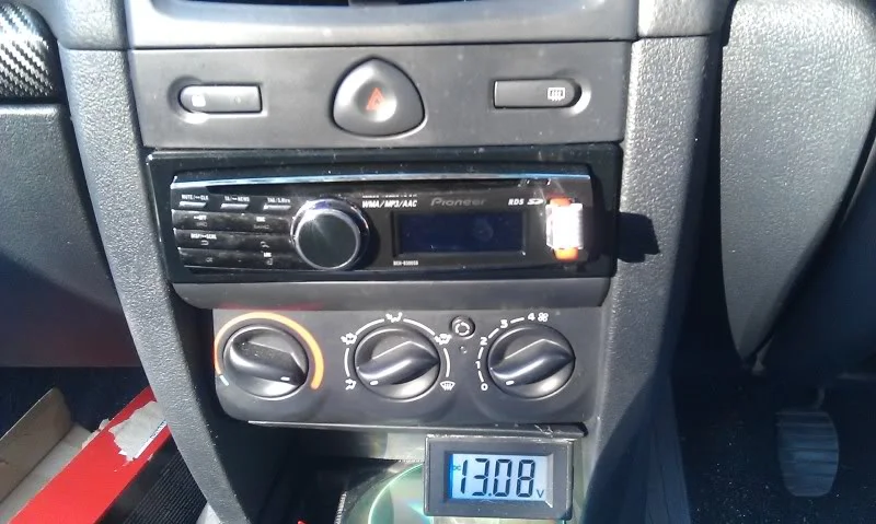

not thought of a switch from the rem the back of your hu would make so much more sense especially when your feeling like s**t and dont wanna blow your ears out or your waiting for someone and wanna turn the engine off....

good job on the car! not a fan of the rear light tints though :(

Thanks when the lights was fly eyed I wasn't to sure but the did grow on me :)

How on earth have you fitted 6 Cubes in a Clio boot only? lol
I cant remember what mine was, I think I hit 146.X. IT played music well though which I liked.
3x Second Skin Bulk packs, I was running 2x Optima Yellow Tops, Uprated Alt, 2 Runs of 0 Gauge for Power and earths (inc engine earths)
1500wrms between 2x SPl Dynamics XTR 12" Subs, but they werent in anywhere near big enough enclosures, were only in 3.5 Cuft beteen them :(
I see how youve done it now, its above the parcel shelf, mine was below (infact I still ran a parcel shelf for security reasons.

The rear pillar trim has been trimmed and u see the rest and u should do it again ;) did you have a door build I'm yet to see a clio with a door build :(
