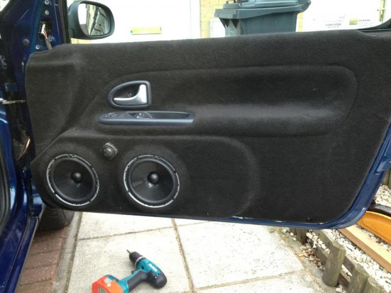

thought i should update my door cards are now finished i have also fitted my spl dynamics ice 150.4 on my rear cards removing the rear speakers and cup holders

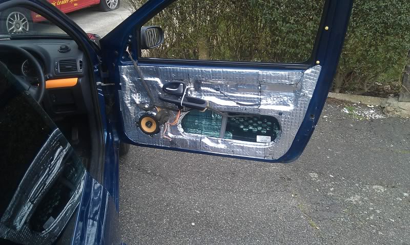

this is how my doors look behind the door card i still need to buy closed cell foam for behind the card

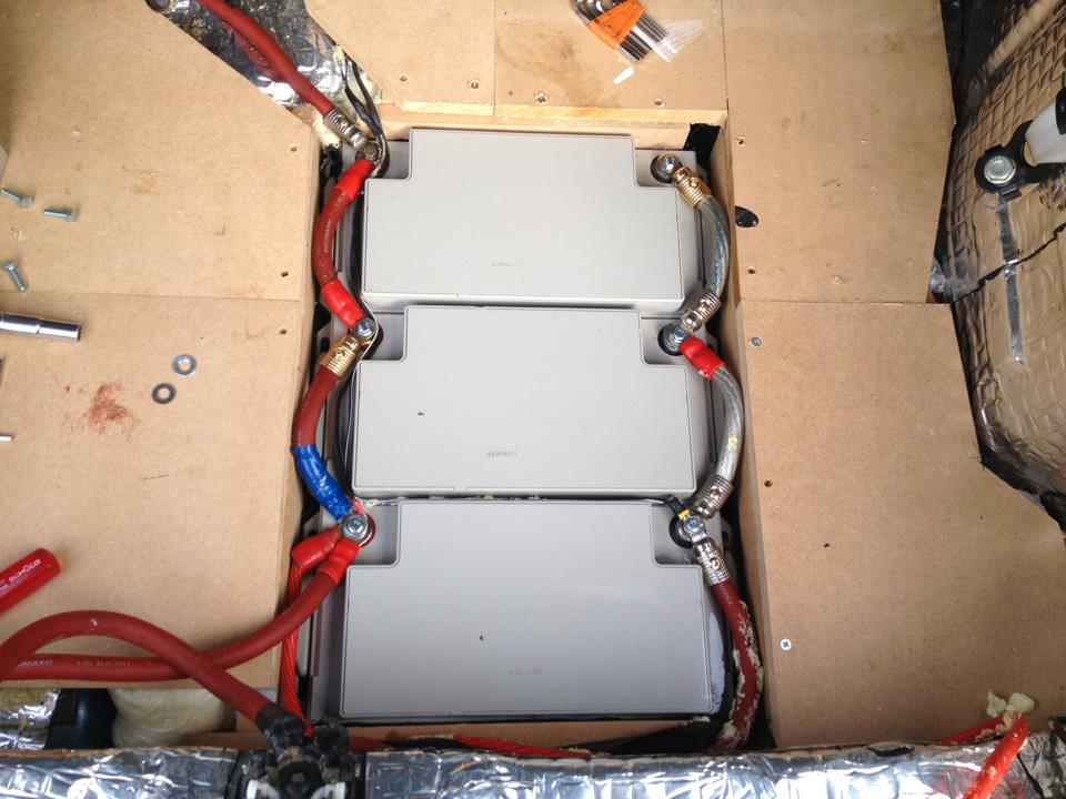

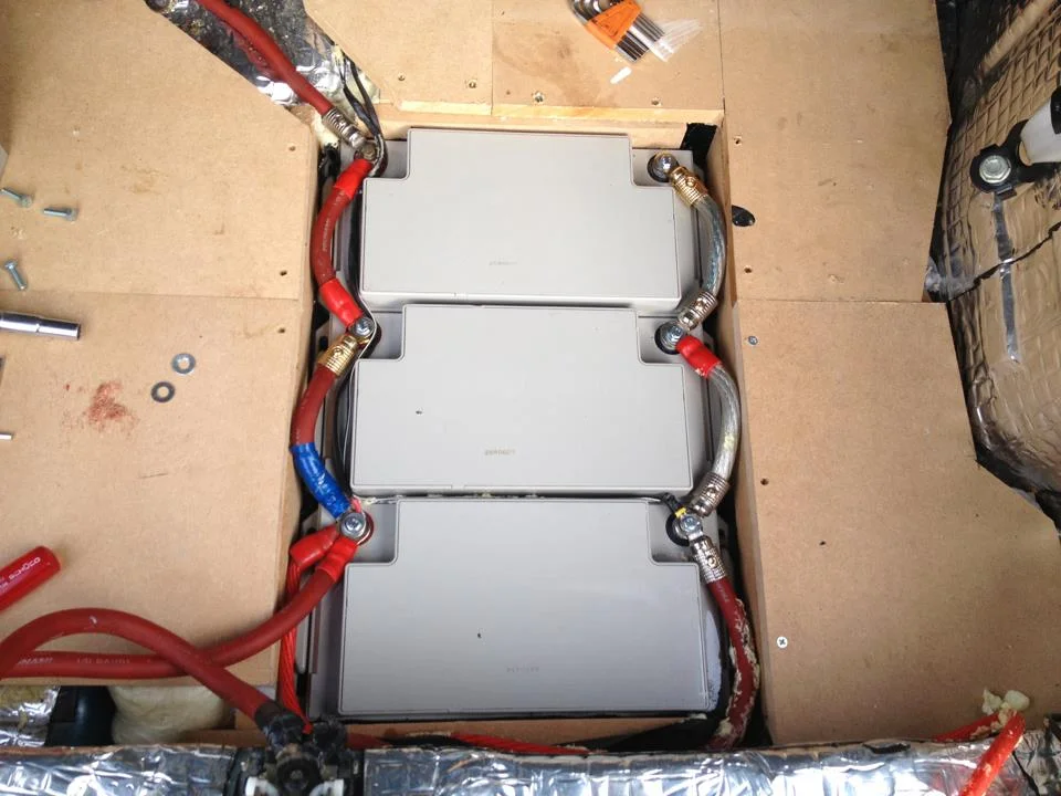

rear batteries replaced and a raised floor was made out of what offcuts i had left since it is a budget install after all

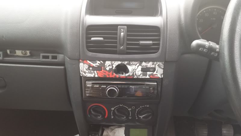

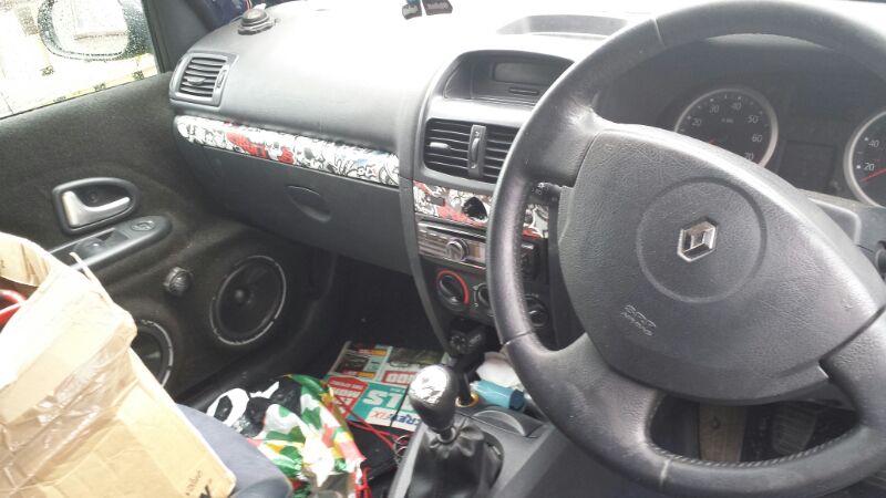

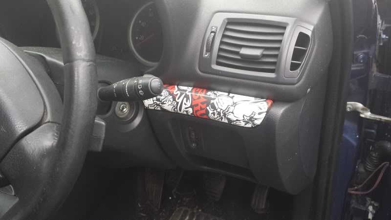

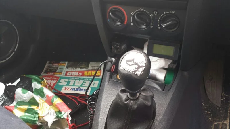

another update I got bored of my orange carbon vinyl on my dash trim as within the 5-6 months of having it on the car it was shrinking and creasing up also fading so i thought i would go for skull type stickerbomb vinyl since i haven't seen it
here is a pic of it before i ripped it off
URL]
excuse the mess in the car she is rather dirty inside
im half tempted to do my glove box handle but im thinking it may be abit much what do you lot think???

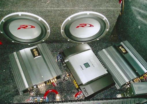

I had 2 12" type r running 1000w rms in a small ported box hitting 144.2 at 52htz.
