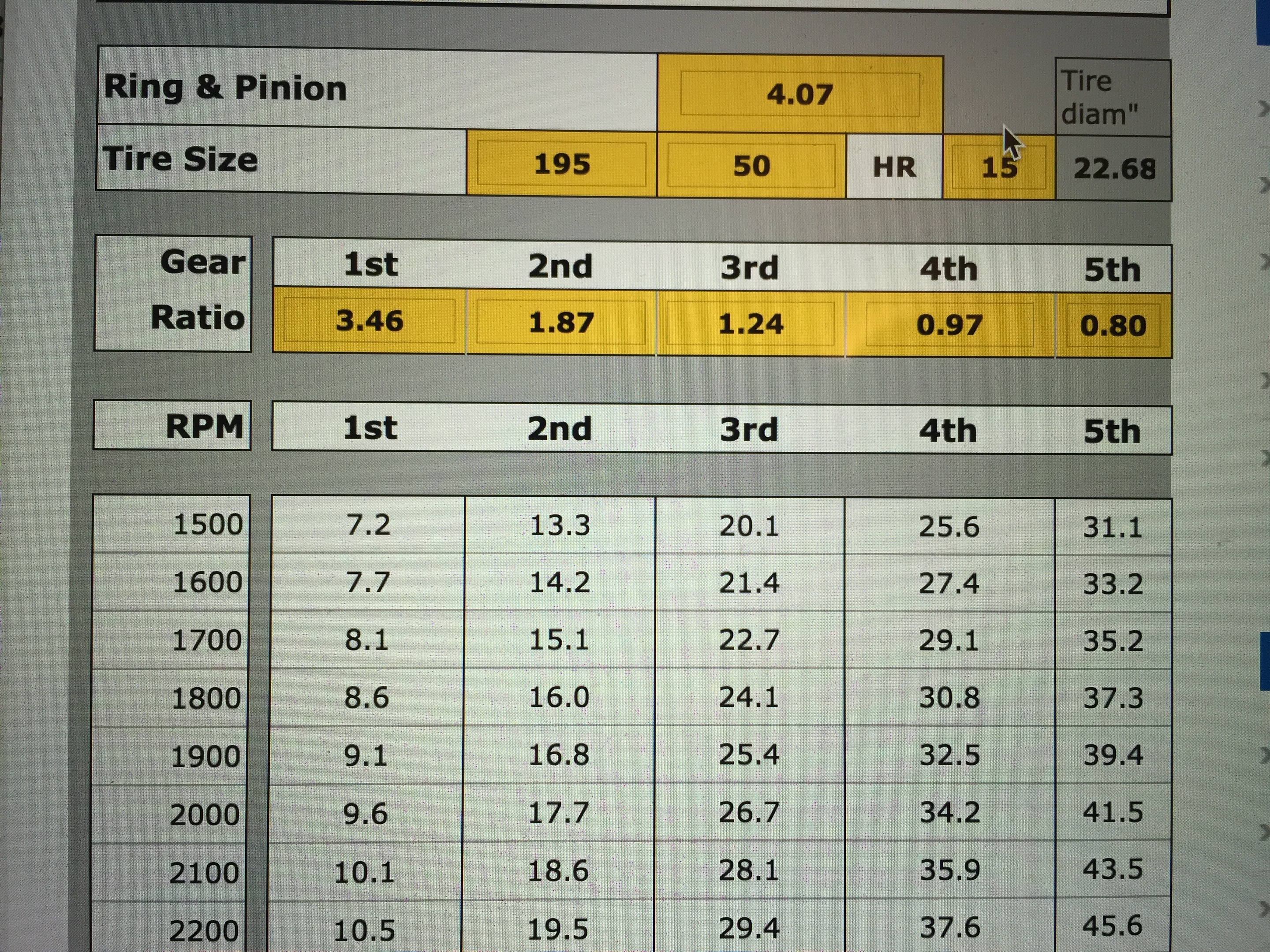

bashracing
This is ph2 boxes ph1 had the same ratios but 3.89 fd iirc

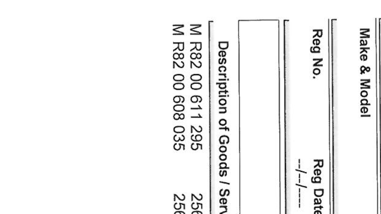

massiveCoRbyn
  Several
I suspect it isn't, as I would think it would be from a five speed box, assume another type of JC5.
Just trying to put together a comparison of the ratio options when you start factoring different final drives and the like!
