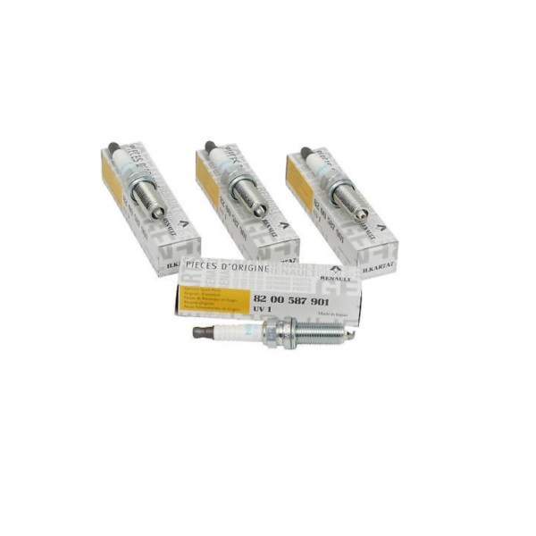

  Twingo GT
You have to be careful though. 8200587901 is for the D4FT, 224018760R is for the D4F. RPD don't actually mention this anywhere.
