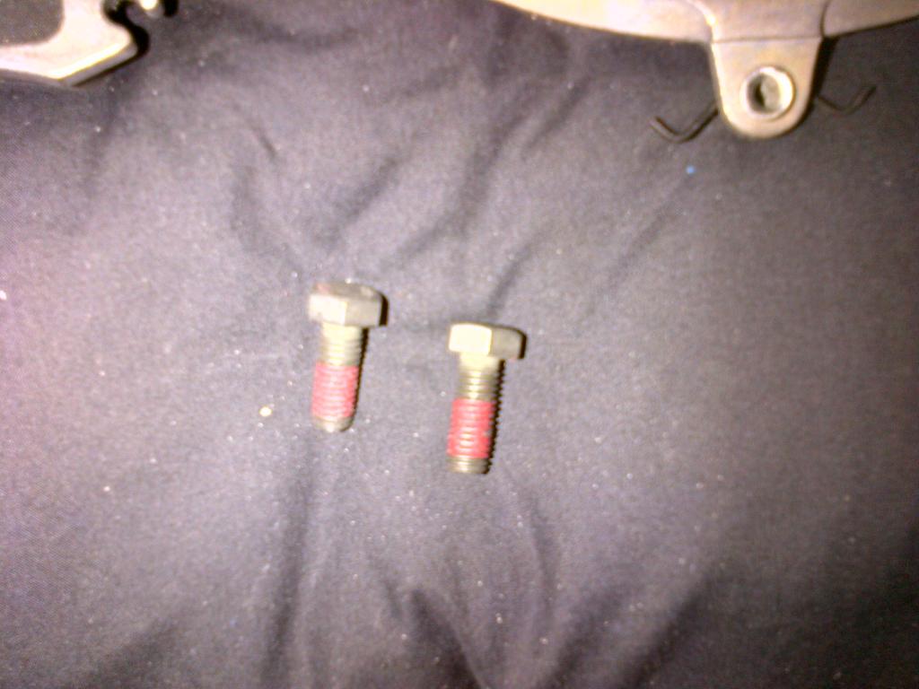

I might get these done tomorrow, I looked inside the box that the pads are in and found two new bolts:
they look about 13mm, are these replacement bolts for step 3 in the link in the original post?
