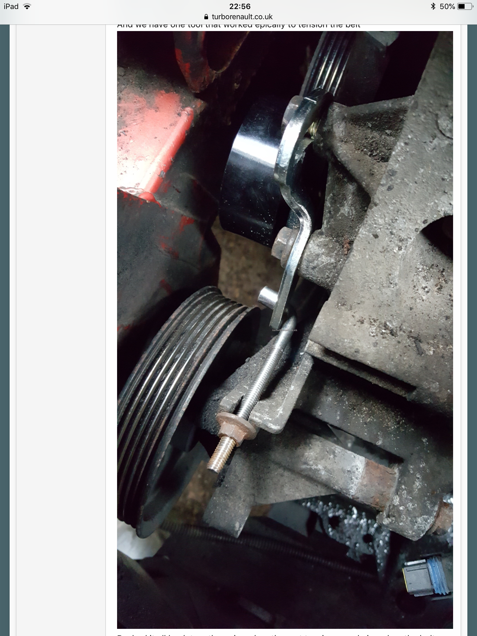

Belt is a piece of piss on a dCi. Only annoying thing is the aux tensioner
Mine needs a new one. It's squealing like a pig on cold starts and when there's load on it. I looked in and it appears to be able to be adjusted manually though, it's not on a spring.

Aye the 65 and 80 are manual and usually break. Think @Brigsy made his own iirc, a lot of people usually do as they’re awful things standard. Same with 172 Cup ones
The manual tensioners are however loads better than to spring ones on the 100’s. They usually come apart and half of it is still stuck to the engine

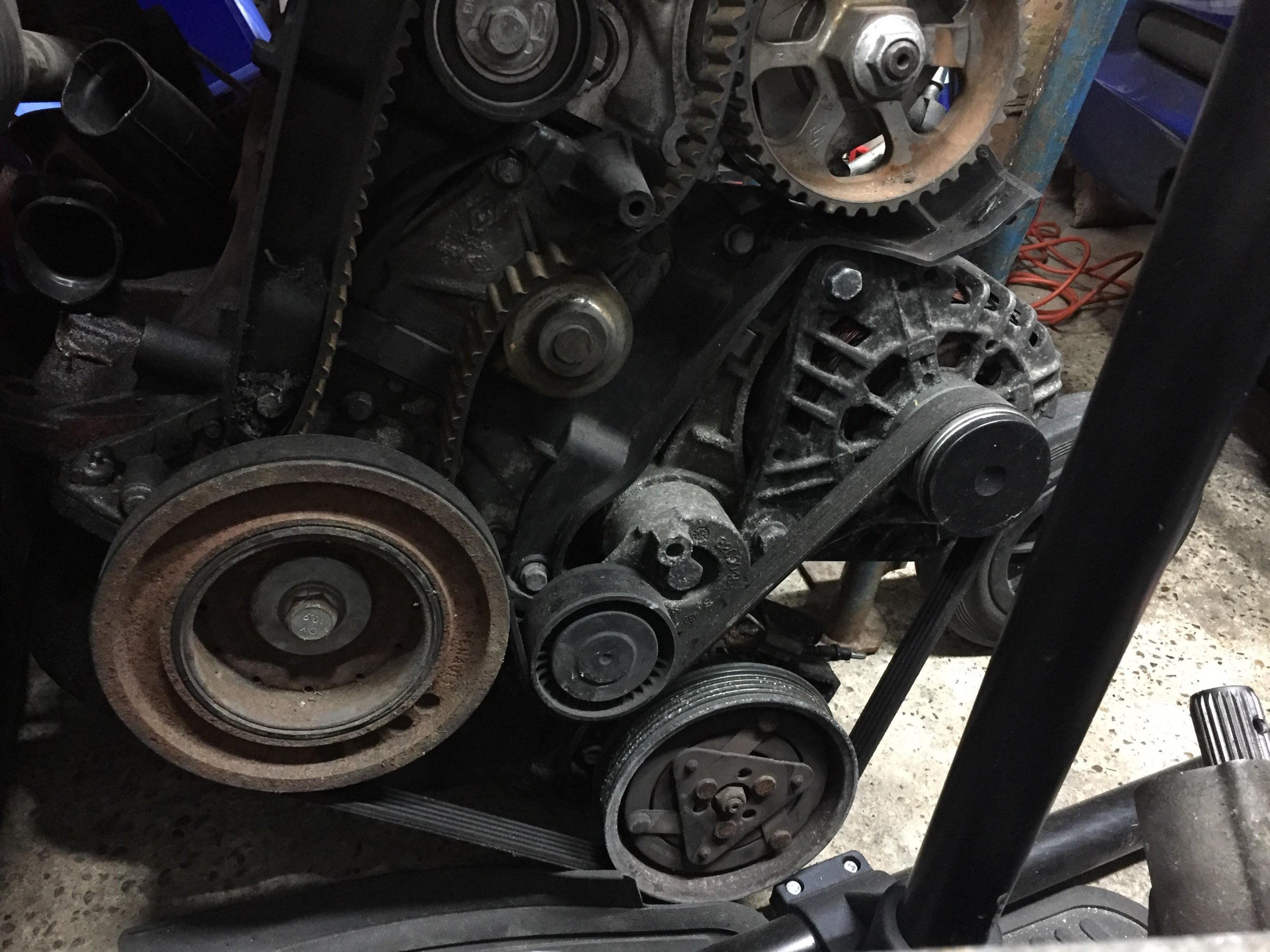

GrahamS
with the tensioners, models with air conditioning have an automatic tensioner which is a doddle. The manual ones can be tensioned with a jubilee clip over the hooks.
Graham,
Mine has a/c! Could you expand on how it’s easier please. It sounds like I’m going to have to give this a go myself. :)

Brigsy
  T.Turbo
I made this to tension the manual tensioner. Without it i could not get it tight enough as nowhere to get the bar in.
GrahamS
Graham,
Well sir, luckily I have an engine out of the car in the garage! you can see the tensioner. You just chuck a spanner on the hex part and it slackens off.

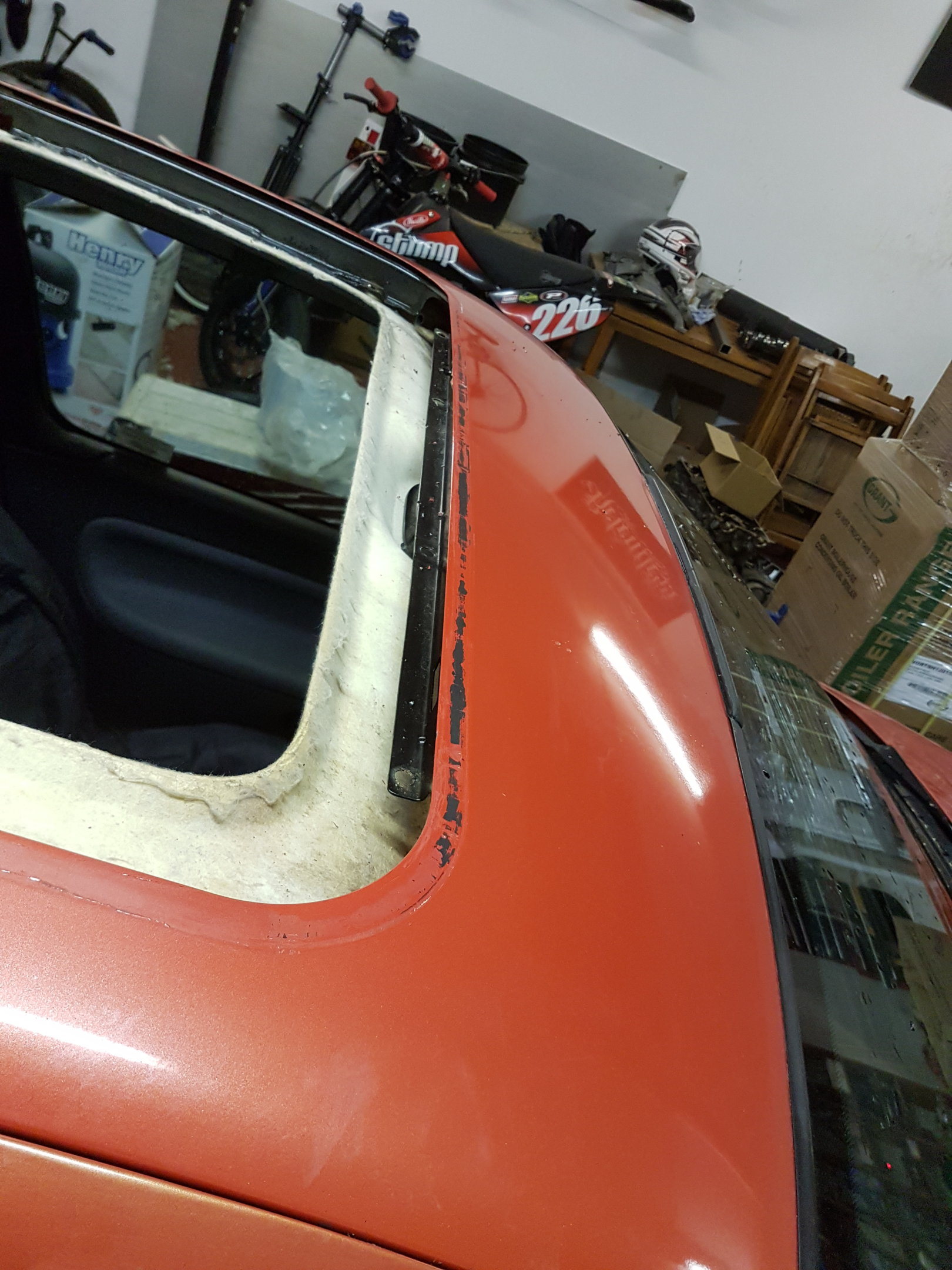

Noticed the carpet was a bit wet in the clio.......
So this happened
Sunroof out. Myself and @rik220 Have done this to every clio we have owned and it's getting easier with practice. Instead of using silicone we used waterproof double sided foam. @rik220 has used it on his 1.2 with good results. Should also be easier to replace when inevitably it does start to leak again. Mpg is now up to round 61 with mixed a and b road driving. Love it.
