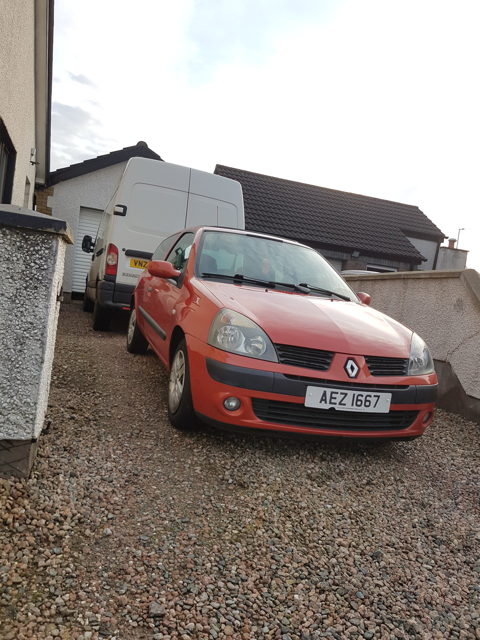

All of the above are good. Came with full history all books and 2 keys. It's been looked after very well mechanically. Pensioners owned it so the body is a bit shoddy but for the price it's grand. How much would you expect to pay for dci 80 injectors and intercooler? May go down that route then remap for extra mpg.

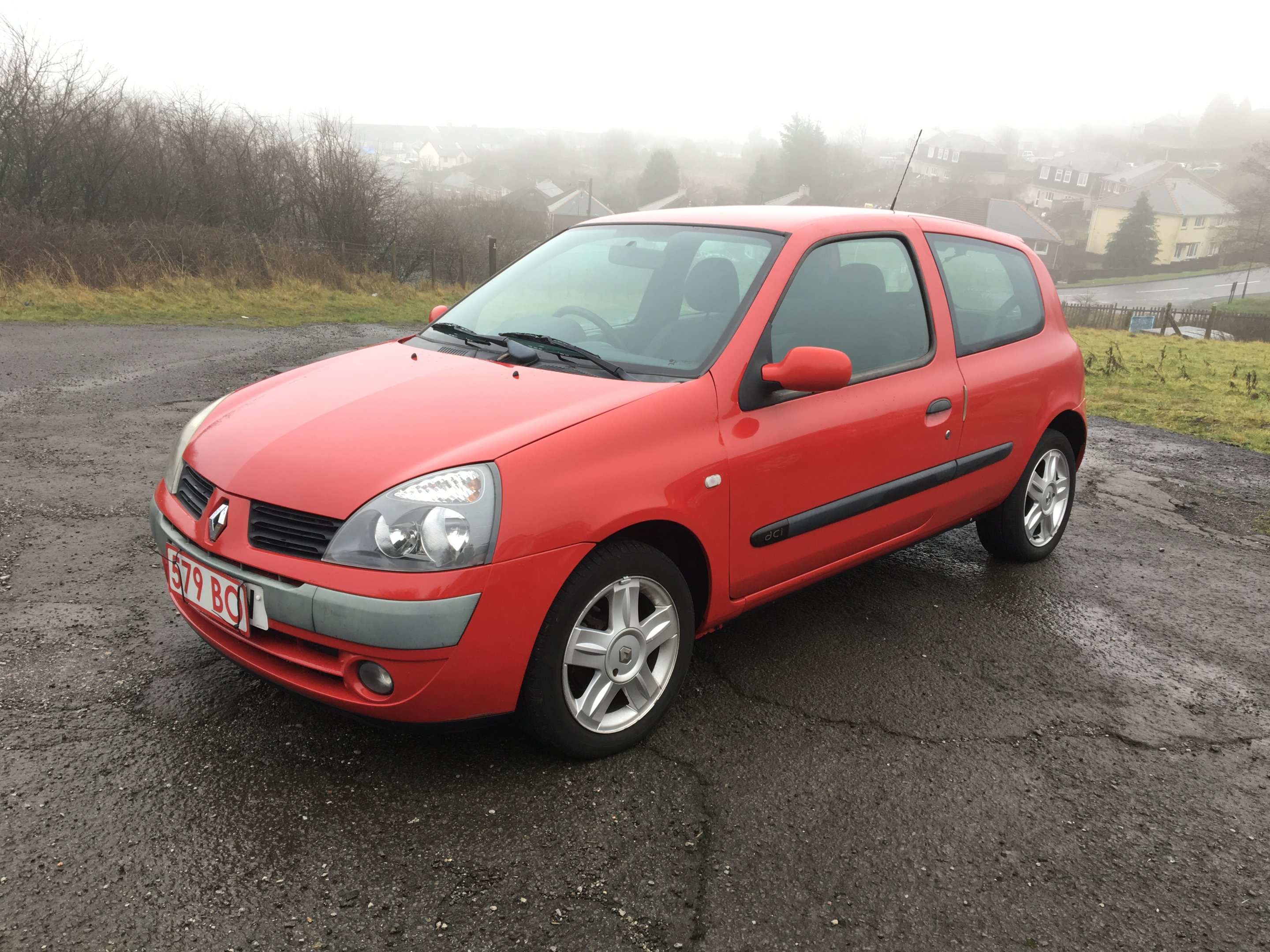

Just picked mine up today ? non-sunroof model thankfully. I wouldn’t have gone and viewed it otherwise. 2005 (55) 4 owners(2 were husband and then wife) , 117k
Almost full service history, minus cambelt, so I’m getting that sorted ASAP.
Love it already.
