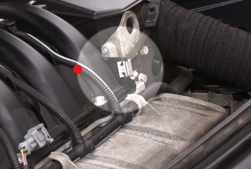

I've quickly done this till I can get out to take a photo later on.
On the plastic intake manifold (black bit) there are little plastic legs that stick up, onto these go some metal clips to attach the engine cover to.
I have circled (from memory so may not be axact) where they should be.

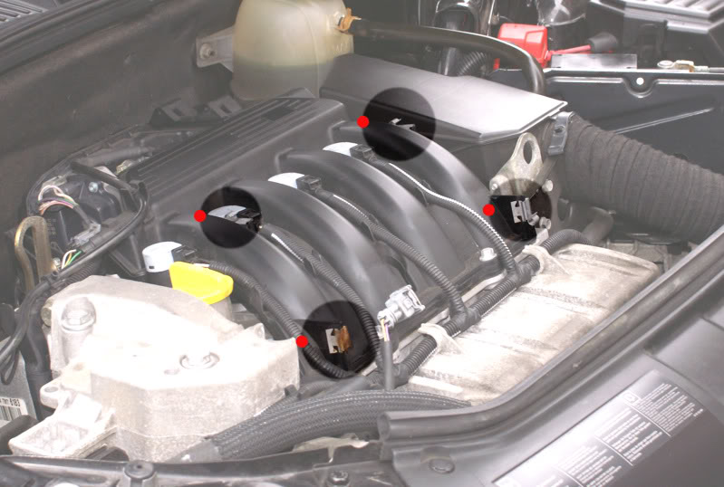

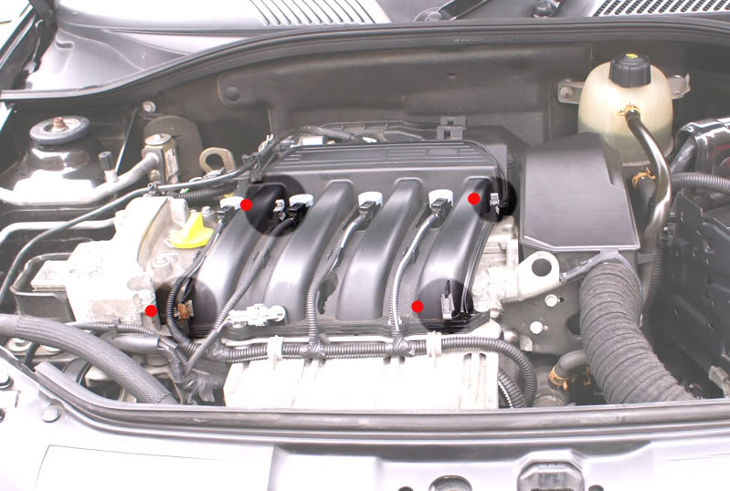

Here we go mate, the plastic lugs on a MK2 PH2 1.6 16v, you may have the plastic bits but not the metal bits, these can be got cheap from renault anyway :D
