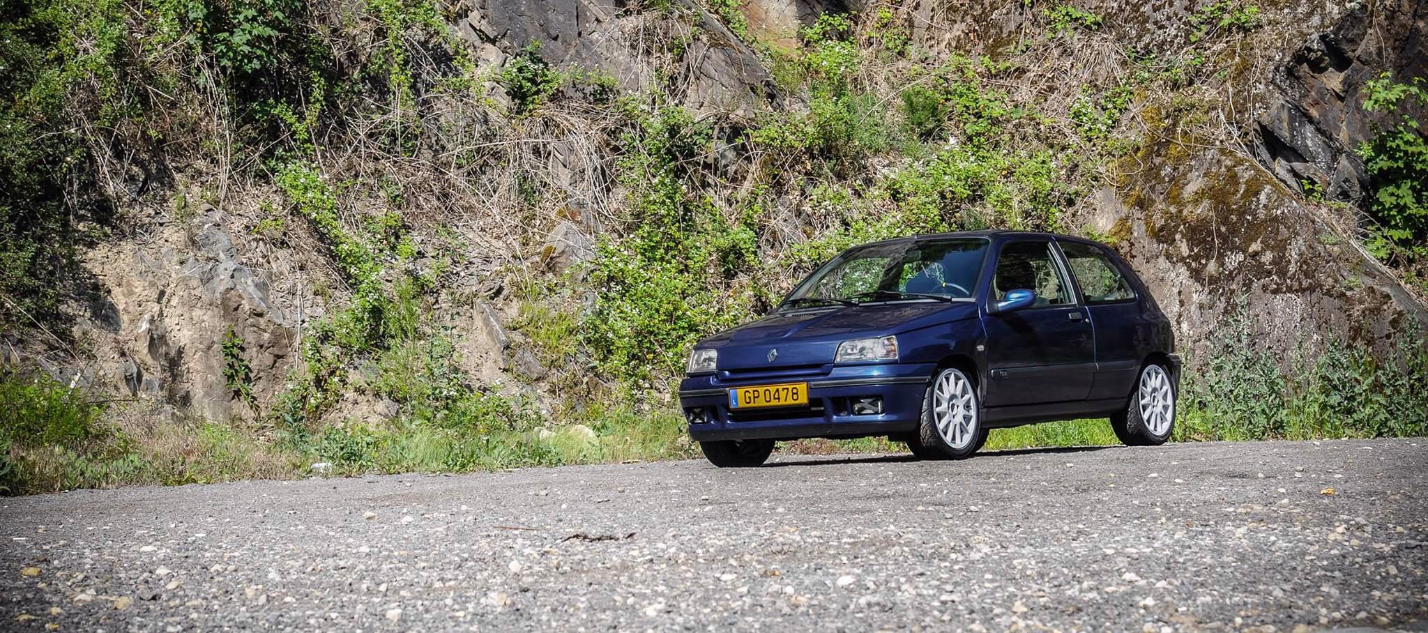

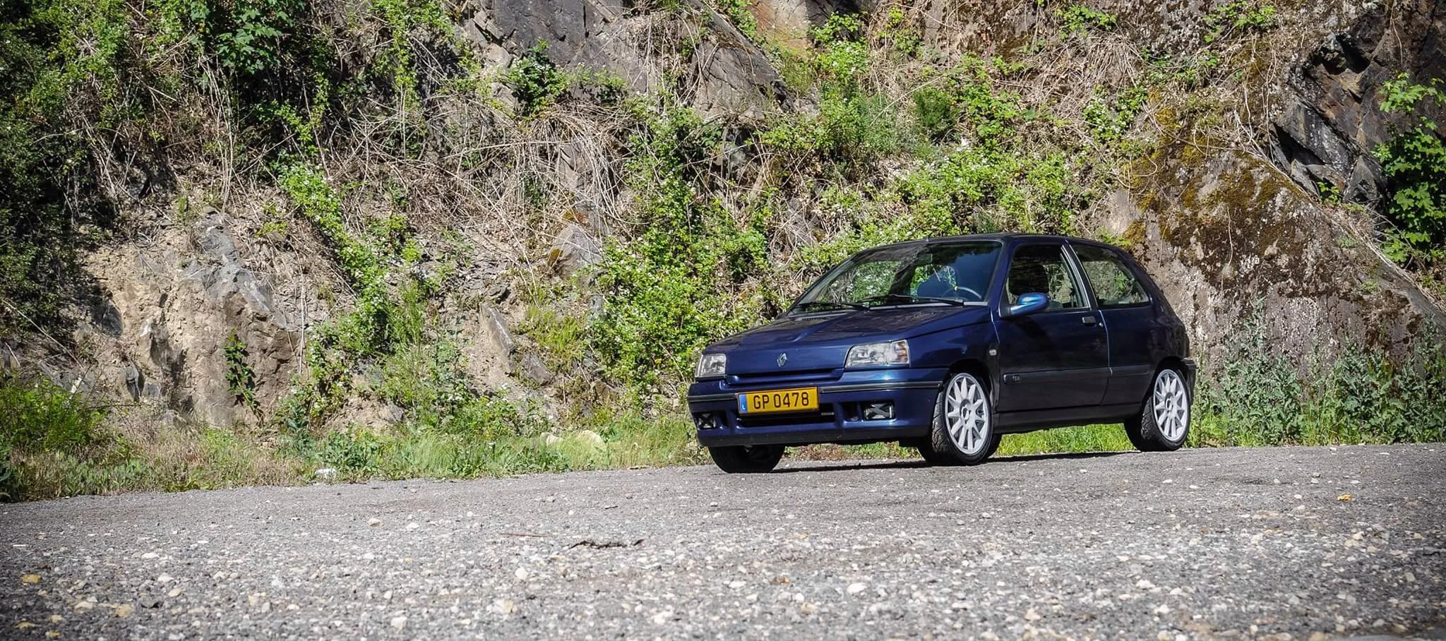

There you go:
tidy looking phase 2! the 16" actually suit it too, mine used to be 449 blue and ran 16" turini in a previous life and looked okay n all
however my other xerus grey one looked odd on the larger wheels! weird!
Whats the difference between phase 1 & 2?
Mine is actually a grand prix version :P
