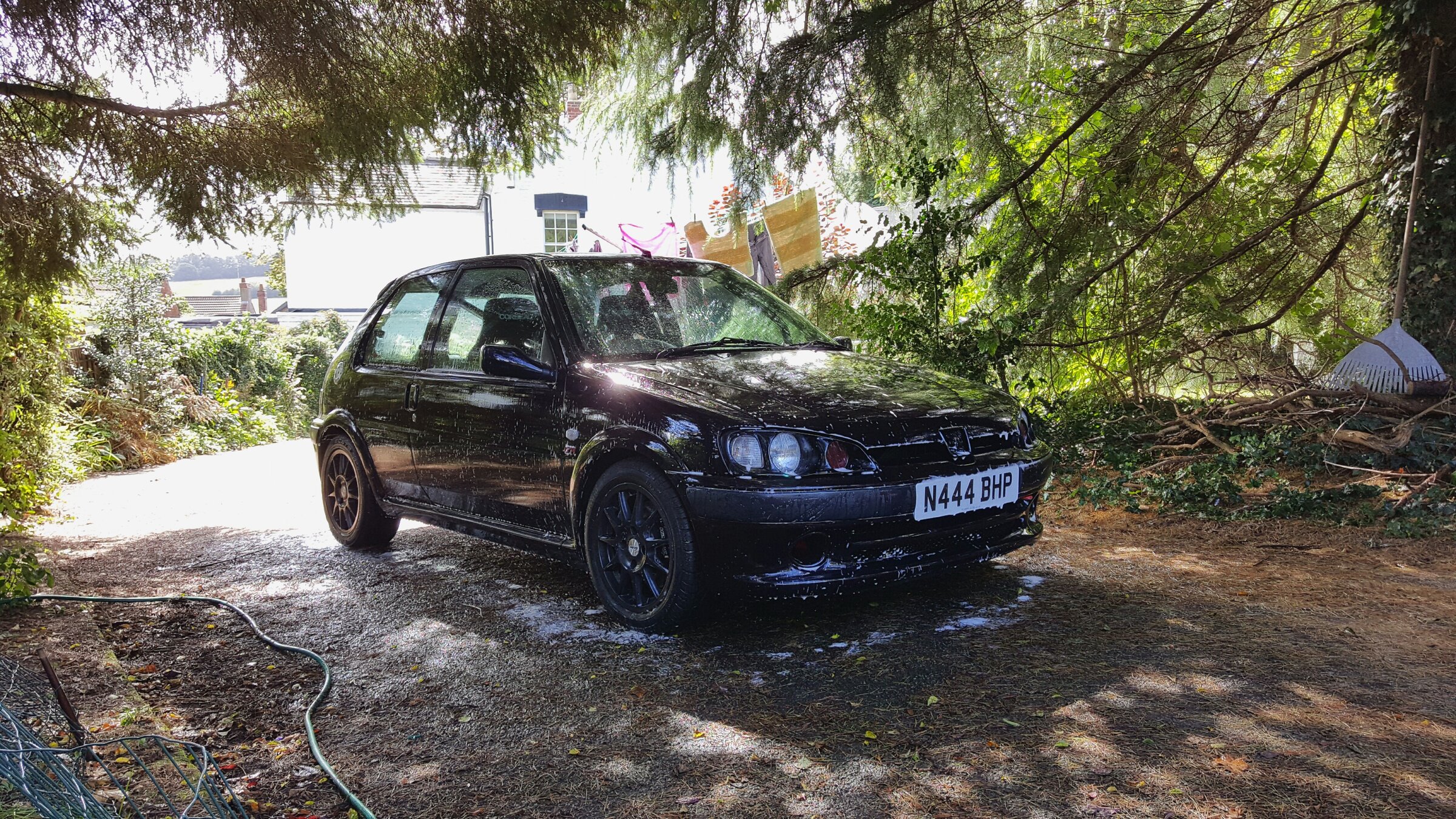

Mate of mine built that N444 BHP.

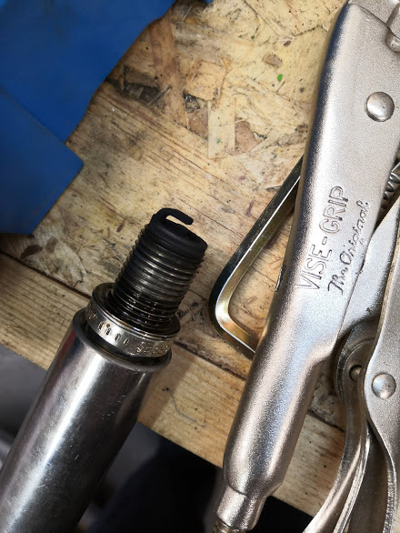

Changed the plugs in all of this. They're pretty coked up.

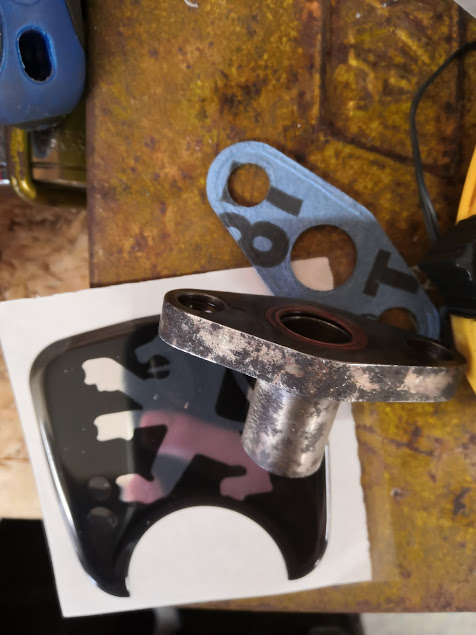

- Then noticed an oil leak from the turbo return. Took it off, to see there is no gasket. The washer sits flush to the flange. Gasket then.

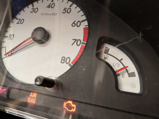

- Then the fuel gauge and coolant temp stopped working!
Tried all sorts here, earths cleaned, even earthed the sender locally = nothing. Tried some other clocks and that fixed it! WTF. This annoyed me more than it should have.

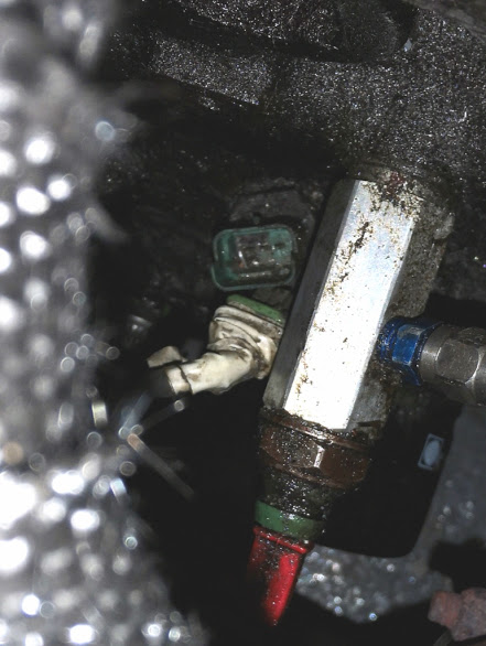

- Oil temp plug broken
I always knew it was, but I thought I should try repair it anyway. The connector was not easy to source. But managed it in the end from Farnells.

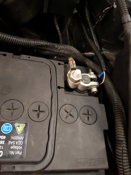

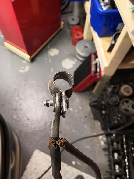

- Battery terminal was loose
Had been cross threaded. The negative terminal just wobbled about. Sourced one from a forklift.
Replaced both gearbox and chassis earths too, just because they looked poo.

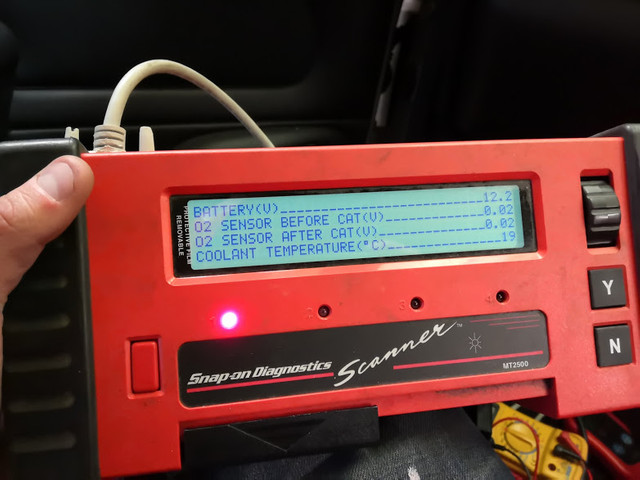

New tool came in handy... at least to tell me I hadn't connected the lambda...

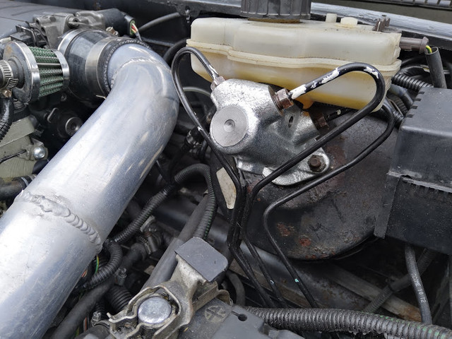

- Brakes are still rubbish
Decided to get a 23.8mm master cylinder, as the one that is on it is 19mm from a Quiksilver. The 23.8mm was the one that should mate with the brakes. £40 for a refurbed one wasn't bad. Pedal is now a lot stronger. Still not 100%, so might need to adjust the arm a bit.

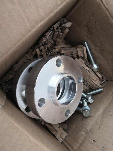

- Burning rubber smell
er... yeah. The 20mm spacers on the rear... are not good enough. The inside tyre wall hits the axle. So, out came the paypal and some 30mm door stops arrived. It does look loads better though.

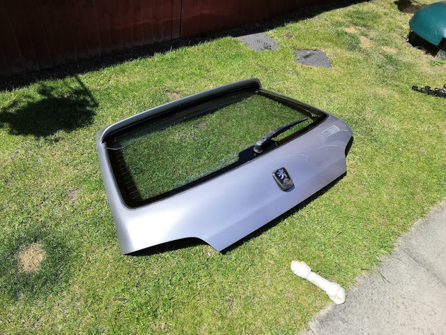

- Boot paint
Back at last from paint.
Donny_Dog
  Jim's rejects

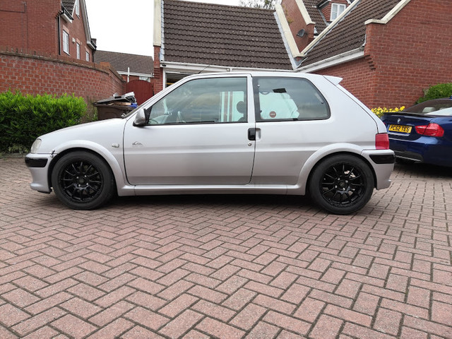

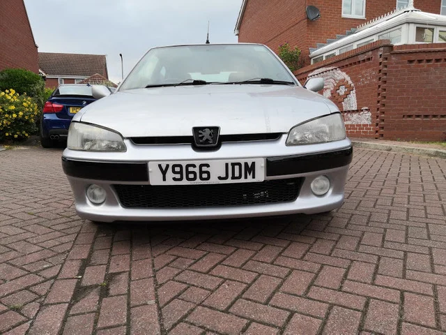

Here it is now. The panels I haven't had painted have a couple of years of outside filth on them, so not sure what it'll all look like when it's had a deep cut.
If you look to the first post in the thread on page 1, you can see what it looked like before.
