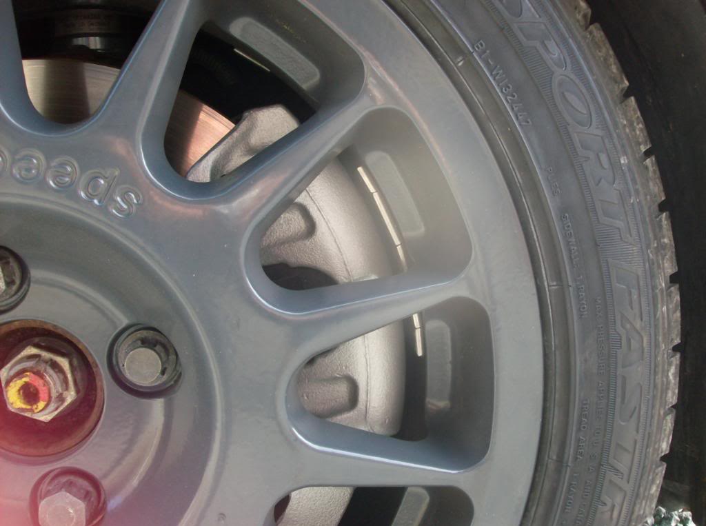

What you think 14" would give if 15" on a 172 gives this qua caliper clearance
