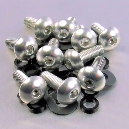

Na, ended up buying these
but thanks any ways, didnt have access to rivet gun.
works well and looks no diff tbh
