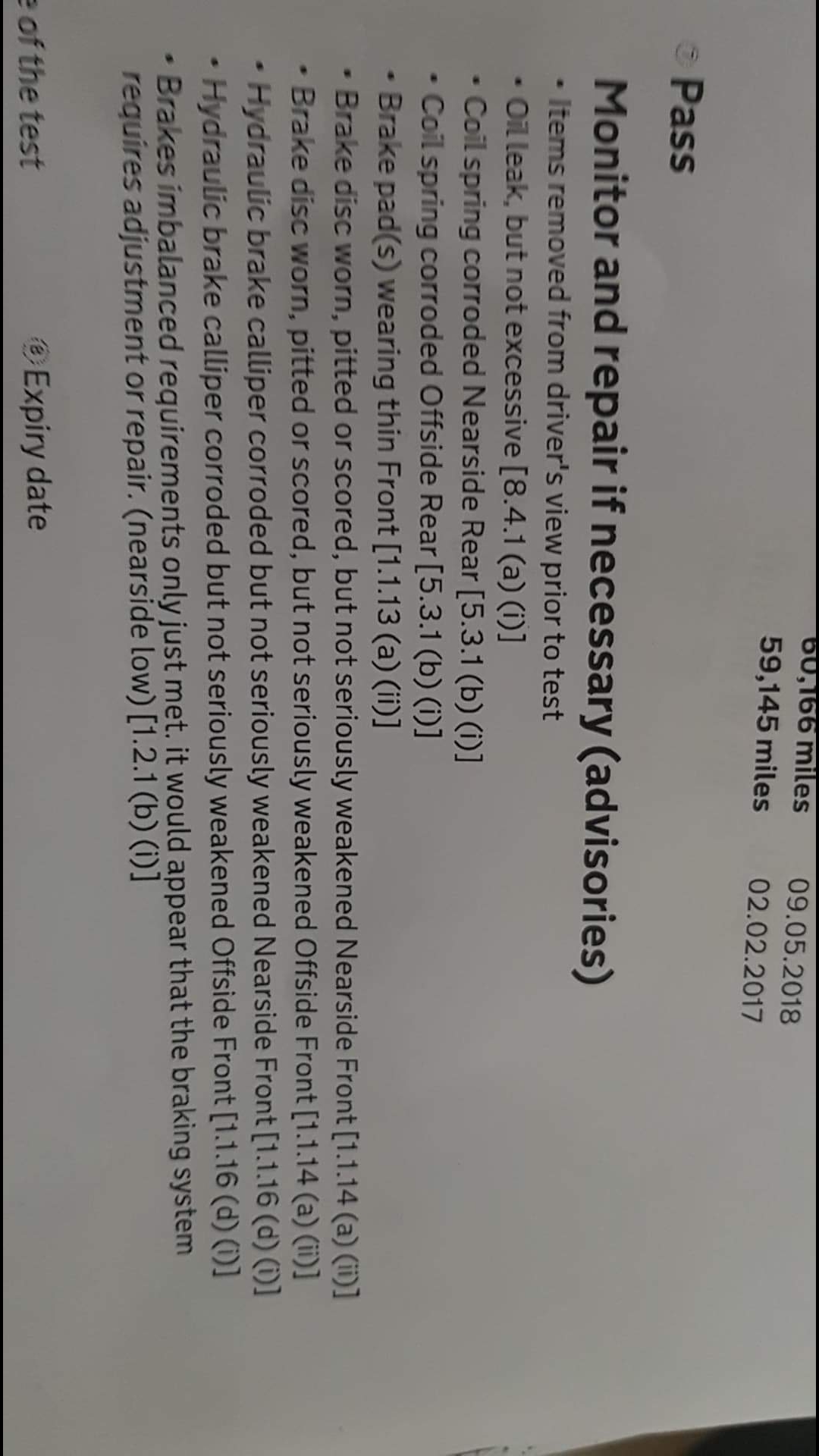

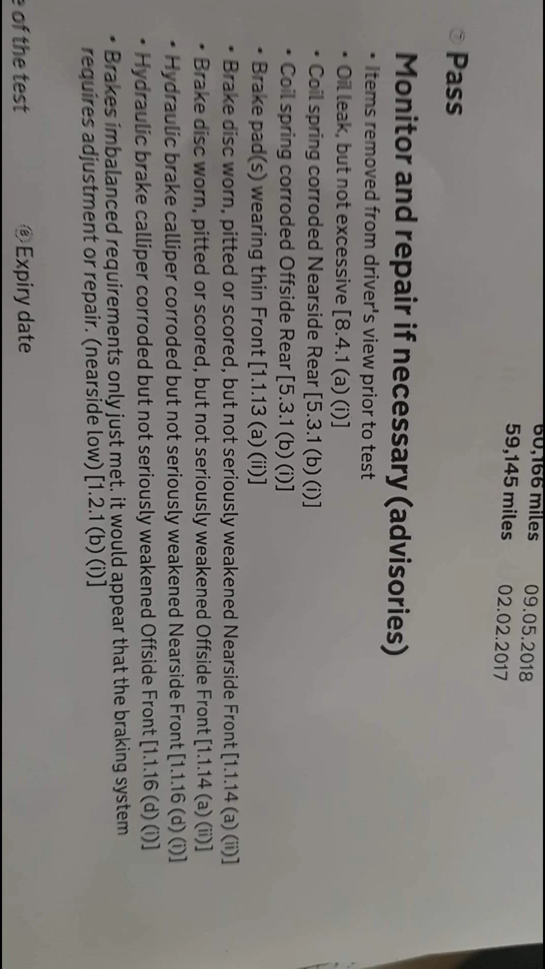

I recently mot my car and have a few advisorys and wondered if that would sort all the non engine ones?
Thanks again!
