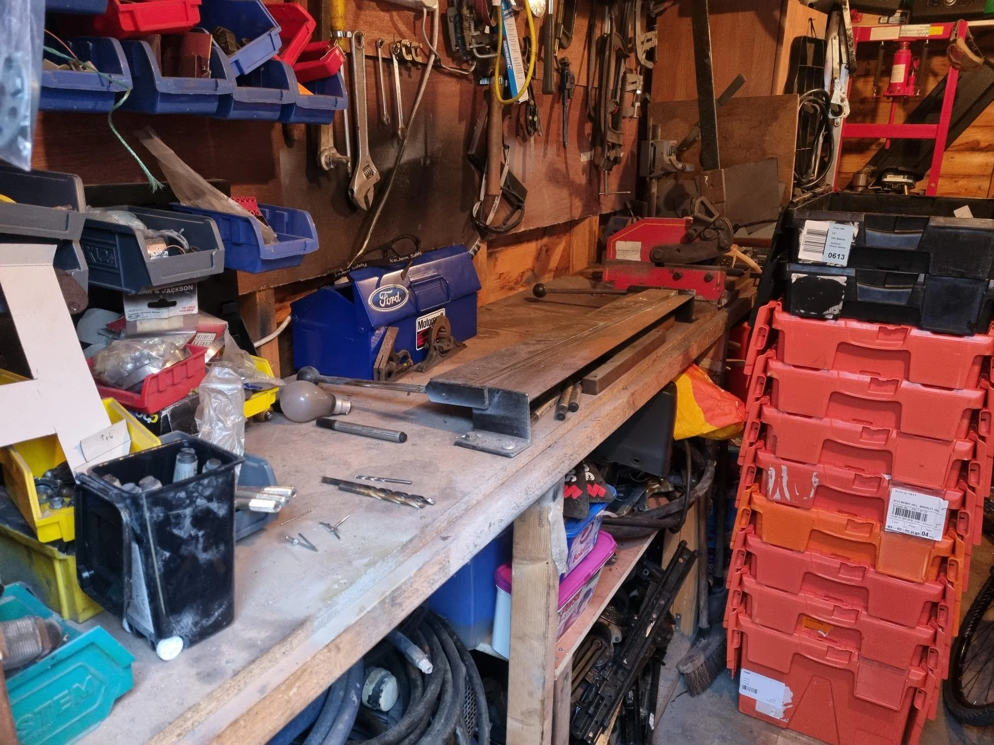

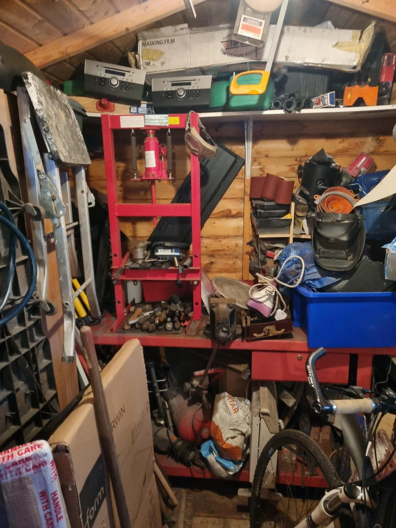

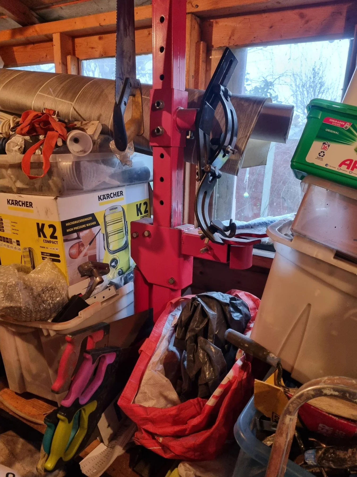

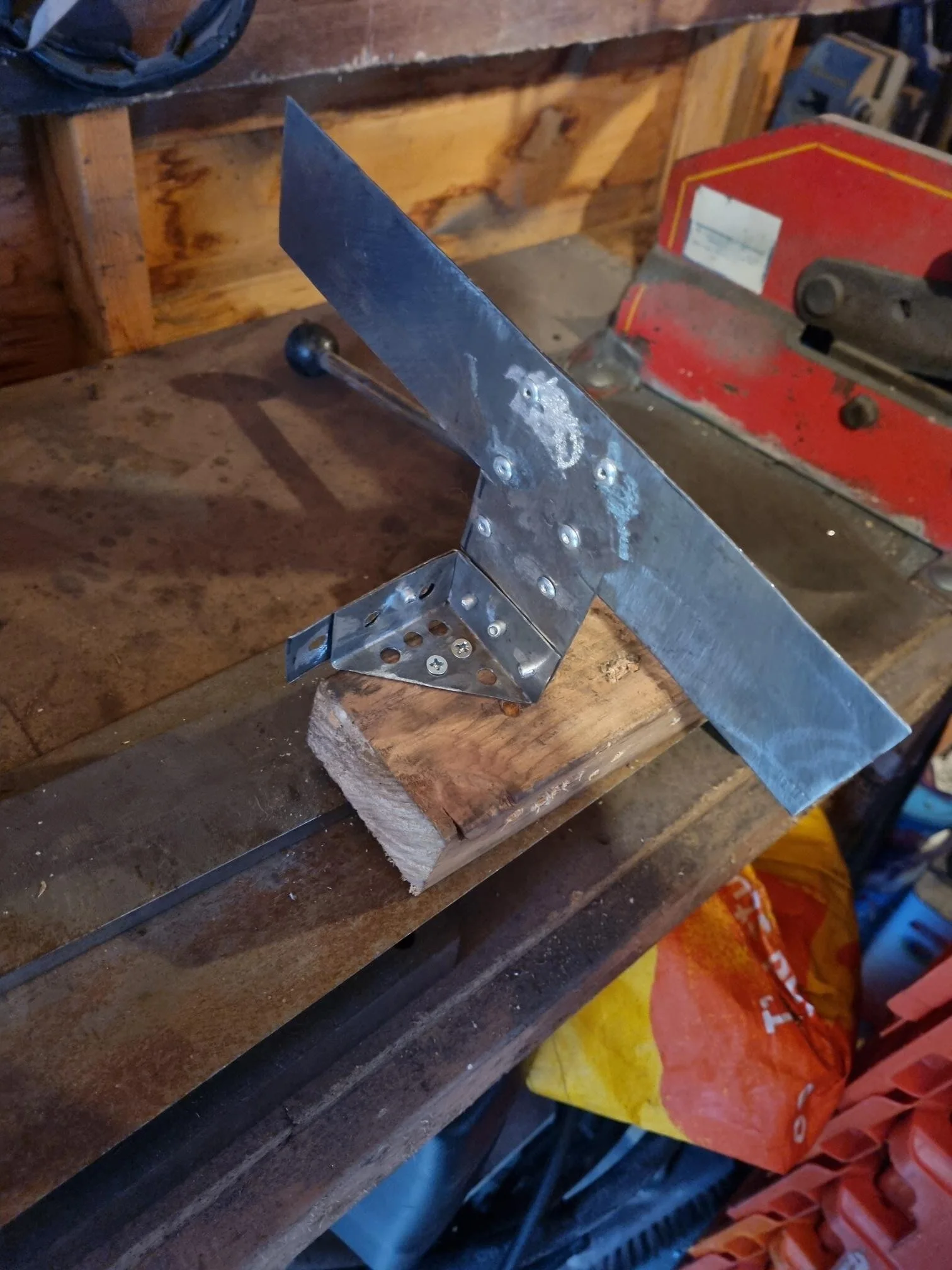

So has been a busy weekend this weekend - my shed in the garden I built many years ago as a workshop (14 foot x 8 foot) with guillotine, folder, vise, press, etc and when I used to do a lot of car restoration it was well used. The last few years though it has become a dumping ground and you could barely get in. So it has all ben emptied out and once again now I can walk in and get to everything. So have made timing strut in readiness (just needs painting), I was going to weld the reinforcer on but unfortunately last year I left my welding wire in the Mig and its gone damp (I usually keep it in the airing cupboard but last summer dug the welder out to do a job on my lads seat rails and left the wire in when I threw the welder back in shed), so I have pop rivetted it together today. This will be held under the bumper face with rivnuts in the bumper so it can be quickly bolted/unbolted when at the track.

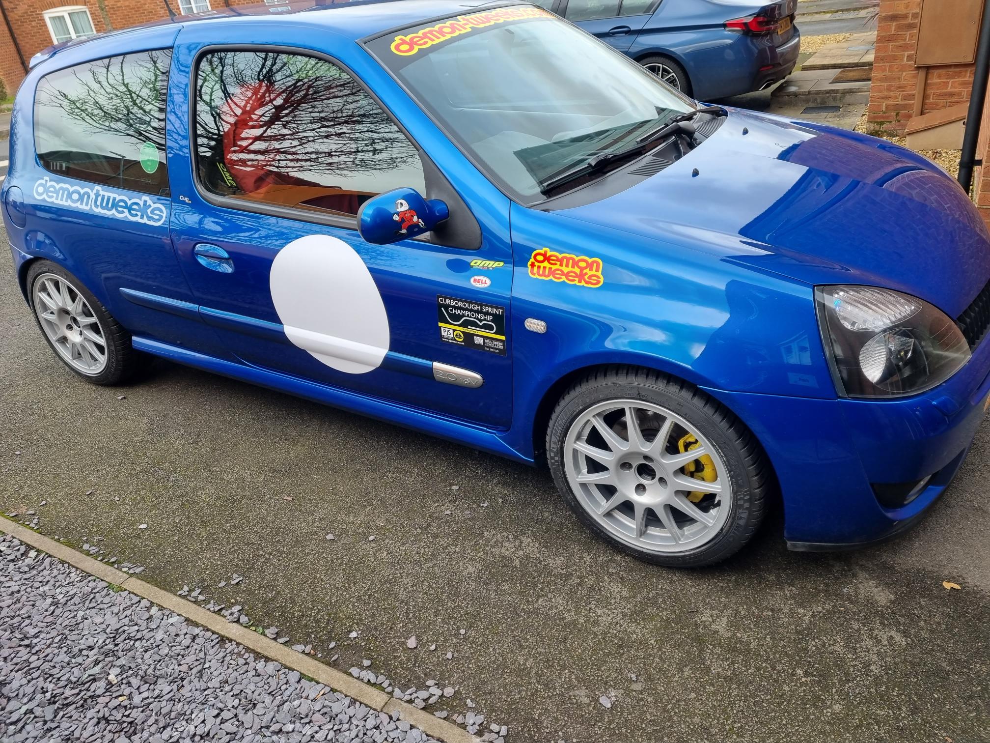

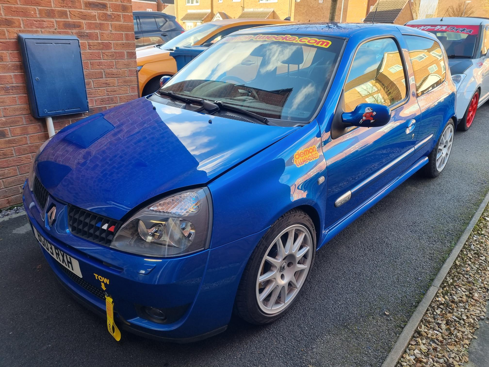

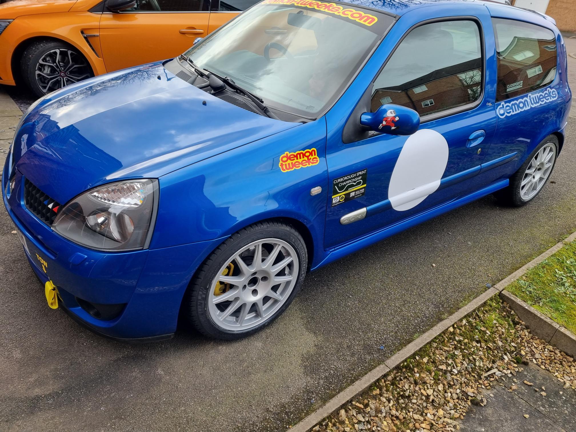

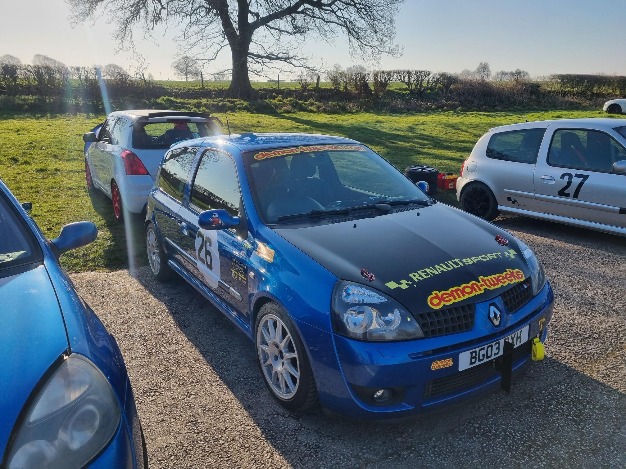

Had a busy weekend. Visit to Demon Tweeks to collect my helmet and full race gear (suit/gloves/boots). Signed up for the Demon Tweeks sponsorship scheme so applied the stickers to the car.
Wil be checking the car over in coming weeks and doing final preparations.

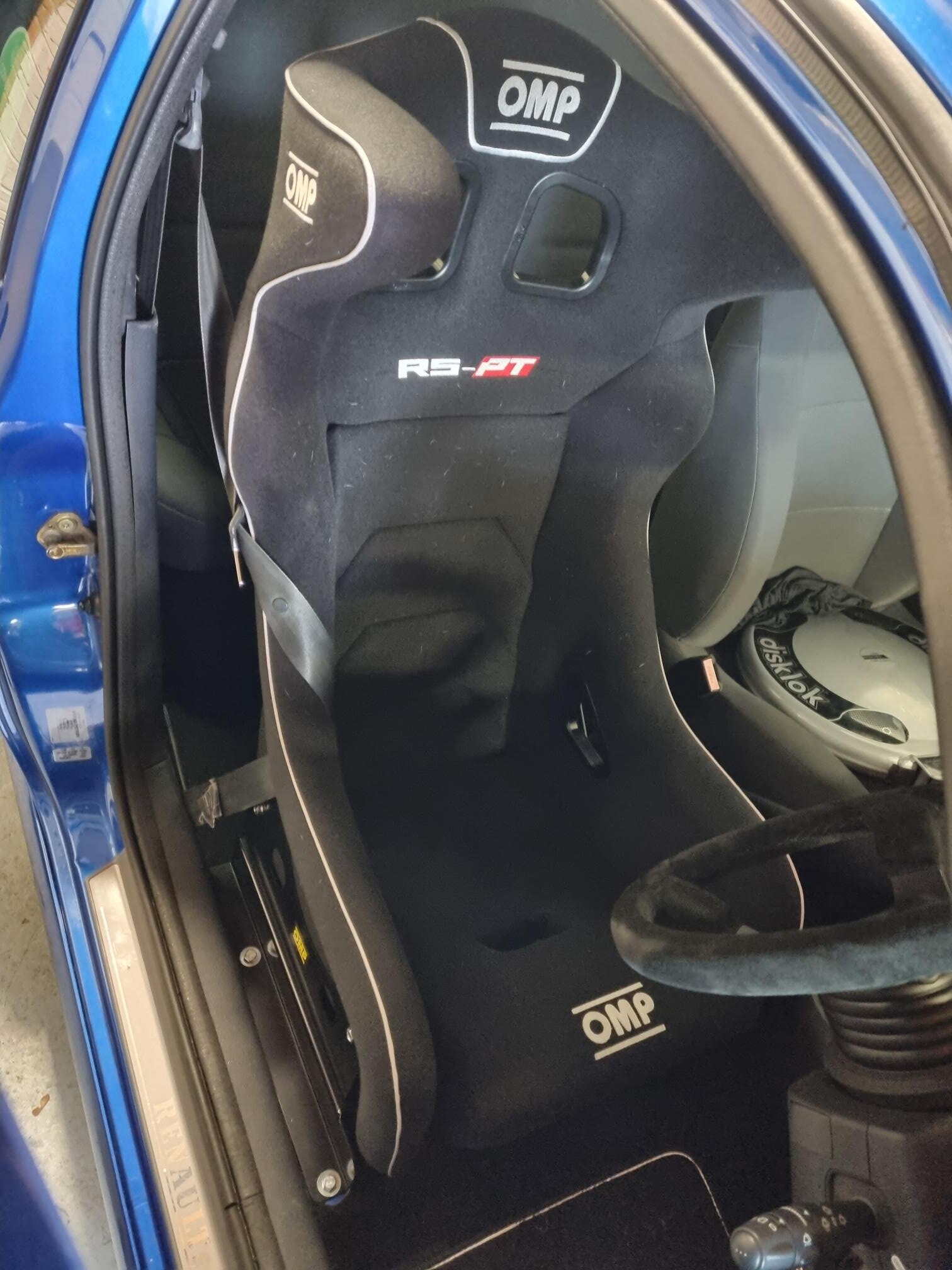

Found a seat I like but without a cage can't mount harness and not sure if it will work with standard seat belt - will ask the question in appropriate forum area :)

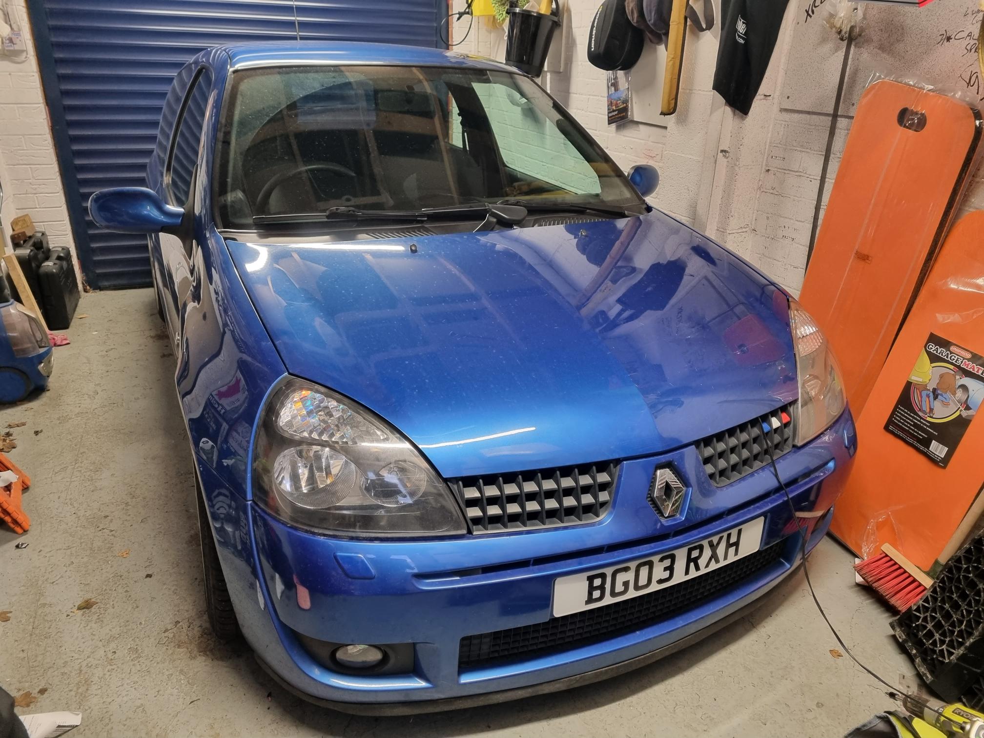

Well cars ready now for its first sprint 20th March, then the next one is 2 weeks after on 3rd April, with the Saturday inbetween having 5 laps on track in the members afternoon at Curborough.

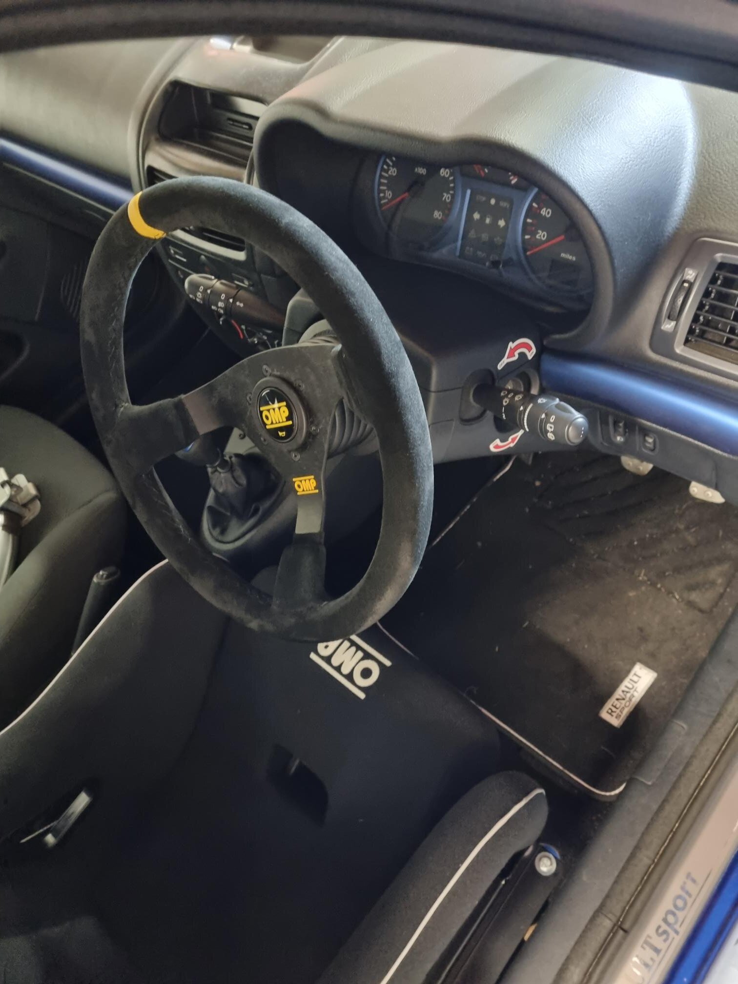

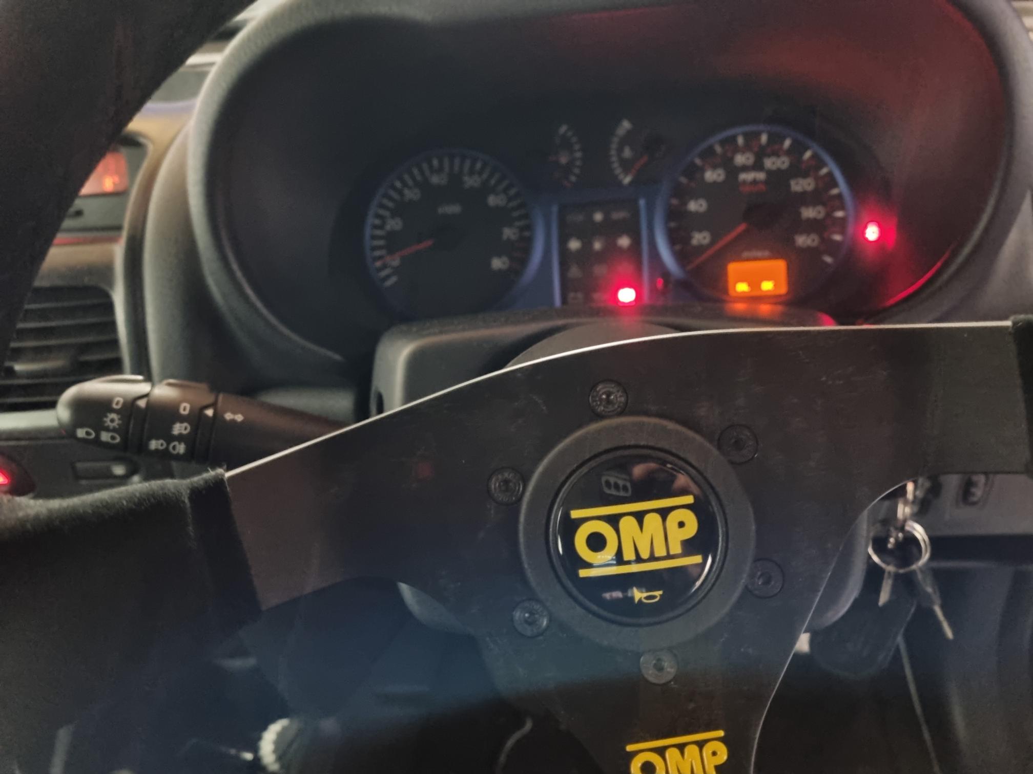

Seat fitted, Steering Wheel on and air bag light sorted (resistor in air bag and seat belt tensioner plugs) so it comes on with ignition and then goes off as no fault found :)

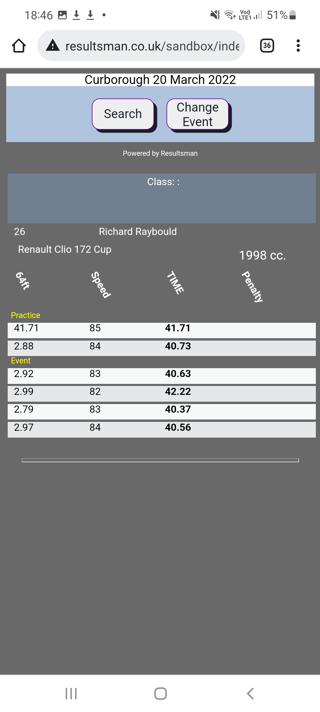

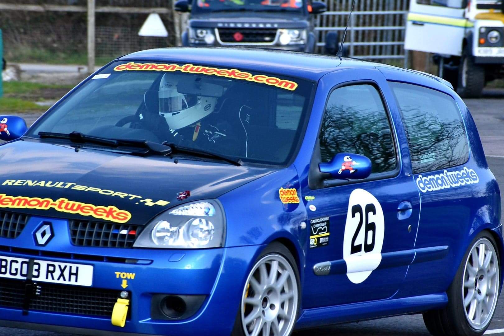

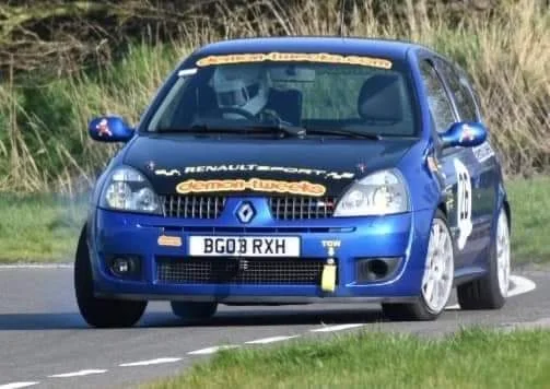

Well, did my first ever Sprint yesterday. Practice one at Curborough. Wnet very well i thought. I was fortunate to be in between two 182's so picked some great tips up off both drivers - real helpful and welcoming - both seasoned racers so it is was great for learning from them. Not sure if they are on here, both were named David - if they are thanks for help!
My track lines need some tidying (times are in image below) and i figured on the last run i was boucing off the limiter etc too long and so thats has cost valuable time.
Proper sprint in 2 weeks time! Hopefully get my cage fitted this weekend and harness - have bought new seat for passenger side to replace the Renault one - i figure a competition seat that side negates the weight of the cage!
