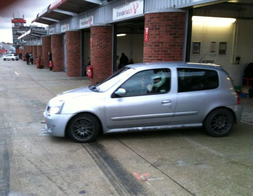

I was the one on track, the fast one :)
Not much really. Done it on a budget.
Has rear interior stripped out. Left the front carpets etc in but with 2 x bucket seats.
MSV/Caged rear cage. Eilbach sportlines and ferodo ds2500s. I am really happy with how it goes.
Was running standard 172 wheels with 888s in the afternoon.

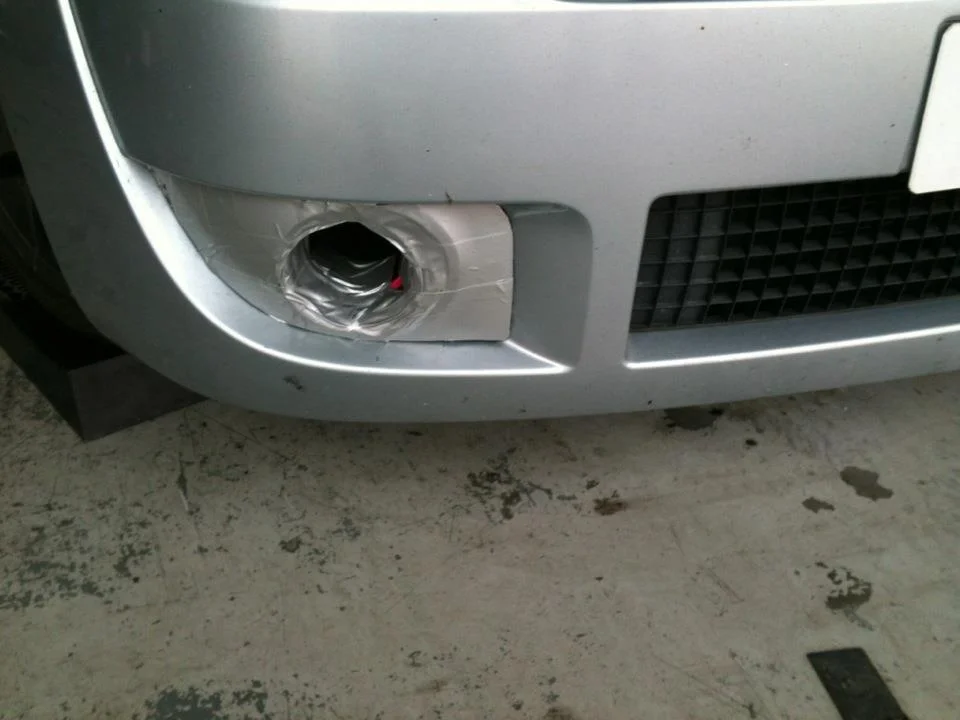

Home made brake ducts innit.
Brakes were getting hot then we made these just before the lunch break.
