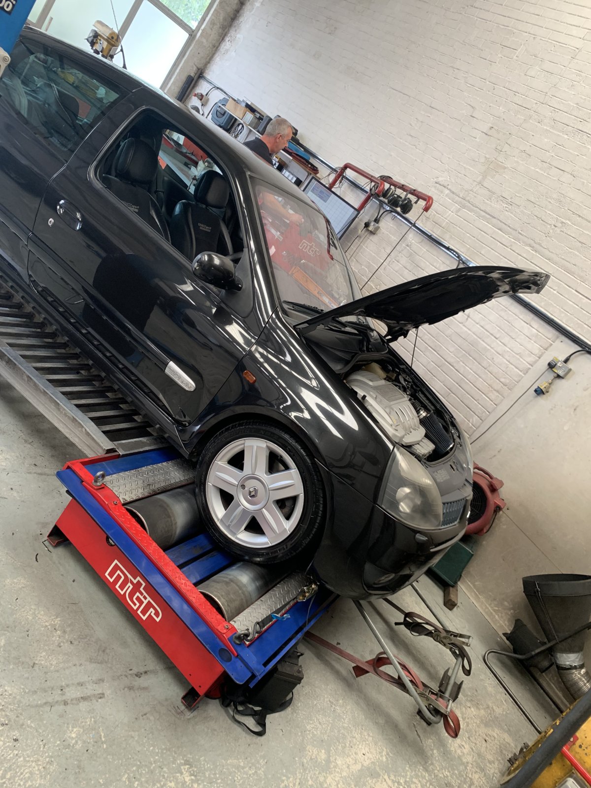

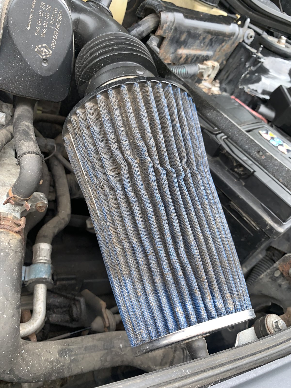

I have recently purchased a 137,000 mile clio 172 as a weekend toy for £800. I owned one of these 5 years ago and have wanted to buy another one ever since I sold it. My new clio is in need of an oil service and has a large cone filter which is very dirty however it still pulls very well and is great fun to drive. All belts are fine as they have been changed just over a year ago. Before I carry out a major service on this car (oil, filter, fuel filter, platinum spark plugs, uprated leads, cold air induction kit behind headlight, cat back exhaust system) I have decided to give it a power run to see exactly how much a good service and a few subtle mods will increase/restore power by. Here is the results before the service. (Go easy on the old girl she has done a few miles and as I say is in desperate need of a service) I am booked in for next Wednesday after I have serviced and fitted all new parts to see if the figures change at all and if so by how much.

Hi mate decent little purchase it’s way down on power tho would deffo loose that filter and invest in a decent one or replace to a standard air box ? Who set the timing up on the car when belts were done ? This can make a big difference the service won’t see much difference I don’t think but good luck looking forward to seeing the updates ?

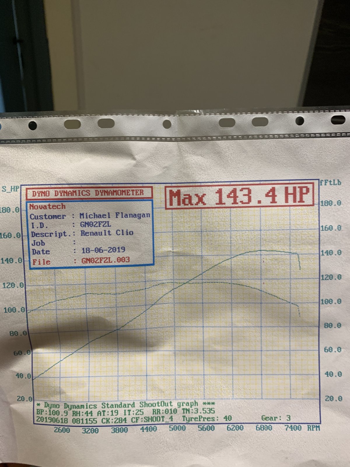

Hi mate not sure who done the belts as it was an eBay purchase and I havnt had a chance to look thorough all the paperwork. Iv been reading that healthy low mileage 172’s are usually running around 165bhp so was thinking it wasn’t too bad the fact the car is 17 years old with 137,000 miles and only 20bhp less? I can’t find any posts of anyone doing a power run on a car needing a service before and after so I’m quite looking forward to it myself

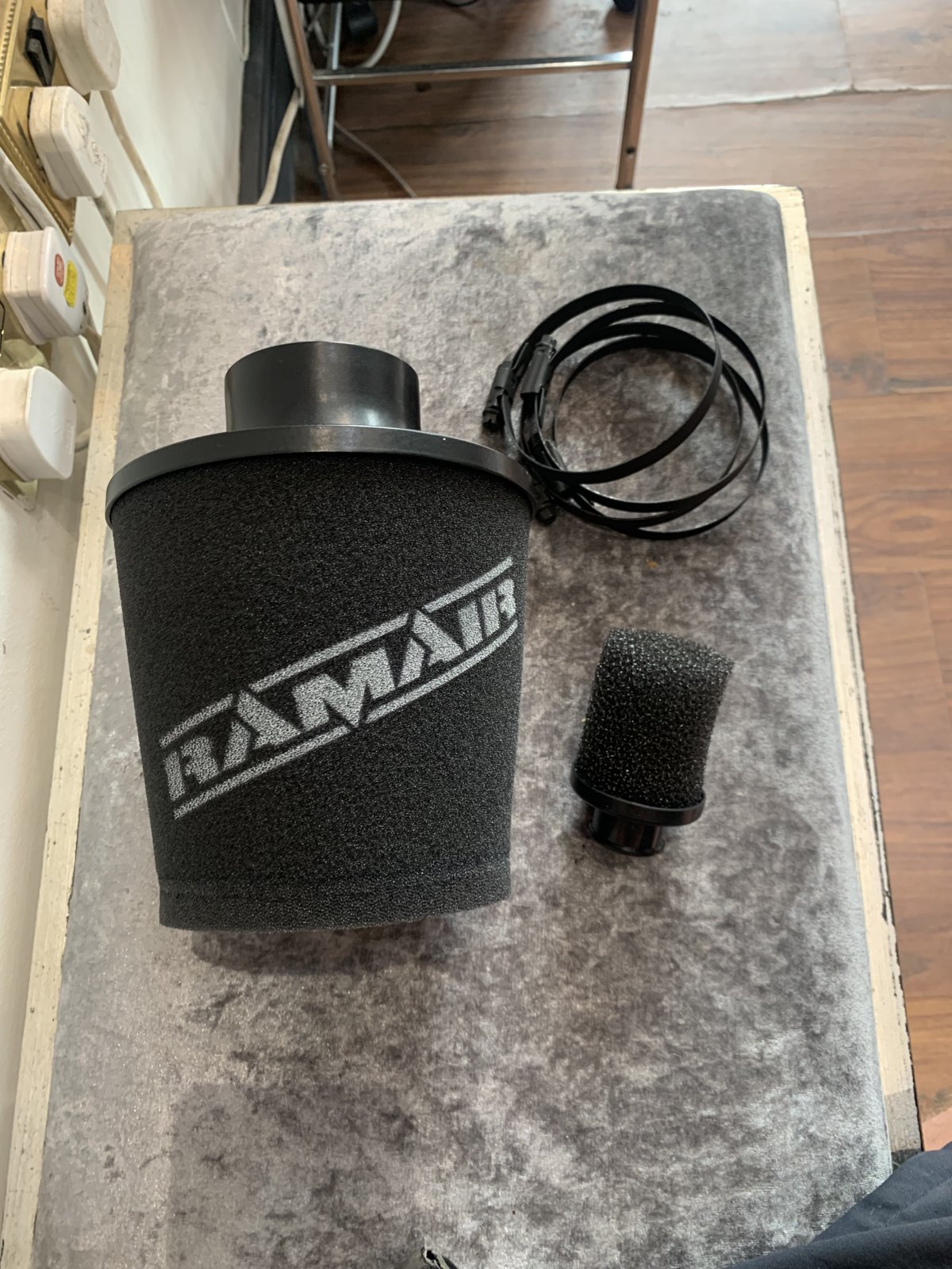

Just waiting for 2 90 degrees elbows to finish off the new induction setup. Iv ordered everything in black from the silicone hoses to the jubilee clips

Is that 143 at the wheels or the calculated crank figure?
Any monkey can throw a new belt on, but unless they've got the proper locking tools and know what they're doing it's pretty easy to get the timing fucked up.
Can easily lose 20hp with bad timing.
I’m not going to get too hung up on if the timing is out until I have replaced the exhaust, that horrendous air filter sucking in all that hot air and a major service. If it’s still in the 140 region then I will look into the timing. This is a little experiment for me to try and get the car back to its original BHP as much as possible. It drives great and pulls very well through all the gears so I have every faith I will get to at least 160bhp eventually ?

Come on people we don’t know it’s the timing, have faith! The oil and filter are filthy, the exhaust is blowing terribly. I’m fitting a brand new cat back exhaust system, brand new cold air induction kit behind the headlight to replace that huge air filter which is almost certainly suffocating the engine. NGK platinum spark plugs, uprated HT leads, the best oil I could get, oil filter, fuel filter. If after all this the car is still pushing out something in the 140’s I will accept defeat and get the timing looked at. The 2nd run is booked in for 12:00 next Wednesday so fingers crossed. Either way it will be very interesting I’m sure ??

I am going to go for a wild guess and say the car will be 149.6 next week, the timing is surely out ever so slightly but at least we can see how a good service and exhaust and filter can change the figures of a car. We can then see how adjusting the timing of a 172 can change the figures aswell and I will get that booked in somewhere for the following weekend. Then back to the rolling road. Anyone else who has timing worries can then use me as a guinea pig and get the problem sorted out on their own car aswell. Who else wants to guess the figure? Closest gets £20 sent to them via PayPal and I promise I will ?
It’s currently 143.4bhp and is desperate for a service plus the catback and filter, so I’m not being too ambitious hoping for a 6.2bhp Increase surely?? ?
