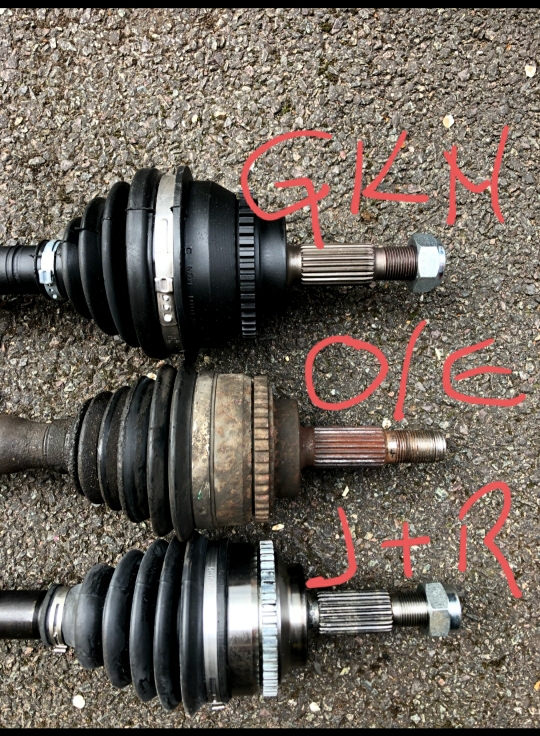

OK... Op. The problem is that Renault and some other brands offer a shaft between 65* to 660mm.. Now Euro Car parts do a GKN Lobo shaft which is 640mm.. The problem you are having is that on a right hand turn the inner tripod is knocking inside the diff cup. YOUR ONLY SOLUTION is to replace your shaft with a GKN 640mm shaft..
My other advise would be that please dont take your car on track as is, because you will damage/break the diff..
As you can see in the picture the GKN is visibly shorter..

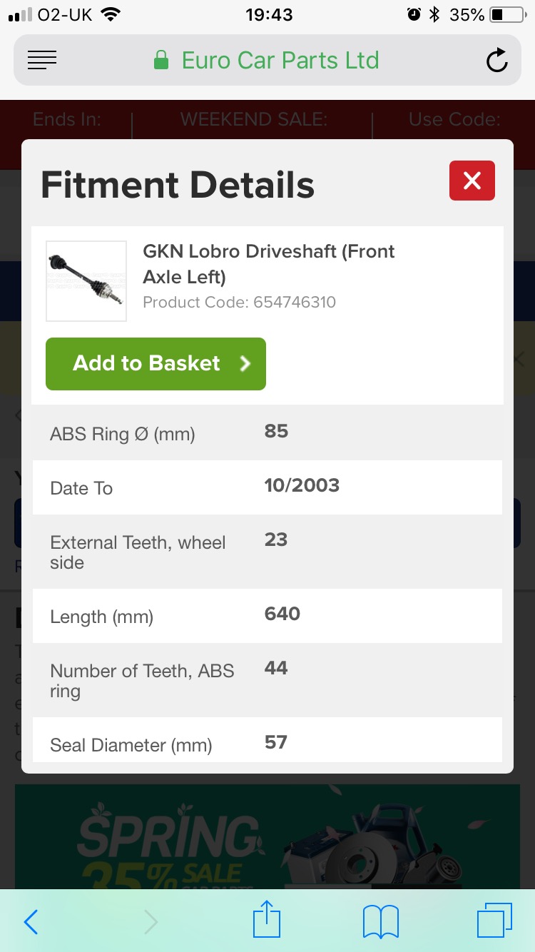

To answer your question though
GKN shaft is 640mm
OE is 658mm
J&R shaft is 660mm
When i had my knocking issues Mark (Northloopcup) and I was searching for PH1 shafts from different sources and we could do find a shaft short enough.. I stumbled upon Euro car parts GKN shaft just before i was about to take my OE shaft to Dave Mac Propshafts (Gripper) and have them cut and shorten my shaft by 20mm, which is what Dave at Gripper said was required.. Luckily all that was avoided when i bought a new shaft and my problem was done with.. Been running solid now for 15+ trackdays and still going strong..

Euro Car parts mate
