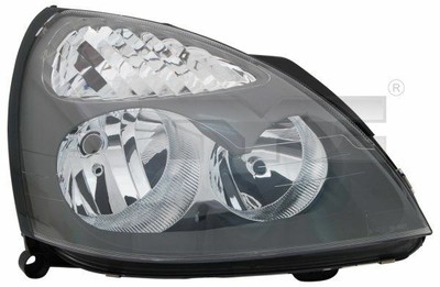

I'm in a similar situation to the above. Everything except for the plastic lenses is fine... but I guess they're a sealed unit ? Is it not possible to buy something like the link below and take the xenon bulbs etc... from my existing unit and swap over ? I know the balasts etc... are located outside the unit.
Having said that, these aftermarket units state that they're 'grey' and look a bit different to my standard unit on the 182.
