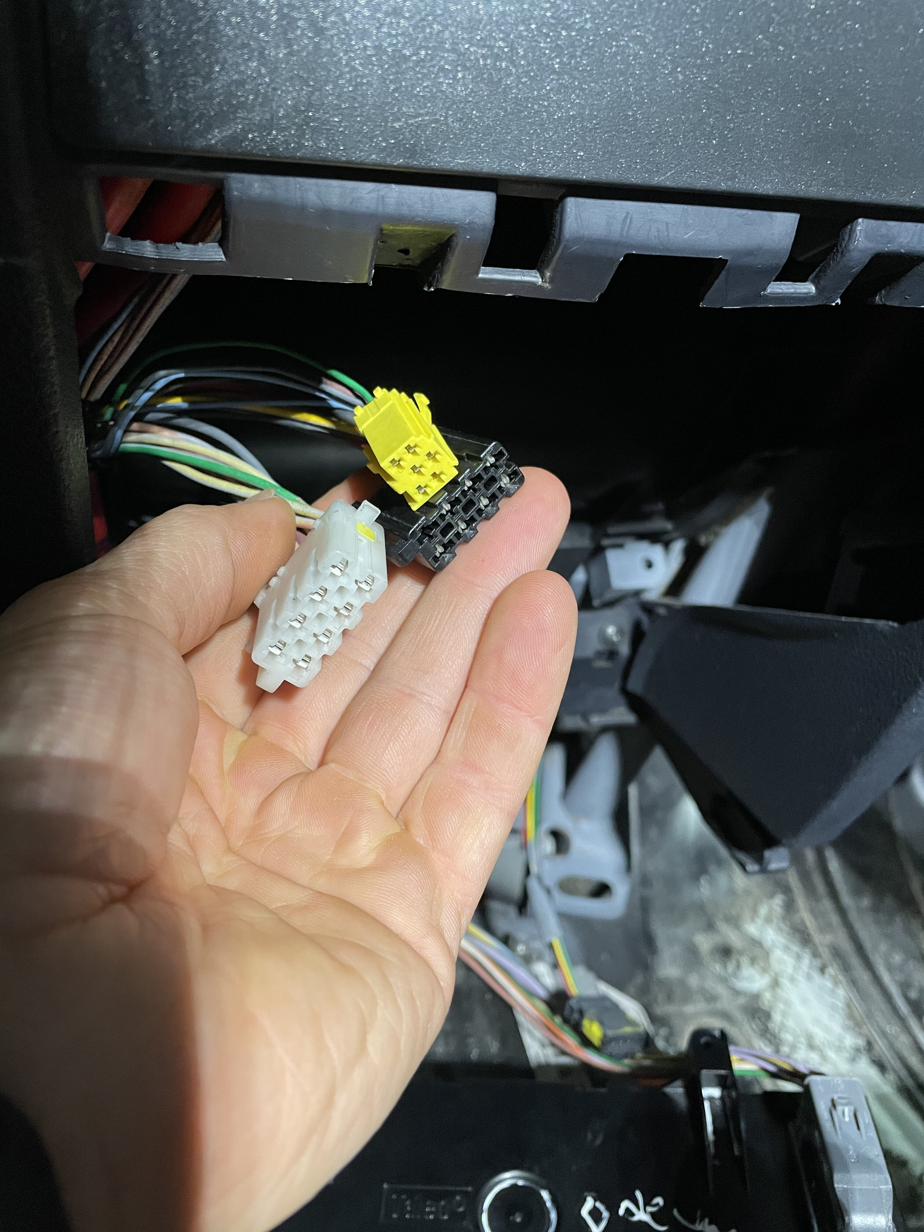

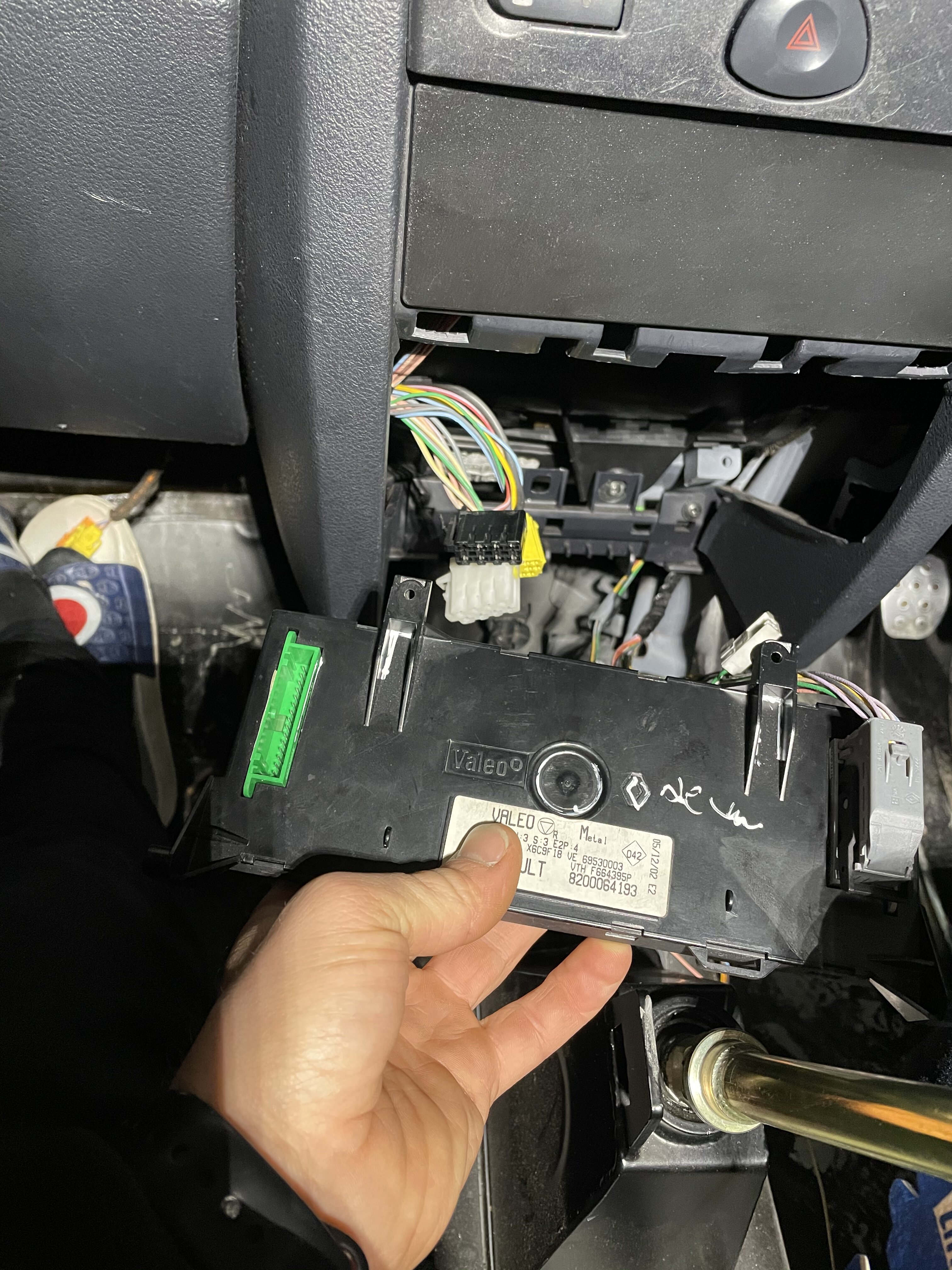

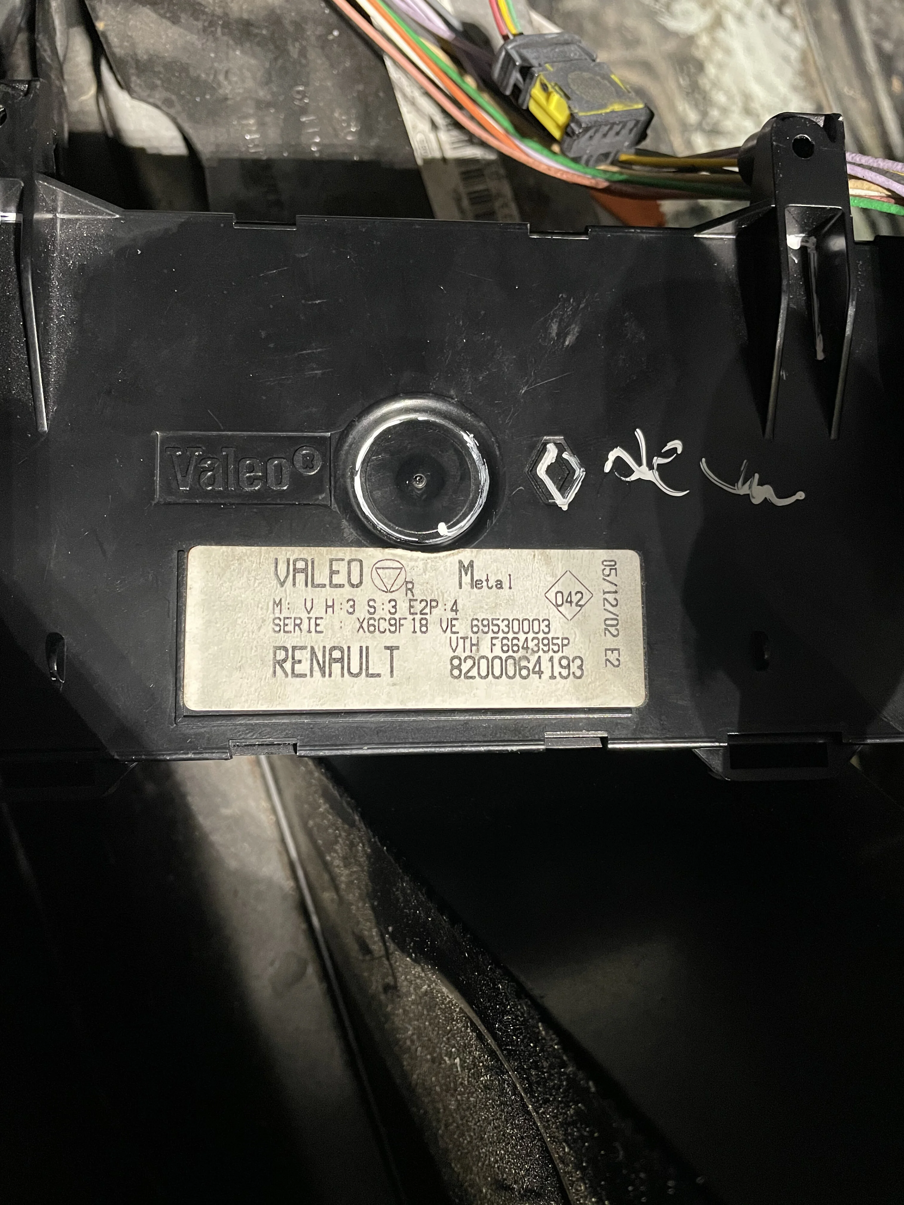

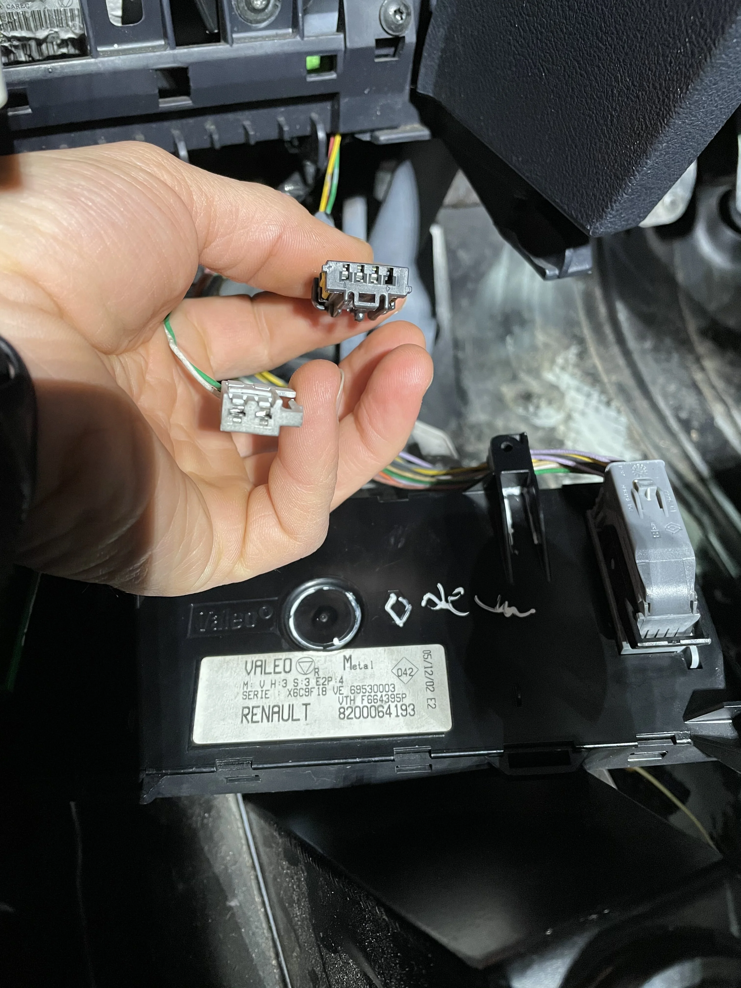

I have a 2003 172 which when I bought it had had the AC delete done, and as far as I can see has had just the heater/climate controls removed. I want to have a heater again so thought it looked like just plugging in the control panel again...

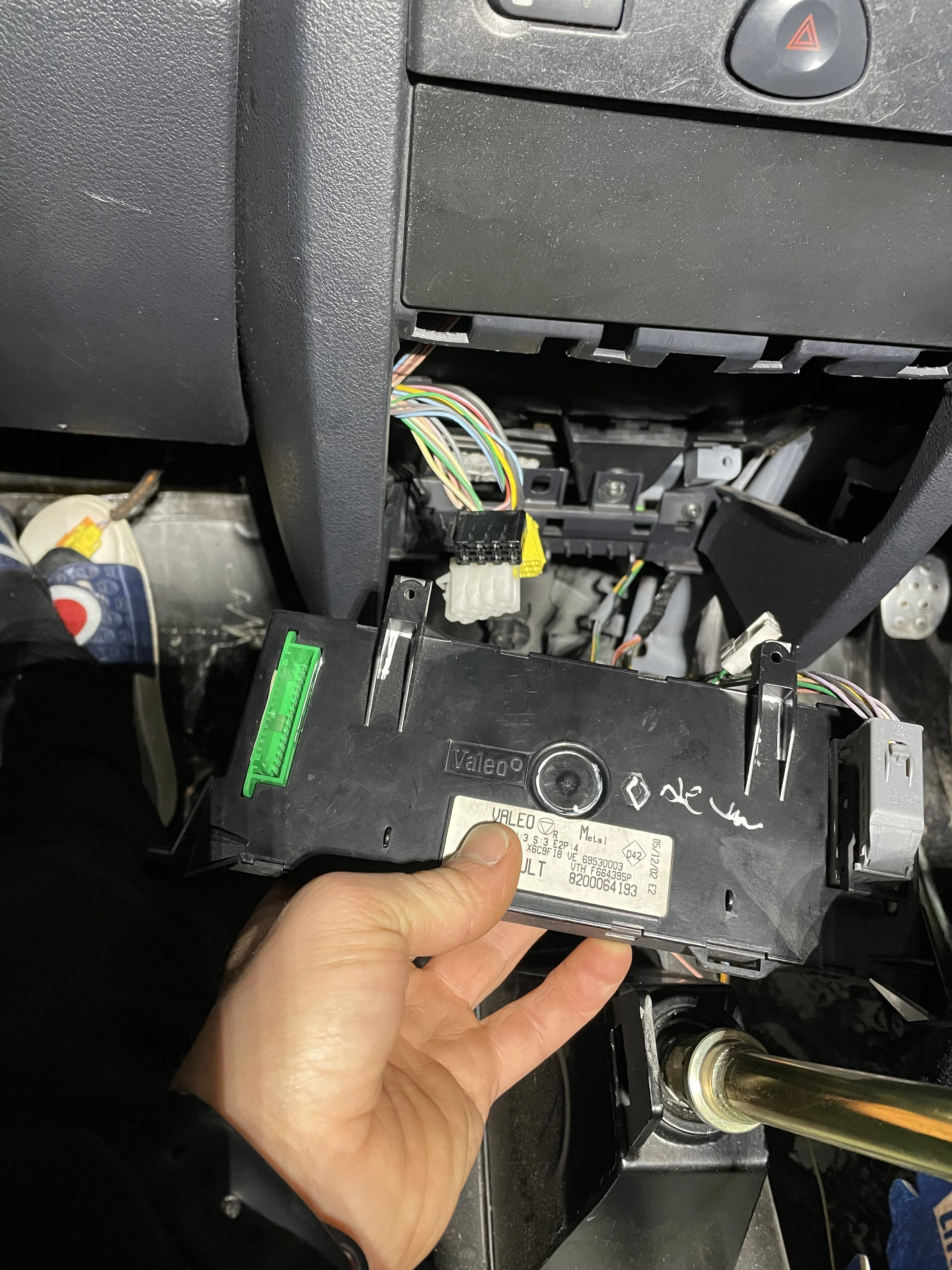

Anyway, I’ve bought a climate control panel but can’t seem to find one of the plugs? (The green plug!) to make it work.
Am I right in thinking it can only be this type of control panel or the cable type? I’m assuming mine isn’t cable as there’s no cables?!
I hope this makes sense and we can sort it out besides it’s driving me mad!

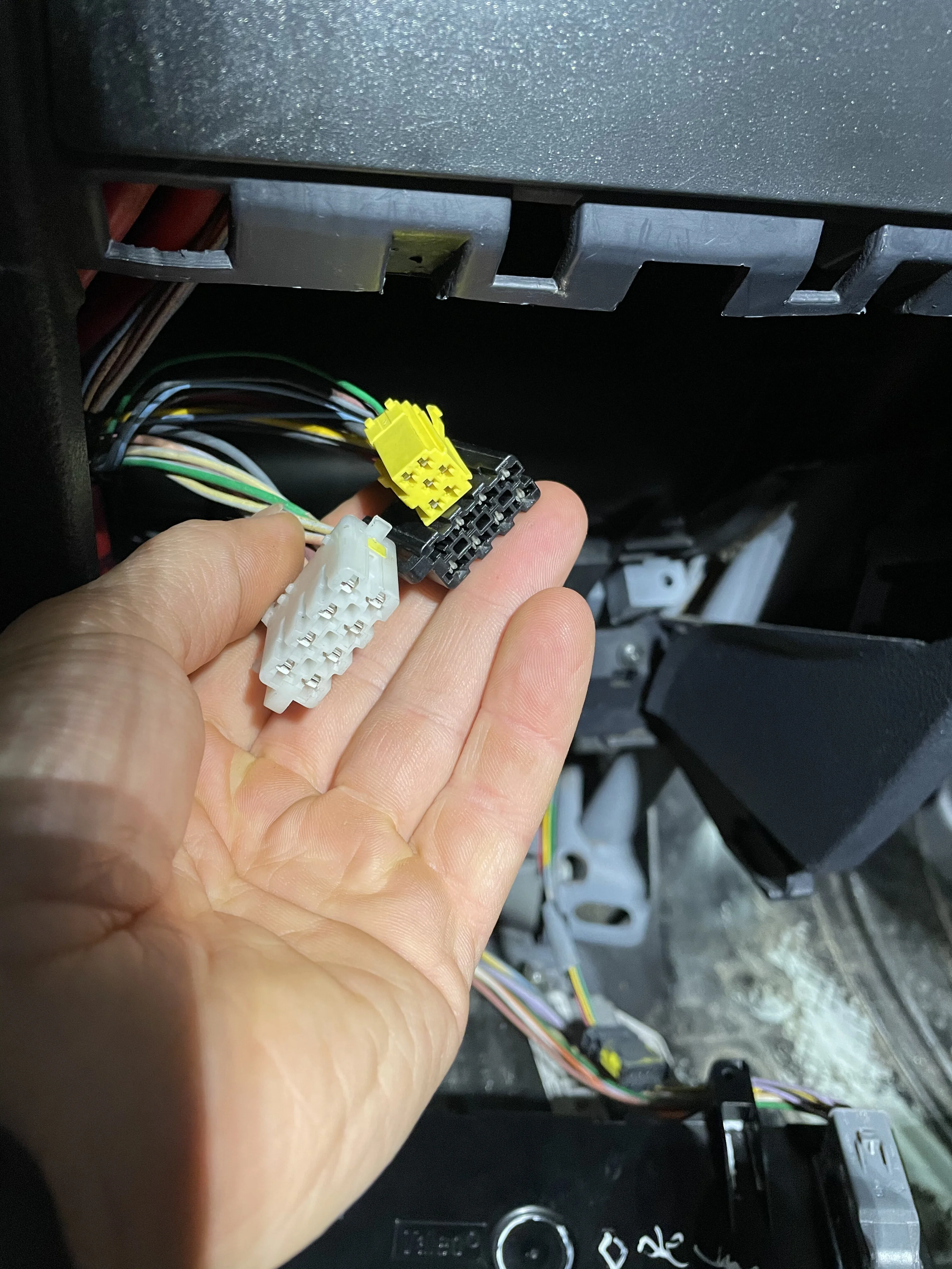

I definitely can’t see that green plug anywhere, do you know what direction it would come from so I can try and trace it back? Thanks
Sorry I cant help you with that, not with car right now to have a look. I dont think it would be hiding there isnt that much under there. Perhaps the previous owner removed it, might be a different dash loom in there.
Thanks for your help mate, hopefully someone else can shine some light! Why someone would remove just half of the heater system is beyond me... 🤦

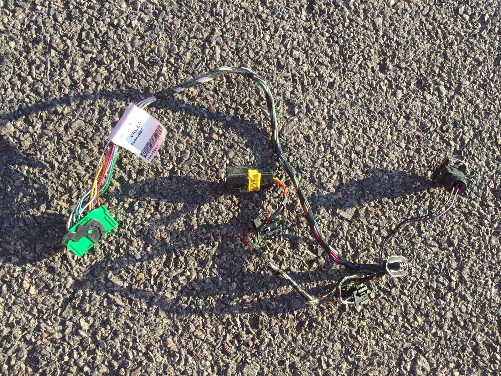

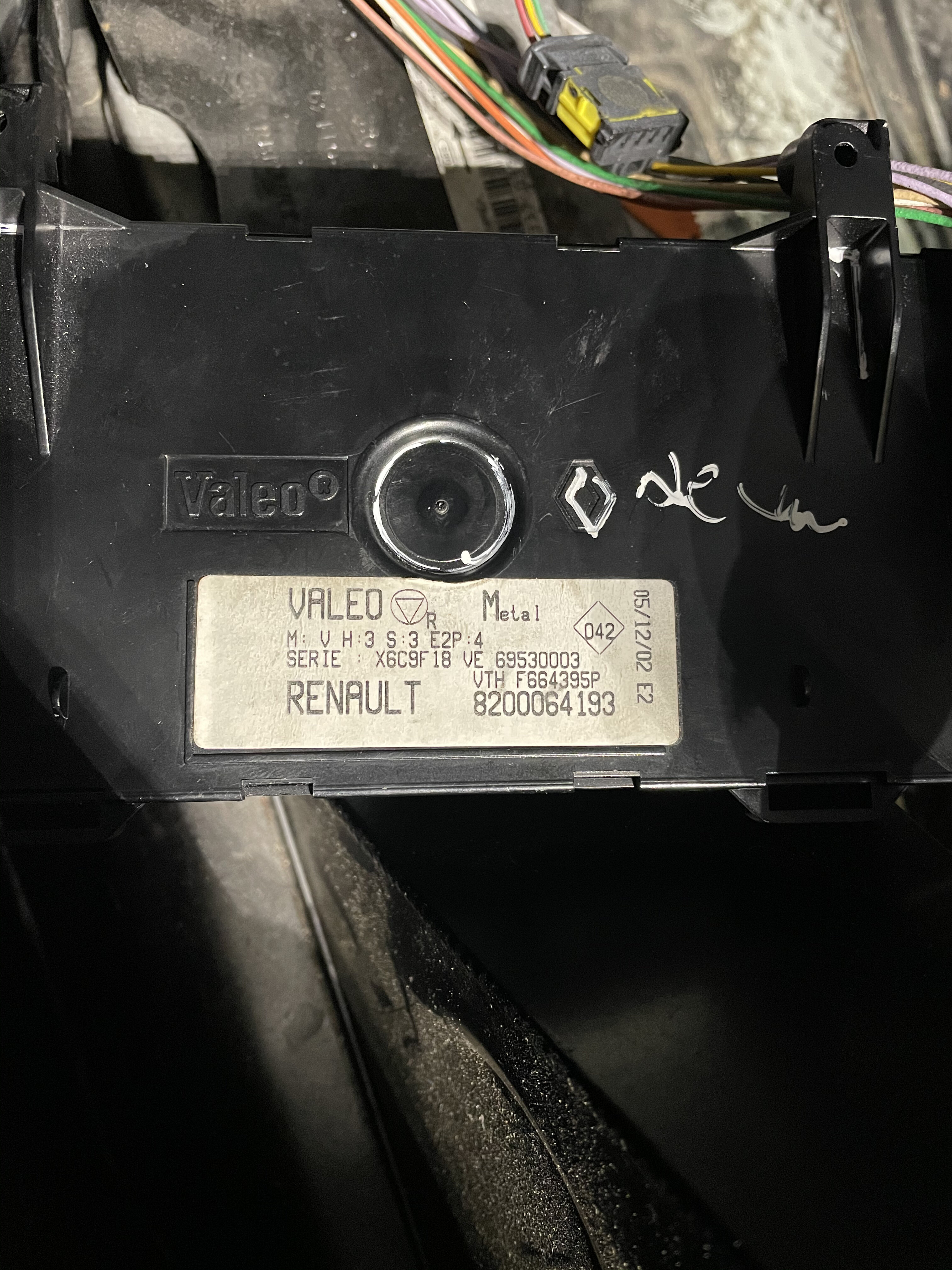

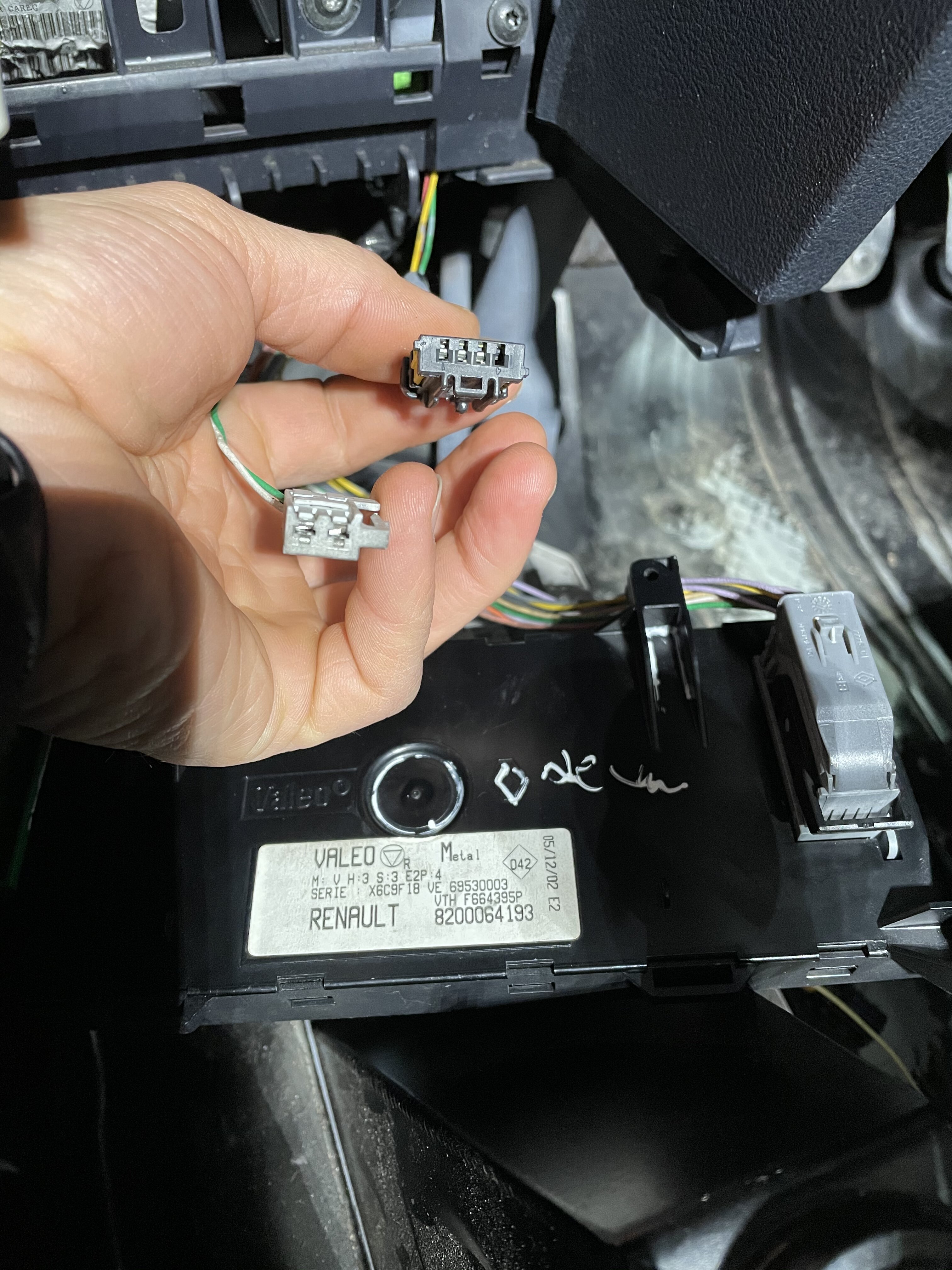

The 3 in pic 4 are radio connectors. The green socket and the black/yellow plug connect to the heater actuators (the loom ZacB posted).
I don't remember the 2way white connector?

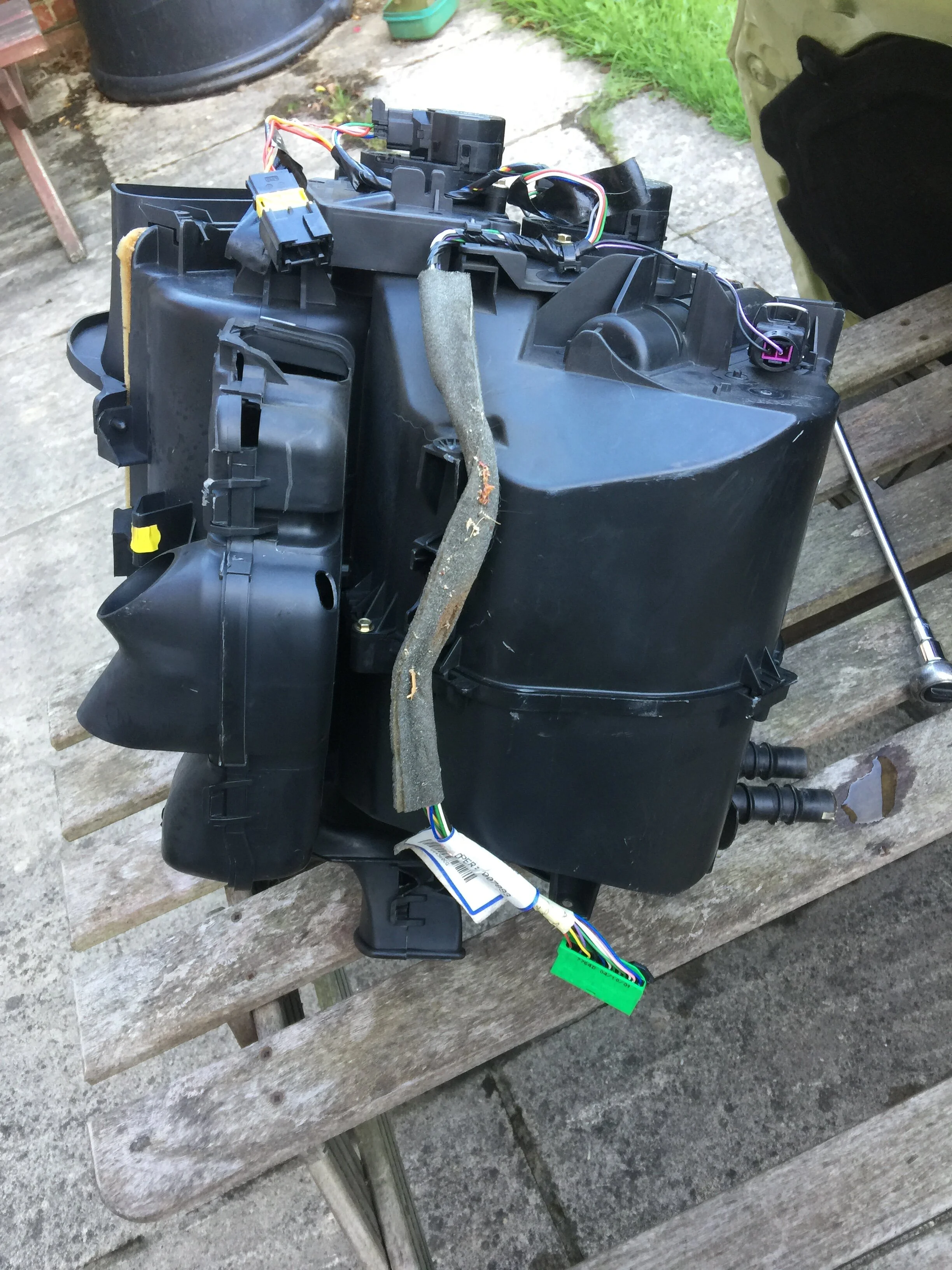

Sorry to bring up this old thread, my cc panel doesn't display any digits just had a light back light, I have found a cable that's burnt on the green plug side before the plug for the main plug that then splits into 4 wires for the motors, is that all that green plug controls? Or is there a control module or something that displays the digits?
