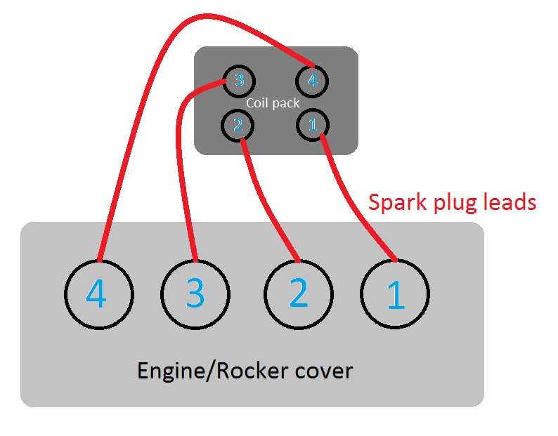

Just in case you didn't know already, on the rocker cover the cylinder numbers are 4,3,2,1 from drivers side to passenger. On the coil pack it's 1-bottom right, 2-bottom left, 3-top left, 4-top right. Or you can just follow the leads.
