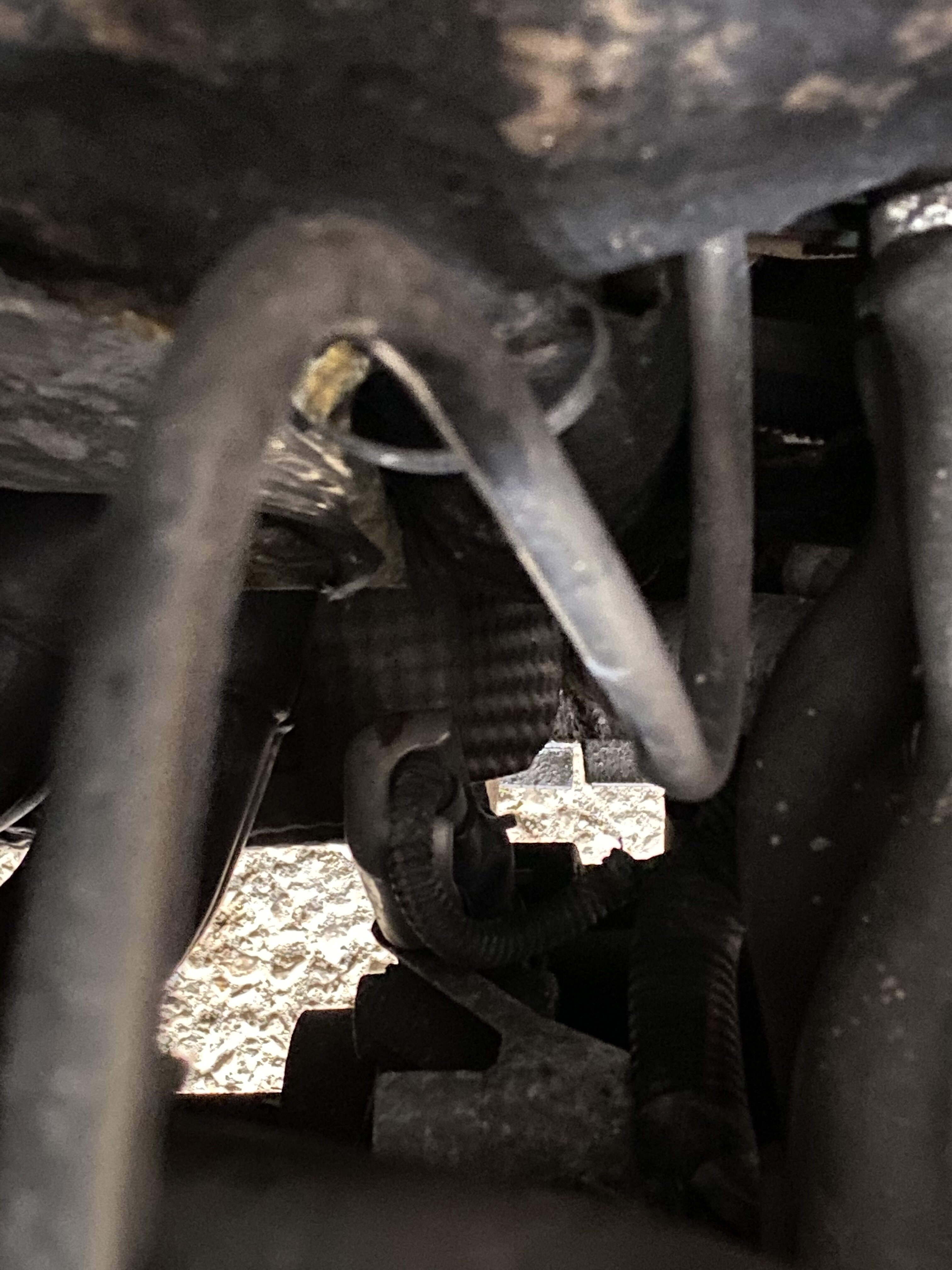

One ABS ring was caked. Hasn’t fixed it. But is this the speed sensor?
If so, probably the issue ?
Jason_E
  Golf GTI, Jap Tank.
f**k sake. What an idiot why didn’t I look?
Cheers fellas! At least my ABS rings are clean now.
