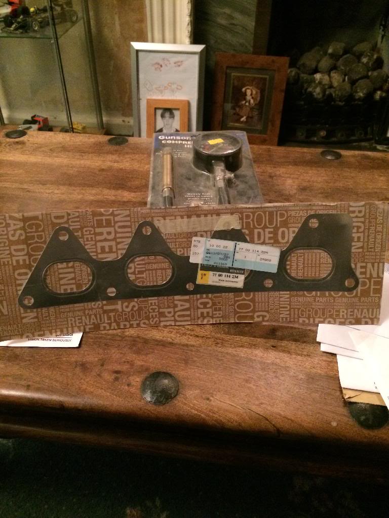

I've changed the mani to cat ring and the old one didn't show any signs of blow by. Didn't seem to change the fault either. I have aqquired a mani gasket from Renault, anyone know if I disconnect the cat if the manifold can be pulled back far enough to swap gaskets over with the manifold in situe? ( I.e save dropping the subframe ).
should be able to, I took the inlet off mine and lifted the old mani up out the top when I fitted the 182 system
just make sure you have the right gasket from Renault, there are 2 listed (1 is for late 172/182 the other for early 172 with oval ports)
no need to disconnect the cat, just undo the 9 x 10mm nuts and you'll be able to move it enough
Cheers chaps I'll get a picture up of the gasket so you experts can confirm before going ahead! Much love.

This is the correct gasket for the Ph1?
