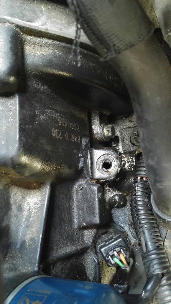

Hello everyone,
guied dip stick broke, just connect avoid anything that allows him to pull out simply.
Has anyone come across this problem? Until now I thought of two solutions
First, lower oil pan, can make at home? And remove from below the broken part
Second, try to drill out the broken part. Run oil cheaper then, hope everything is washed out and put a new
Thanks, Ori
Google Translate , it's that bad ?
Sent from my LG-H815 using Tapatalk
@rupni
Dont worry I understand. The pipe the dipstick goes in to has broken off . If there is anything left to grab on to then get some mole grips on to it and unscrew it. Must be able to get a replacement pipe ordered from Renault I would have thought.
Nothing left to grad on
