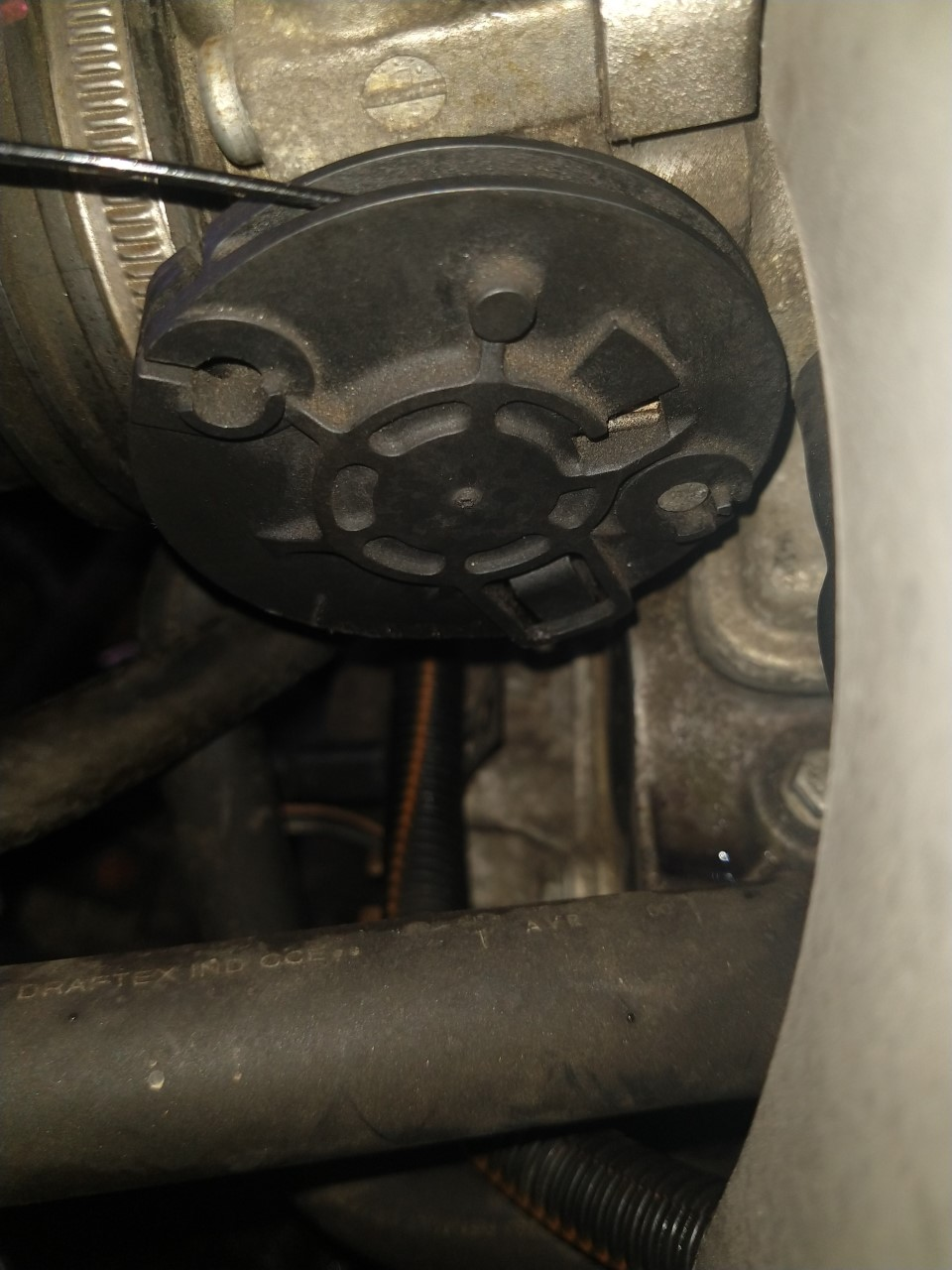

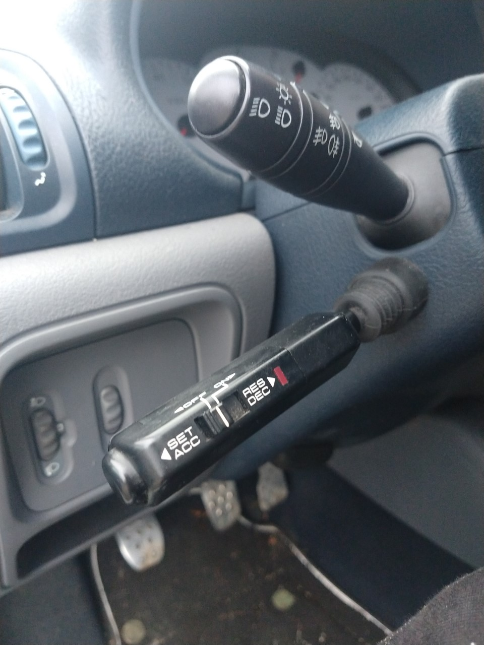

Just got a 172, runs really nice, but was told by previous owner that cruise control needs to be adjusted at throttle body to be enabled.
Not sure what needs to be done because i was told it works but just needs to be enabled.

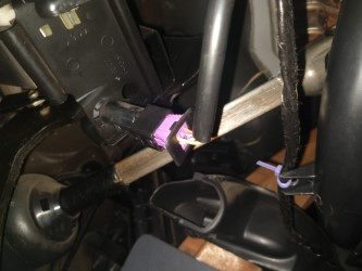

pic 1 i think is the clutch switch

That's aftermarket. Looks like a standard throttle body movement but due to the cable throttle this is pretty likely to be vacuum driven. To turn it on in the ECU there is probably a switch to send 12v to the cruise control pin so have a look for that.
Rystar
  2003 Clio 172
Its definitely aftermarket, usually they have an electronic servo box with its own throttle cable coming from it. if you wanted it to work you'd have to locate that servo/cable arrangement as its probably been disconnected and tucked away. You'd then connect the cable from that to the other side of the throttle linkage on the throttle body (where your normal throttle cable goes there's usually a second guide for a second throttle cable).
Personally, i'd be removing that
